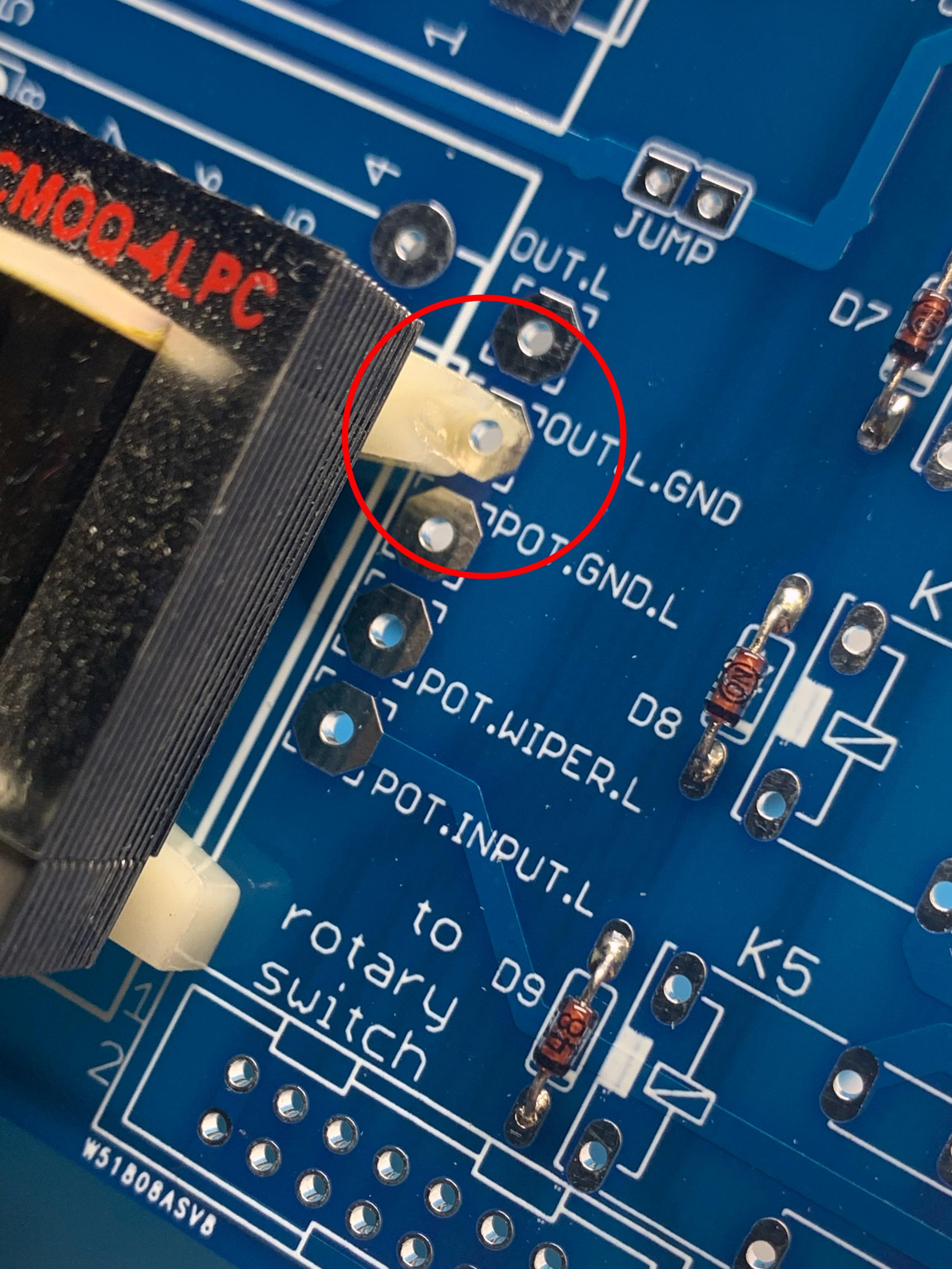

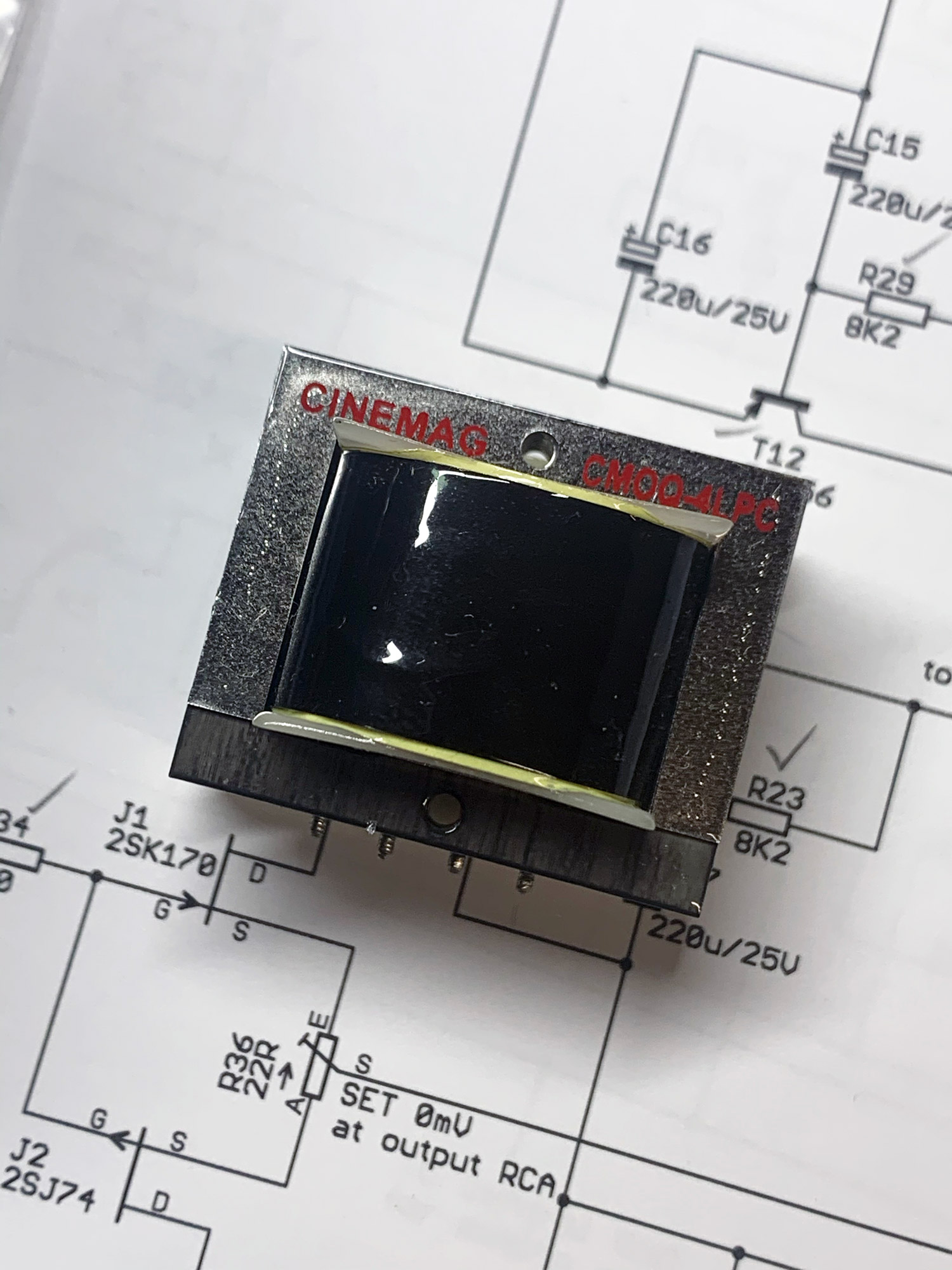

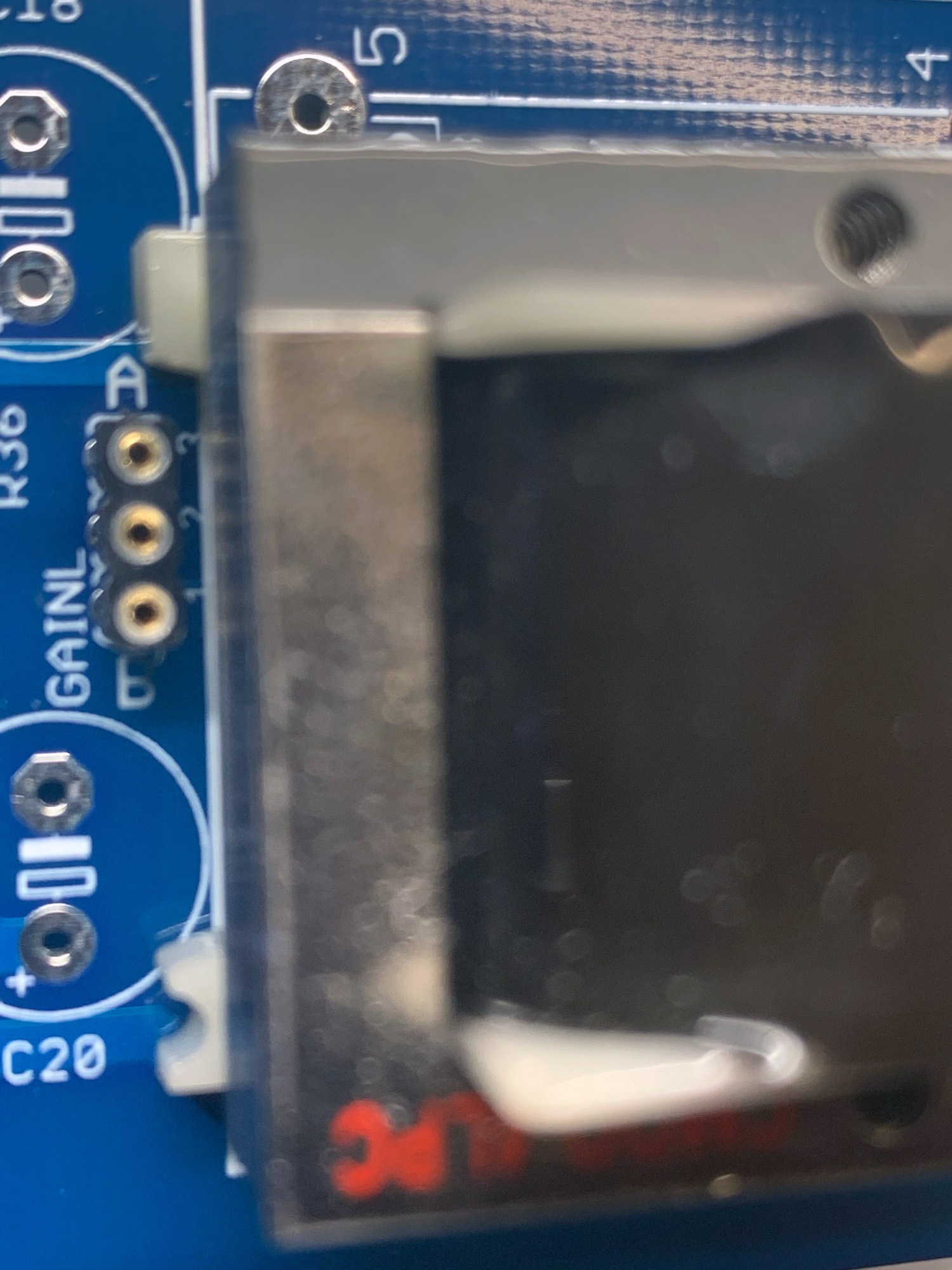

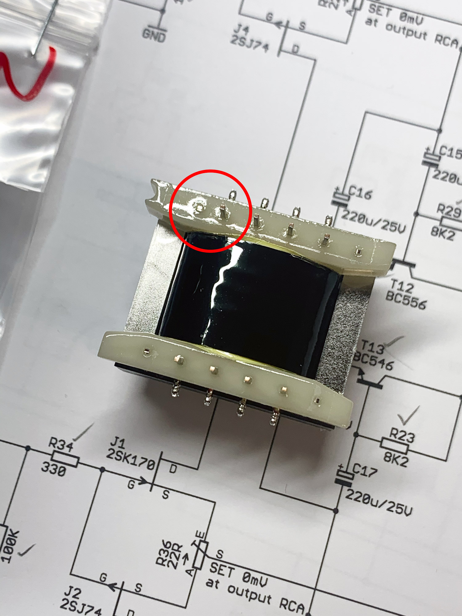

Some confirmation needed (for me) on the Cinemag install. They really seem to fit in only 1 way. All 4 outer pins are cut—they aren't connected to anything—and don't fit the PCB (as previously discussed in this thread).
See pics.

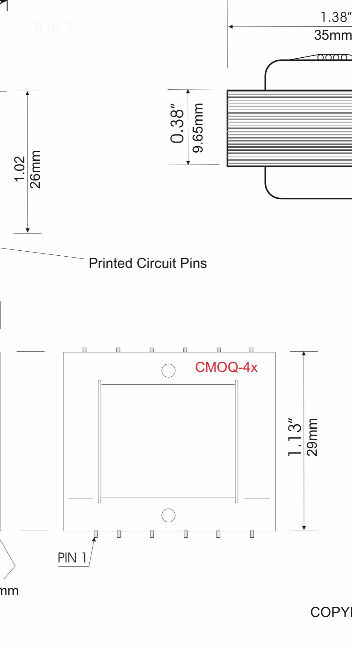

The schematic shows "pin 1", now removed, as closer to it's adjacent pin than the spacing of all of the others—yet that relationship on the actual transformer in hand is the opposite of what's in the Cinemag diagram (looking at the text orientation on the top of the transfo as a reference pin 1 should be bottom left, yet actual transformer has that relationship top right)—basically the diagram from Cinemag seems opposite of the actual transformer when looking at the pin 1 designation.
Hopefully my confusion is clear.
Is the cutout on the plastic support bar (red circle) just a coincidence? (Making clearance for OUT.L.GND).

yup , only one way of installing it , even if in case that you rotate it for 180deg , no biggie , result is same ........ not counting what's preferred way when thinking of winding capacitances vs. input phasing
not enough place is , certainly , my bad , but I believe I did manage these details in last/final/golden/bestthanmanafromheaven iteration of pcbs
so , just be creative , squeezing in what's needed ; result maybe little awkward to eye , but nevertheless sexy whispering in ears
should I say that is my wit ........ or that is coincidence ?

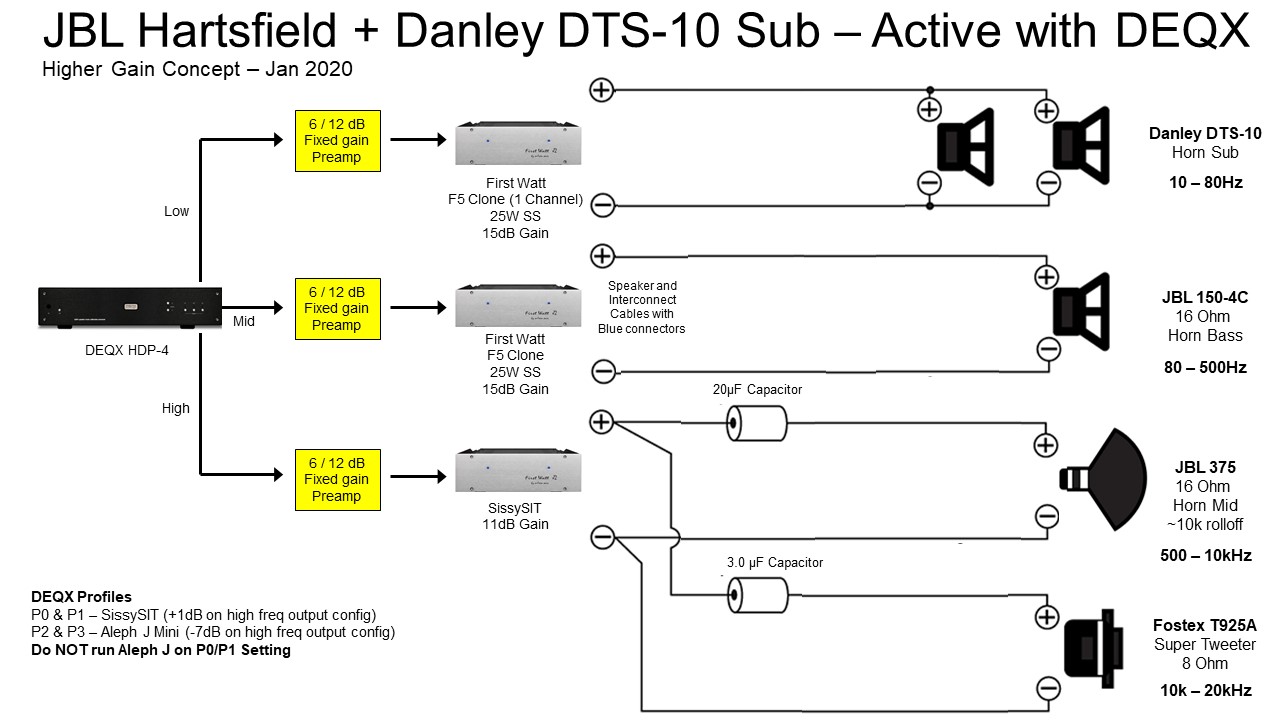

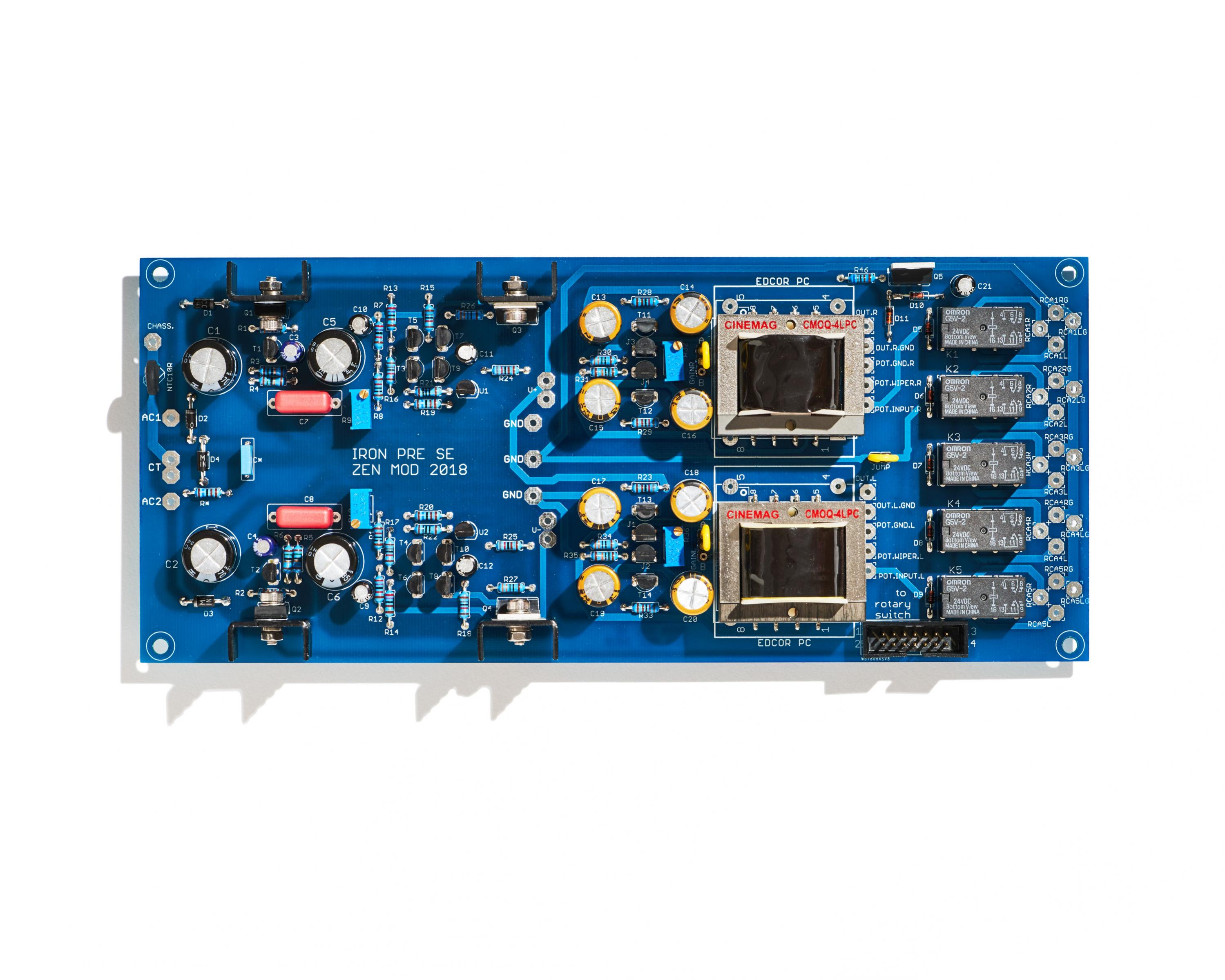

I'm going to be building this soon thanks to the kindness of Jim and and Patrick. Your design is going to solve my need for 5 channels of 6 or 12 dB gain, and I will have a jumper to choose! Elegant and Perfect! 5 channels of fixed gain. Shall I have "5 Iron" on the faceplate?
My plan is to leave off all the relay switching parts, and I also won't be using volume pots.

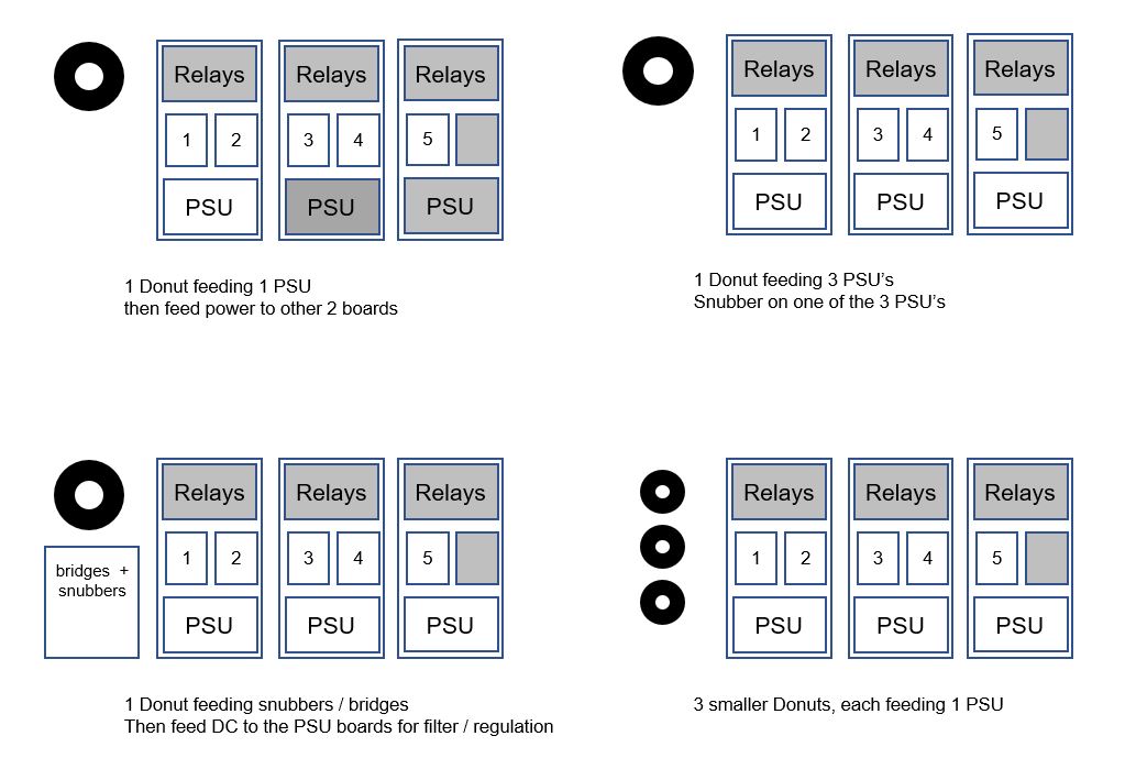

What's your opinion on best way to implement power supply for 3 boards? I have a few ideas attached, and I'm looking for your advice.
you can call it Elmer Working on the Railroad , if you wish ........ 🙂
considering that GND is shared between all of these , use one Donut feeding all of them
leave intact arrangement on pcb - build all regs
parts are cheap and there are still limited number of them , so why not having it made properly
to repeat - small heatsinks just on BD transistors , no need to put them on mosfets
btw. tnx to kindness of Jim and Patrick , all interested parties are going to build them right away , so no need to introduce it in Store
well made ( static shield , magnetic shield) 30VA , 30Vct Donut is good for job
