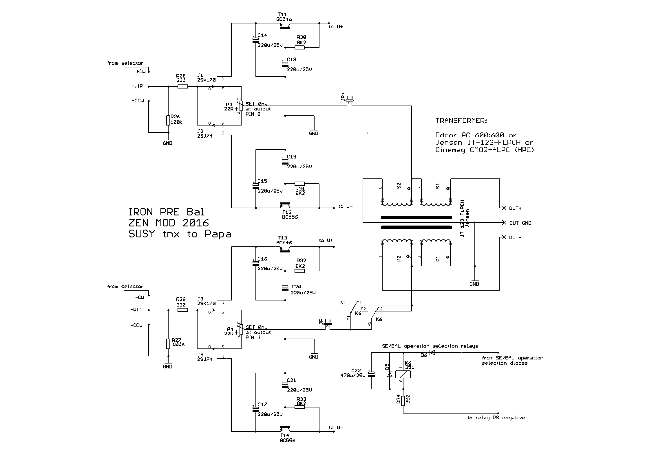

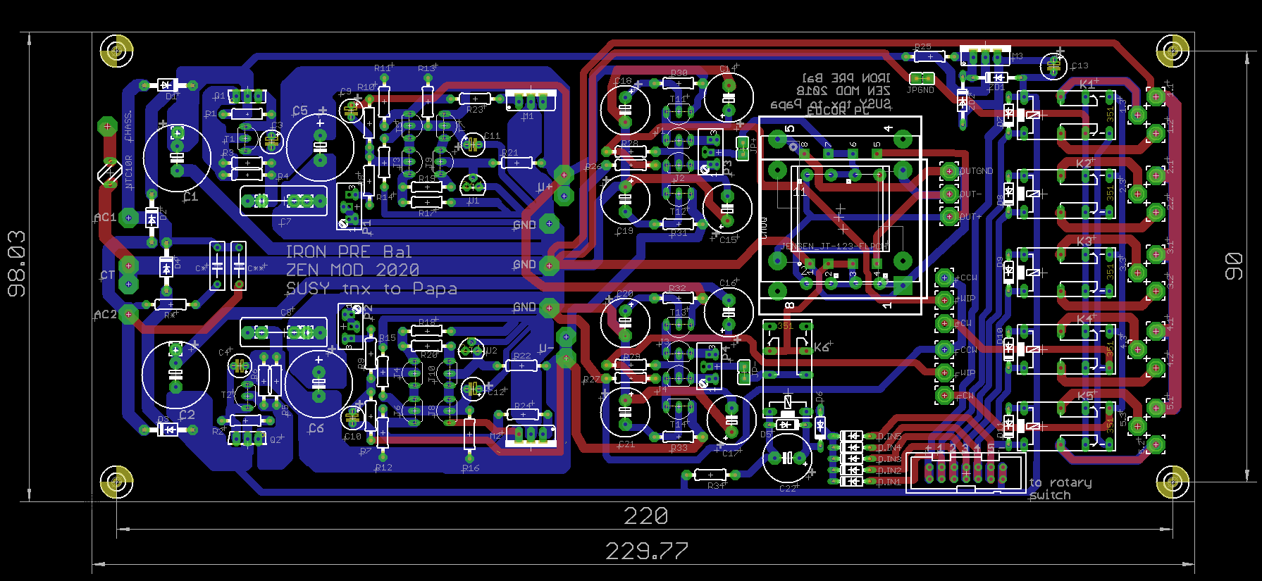

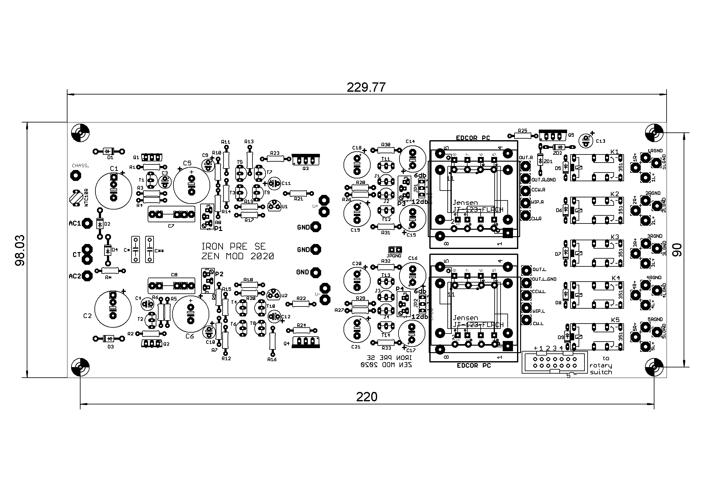

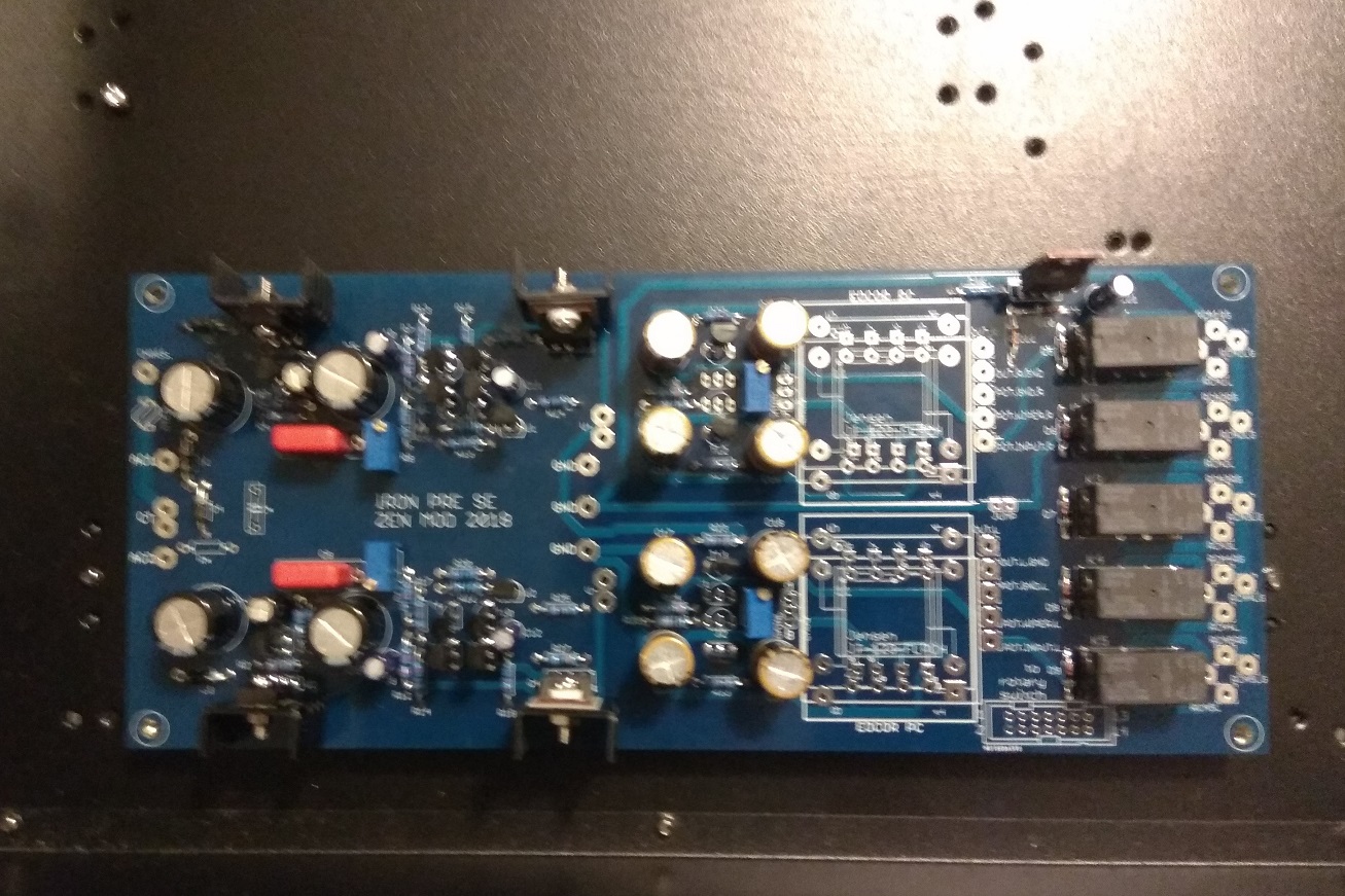

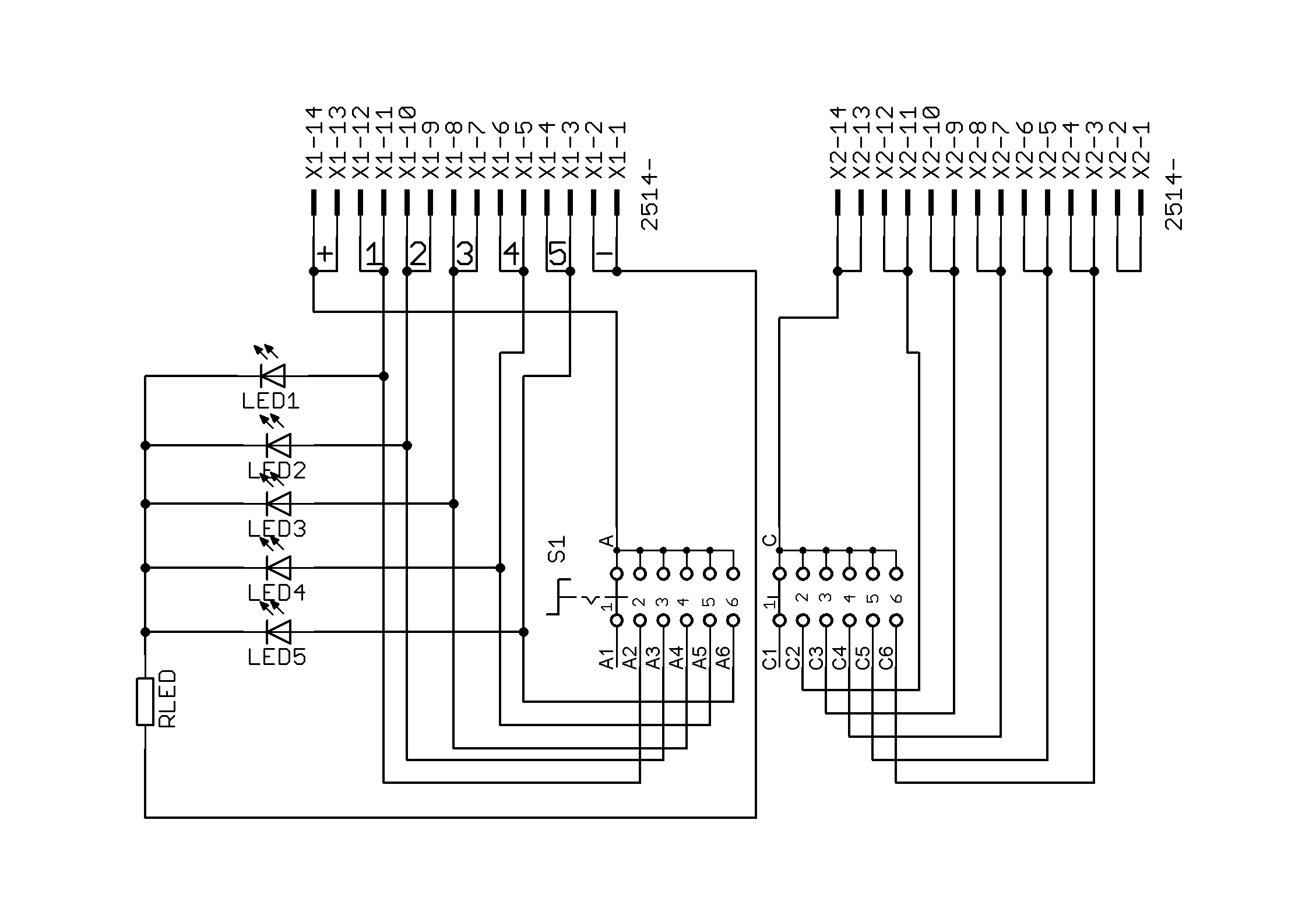

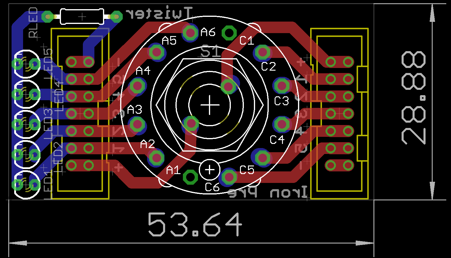

oh , btw.......
there is ongoing e-mail correspondence between Flying Jim (6L6) and Patrick A. (sorry, ZM didn't catch Patrick's Nick) and Mighty ZM ..... you can easily grasp how easily ZM is confused with e-mails flying between 3 of us .......
anyway , topic is final development of Iron Pre preamps ( both SE and non-SE) , mostly related to brushing up nomenclature , enabling all bells and whistles,helping with BOMs and preparing of Build Guide , enclosure(s) etc.
my part is finished (sch and pcbs) , so I'll post just teasers -- how final pcbs are going to look
hope I'm not stepping here on their toes ...... 🙂

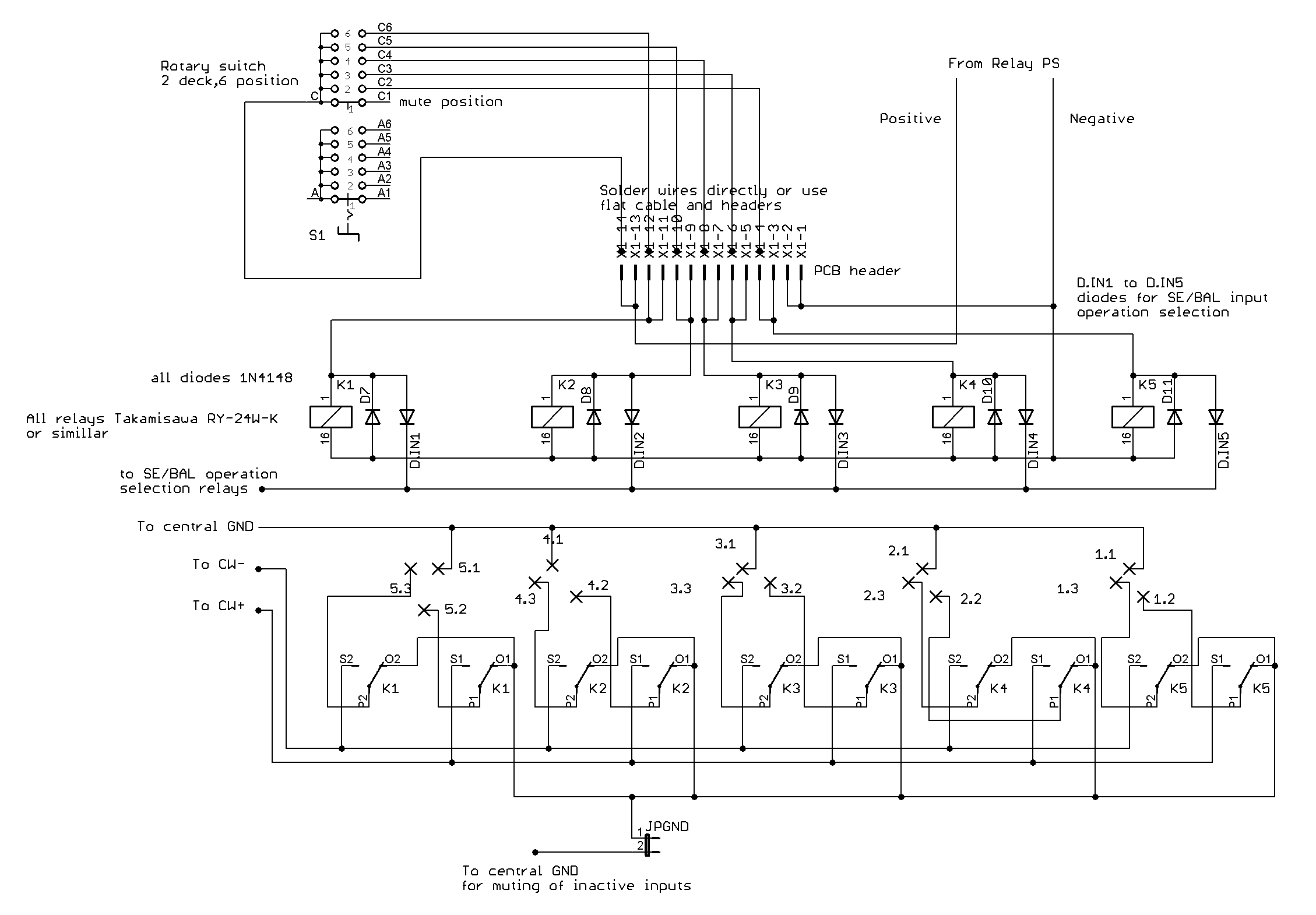

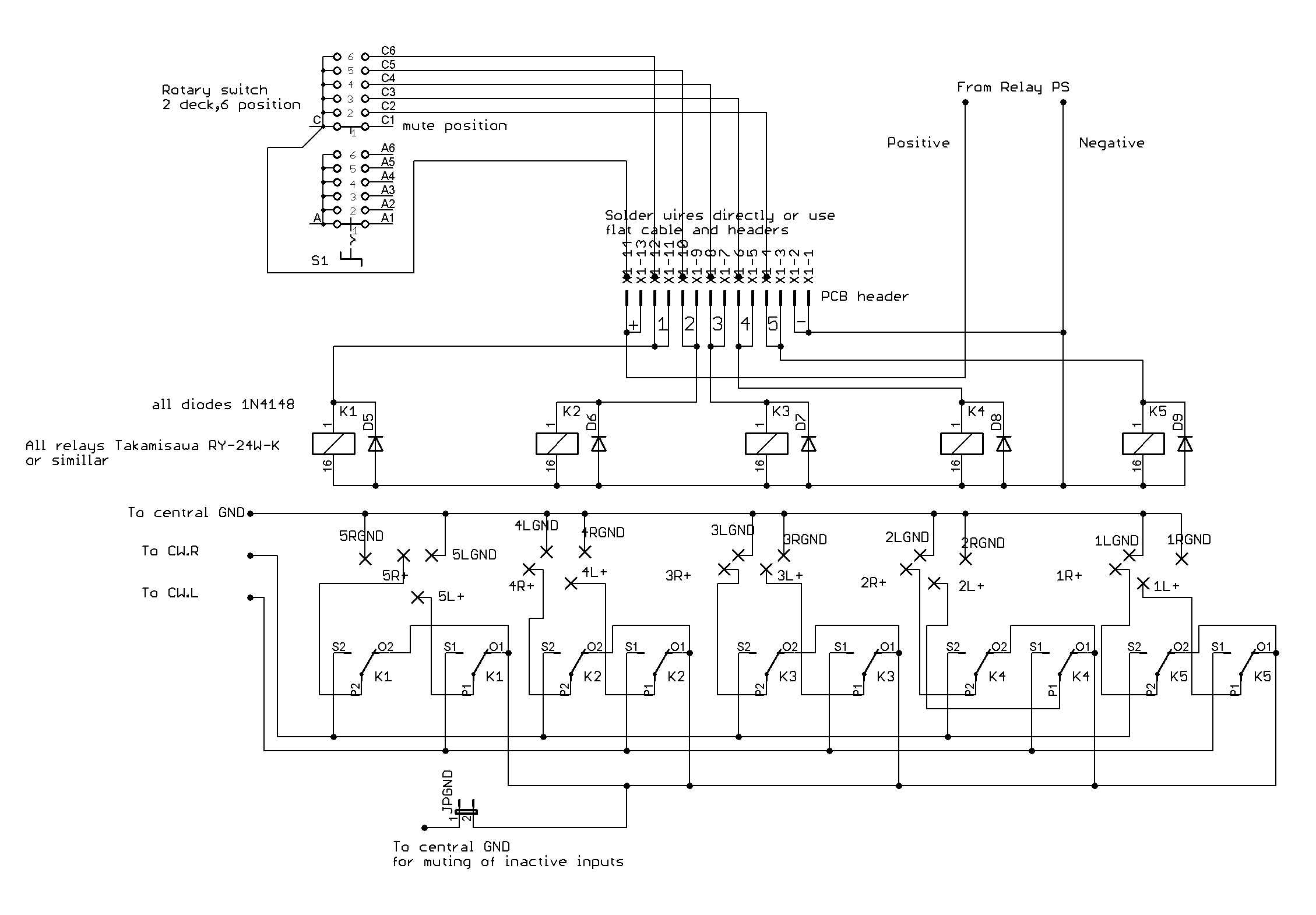

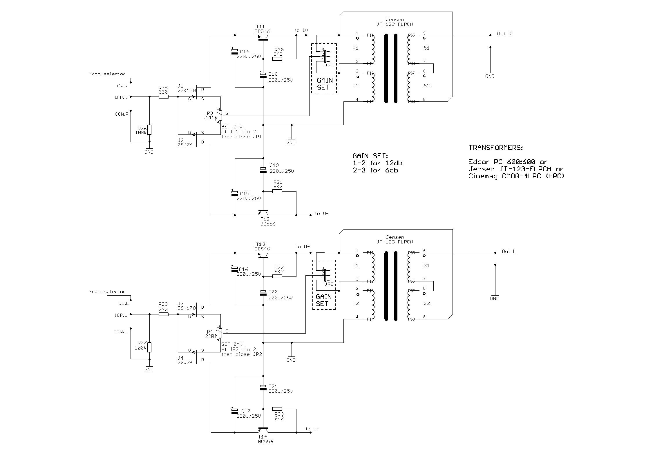

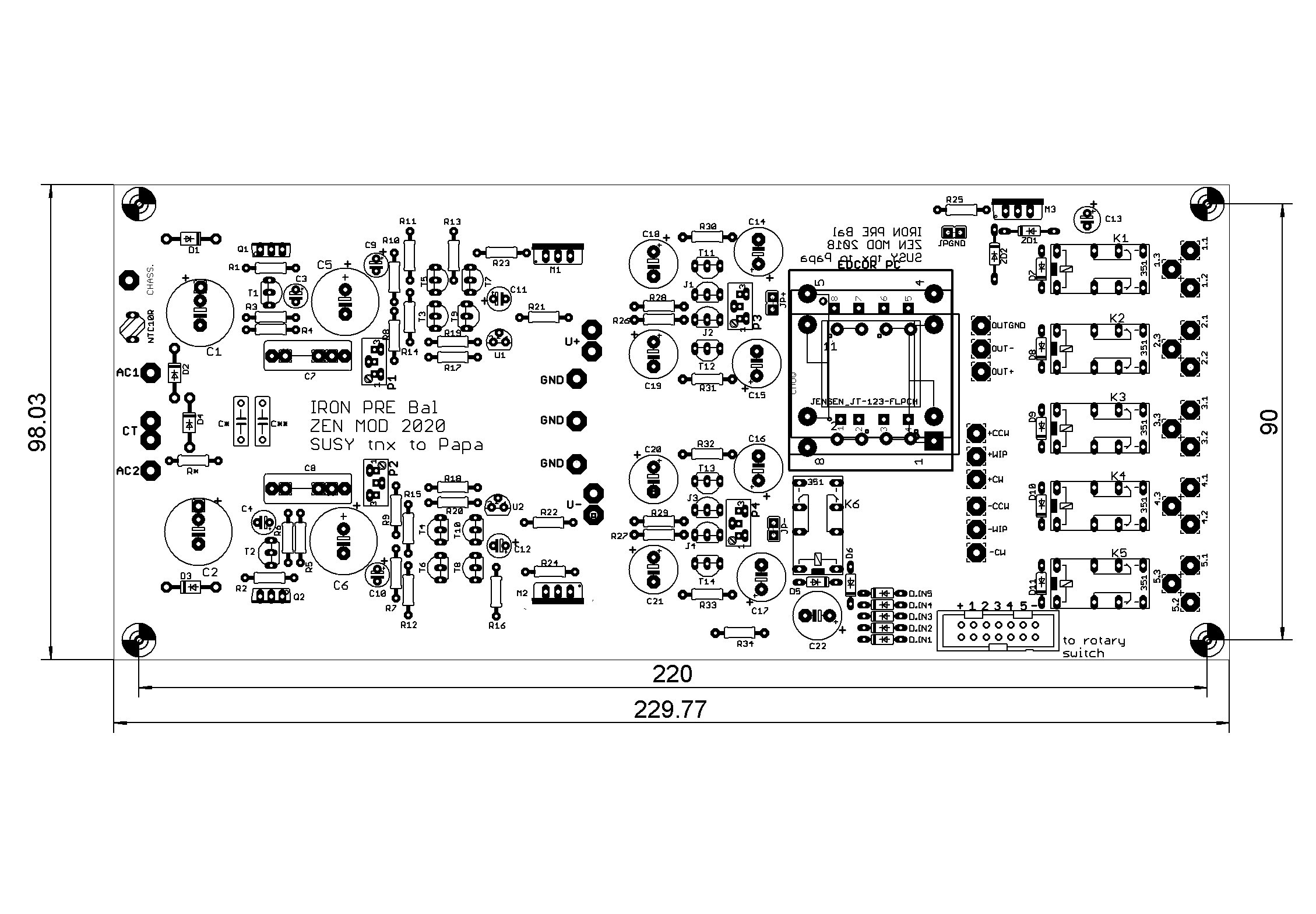

well, ''Pre'' in title is somewhat hinting that ....... 🙂
but , anyway , that's line preamp stage , where you have selector (5inputs) followed with resistive attenuator (volumepot) , then followed by buffer (with reg. psu ) and finally autoformer at output ..... everything on board ;
SE iteration - both channels on one pcb , 3 different brands of autoformers applicable, settable gain 6db or 12db
Bal iteration - one channel- one pcb , 3 different brands of autoformers applicable, gain fixed 6db , arbitrary number of (fixed) SE inputs , rest to 5- Bal inputs, both SE and Bal outputs (active in same time) ; so , functioning as SE in/Bal out and Bal in /SE out converter , and normally as Bal in/Bal out stage
if I forgot something ........ just shoot
