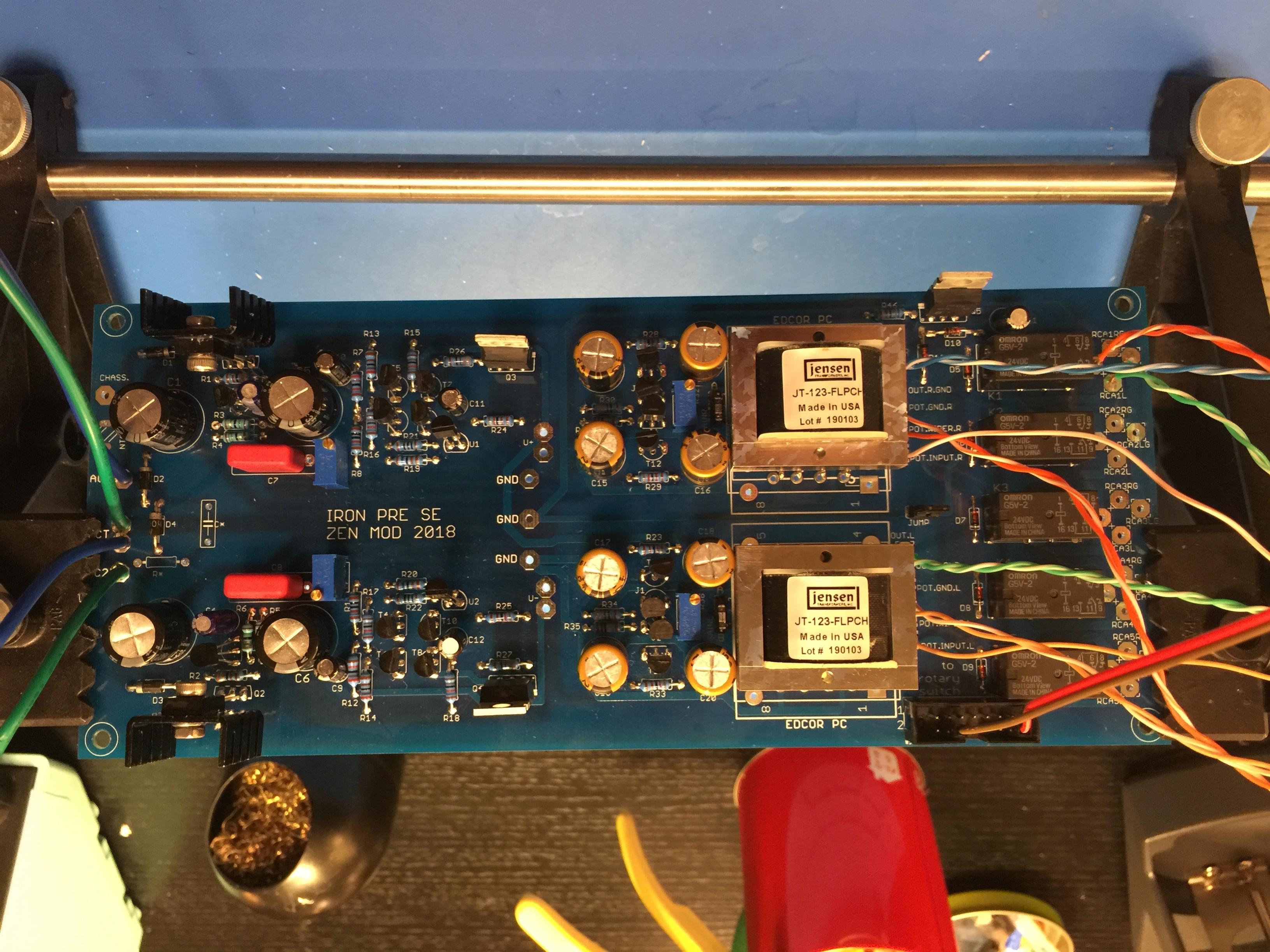

Hi ZM,
Reference to post #553 where is the SE/Bal switch(what is it labelled) on the PCB?
Thanks. nash
Thanks. nash

same principle as Iron Pumpkin ........
see here (post #3):Iron Pumpkin(s) and other smaller vegetable animals, Tips 'n' Tricks thread
So call it either Iron Pumpkin Bal or just Iron Pumpkin - it is not having SE in name .....
Also made of two mono channel pcbs , difference to SE being one more buffer, simply because it is needed for additional phase
Iron Turtle for balanced - each Metglas cored AVC having two bobbins (one per phase) , connected in pure differential mode (contrary to some other AVCs around , using one xformer per phase , so no possibility of intrinsic Supersymmetric operation of differential iron
additional relay (6-th) on channel pcb is for case that you want to use arbitrary number of SE inputs ; when SE input is chosen , additional relay is energized , so connection between negative buffer output and negative AVC coil is cut , ensuring that non-modulated negative buffer is not acting as virtual GND for its coil ...... which is now modulated from his twin - positive coil , thus we still have full balanced/differential output
set of schm/pics:................
Thanks for explaining. But how do I activate relay K6 to go SE? Cant seem to find that on the PCB or schematic. nash
to enable IN1 to be SE , solder DIN1
same way for any other input
everything is on schematics![]()

Solder in the corresponding DN# diode to get SE for the input selected
Now I get it.
Thanks. nash

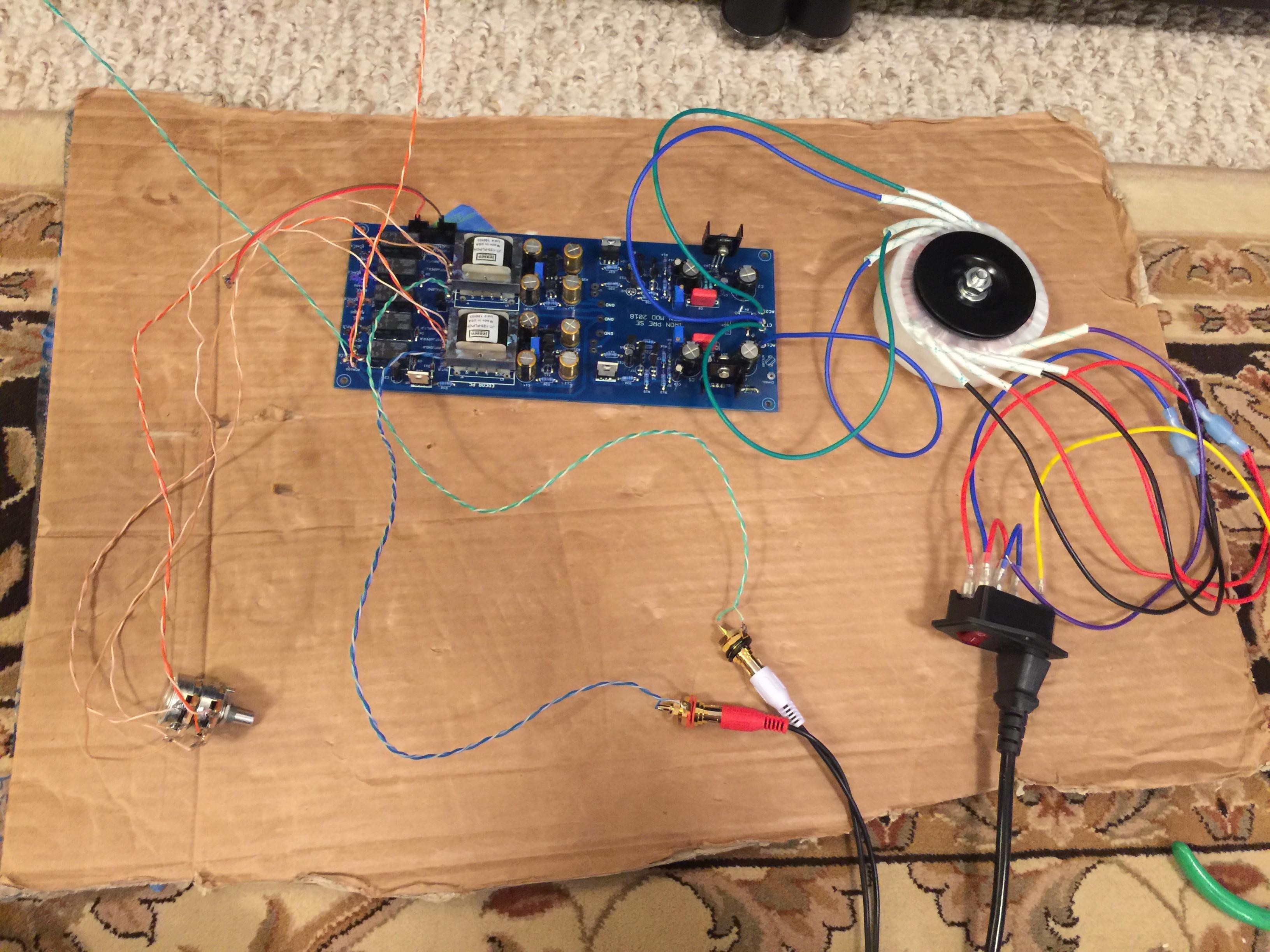

What follows is a wall-o-text with 100% subjective opinions re: the Iron Pre / Babelfish J2 combination.
I’ve had my Iron Pre (SE) / Babel J2 combination in my system for just over a week now. I swapped from a well-regarded commercial solid state pre-amp and my DIY F5. I had been using that combination for several weeks. Over some time, I had fiddled with the bias on the F5 in a number of controlled steps in an attempt to hear differences. With the F5, higher bias, seemed to improve the sound. I really like the F5 sound. For clarity, I have not attempted to alter H2 using P3 in my F5 build. That will come later after I get some proper test equipment. I rarely change two components at once, but in this case, I couldn’t resist.
The timing just worked out well. I received my Babel J2 boards right around the same time that Zen Mod and 6L6 were kind enough to allow me to build a set of the prototype boards for the Iron Pre. For those that don’t know – the Iron Pre is coming to the store!!! There will be balanced and SE versions. I am unsure of dates, but patience will be rewarded. I made two dodo errors. I was a little long with the iron and melted insulation between a twisted pair of output wires - that created an intermittent short. I also failed to push one of the gain jumpers fully into place. Other than that, the build went flawlessly. I can’t wait to get it into a chassis. I'll post some proper porn vs. the amateur shots previously shared once it's all done.
Thanks to the Mighty ZM for making these designs available, 6L6 for helping choose this incredible project, and of course to Papa.

What’s next - I’ll use the Iron Pre with other amps and the Babel J2 with other pre-amps in the future, but right now I’m just enjoying listening too much. My F5 boards lost their home to the Babel J2, so I may put the F5 boards back in another chassis just so I can compare single changes. When I get my SissySIT back from a friend, that will be my first comparison to the Babel J2 with the Iron Pre as a common denominator. After that, I’ll likely try the Aleph J with Iron Pre. I’m curious if there is such a thing as too much “sugar”. I also want to see which one brings the most “magic” and/or if the whole is greater than the sum of the two (or three if I include speakers) parts.
Back to listening.
