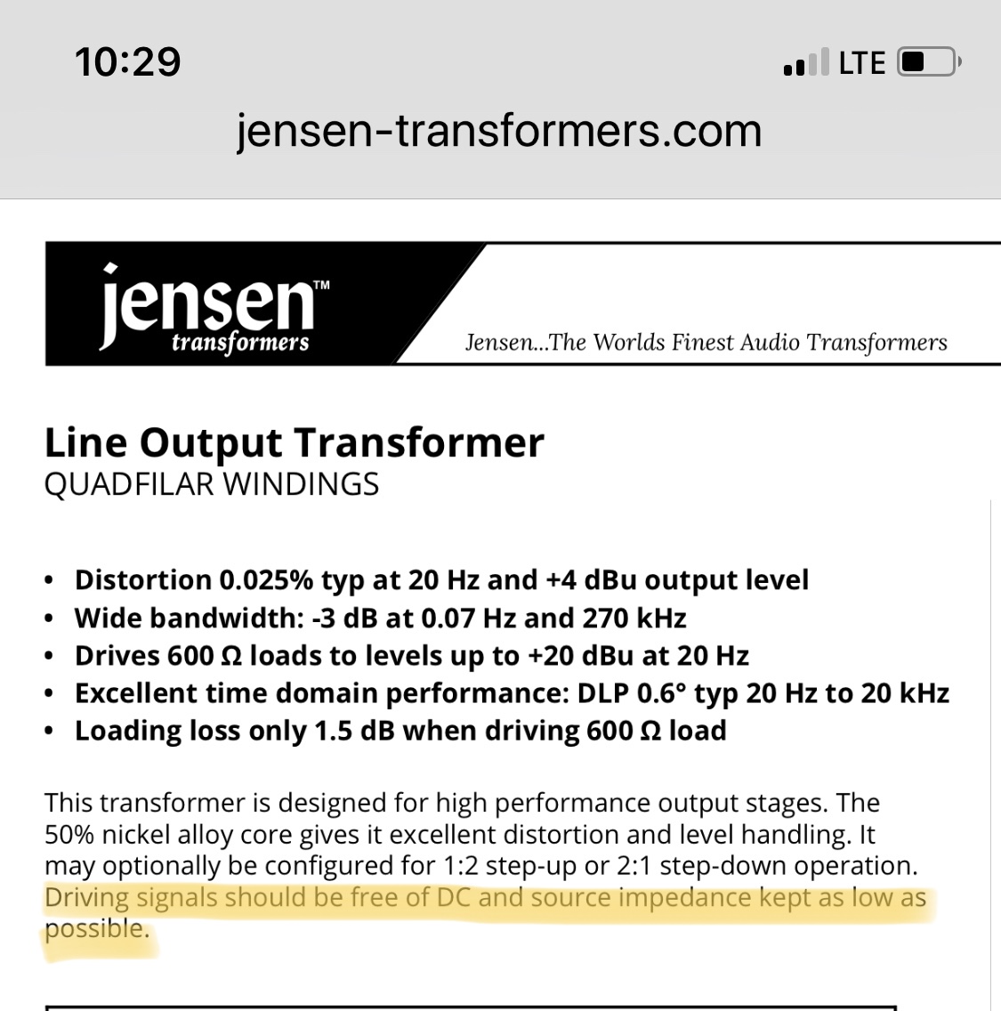

“I didn't even try a direct coupled B1 R2 because of trust issues when it comes to DC.“

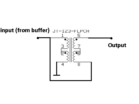

Hi Zen
I’m inside my DCB1 now sorting a few issues and adding some Jensen JT-123-FLPH to the output. Is the DC offset something I need to worry about with this circuit? I ask because the Jensen data sheet also mentions feeding them DC free signals (image).
I don’t remember what the offset on the output of the DCB1 was when I fired it up and tested it a few years ago. I don’t think it was anything to worry about, but I could test it again.
Should I be adding something like a 1uf coupling cap in series between the outputs of the DCB1 and the Jensen’s for safety?
I’m following your wiring guidance diagram for the Jensens. There is a slight discrepancy from the data sheet pin out diagram in that pins 2&3 and 6&7 are reversed from yours. I’m assuming it doesn’t matter as these pins are just linked in series in your diagram (image)?
Another thing I wanted to confirm with your diagram is that the “in” wiring to the Jensens is being run to pins 1&8 in parallel?
Also, should I just connect pin 4 to the output signal ground coming from the DCB1? I’m adding a safety ground to reference the DCB1 board to the chassis at the recommendation of its designer. I could link directly to that point instead. Not sure if it’s a good idea.
I'm most confused with this. I tried to straighten it out in the "Wayne's 2018 line stage" thread but never did. I was having DC, on fireup as much as 50 mV, after 45 mins or so settling to 3-1.1 mV. (once a smidge over 1 volt) I know the edcor in M2 is said to require no more than 5 mV to avoid saturation and other evils. I don't know if the DC on the linestage output reaches to the edcor in M2 but the notion makes me nervous.
I have heard of using DCB1 and transformer "simple kiss" style, but wondered about the DC on the output of DCB1 and its effect (if any) on M2.

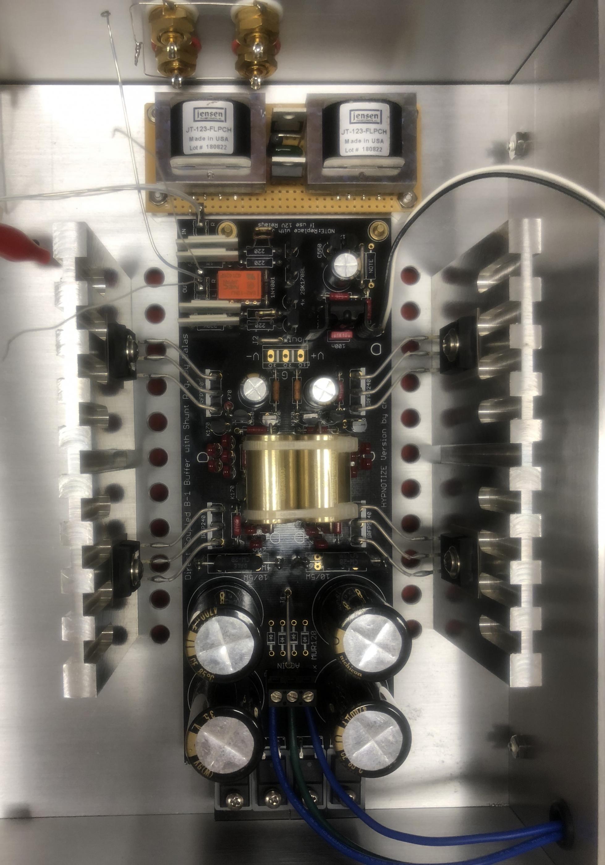

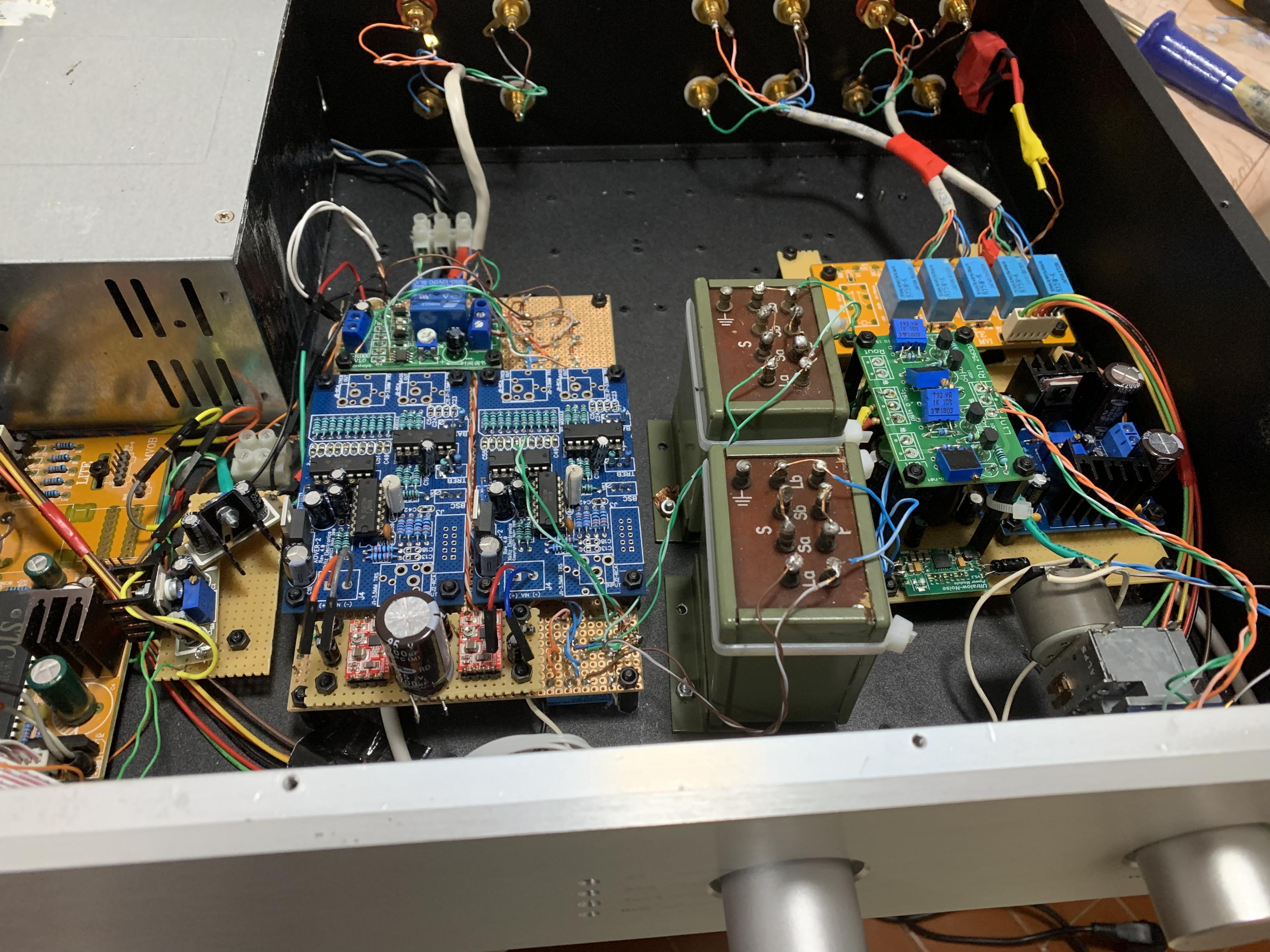

Spent some time yesterday and today making changes to my DCB1 as I could.
I pulled the 220 Ohm series resistors on the outputs and replaced them with jumpers in preparation for the Jensens.
I also decided to change out the current setting resistors I originally installed in the DCB1 to try running it a little hotter.
Afterward, I tested the DC offset several times over during start up, shut down, during warm up and after it had idled for over an hour. The worst offset I saw was -2mV while completely hot on one channel and a similar 2mV jump during several consecutive power cycles.
I’m not sure I’m where I want to be with the current as it only seems to be burning at about 300mA. I may try it as is before turning the heat up again.
In the mean time, I roughed out a perf board with stand offs to tuck in the chassis by the outputs and started mounting and wiring up the JT-123-FLPH along with some bits for a safe ground I want to install.

2mV is safe (more than) for autoformer
regarding burned heat in reg - once when you pass double Iq figure (Iq of stage fed with PSU) , if reg is made properly - everything above that is nothing else than ...... heat
example - Good Gemini is programmed for 60mA in case of Iron Pumpkin SE (20ma Iq) and 100mA for Iron Pumpkin (2 x 20mA Iq)

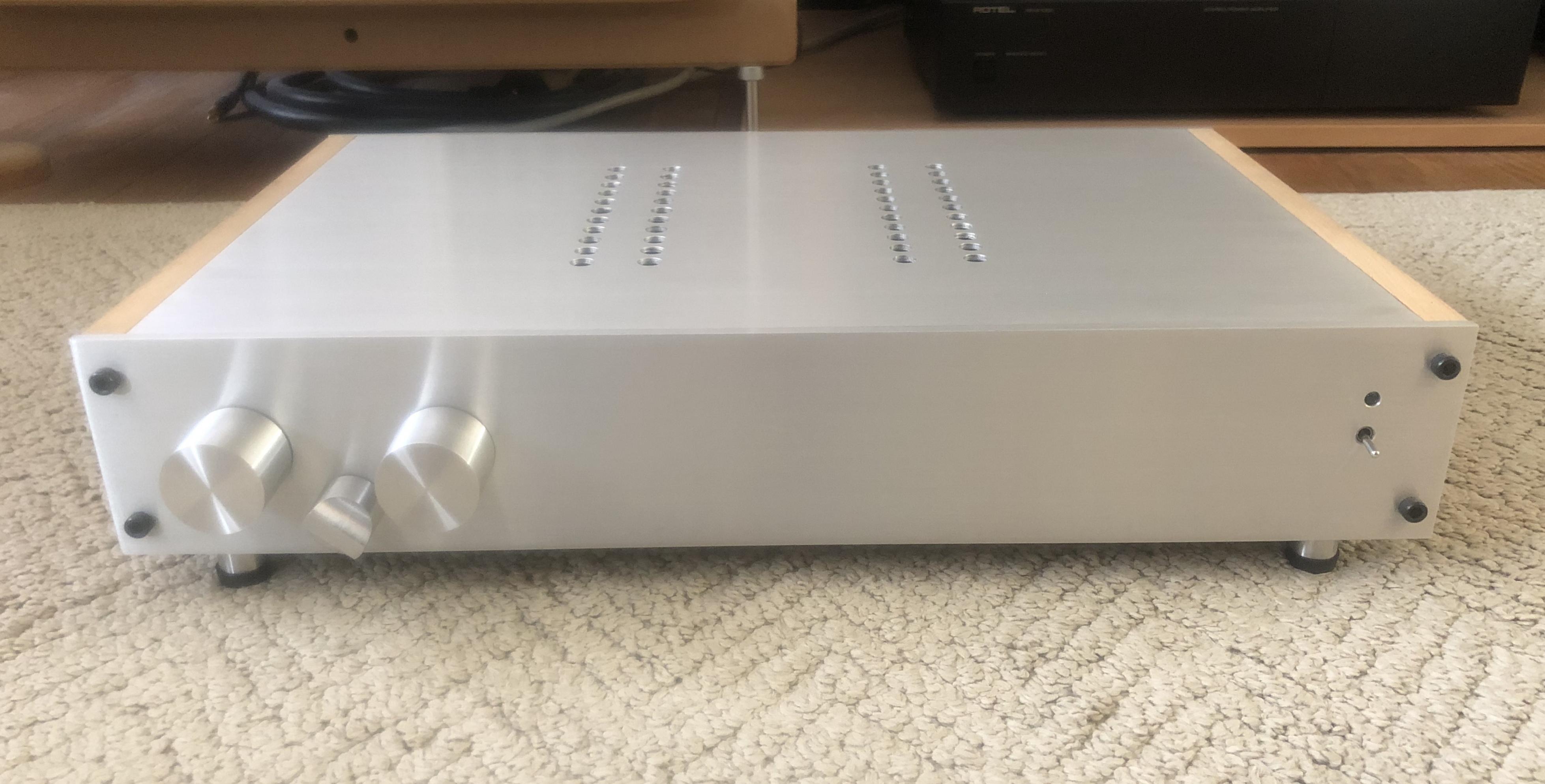

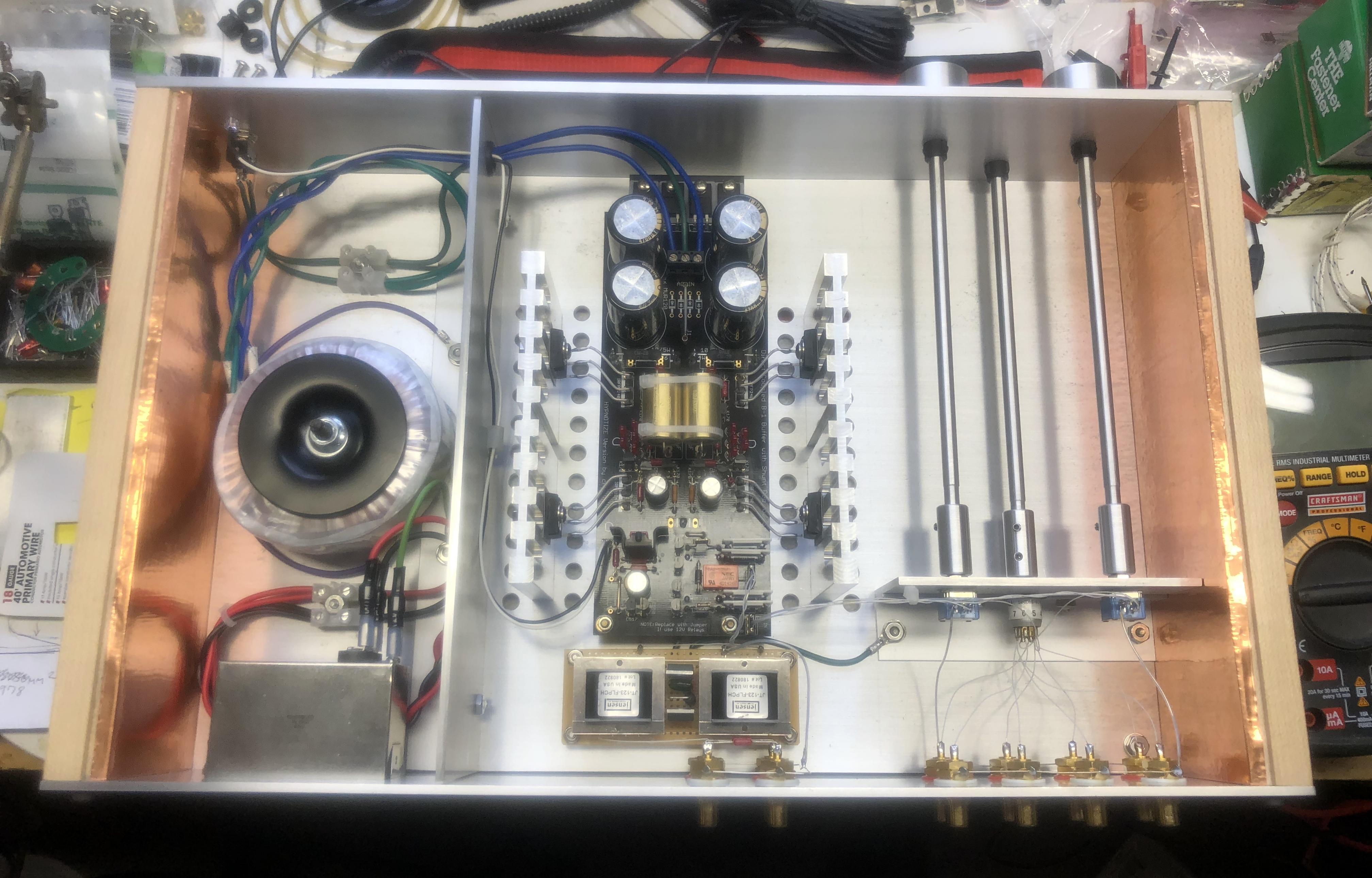

Just finished modifications to my DCB1 based preamp. Now its an IronDCB1.
Jensen’s tucked in the back in series with the outputs. Hopefully the 6dB of gain will help make my phono happier sounding.
I replaced the pots with some proper logarithmic NOS Clarostat units which I bought a batch of off eBay. I matched them for the highest impedance I could find out of 100 I had. My phono has an output impedance approaching 3K, so I figured any help I could find avoiding a mismatch problem I should take advantage of.
In cleaned up and shortened the signal wiring inputs.
Added a new safe ground that connects the circuit board’s central ground to the chassis and lifts it so is supposed to help with any ground loop issues.
I had to pull my fancy TX2575 series output resistors in order for the buffer to be able to drive the transformers, but the remaining other important resistors are all the same or similar quality.
I also adjusted the current setting resistors in the power supply to run it at higher current which is supposed to give me some sonic benefits like improved sound stage and blah blah blah.
Thanks for the advice on the power supply Zen. I was running it pretty cool and only increased it to about 300mA or so. Still not much heat generated, but I had the lid off and have been running it like that since I finished it a couple years ago.
I’d like to finish perforating the lid I made for it and finally put it in place, so I’ll have to monitor the heat build up. Hopefully it won’t be an issue as the entire core of the chassis is 1/8” aluminum plate and acts as an additional heat sink to the ones I made and installed.
Hope to fire it back up later and make sure the offset and heat still seems fine. Any other issues I should check before I try it in my system?

Just an update. My Iron-Hypo project appears to be successful.
There were no issues with heat or DC offset at all...actually the offset dropped to about 1.1mV on both channels once I completed all the final connections and retested it before hooking it up.
In my eagerness to give it a listen I had a less than ideal first experience. Part of it was that there was much distraction on the weekend going on about the house.
The first test was with my phono source. Honestly, it left me scratching my head and walking away a bit frustrated. I wasn’t sure things didn’t sound worse.
I was making these modifications with the goal of trying to help my phono source drive my system in a similar manner that I was capable of doing with my CD player. The difference between the two was big and the system sounded much more dynamic and alive with the CD source especially when I was listening to some of my favorite R&B recordings.
When I came back to the system a few days later I listened to it enough to evaluate how much more gain I appeared to have at my disposal.
The CD player had way more gain than it needed. Luckily, the NEC unit I had started using because my old Rotel died has a built in output level pot and I was able to dial it back to the middle of its range so that it seemed to work well with the preamp.

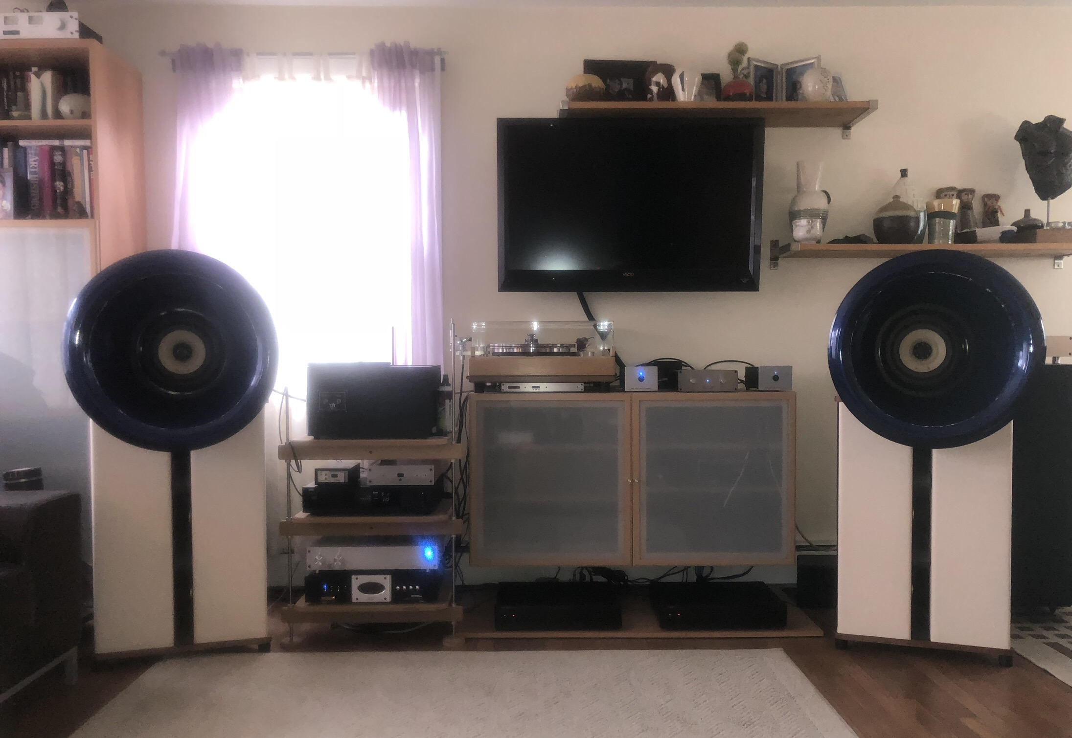

Below is a bit of a lousy picture from my phone made worse due to the light from the window behind and a pic of the preamp all buttoned up with a lid and everything for the first time.
I have Lowthers DX3 in the Oris Horns being driven by the humble little ACAs I built with some Semisouth slipped into Q1.
The dipole bass units are loaded with 6 each of those buyout 8” Peerless that Papa came across at Parts Express shortly after he produced the SLOB article. Some old bridged Rotel AV amps drive them.
Signals are managed by a B5.
LOL...in short: Preamp + Iron = 😀
