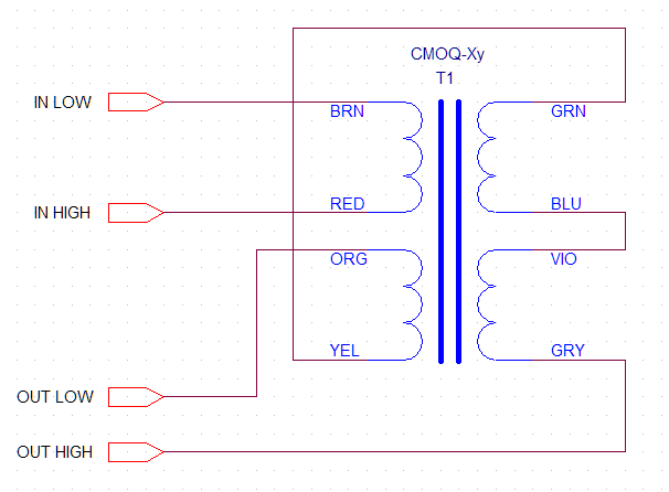

I checked it 1:3 as cinemag sugested and I get 2.77x gain!
Loose wire! Now its working 1:3 as stated by cinemag! Next stage has 100K input impedance its the M2 clone!
check again ...... without loose wire

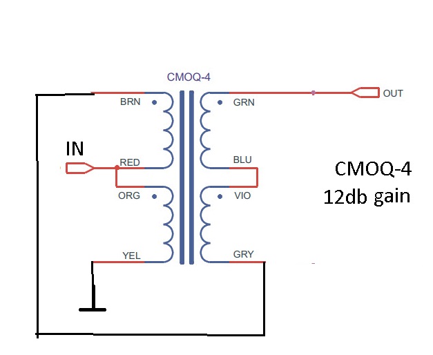

Guys I managed to configre the cmoq-4 for 1:4 autoformer test and it sounds wonderful! Cinemag propably send me a phase reversed sample so the colors in datasheet dont match the transformer! 🙂

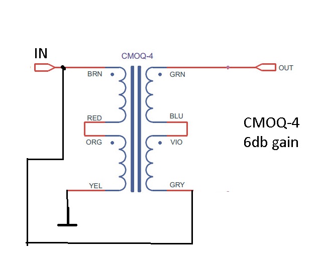

connected as autoformer , 1:1 is becoming 1+1 , having 2V/V gain , which is 6db
if you take 1:2 , it is becoming 1+2 , giving 3V/V gain , which is 9.5db
there is waste number of possible xformers ....... if you take 600CT:600CT , that's practically 4 windings of 150R (nominally) ......
you can use that one as 1:1+1+1 , resulting in 1+3 , having gain of 4V/V , which is 12db
and that's where I think you need to stop with gain , because Rout of entire shebang is really going up
