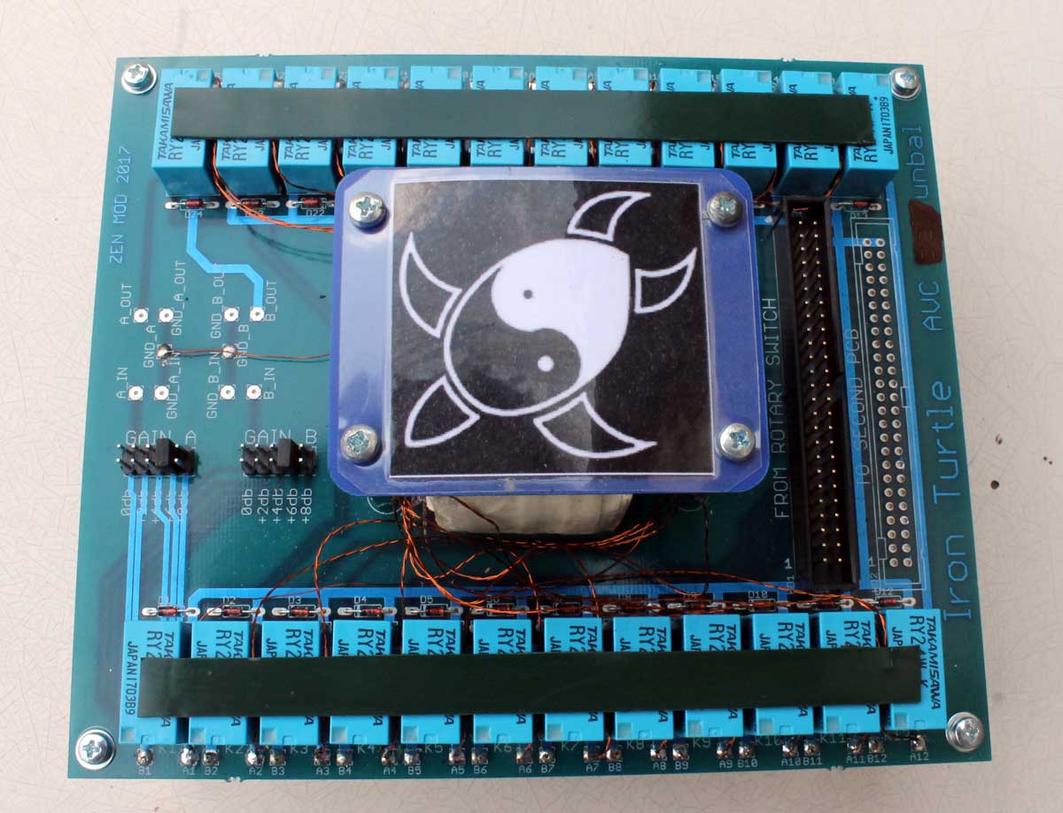

Very nice ZM!
Wow the balanced one is becoming high. No slim line cabinet.
Did you have a chance to listen to it?
( don't think so, there is no solder on the in-out pads :) )

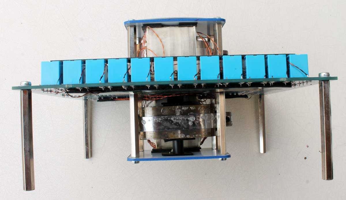

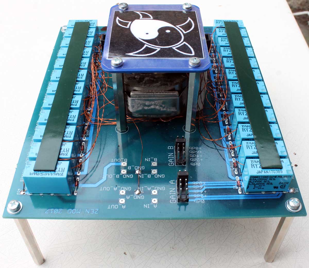

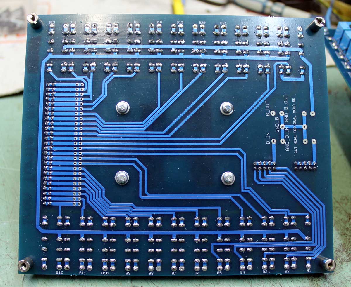

well , SE iteration is pcb sandwiched between two xformers , and can't be arranged differently , overall height is 95mm (so - take it or leave it , no slim boxes in my realm :rofl: )
I/we did extensive listening and comparative tests of SE iteration , before I had pcbs made ; with pcbs (read - relay signal switching , not silly rotary switch) , it can only be better , though I'm doubting that I can hear difference , at least as long contacts in silly rotary switch are still decent
few pics from today enclosed , for general amusement ( and maybe some info)

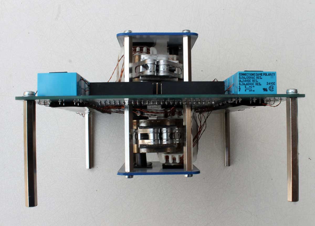

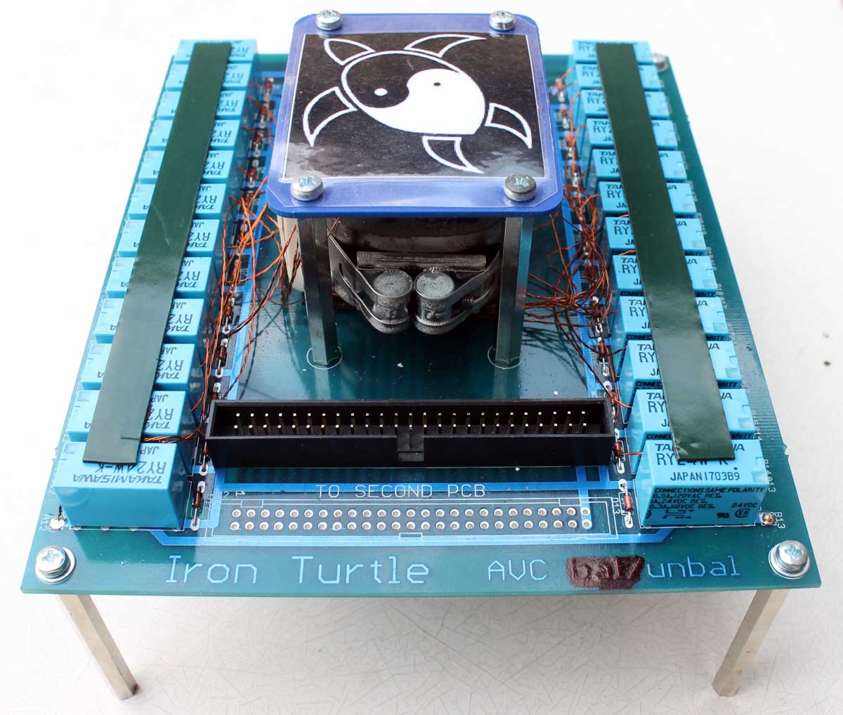

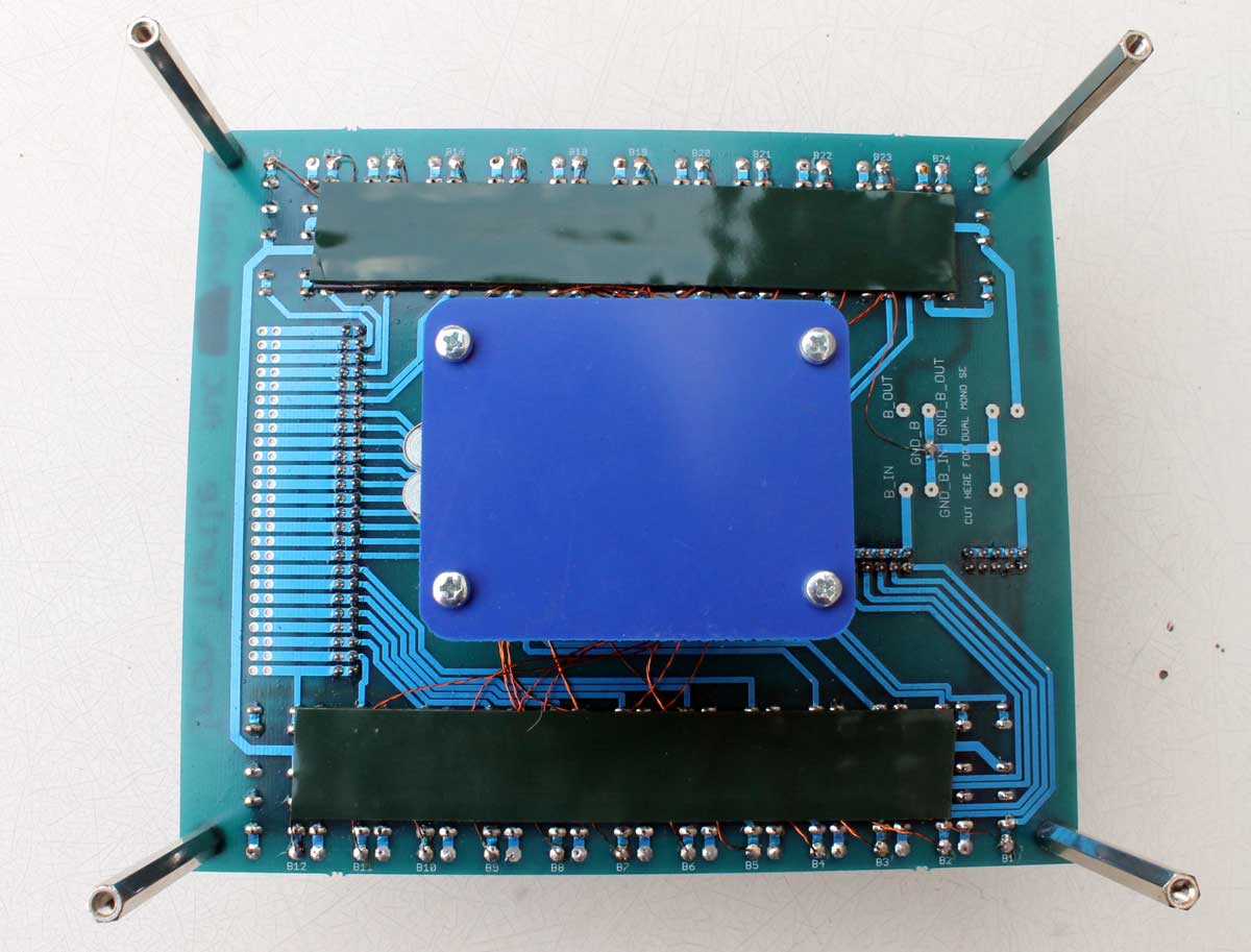

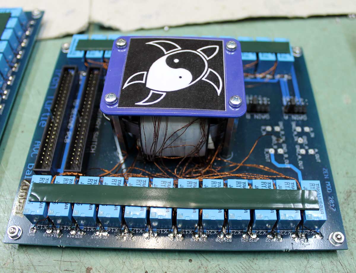

while SE is pcb sandwiched with two xformers , Bal iteration is one xformer per pcb , so two needed for stereo operation ; they can be mounted separately (each having height of ,say,55mm with bottom distancers) , or can be stacked one on top of another , with overall height of approx. 105mm
I did some listening tests of balanced iteration , hearing nothing worse than what I have heard with SE ...... :clown:

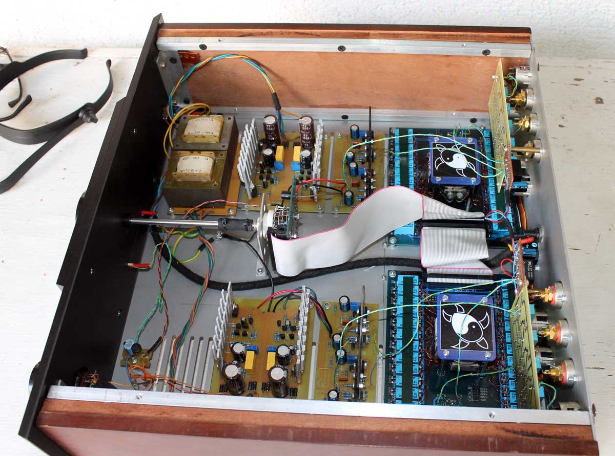

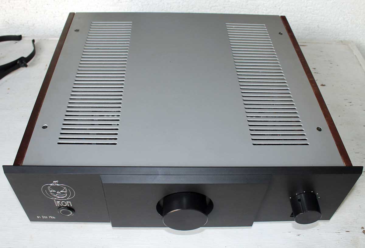

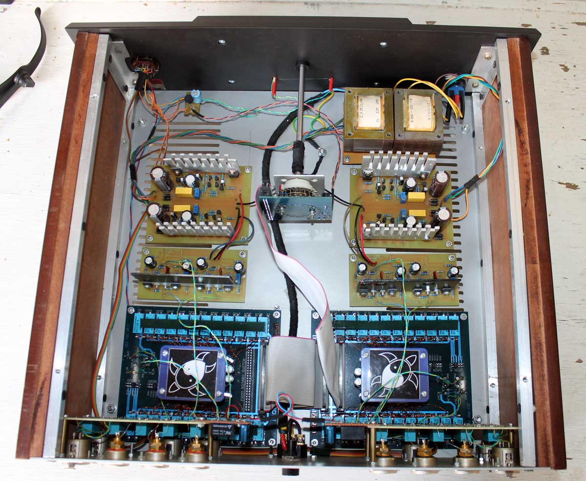

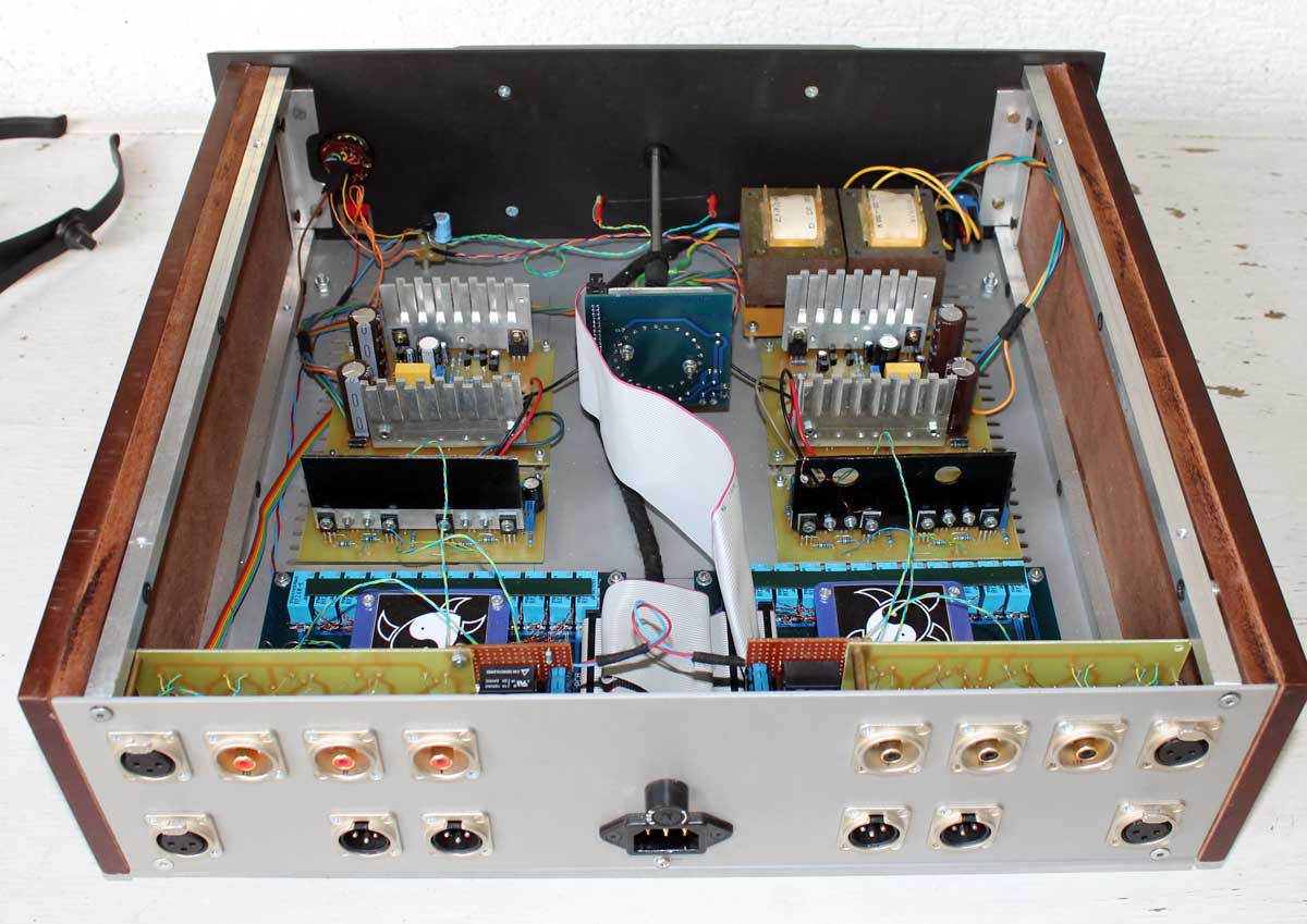

I just finished completing first Iron Pumpkin (developing) prototype with Turtle (bal) modules ..... and sent it to second pair of trusted ears
that IP proto is nothing else than all modules separately - Good Geminis (shunts) , Iron Pumpkin Diamond buffers , selectors and Iron Turtles ;
I had , prior to Turtles , plain pots after selector and simple autoformers on output ..... now - pot is tossed , and Turtles in place of autoformers ....

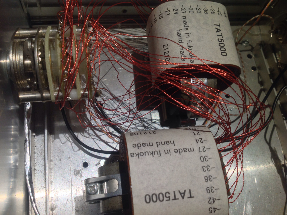

Jfet's buffer for AVC help please :)
My autoformer volume control is single unbalanced and totaly passive version.
I see interesting Zen Mod work and think about add jfet's buffer to my AVC.
Bunch of Toshiba and LSK pairs screams in drawer to be used.
Can be superb to try bufferised version now but i need kind experts who show me adequate schematic for that purpose.
Last news i get 2 more autoformers ( first pict ) so i can build full balanced version in the future.
Some thing cascoded for low impedance or not ?
Please bring me solutions :)

for proper balanced and differential , you need balanced autoformer
otherwise , you'll have sort of balanced , made of two SE
as buffer , just use what's known as Papa's B1 V.2 - Toshiba JFet complementary buffer , ....... also seen as input of M2 etc.
for full blast (well , more like cheapskate) iteration - see my solution from PSM LS Cook Book (link in sig)
