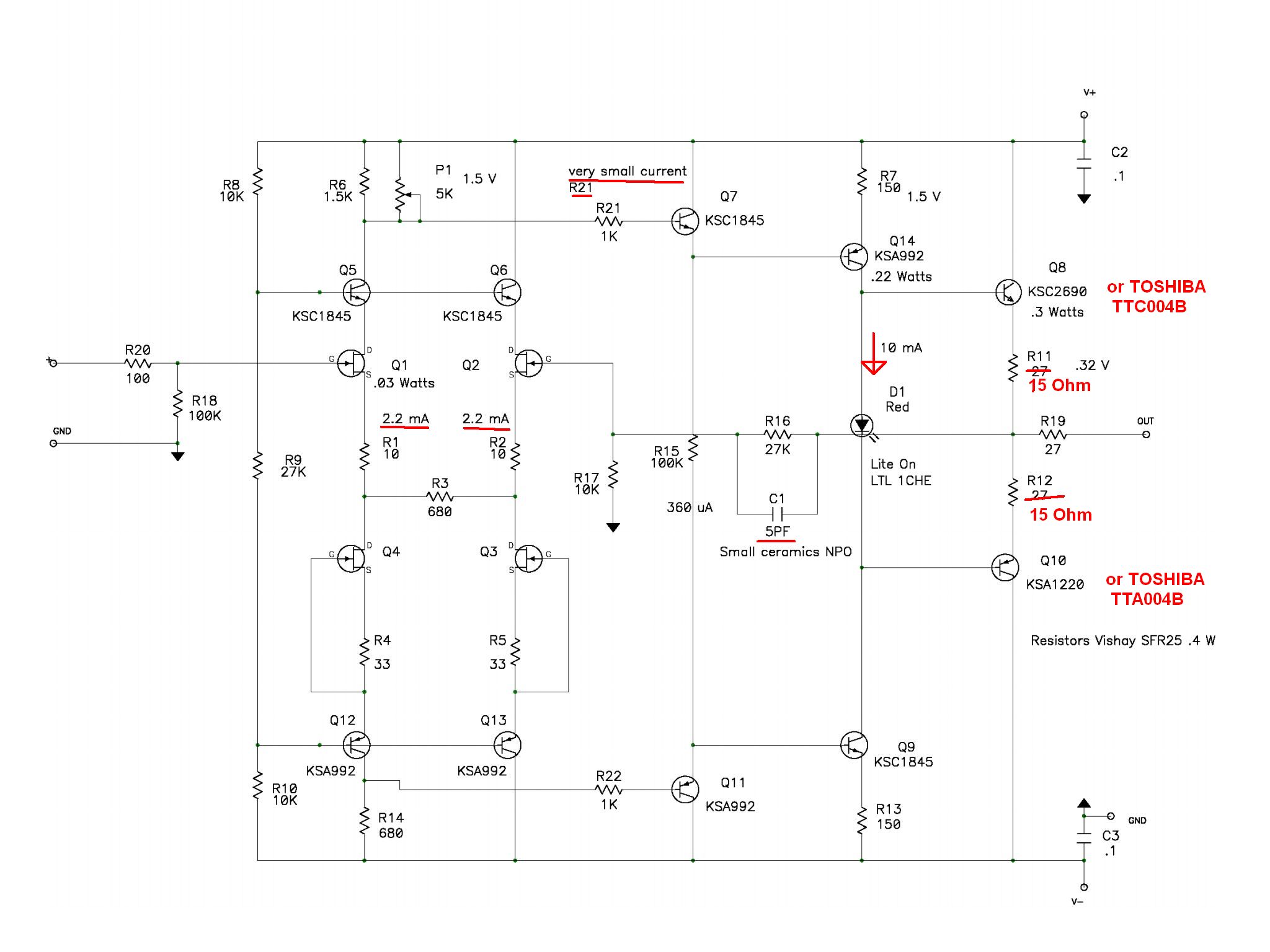

Hello e_fortier,
I hope this schematic helps... :idea:
Cheers
Dirk

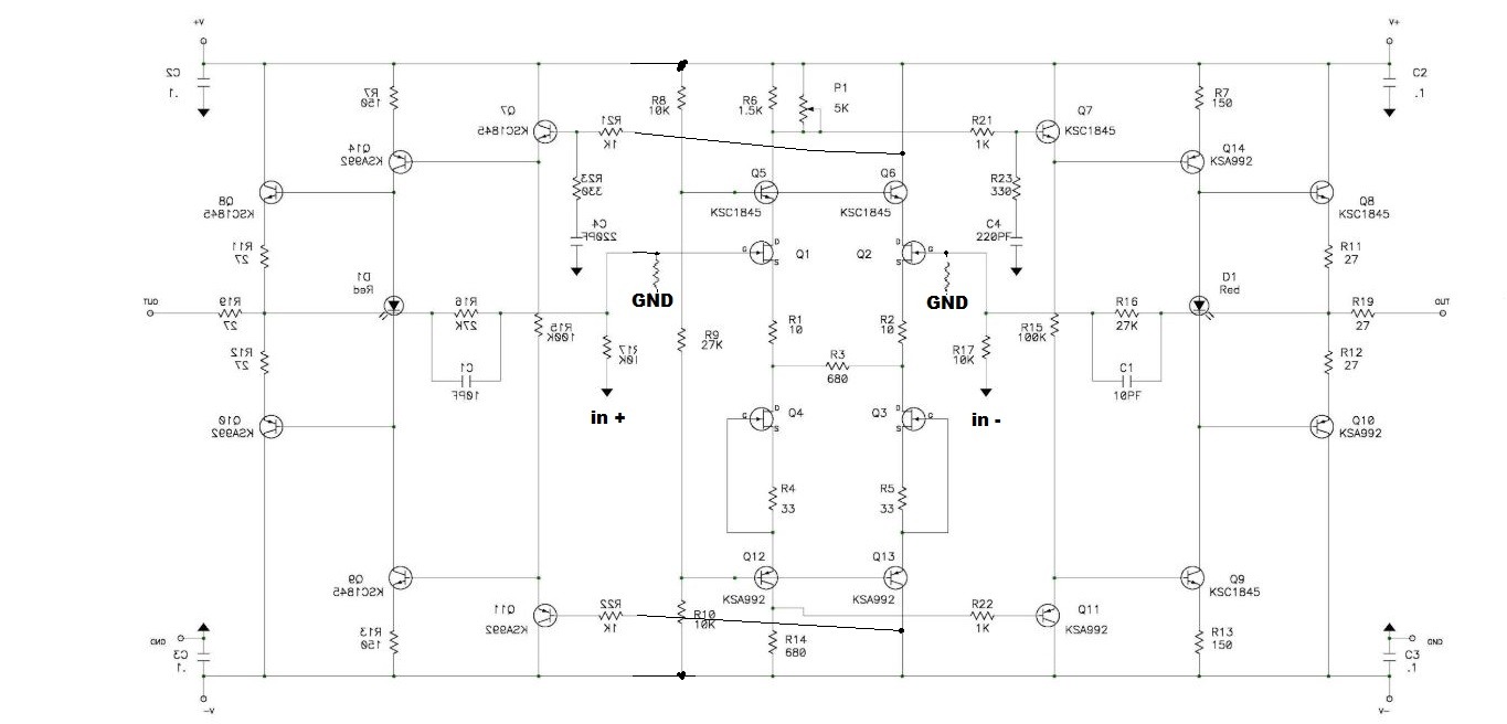

Hello toghether,
i`ve been thinking about, how to get bal in and out at this pre, without doubling the boards.
In this forum i do a little search but did not find something that fits.
So i do a little copy an paste, how i thought this could work.
I`am not really sure this will work + understandig of feedback resistors, for gain setting is limited.
Will copying them to the other side will affect the gain of the whole amp?
Or will gain stay the same?
And what to do with the Resistance to ground at input. I think this will be needed for high input impedance and a path to ground at input.
If someone has suggestions, be welcome
greets Alex

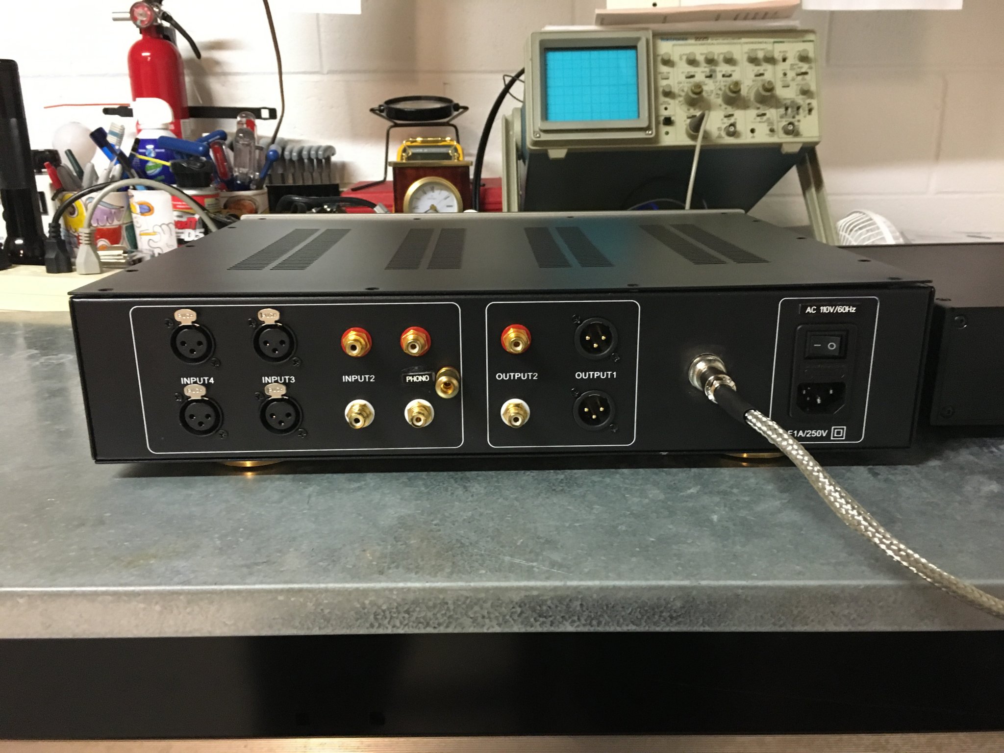

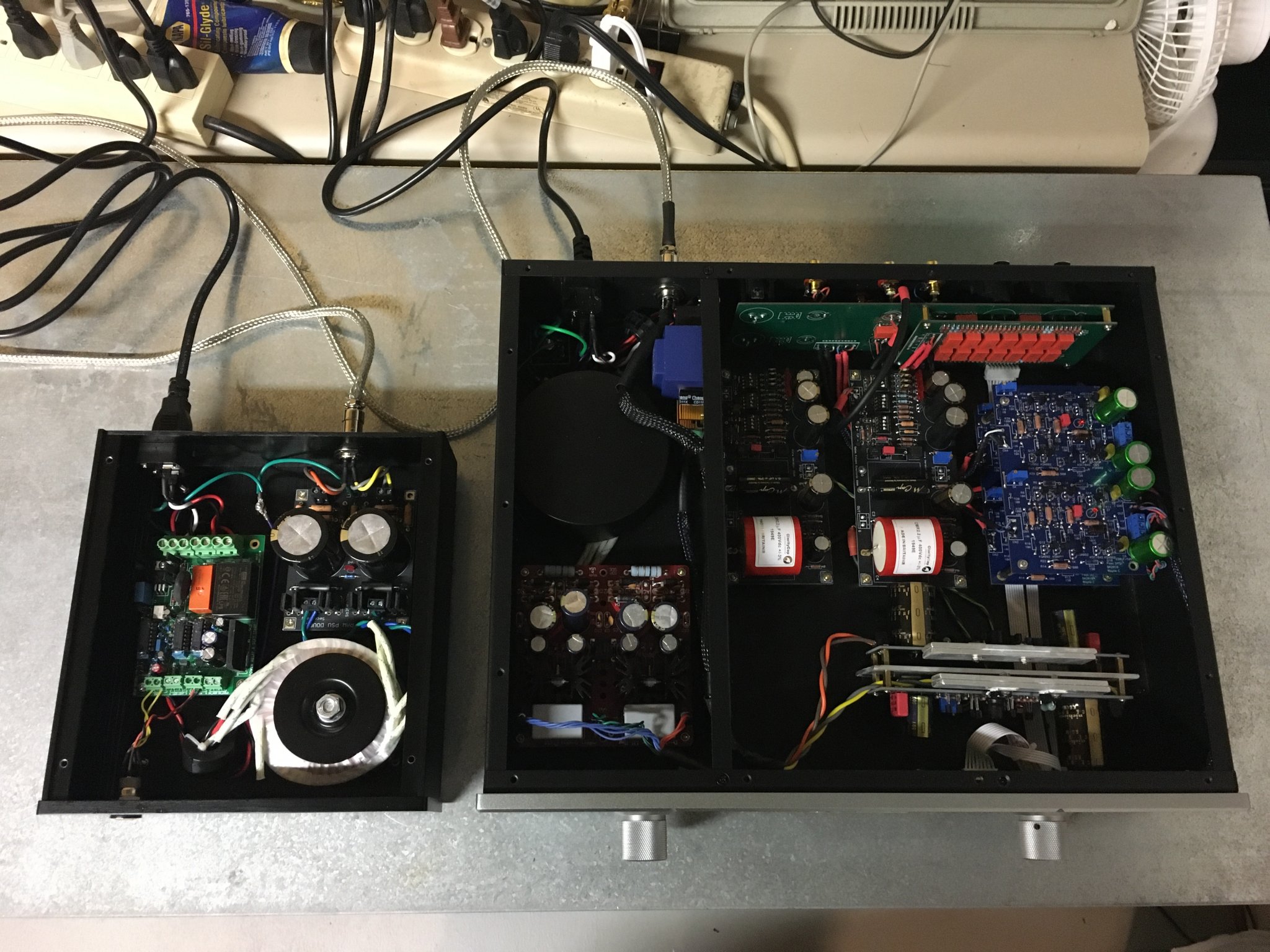

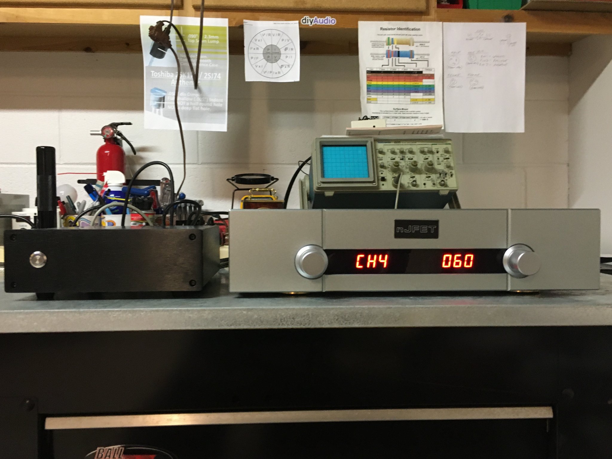

The BA2018 boards are on the right side of the pic, it has a Salas UFSP phono section which takes up most of the room in the enclosure. The power supply for the UFSP is seperate, and the BA2018 power supply along with the supply for the remote, relay operated selector and volume control is on the left side of the enclosure. My first build with a remote, the amp is an ALEPH J.

Bigger better, or more Iq makes this version of the OS better. Or my cables need the extra drive. Or a ton of other variables come into play. Dunno. Just sounds more liquid 🙂 the version with big outputs have more than double the bias/Iq. Plus a bit simpler circuit/less parts.
Theres another version of this circuit besides the one posted on post #1? I thought the bigger outputs just meant different transistors minus any circuit change. If theres a simpler version than the first post id like to know
Andy talk about the official version, which comes in 2 variants:
1) smaller transistors/more parts (what, one or two items)
2) bigger transistors/fewer parts.
Both are on the same pcb, and are equally challenging/easypeasy to build…
Then there’s the forum‘s hacks, like zm, who just can’t resist the itch to hack everything😉
