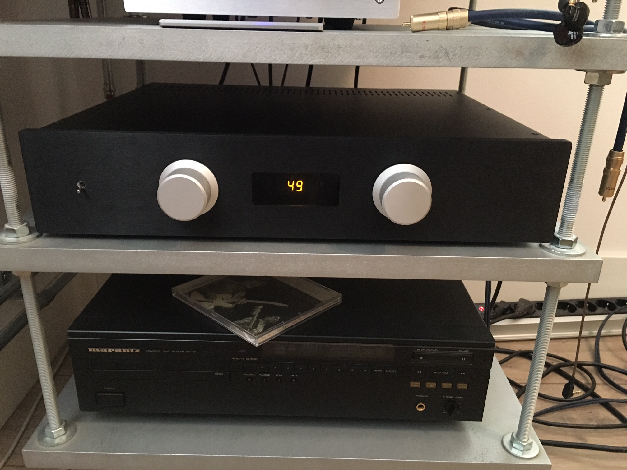

Wayne's BA 2018 linestage
The final result of my Wayne BA2018. Maybe I will put in a phonostage later…
