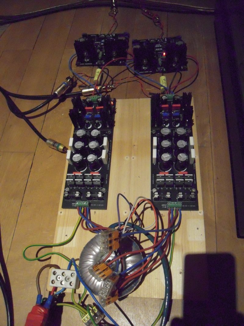

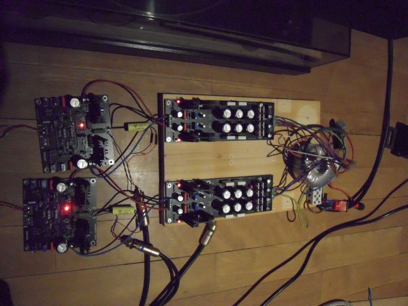

I made my own pcbs with slightly more space - easier to measure.
Exchanged the TOSHIBA 2SK209 with ONSEMI 2SK3557-6-TB-E. Had to adjust a few resistor values -
more current to those tiny JFets. Running at slightly above 34° C.
Exchanged the Fairchilds KSA992/KSC1845 with ZETEX ZTX851/951. Running at 35° - 37°C.
Outputtransistors are TOSHIBA TTA/TTC004B. Running at 29° C. Perhaps room for more bias...

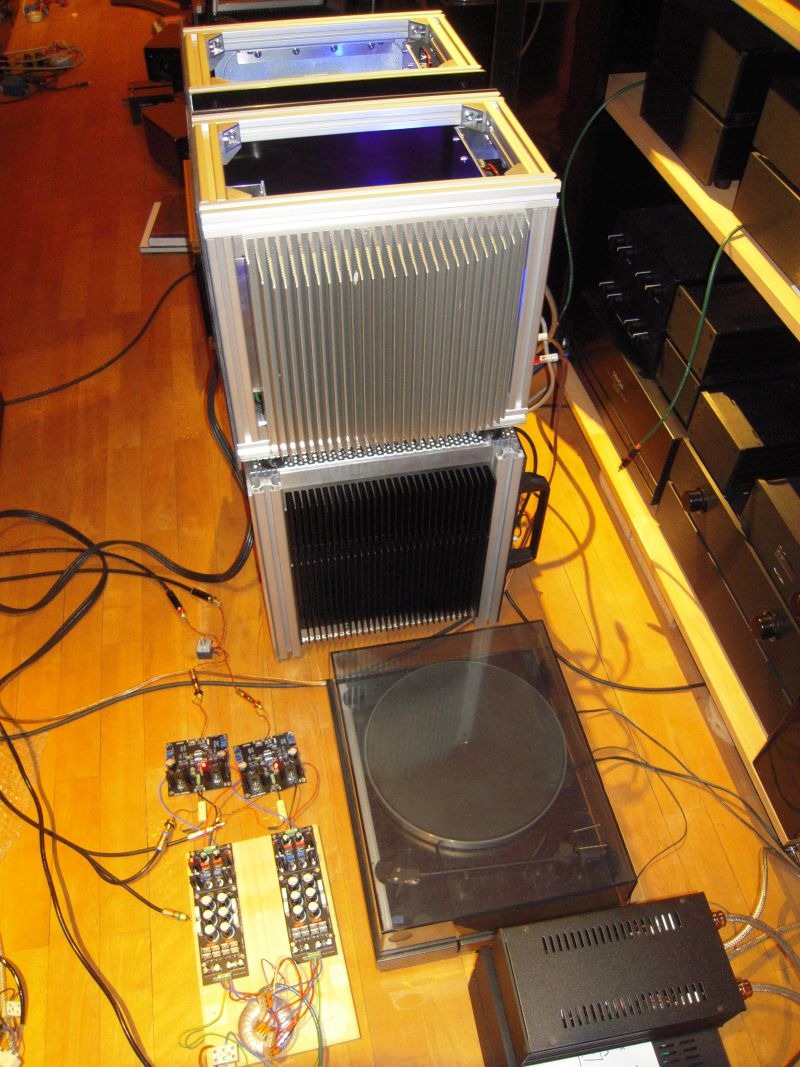

I have some hum. But no wonder with those wild cabling for testing. And the preamp/PSU is on the wood board.
The sound is great with my IXYS-Mosfet-monoblocks.
I am listening... 🎼🎧

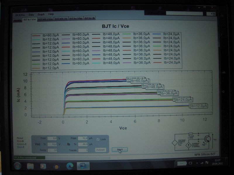

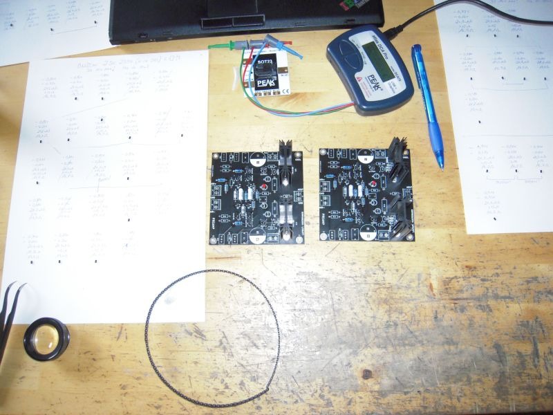

this time I use another very low noise JFet, the ONSEMI 2SK2394 (Q1-Q4). It has lower noise than the BF862.
Matched those tiny JFets.
And matched the BJTs in the other stages. So I will see how it sounds. Have to solder a little bit....
