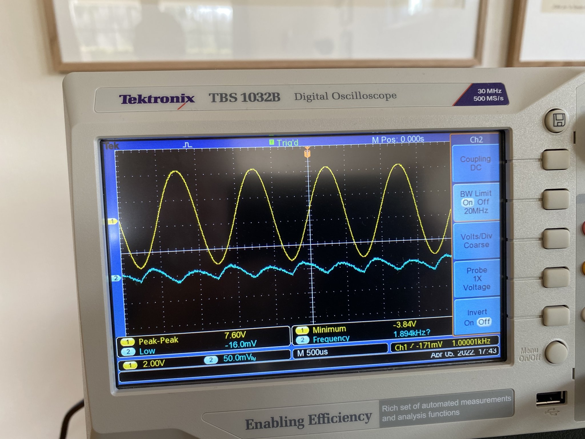

sine is not perfect, but parts aren’t matched so maybe OK?
does this look right, friends?

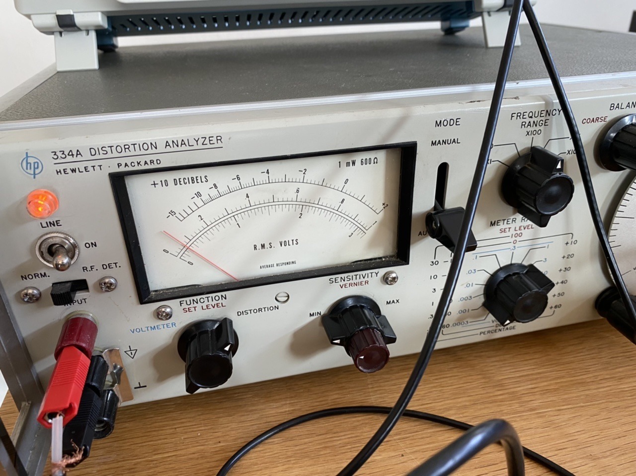

I misread. Recalculations show 0.09%. Might that be correct? Will spend some more time on this
I have read up a bit, printed the manual. The copyright on this thing is from 1966! Impressive, old stuff working like a charm.
the manual says that a 0.4 reading on the 1 percent scale, means 0.4 percent distortion. If read correctly (on the correct lines and dots), my WLS shows .35 on the .3 percent scale. That would be 0.105% distortion.
have adjusted the meter, and will redo step by step following the manual 🙂
once I dial this in, I will measure both the ACP+ and J Zen 🙂
Andy

As planned I got to remeasuring today, with a cleaner sine too, following manual.
end result is 0.081% distortion. Very happy with that. Single ended, 7db gain.
reconfirming neg phase 2hd, affirms my suspicions as to why it sounds so good with my Aleph J Zen. The J was measured to redicilously low levels of distortion @ 1 watt output today, approx 0.15 percent. Neg phase that too 🙂 But need to redo those measurements.
btw, preamp noise under 300uV measured at the outputs. Completely independent of shorting input or not. And a noise environment for the probes. Very nice 🙂

In fact, I read in the manual now, the 334A measures down to 0.1%. And today, measuring the WLS, I ran out of range on the sensitivity scale. Meaning distortion is probably even lower.I never measured that J iteration, but 0.15%@1W seems too high
so is my equipment bad, or the WLS and J just too damn good?
