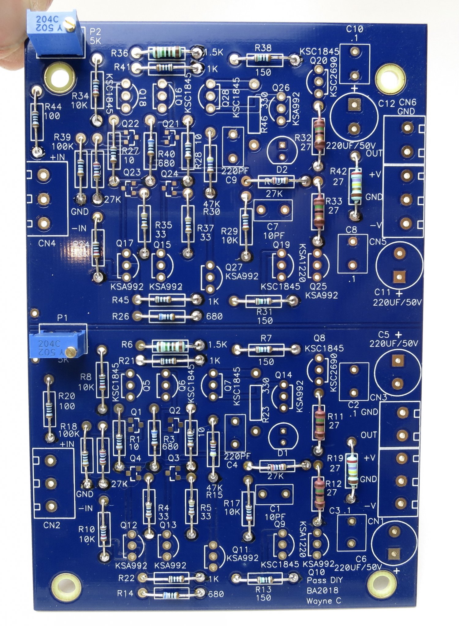

I've built three BA2018s and had forgotten that the one with a SRPS was built with a dual-mono, split-able BA board I got from forum member IckyB. Also, the SRPS board is a layout I did myself, taken from schematic V2.3 with an added on-board transformer, rectifier/filtering circuit and power LED connection. So the attached photo may not be much help. It's also possibly the densest chassis build I have done.
For what it is worth, the SRPS ICs (just barely visible at the far left) are AD825 and there is a 0.01uF bypass cap connected between the SRPS ground and chassis ground. Ref voltage is 6.9V and R15/25 (R6/13 on V2.3 schematic) is 1.5K ohms, providing around +/-18V at the regulator outputs.
The IckyB board (not split into 2 pcs) has power connections on the outside edges and also in the middle where the two circuits are divided by the score line. I connected DC power to both channel edges on separate home runs and the sense wires to the board middle and jumpered across the split line. All the power and sense home runs are twisted pairs.
Schematic and parts list for my V1.0 SRPS is attached for reference. The IckyB boards follow Wayne's schematic but not his layout.

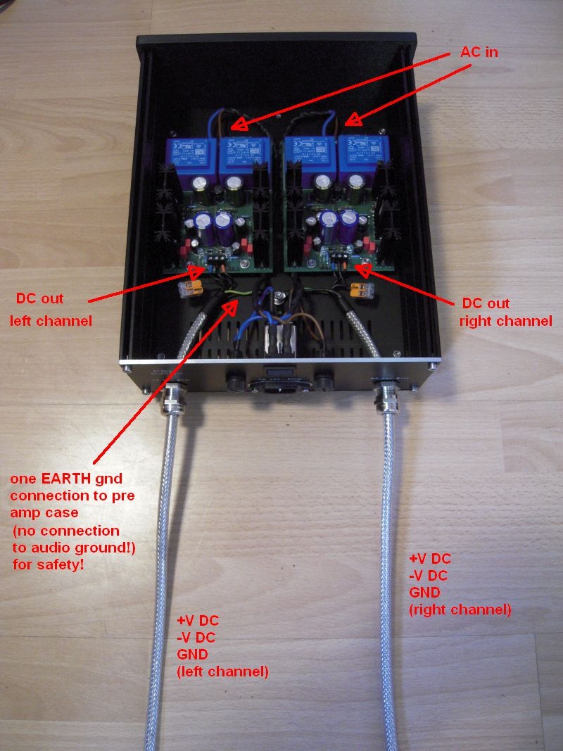

Hello members,
I am also playing around with Waynes Line Stage.

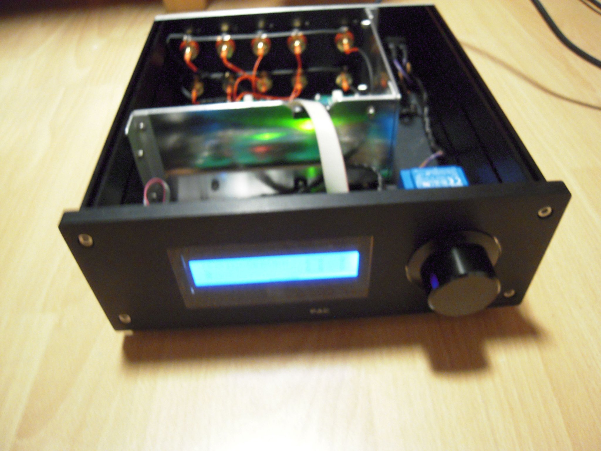

I made two builds of the original boards from the diyAudiostore. I used bigger output BJTs (Toshiba TTA/TTC004A). Why? Because it is also an excellent Headphonamp...

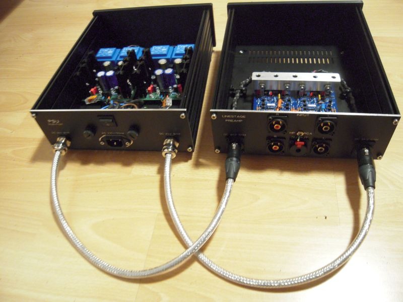

I 've built mine in three cases:
-PSU (each channel has its own PSU - dual mono)
-preamp
- one case with inputs switching and volume control.
I did this to have a modular system. I can use the 'PAC' (Pre Amp Controller) for other preamp projects.

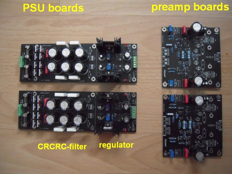

At the moment I make my own PSU boards. CRCRC-filter with following regulator. I used AnalogDevices
LT1085/LT1033 (or LM317/LM337). Via potentiometer I can adjust +-V DC out from PSU in a very wide range.
I want to play with different transistors in Waynes Line Stage. Not that I think I can do better than Wayne!
For sure not. But I am curious.
I made one board with the Onsemi Jfets '2SK3557' (instead of the Toshiba 2SK209). But the onsemis have a much lower Vmax than the Toshibas. Instead of the fairchild KSA992/KSC1845 I used ZTX851/951. This project is still in progress... Don't ask me how it sounds.
So, have fun with Waynes Line Stage - it is an excellent preamp and headphoneamp!
Cheers
Dirk 😉

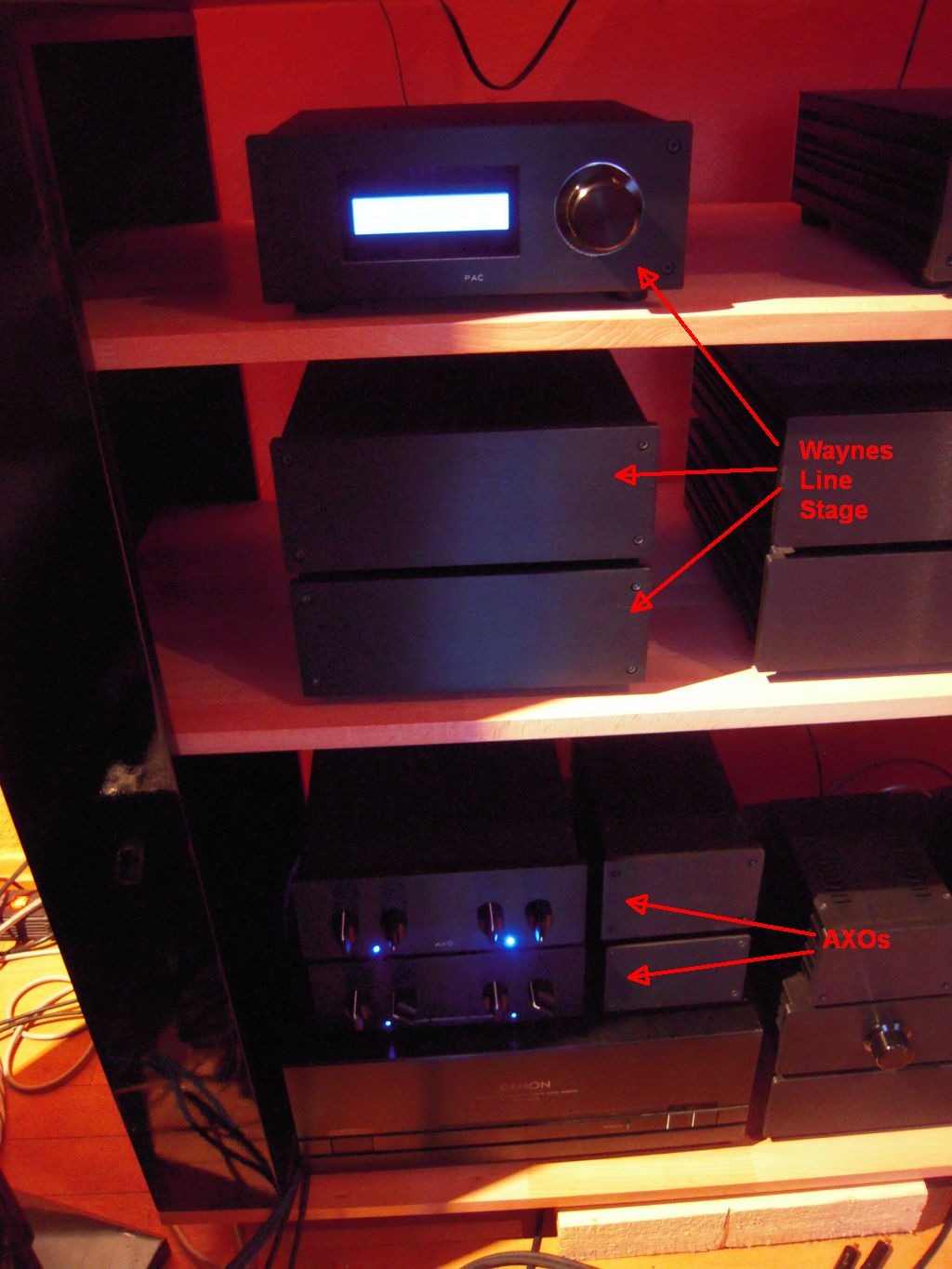

Hello myleftear,
I don't want to make anybody jealous.
Waynes Line Stage is a fantastic preamp as it is. Everybody of us 'greedy boyz' can build one.
My first try was built on the wooden board with a simple PSU, the official board from the store
and an ALPS-pot at the input. No input switcher.
And then I listened and was surprised...
Have a nice weekend
Dirk 😉

Hello mhenschel,
locating the regulator close to the preamp-pcb is a good idea. Sometimes you have to make
compromises...
Using a CRCRC-filter is for me always combined with testing. I often solder the Rs that way in, that they are
easily desolderable. On the other hand we have the rule of thumb, that the AC sec. voltage at your transformer multiplied with a factor of 1.3 to 1.4 will be your DC voltage after the rectification and CRCRC-filter. A nice tool is Duncan's PSU Designer 2.
https://www.duncanamps.com/psud2/
If I use a transformer with 2 x 24 V AC sec. I assume that after the rectifier and CRCRC-filter I will be anywhere around 31 V DC to 34 V DC. You can adjust this with different R-values = burn some voltage. And the combination of C-values and R-values is also important for filter-characteristics. In Germany we have
230 V AC / 50 Hz AC mains voltage. So it would be nice to filter the 50 Hz-hum and its multiples (100 Hz,...)
as good as possible away.
I prefer to go pretty high - or lets say minimum 4-5V over my target-voltage and then I regulate down.
For me the limit is the Vmax at input of the regulators (or deltaVmax for the regulators). And I also look
at the heat dissipation. It makes no sense if your target-voltage would be 12 V DC and you have 34V after the CRCRC-filter and you burn 22V away. Only some thoughts.
Cheers
Dirk 🙂

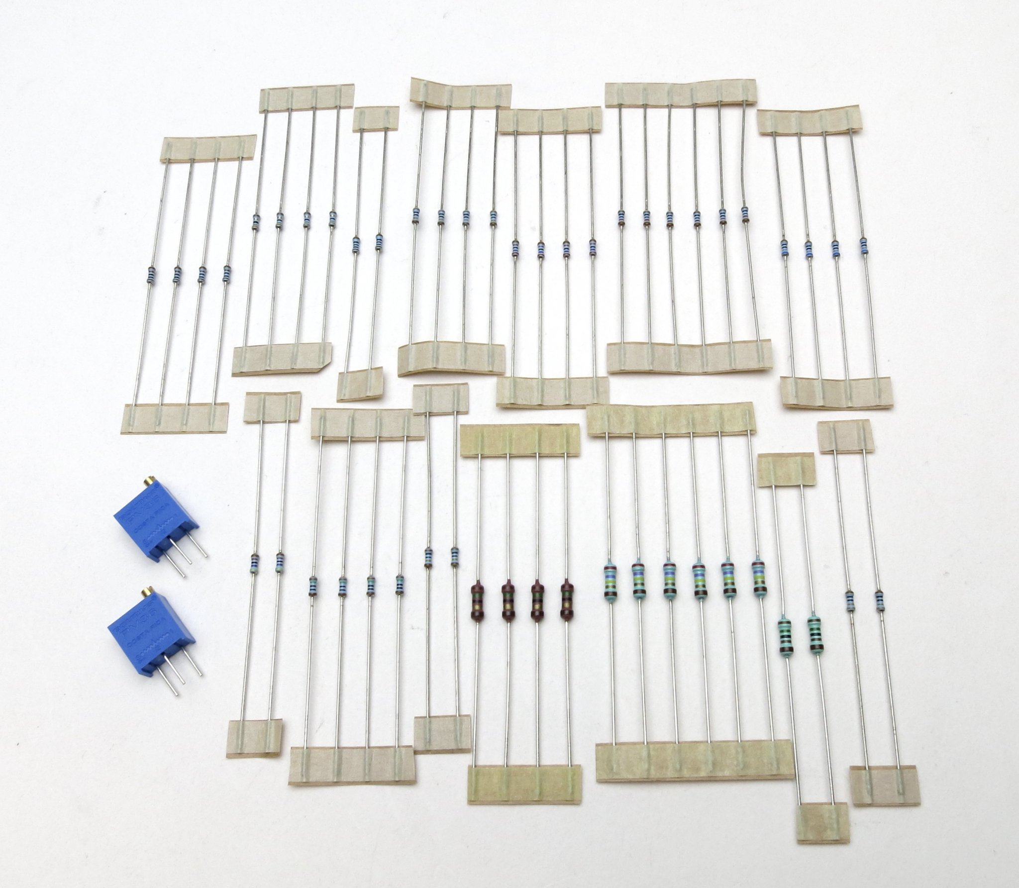

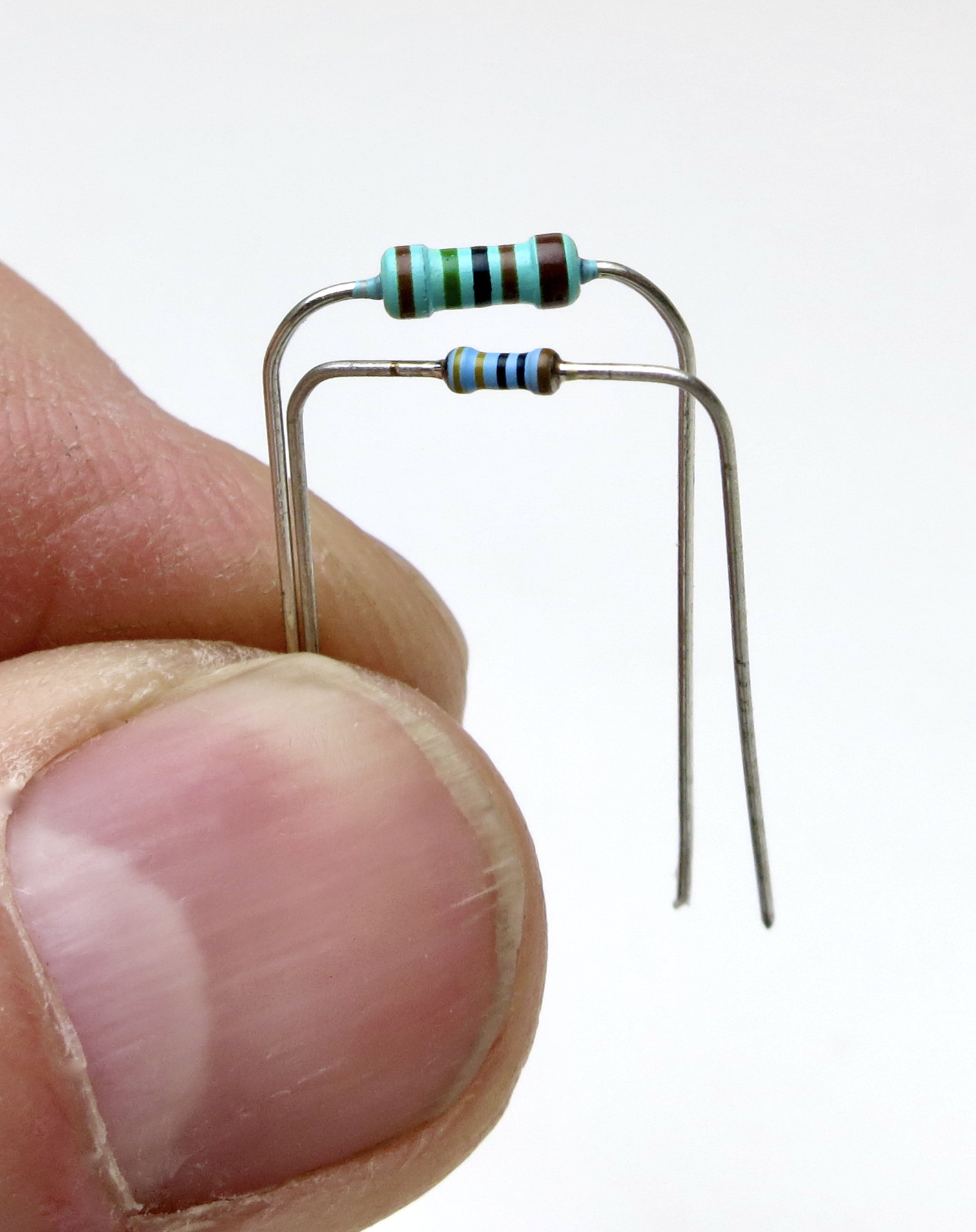

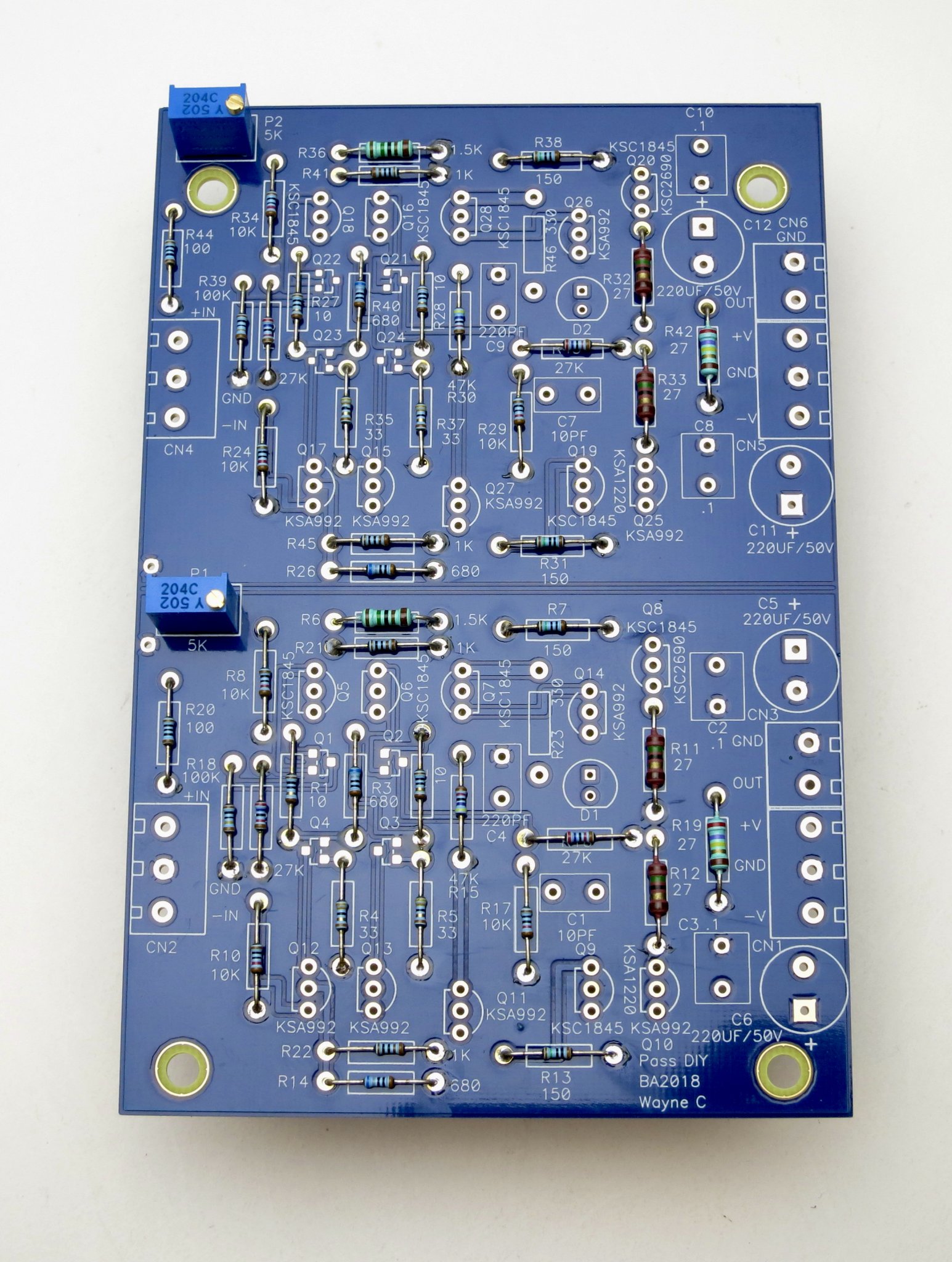

The most recent batch of parts kits contains the very nice, but very small, premium, European-made, Vishay MBA series resistors. Albeit a small package, these are ceramic bodied and 0.4W (almost 1/2W) max dissipation, and we are using them in lieu of the more common 1/4W (0.25W).
The body size is comparable to an old 1/10W (0.1W) or maybe even smaller. Some people may erroneously think they are 1/10w resistors and we are being cheap, nothing could be further from the truth. The parts available in the current electronics reality require trying some neat and nifty new things. They work perfectly and sound fantastic. Will the (very easy to read, which is why I prefer them,) Dale RN-series ever be available again from distributorship in the quantities we need at a price than isn't fully ridiculous? I'm not holding my breath, and published lead times are increasing. This is true of a LOT of various parts, the supply chain is genuinely messed up.
The “large” resistors in the photos are normal-sized 1/4W (although the brown ones are 0.4W…)
Please note that the PCB shown stuffed is setup for using the “big” output transistors, where R11,12, 32, 33 are 15ohm, and R23, 46 are omitted.
Also worth note, in this most recent 'big' transistors are the fantastic Toshiba TTA004B/TTC004B. Genuine, in-production Toshiba through hole transistors. Sometimes there really is a silver lining. 🙂

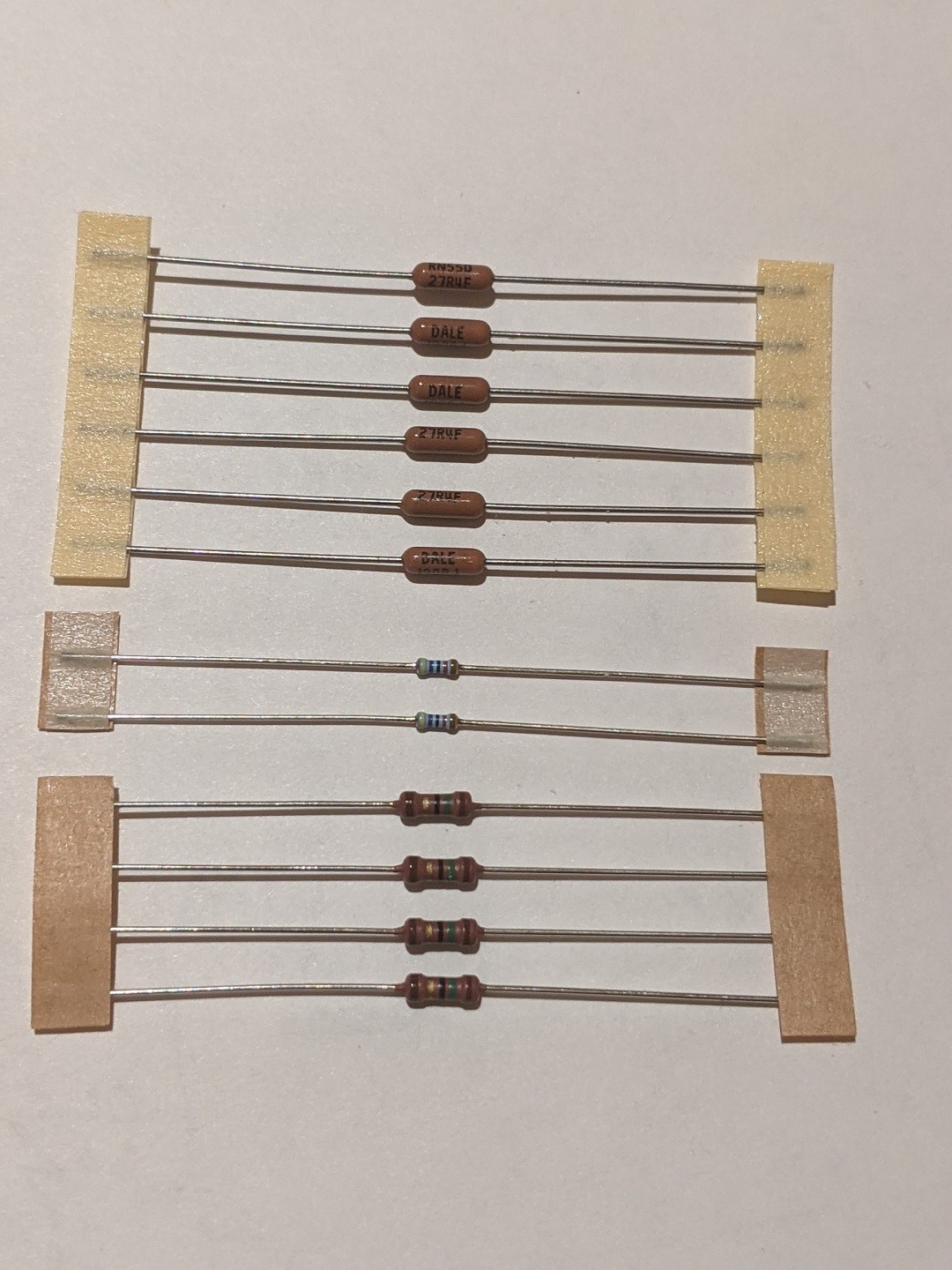

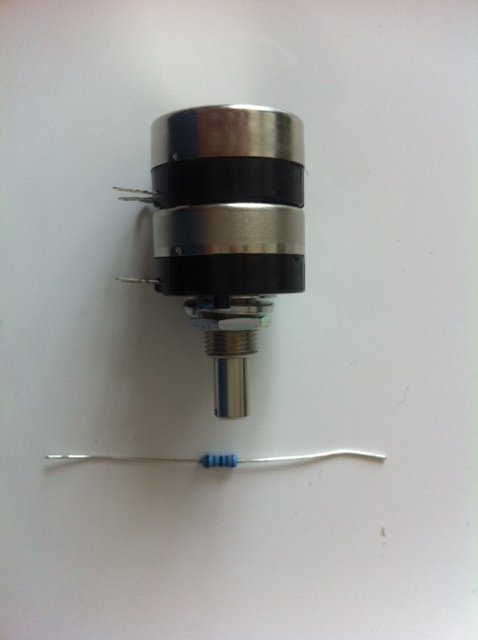

Is there any advantage of dale RN vs dale CMF or other dale types? I looked into it a bit and can't find anything that explains any reason to splurge on the RNs.
They are VERY easy to read in photographs, and have the value written on them instead of the color stripe code, so generally they are a lot more user friendly for hobbyists.
They have gotten extremely expensive, and difficult to obtain, so alternatives are being used.
Yes, I like the Dale resistors specifically due to them having the value printed on the actual part. I also think they are very consistent. The CMF series are quite a bit cheaper and still have the value printed. I generally purchase the 1/2w variety.
I do see that the RNs tend to be larger. Maybe the RN series is just overbuilt vs the CMF.
The RN’s are milspecced so they are a bit larger and can dissipate a bit more than specified.Yes, I like the Dale resistors specifically due to them having the value printed on the actual part. I also think they are very consistent. The CMF series are quite a bit cheaper and still have the value printed. I generally purchase the 1/2w variety.
