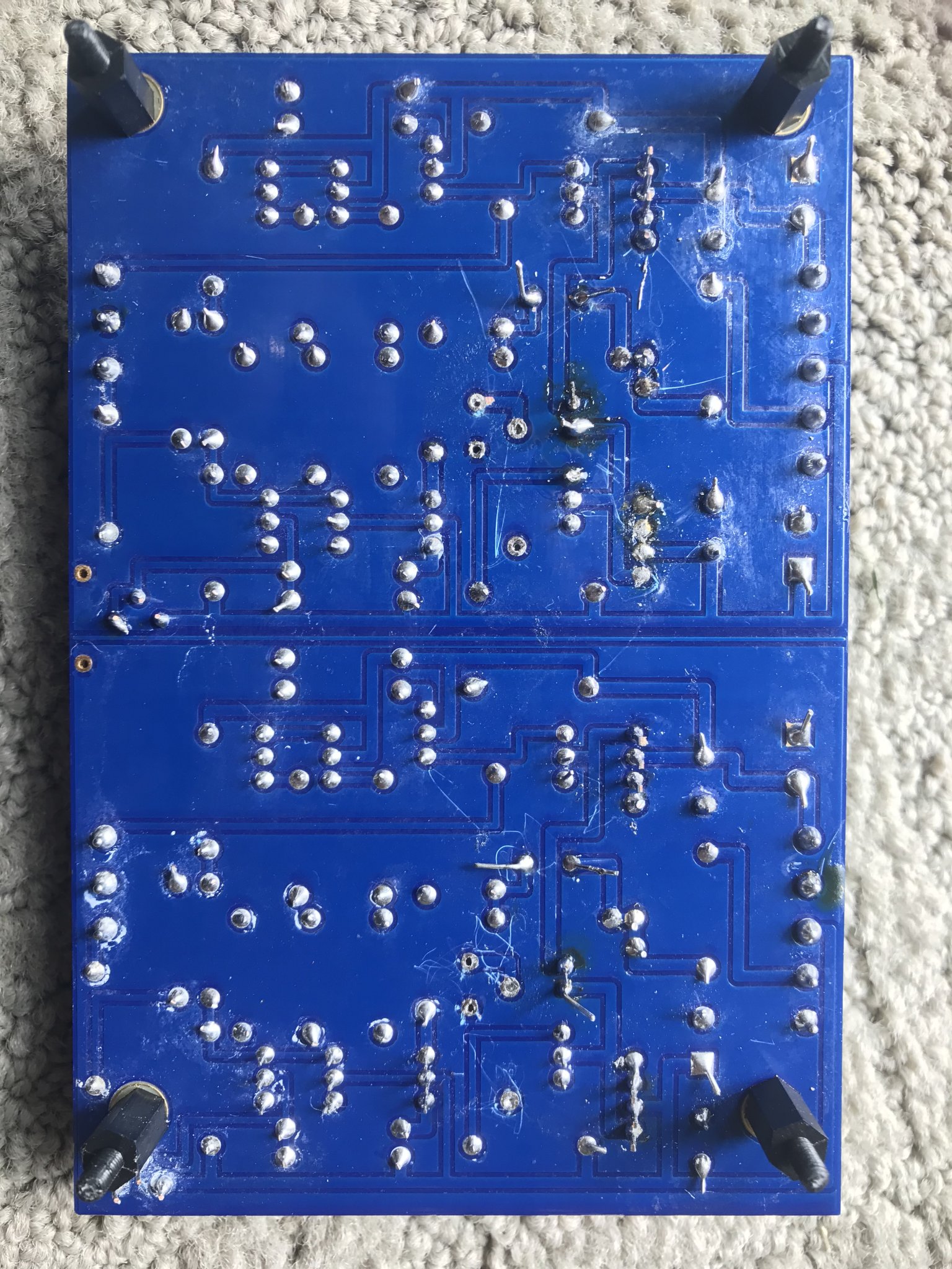

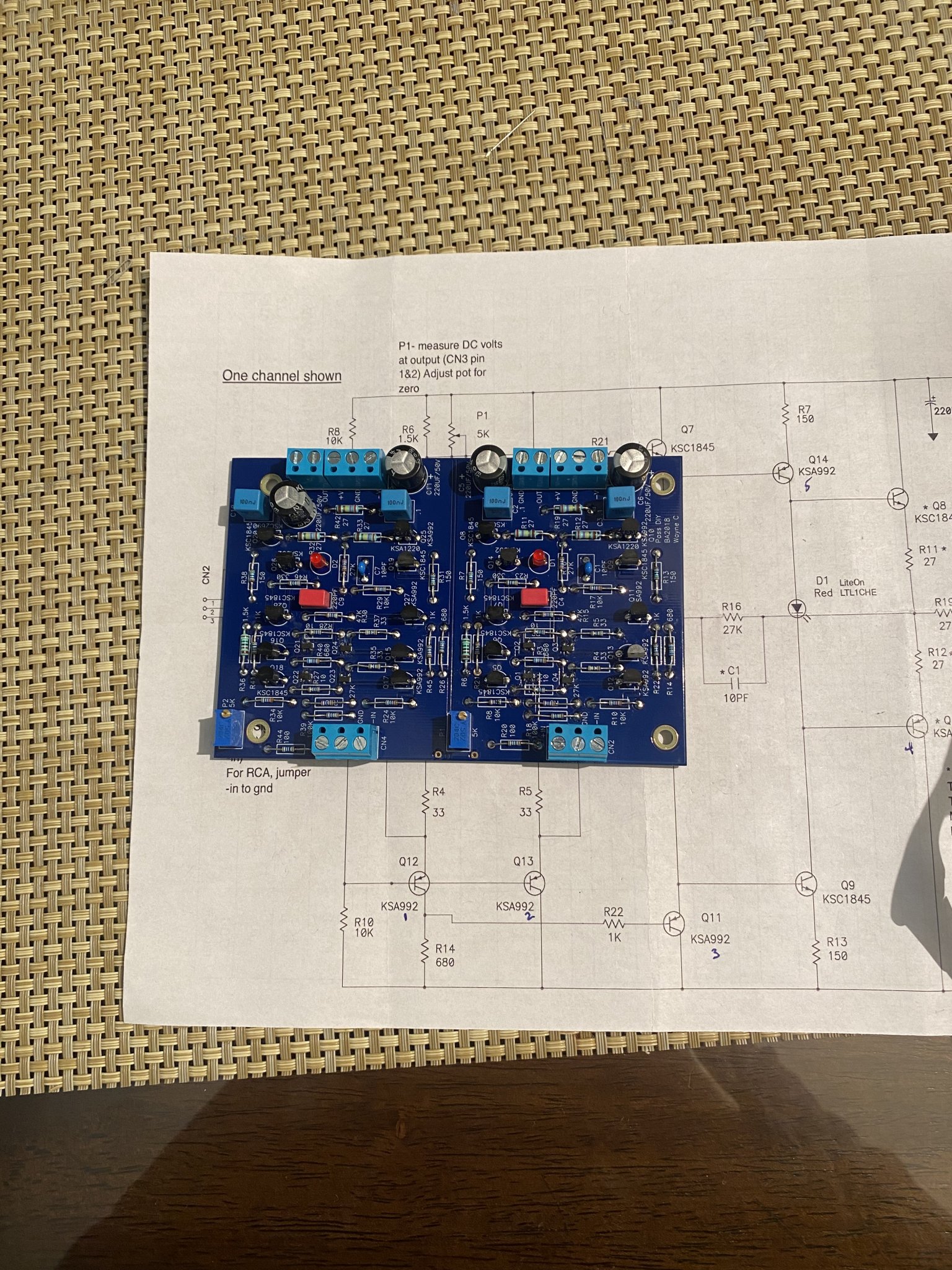

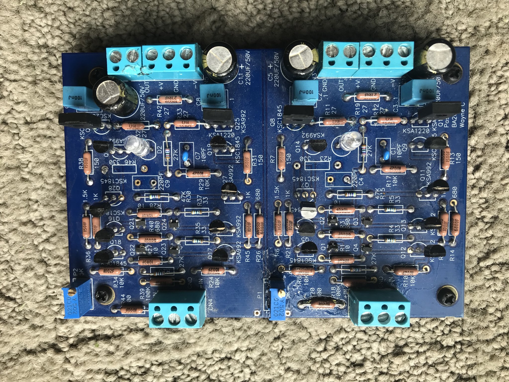

A little help please. I built the kit and a power supply kit. The power supply is providing 18v- and 18v+ beautifully. When I connected the two and powered up the LEDs in the linestage both lit for about 2 seconds and went out. I shut down and dug in. After sorting a couple issues and some re-flow work I installed two new LEDs and fired it up. LEDs were not lit. When I powered off the LEDs lit and then faded out slowly. I inspected everything I could think of and tested every transistor, reflowed a couple more spots and PRESTO ...... still no workie. I have no hair to tear out except on my chest. pics
You need R23 & R46, 330 ohm, and C4 & C9, 220 pF caps. Sorry, your using the large output devices, both of my builds use the little ones and use the resistors and caps.
Hello Pmat,
what kind of new LEDs have been installed? They have to be of correct type / value regarding mA-range and
behaviour to bias your outputstage properly. 15 Ohm- bias-resistors are in.
The LEDs have the correct orientation on the pcb. I can see this on the pic.
Are your rail-voltages (+18 V / -18 V) stable?
Only some thoughts.
Cheers
Dirk

Sure you didn’t connect power leads to signal input instead of DC input?A little help please. I built the kit and a power supply kit. The power supply is providing 18v- and 18v+ beautifully. When I connected the two and powered up the LEDs in the linestage both lit for about 2 seconds and went out. I shut down and dug in. After sorting a couple issues and some re-flow work I installed two new LEDs and fired it up. LEDs were not lit. When I powered off the LEDs lit and then faded out slowly. I inspected everything I could think of and tested every transistor, reflowed a couple more spots and PRESTO ...... still no workie. I have no hair to tear out except on my chest. pics
your boards are messy, with suspicious joints still. Looks like you have been rushing along. Not a good idea with this circuit.
also: you say you replaced the LED’s. With what LED’s did you replace them? These LED’s are a specific type, and are part of the biasing of the circuit. If you used something else than in the kit, remove immediately and order proper ones.
if LED’s are the correct type, I suggest you;
1: Clean the boards properly with isopropanol and a toothbrush. Rinse several times. Focus especially on the JFETs. They will not work properly with greasy flux residue around them.
2: Confirm correct LED orientation. Since they lit upon shutdown, I suspect you either put your power in where the signal input is supposed to go, or that they are inversely orientated, or that they are the wrong type.
3: Connect DC wires to the correct place, including gnd.
4: Short inputs (gnd to minus, plus to minus).
5: Power on. Do LED’s light up?
6: Focus first on the the right channel. Connect your DMM set to DC volts or millivolts across R1, then R2. Observe voltage drop. It should be approx 0V3 (0,3 volts, or 300mV. Divided by 10R this gives the proper CCS current of approx 30mA. Report your findings here. If CCS is OK and LED’s light properly, it is possible to proceed with further troubleshooting.
Anyways, same drill as always: check all parts are in correct place, and that all active components and caps with polarity are correctly orientated.
Andy
The LED’s are of the wrong type. 100% certain. Beat me to it, Dirk, but of course I missed that they are correctly orientatedHello Pmat,

You need to snip off all the excessive leads, reflow and clean the board. I see a lot of potential for shorts
