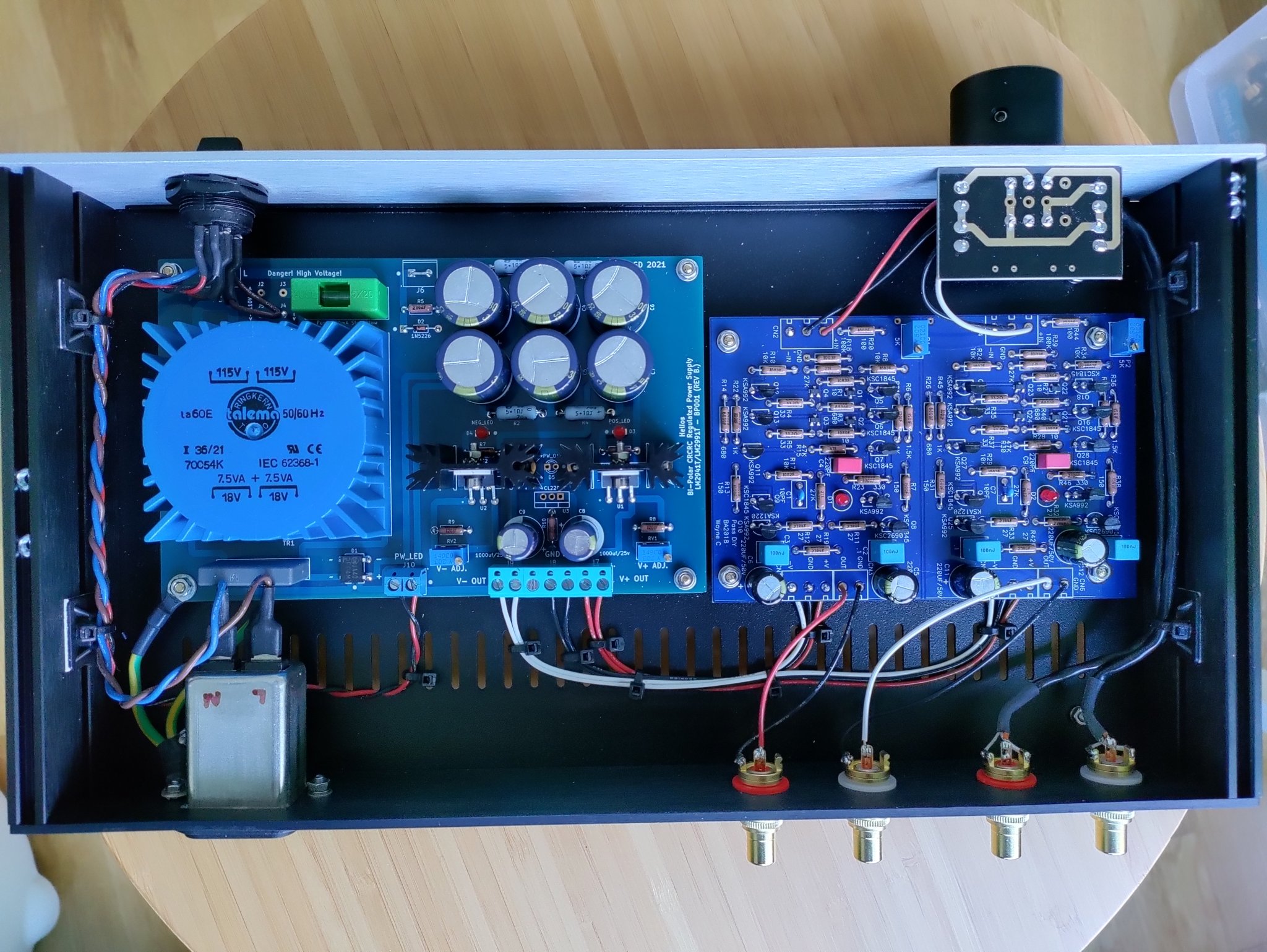

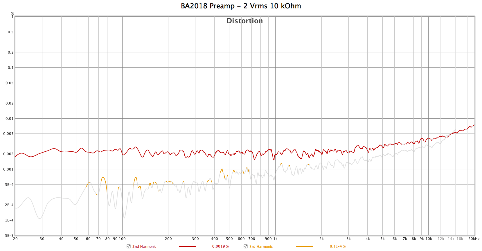

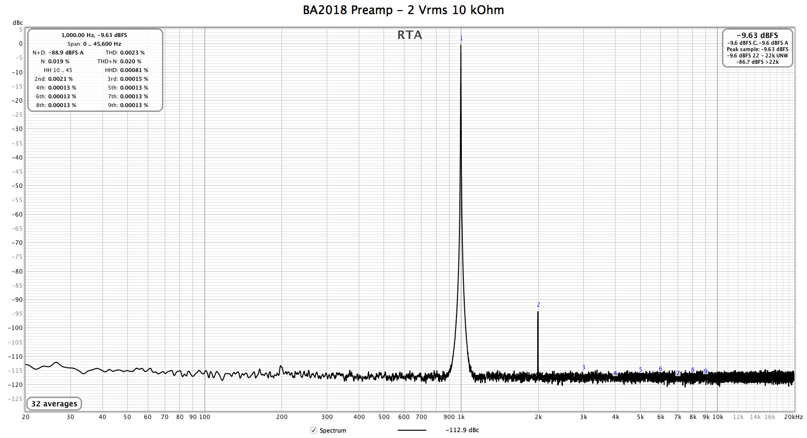

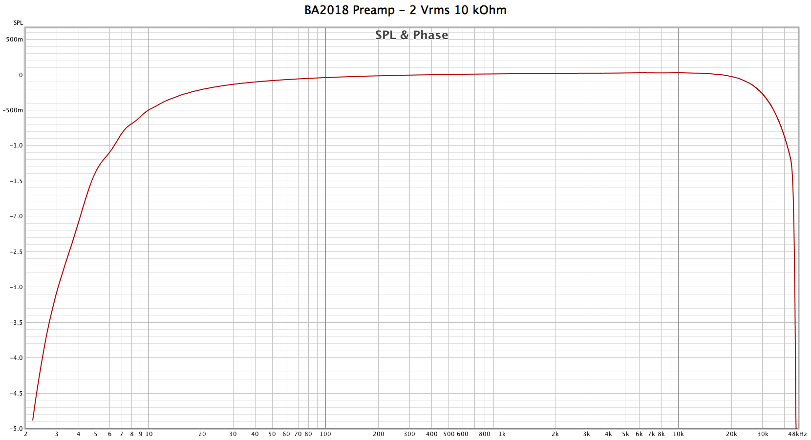

What can I say that has not been said already? I am amazed of how clean this pre sounds and measures.
What a gift for the diy community. Thanks Wayne! And thanks to the Store for providing the complete kit.
Here the complete set. Done with an old sound card... that probably shows its limits before the pre. 🙂Measurements are very impressive.
Smooth buildWhat can I say that has not been said already? I am amazed of how clean this pre sounds and measures.
I've had mine for almost a year now, it's nice to see what I've been hearing.Here the complete set. Done with an old sound card... that probably shows its limits before the pre. 🙂

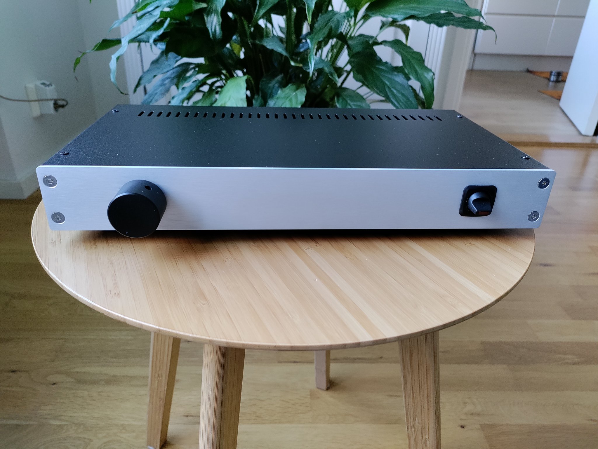

Very, very nice! I also like the on/off switch. Could you provide information or a link of brand and type?What can I say that has not been said already? I am amazed of how clean this pre sounds and measures.
Thanks. I have no clue about brand. I used to buy from eBay but now I can find them only locally (links below).Very, very nice! I also like the on/off switch. Could you provide information or a link of brand and type?
https://www.electrokit.com/en/product/toggle-switch-1-p-on-off-led-red/
https://www.kjell.com/se/produkter/...ppomkopplare/strombrytare-250v5a-1-pol-p36093
Maybe with an image search you can find out more.

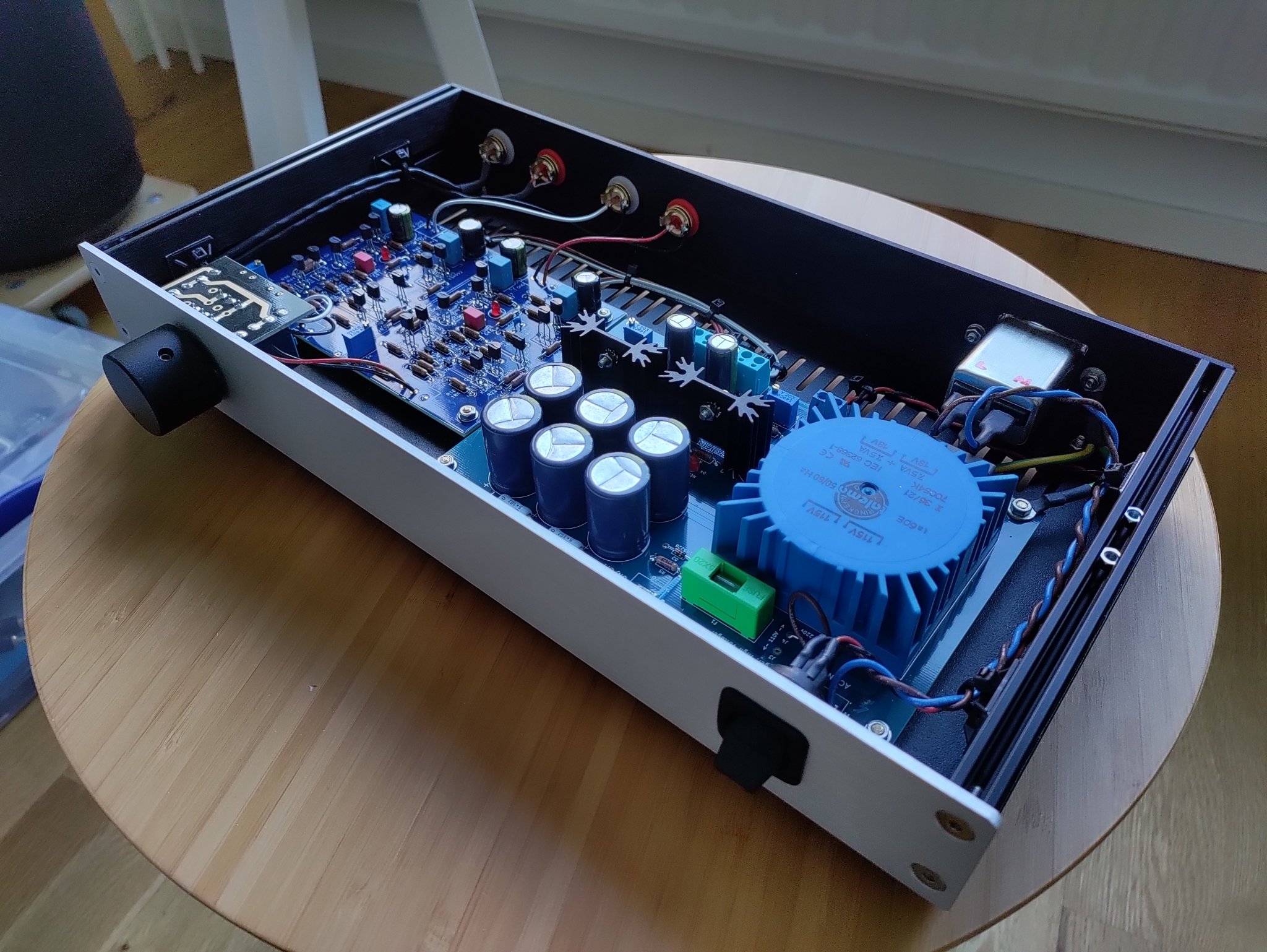

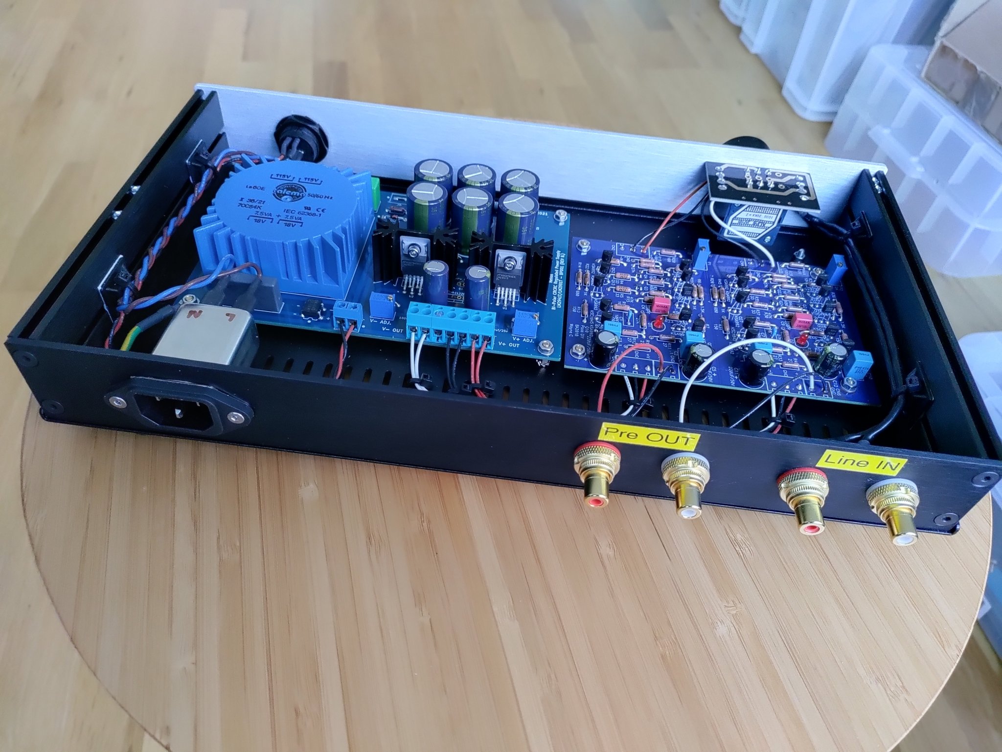

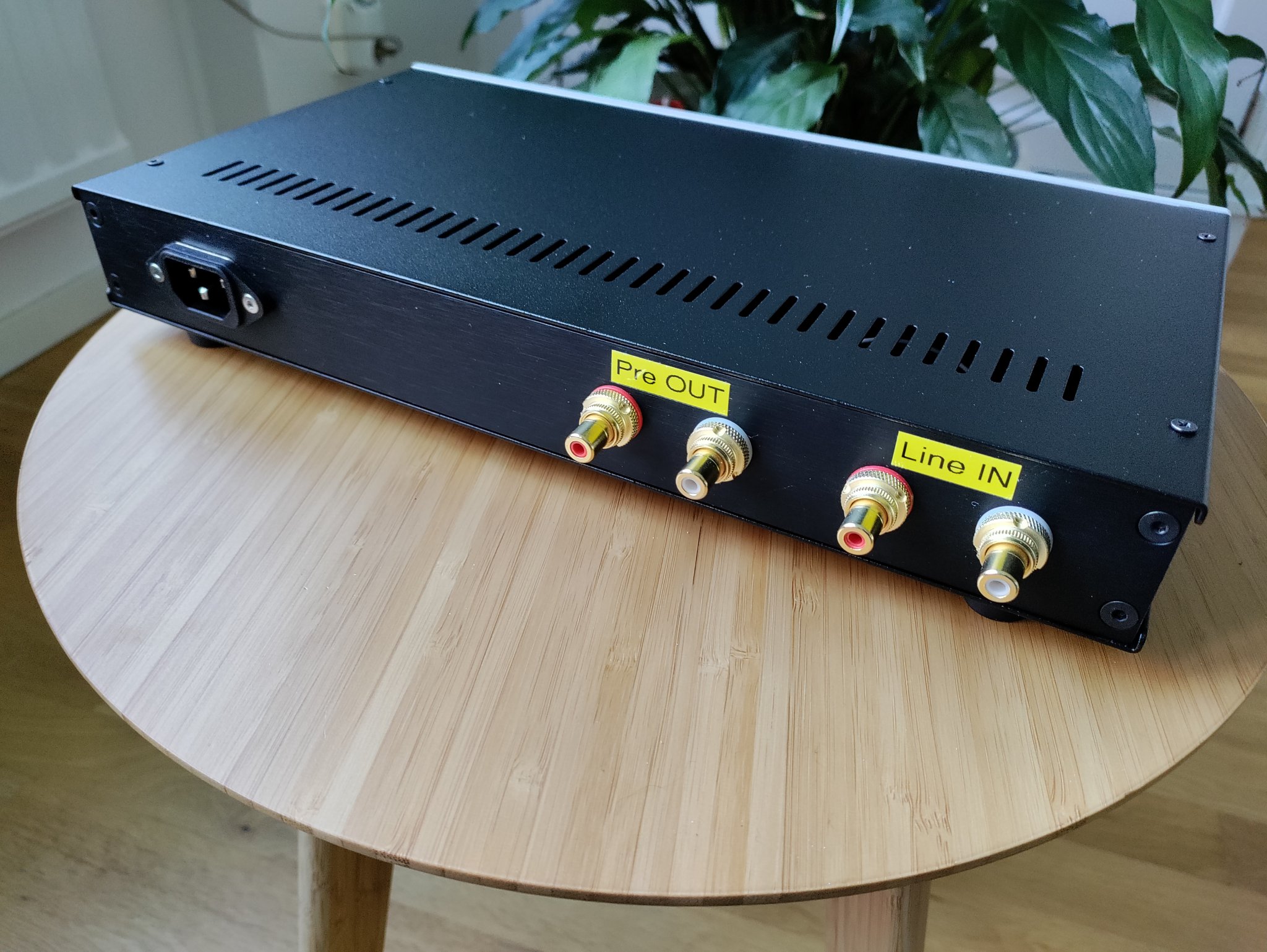

I really like the look of your build. I am put off from building this kit because of the difficulty of locating all the "little parts" needed to finish the project like the case, the volume control, the input and output connectors, the power supply. You have put together what looks like a very nice blend of form and function. Have you a bill of materials for the whole thing? If so I would very much appreciate having a look at it!
Unfortunately I don't usually make a BOM because I work on different projects in parallel and once something is missing I move to the next one until is time to do a combined order for missing components. In doing so you are not put off by the need to locate everything upfront... 😎 However, I can track down any single component and I am happy to do so. We can keep the discussion here (it can be interesting for others) or in PM. But let's start now.Peppe,
- The case is a HIFI 2000 Case GX347 40x330x170 - Front 3mm Silver. I guess you find it also on the Store.
- The BA 2018 PCB and components is the kit from the Store. I replaced some resistors with Dale CMF55 since is what I usually buy/have.
- The PSU comes from here but the BOM is on another page. The guy is a member here and very nice to deal with (and will answer shall you need technical aid). However, if you want to use the the 1U case above you must order the low profile versions of the transformer (Talema 70054K - 15VA 18V), capacitors (EEU-FK1V332S and EEU-FK1E102L) and heatsinks (513002B02500G). In parentheses what I used. And must use 5mm hex spacer to mount the PCBs. Height of the components is important. Not exact part number.
- Wayne's BA 2018 linestage
