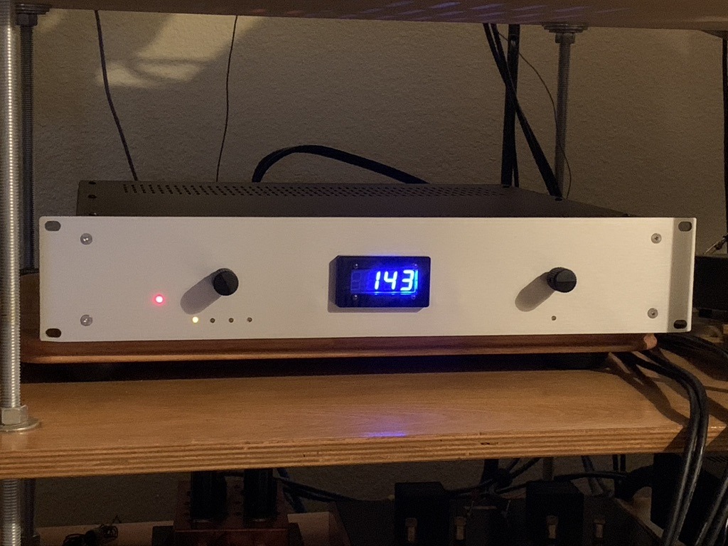

Latest and last rebuild (hopefully) of my BA 2018. I believe I have exorcised the noise demons once and for all. Calibrated ear-on-speaker test tells me it's quieter than a gnat farting on Pluto. New attitude, focus, determination and patience to get the most out of this gain stage. Each rail, of each channel, gets it's own xformer winding, diode bridge (11DQ10's), pi filter with common mode chokes and Nichicon UKZ Type 3 Super Through caps (1000uF X2), and a tweaked Superreg (WJ's latest improved voltage reference changes). Split bobbin transformers and CMC's inspired by Gary Galo's old Linear Audio articles. No shared ground other than the ground lift circuit at the chassis ground next to IEC inlet. Placed a header that can be easily shorted at the input RCA's to give the option to share both channel grounds there, or leave them separate (open right now). Humanity's oldest question... "do I tie the grounds together in a true dual mono setup? If so, where exactly?". Speaking of ground, PS ground stays completely separate until finally meeting up at the client (gain stage), at a busy star ground there, per Mr. Didden's teachings. Remote sense wire from the Superregs is twisted and screened Mogami balanced interconnect cable. Wima film cap rail decouplers (.1uF) were removed from the client and replaced with 10uF/100V Nichicon Muse UKZ's. Converted to large heat sinked alternate output devices and associated changes. Proud papa bias obviously but sounding fantastic and keeping me up way too late on these worknights, a good sign....
Hello william2001,
your build looks really good! I also made my Waynes-Line-Stage dual mono. Great setup.
Have fun and enjoy the sound!
Dirk 😉
Dirk 😉

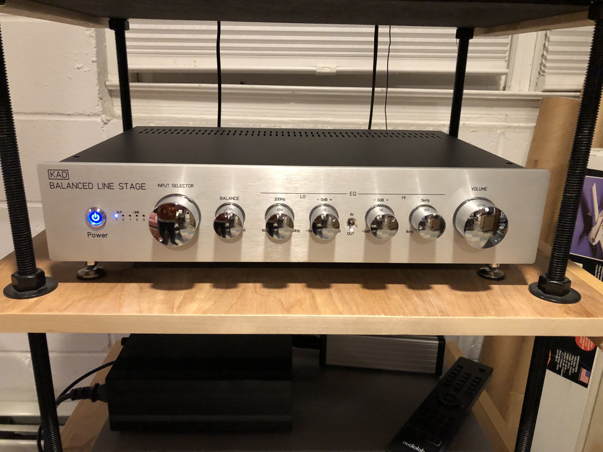

I built Wayne's BA2018 last year and it exceeded my expectations. I was wondering if anyone has compared its sound to the Doug Self Linear Audio preamp (my PCB says v.2.1b). If the Self preamp isn't a lot better-sounding, I'll probably hold off indefinitely building it.
I have both, and I agree that the BA2018 also exceeded my expectations also. That said I did not do a head to head comparison between them on the same system. The Doug Self is very nice and the fact that it has build in tone controls and balance makes it more versatile for more applications. But I'd have to say I think that the BA 2018 sounds cleaner/ more transparent. If it had a balance and tone controls it would be the bomb. That said the BA3 FE is also fantastic. It's great to have worthy choices.I built Wayne's BA2018 last year and it exceeded my expectations. I was wondering if anyone has compared its sound to the Doug Self Linear Audio preamp (my PCB says v.2.1b). If the Self preamp isn't a lot better-sounding, I'll probably hold off indefinitely building it.
Thanks, that's an excellent response in a number of ways. 😉 And I had already suspected that it's really hard to beat the audio quality of Wayne's preamp, hence my query.
I have all three boards for the Self pre, so I'm wondering if I can cobble together a Frankenstein's monster using the BA2018 for basic signal-amplifying and also the switching capabilities of the Self "KAD switched five input IO" board. I guess it comes down to PS compatibility (separate PSU for both?). Hmm . . .
I built them both and they are in regular rotation in my rack. They have different “sonic signatures”, both of which I like very much. As was pointed out, the Huff/Self pre has a lot of features already engineered in that you would have to develop yourself if you wanted them on the BA2018. But that simplicity is some of the charm with the straight forward BA2018. Why not build them both? Hearing and understanding each design philosophy is kind of a magical thing. Enjoy!Thanks, that's an excellent response in a number of ways. 😉 And I had already suspected that it's really hard to beat the audio quality of Wayne's preamp, hence my query.
Oh, I will build the Self preamp, but I have other projects that have a higher priority, including electronic projects that are not audio-related (especially working through Learning Art of Electronics). I was just curious if the Self preamp was a "must do now" project or not. But, yeah, the Self preamp seems like a more-than-worthwhile project, especially since I've already bought the PCBs. I don't want to get too off topic, so I must reiterate that the BA2018 preamp is amazing; certainly it has surpassed my expectations.

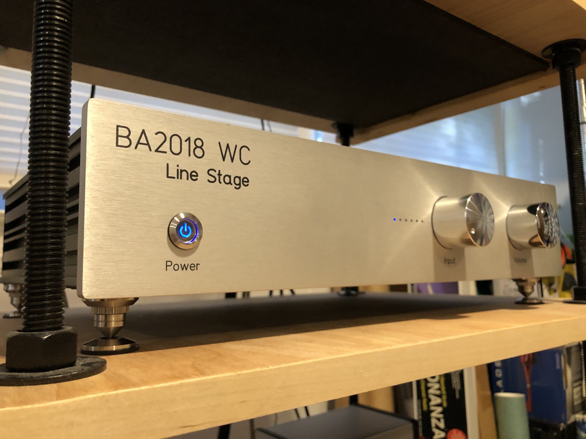

Wow, your builds are spectacular! Where did you get the panels engraved? And what about those fancy knobs?!
The BA2018 certainly is amazing! That’s the pre I’ve been listening to lately. I designed the front and rear panels in front panel designer (it’s a free download from the front panel express) and ordered the chassis with all the machine work, anodizing and printing from the diyaudio store. The knobs are also from the diyaudio store. That Horowitz/Hill book is a nice light read, isn’t it? 🤪Oh, I will build the Self preamp, but I have other projects that have a higher priority, including electronic projects that are not audio-related (especially working through Learning Art of Electronics). I was just curious if the Self preamp was a "must do now" project or not. But, yeah, the Self preamp seems like a more-than-worthwhile project, especially since I've already bought the PCBs. I don't want to get too off topic, so I must reiterate that the BA2018 preamp is amazing; certainly it has surpassed my expectations.
I hadn't realized that the DIYaudiostore had that much capability to engrave panels (via Bologna, Italy?). Thanks for enlightening me. Yeah, AoE is heavy going for me. Learning AoE is the lab manual, and is more hands on than AoE, which is more of reference work, IMO (still essential, though).
Did you purchase a Wen? Maybe the 8"? I'm tired of cockeyed results.I only did that once. The multi day agony of that experience, convinced me that a low priced "tabletop drill press" from Amazon, would save me so much time and prevent so much misery, that it was worth far more than the USD 120 selling price. I've never regretted the purchase.
