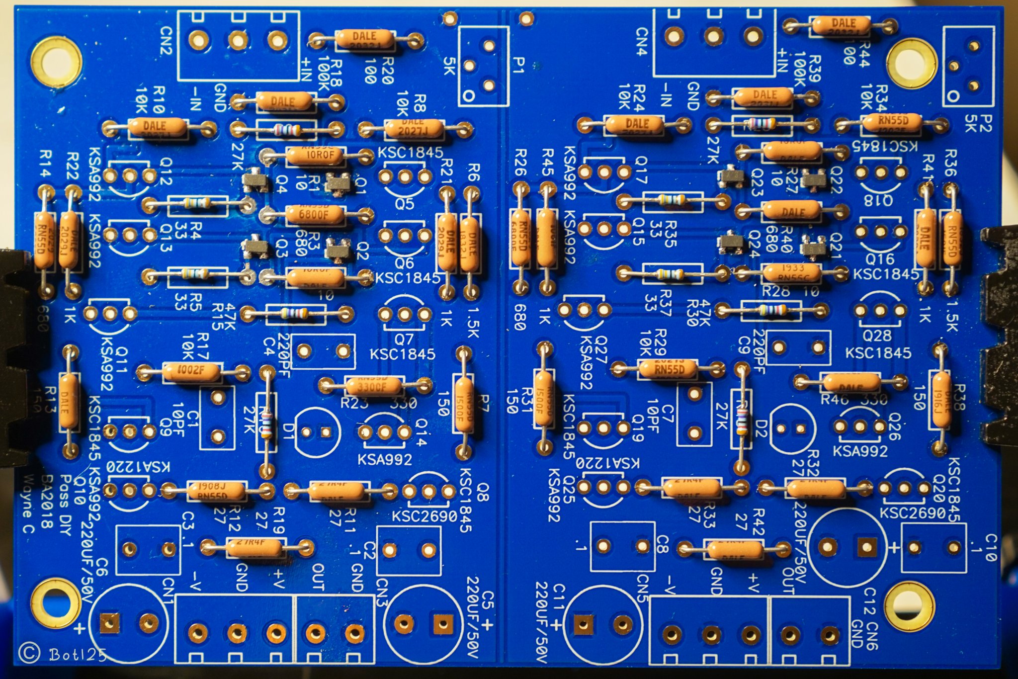

I have a BA2018 with Super Regulator power supply. Works fine. Very quiet. Dumb question about your BA2018 boards. Do you have the -IN terminals jumpered to the G terminals on the input blocks? The original schematic did not include the text that tells you to do that for unbalanced input configuration.

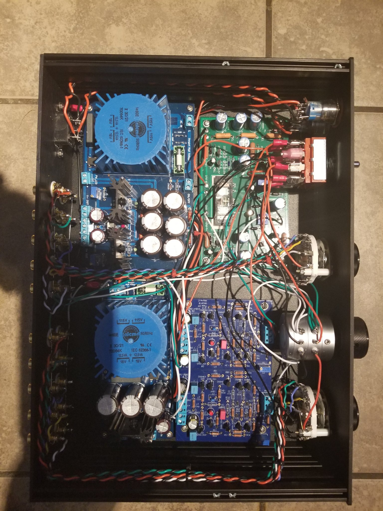

Well I kinda meant pictures of your finished project, showing how you have the wiring arranged / raw DC supply / grounds / etc. in this "known good" configuration. There does not seem to be many pictures of these in the wild that I can study, or at least I'm having trouble finding them.

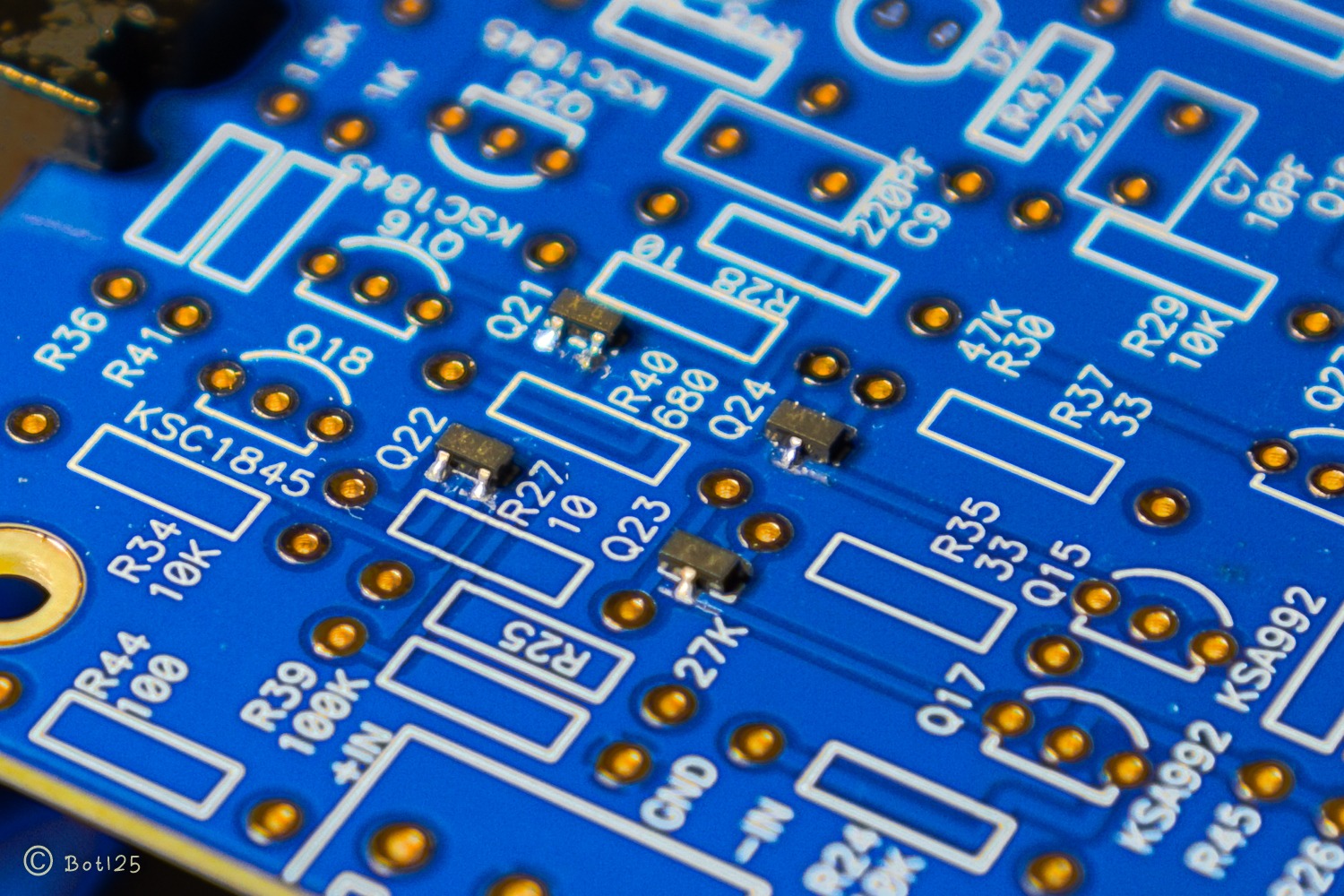

Let's see the SMD JFET's, I used magnifying glass on mine, would like to see a photo or two. On two of the three PCB's I built, two had poor solder joint on one leg of one JFET. Never saw it using the glass.
As you asked! I almost forgot...
william2001

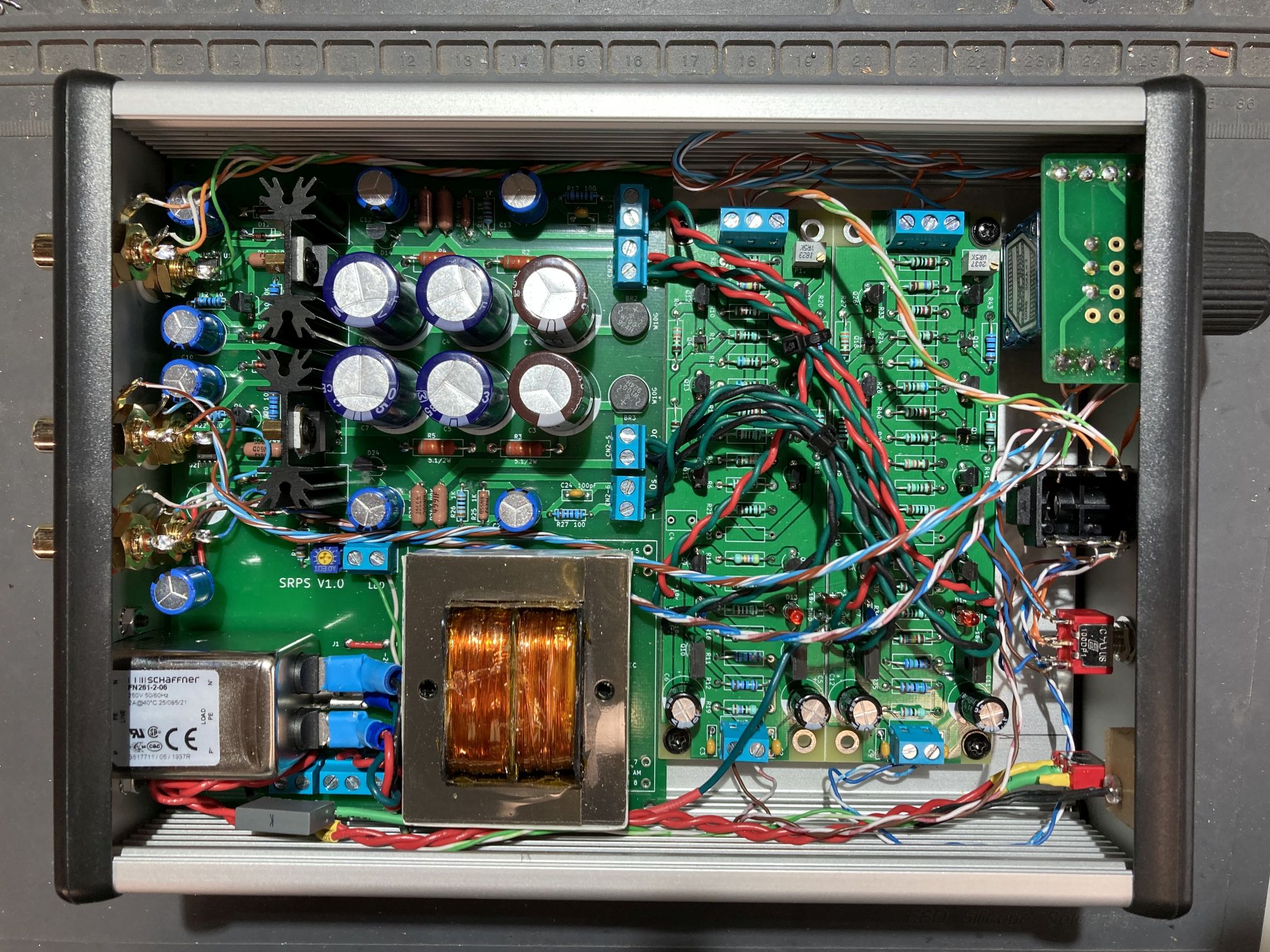

I've built three BA2018s and had forgotten that the one with a SRPS was built with a dual-mono, split-able BA board I got from forum member IckyB. Also, the SRPS board is a layout I did myself, taken from schematic V2.3 with an added on-board transformer, rectifier/filtering circuit and power LED connection. So the attached photo may not be much help. It's also possibly the densest chassis build I have done.
For what it is worth, the SRPS ICs (just barely visible at the far left) are AD825 and there is a 0.01uF bypass cap connected between the SRPS ground and chassis ground. Ref voltage is 6.9V and R15/25 (R6/13 on V2.3 schematic) is 1.5K ohms, providing around +/-18V at the regulator outputs.
The IckyB board (not split into 2 pcs) has power connections on the outside edges and also in the middle where the two circuits are divided by the score line. I connected DC power to both channel edges on separate home runs and the sense wires to the board middle and jumpered across the split line. All the power and sense home runs are twisted pairs.
Schematic and parts list for my V1.0 SRPS is attached for reference. The IckyB boards follow Wayne's schematic but not his layout.

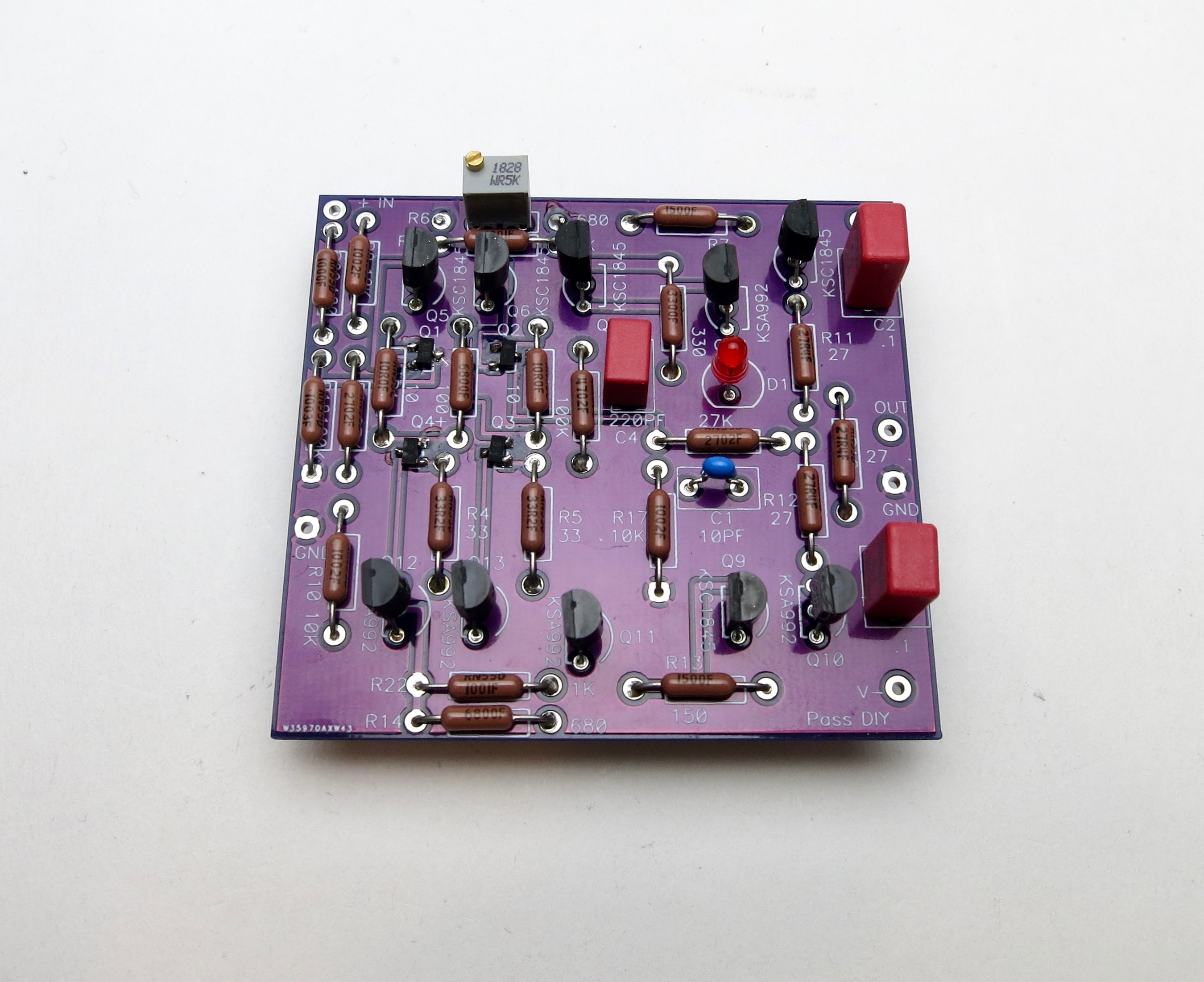

Haven't gone through all 157pp so apologize if this is covered above somewhere, but...
Just finished my firs WB 2018 linestage and it is superb. Want to build another and the parts are now unavailable on DIY. So checked post 508 above, got the BoM and all is available except for the bipolar transistor KSA1220AYS. This part has been discontinued by onsemi.
Are their other equivalents? Other sources? (DigiKey is out as well and will not be stocking in the future).

Instead of the KSA1220 / KSC2690, you can use Toshiba TTA004B and TTC004B. Direct replacement; that's what I used; works very well. 🙂
Mouser is well-stocked on the TTAs, and has some TTCs - many more of those in 4 weeks.
Also, there are generic substitutes for the KSA1220, like 2SA1220 from Inchange Semiconductor.
Hope this helps, regards, Claas

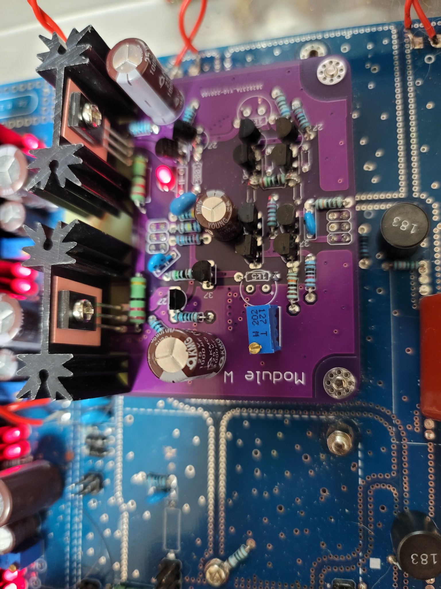

What should the source resistors be if im using j309? I spun a to92 version of this circuit, put j309 s in it with the source resistors x10 the stock value (10ohm>100ohm, 33ohm>330ohm) and it works fine but sounds shrill. Everything else is as per the schematic.
Should i have changed something else and not the source resistors?
Well i tweaked the new board with the j309s to have exact same components as the 209 board and now i really cant tell them apart soundwise. In that regard the through hole version is a success. Now looking for ways to improve the schematic itself of this wonderful circuit. Ideas welcome 🙂
