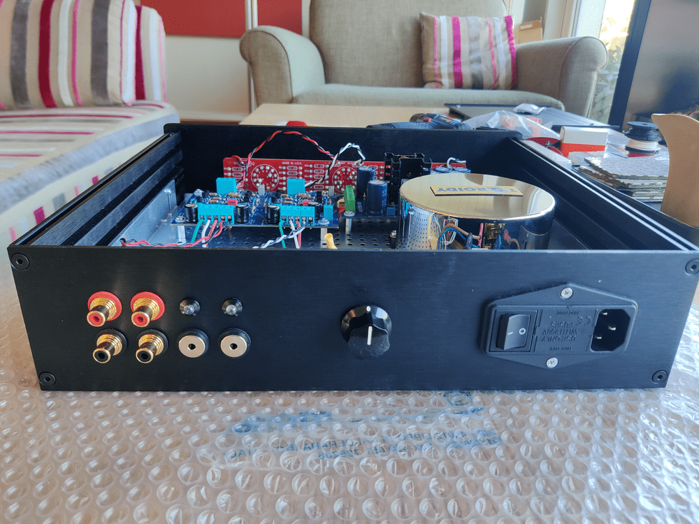

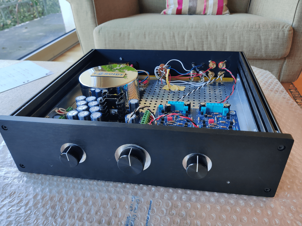

Finally finished my Waynes! Started on this project over a year ago (may be more like 2...). I thought "hey, I can buy the board as a kit from DIY audio, won't take more than two afternoons to stuff and solder the board". Let's just say I was right on that estimate, it was all of the other things which I discovered on the way which took time....
Chassis from Modushop, A3 stereo stepped attenuator from Glass-ware, VDRN PSU, Toroidy "porn for audiophiles" transformer, parts from Mouser and Digikey, and lots and lots of help from all the wonderful people on the DIY Audio forums. Thanks, everyone!
I didn't like the LEDs on the board, so I pulled them to the front of the chassis. Fun to watch them fade out when you cut the power... nice reminder that the PSU caps don't go to zero immediately.

Cross-posting with the VDRN thread (more photos there), because people on that thread were so helpful figuring out the power supply.
