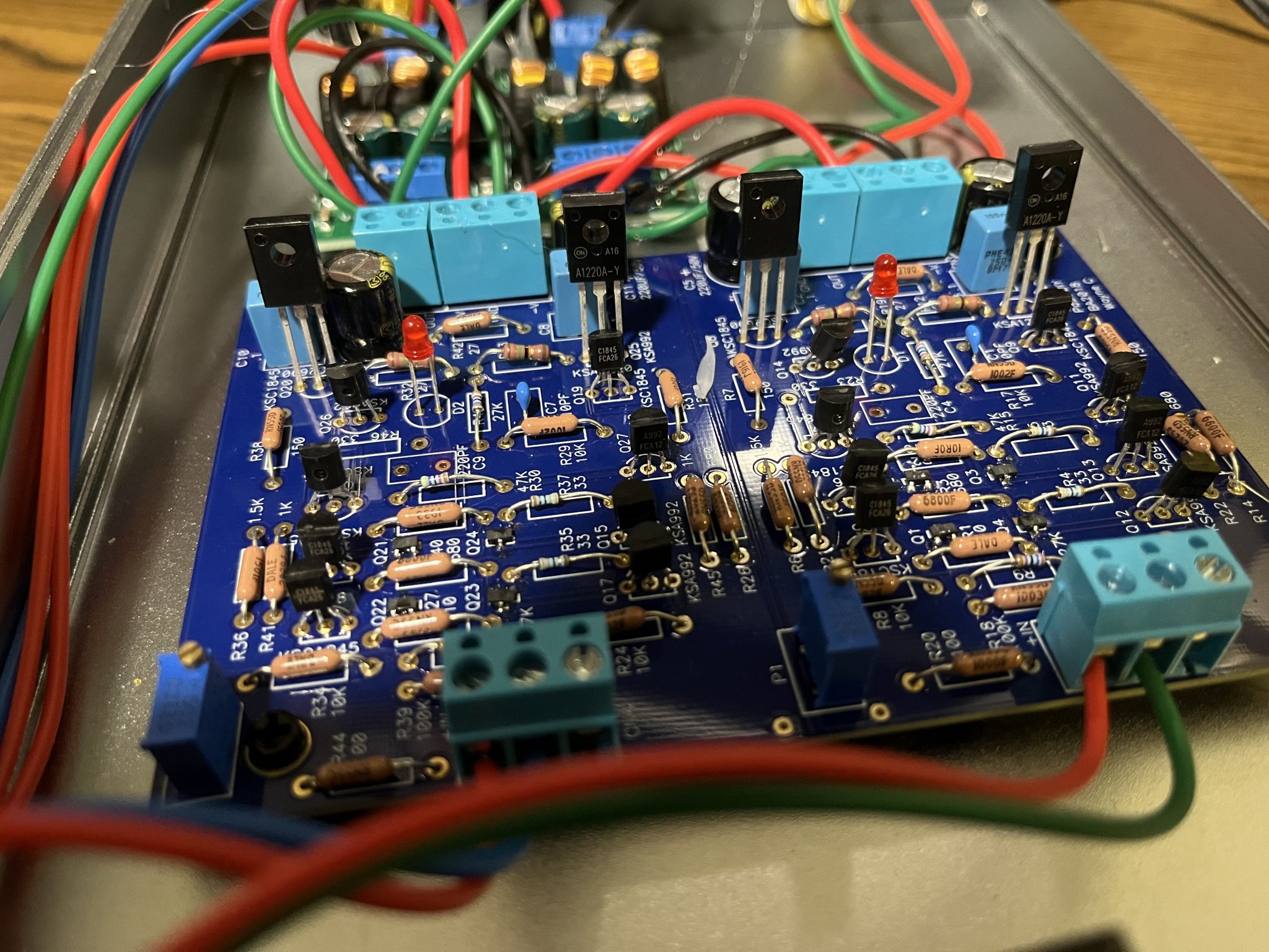

i am wondering if I have got the orientation of the Toshiba transistors correct. could anyone point this out to me?
I have massive dc offset now but no magic smoke.
Q20, Q25 looks right. I wouldn't want any leftover flux residue under/around Q1, Q2, Q3, and Q4. Flux is great for the soldering process but not for operation of these circuits. Isopropyl alcohol, a brush, and some compressed air are your friend here. Repeat process until contamination is completely gone. Is the LED lit? There is a schematic posted at #3303 with some current readings. Output stage should be ~20mA or so on a known good unit. Check the voltage across your part, then calculate current through it with ohm's law... I=E/R. The trimmer pot is very sensitive on these also when you go to set the DC offset.
I second Williams post. The big ones do look correct. But I do not second your solder joints. I see many, many possible cold joints, around several of the small bipolar transistors for example.
that also makes me question the soldering of the small JFETs.
in fact, I would reflow everything that looks sUspiscious. First up: jfets. Without then nothing will work. Try to find the next point on the board after ALL of the jfet legs. Measure resistance with a DMM or use beep mode between the jfet legs and the next point on the pcb (often a resistor leg). That will give you a hint on where to start 🙂 get those right, then move on.

Thanks for the help!I second Williams post. The big ones do look correct. But I do not second your solder joints. I see many, many possible cold joints, around several of the small bipolar transistors for example.
I was shocked the initial offset was 14dc. Thought it was too much to trim. I am using a less conventional buck boost supply splitter, so that I can use a 24v wall wart.
Cleaned and reflowed the joints as per advice. And trimmed the trimmer to the end and viola 20ma offset.

Just to contradict my good ol‘ friend andy,
please post a picture of the other side of the board to confirm the joints. I agree the solder would flow all through the hole to the upper side, but then, looking at the work of other very experienced builders (think 6L6), a joint may be ok even if the solder doesn‘t went through…
OTOH, I always reflow joints from the upperside just to have them looking perfect. And to be sure not to cook those parts, I never solder all legs at once… (first round: all legs on the left, second round: all legs in the center etc.)
