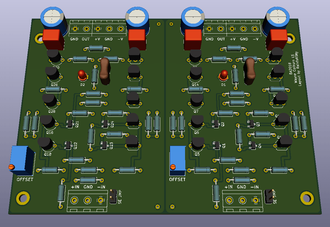

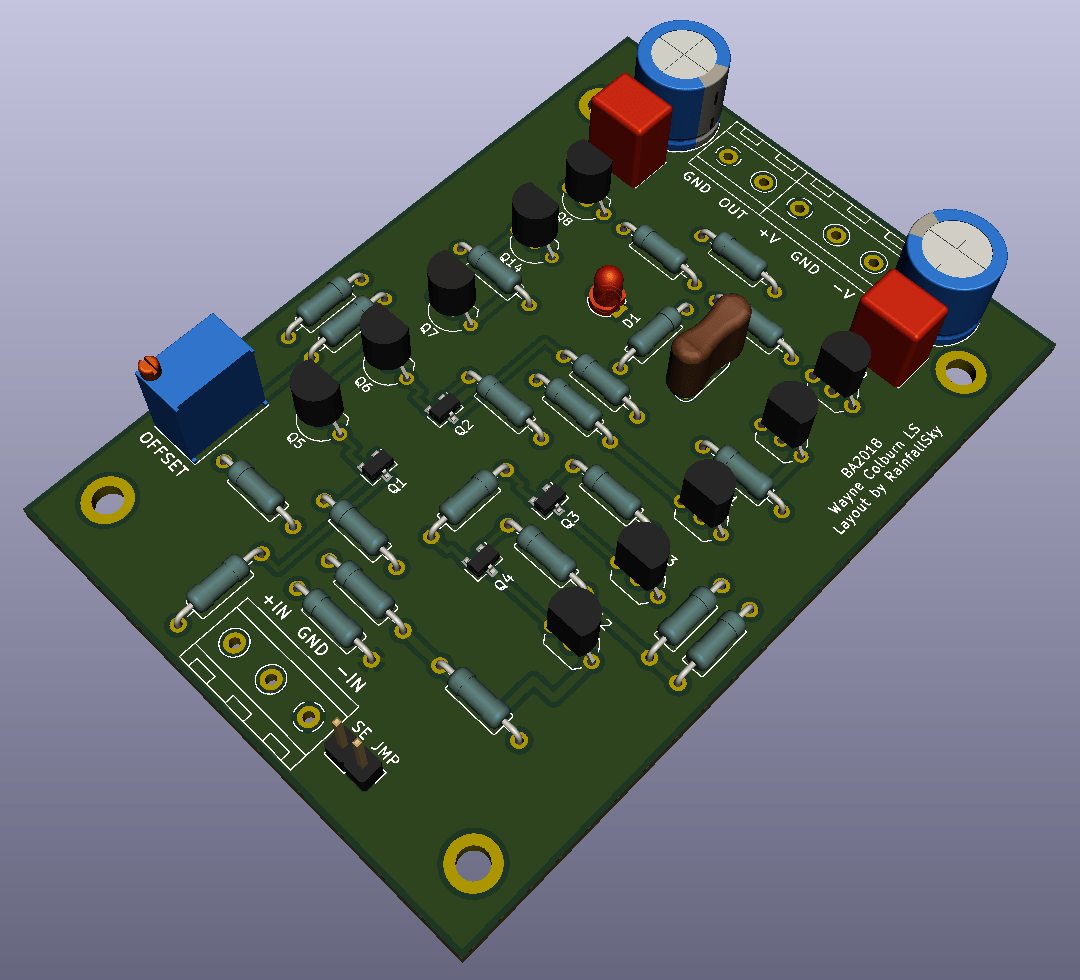

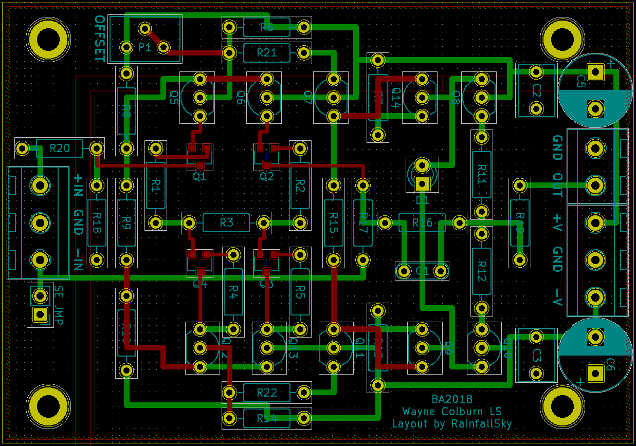

I am in the process of making my board of Wayne linestage in KiCad. Parts more or less settled.
Then everyting will be ready to copy paste to look like one whole board like in the DIYA store.
Is it a good idea to add pinheader jumper for SE mode?
I don't see why not. But I personally would be changing R18 and R20 also in addition to the jumper setting, depending on if I were using this with a balanced input, or single ended. Balanced input I would install 10K at R20, and 27K at R18, as Wayne mentions early in the thread.

Almost complete.
I have a question about grounds connection for BAL-input BAL-output.
Store board have one grounds connection at the edge of the board, closer to intputs.
Is it because it better should be connected closer to input grounds? Or is it because it just enough?

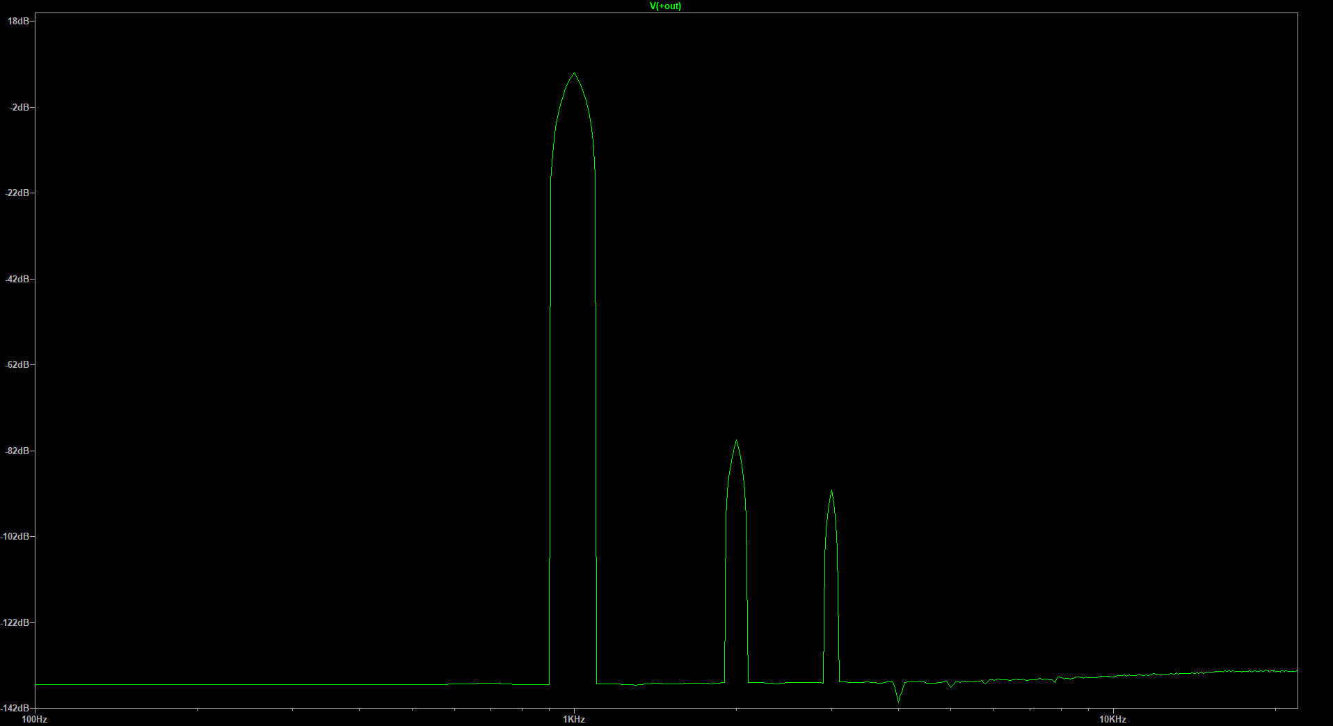

I tryed Bob Cordel's models of BC560C / BC550C and they are amazingly good in Q9 Q14 positions.
But different pinuot than KSC1845 / KSA992.

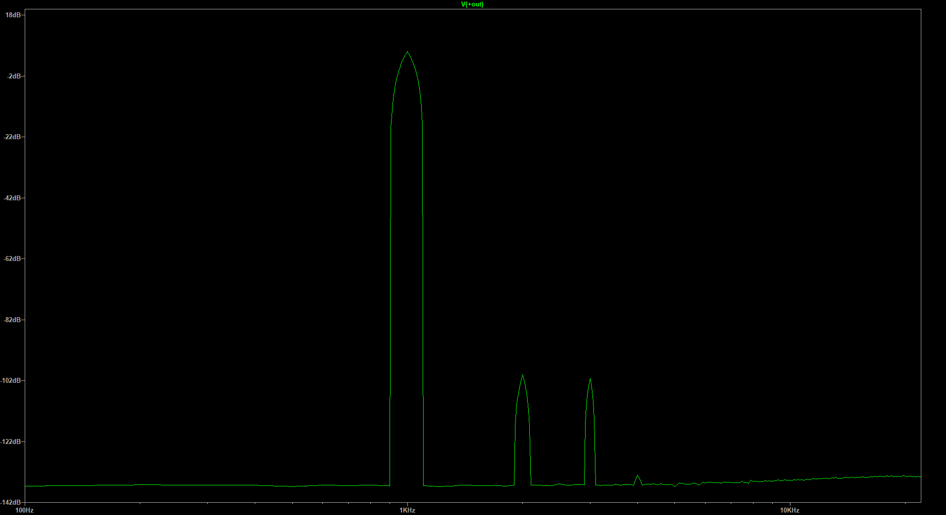

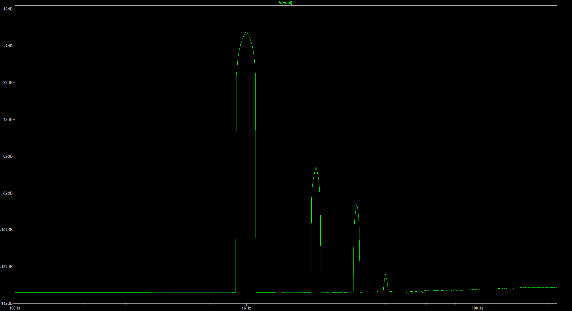

Some simulations to show what I mean.
Picture 1
Original Wayne linestage:
2SK209, KSA992 / KSC1845, Q8 Q10 TTC004B / TTA004B
Total Harmonic Distortion: 0.020234%(0.025464%)
2H: -67.816567dB
3H: -87.853831dB
4Н: -125.89844dB
Picture 2
2SK209, KSA992 / KSC1845,Q9 Q14 BC550C BC560C, Q8 Q10 TTC004B / TTA004B
Total Harmonic Distortion: 0.005366%(0.016365%)
2H: -79.508568dB
3H: -91.186182dB
4H: -140.74531dB
Picture 3:
2SK209, KSA992 / KSC1845,Q9 Q14 BC550C BC560C, Q8 Q10 BD140C / BD139C
Total Harmonic Distortion: 0.000679%(0.015476%)
2H: -100.11092dB
3H: -101.21053dB
4H: -133.03007dB

It could be those parts need to have their setpoints optimized. If using same settings the bias current won’t be optimal. I don’t think there is intrinsically a reason why 2SK209/KSC1845/KSA992/TTA and TTC are higher distortion. Those are all excellent high performance-capable parts used in some of the best amps.
difference is in models, much lesser in vivoI tryed Bob Cordel's models of BC560C / BC550C and they are amazingly good in Q9 Q14 positions.
Somehow simulation is "upset" in KSA992 being at Q14 in particular.
Changing it in to alot of othe built in ltspice BJT models improve THD..
I was using KSC1845 / KSA992 models from files in post #683Somehow simulation is "upset" in KSA992 being at Q14 in particular.
I google at least 2 more models that don't have this anomaly and everything is pretty.
Can anyone recommend good KSC1845 / KSA992 ltspice models?
