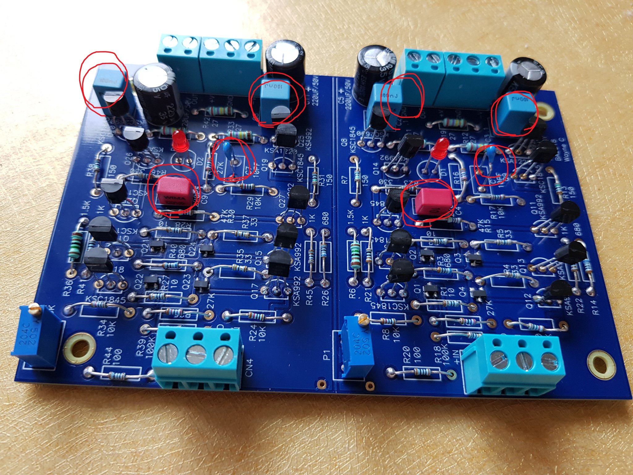

I've build this board today.
Are the parts marked with red circles in the image below without polarity?
General question regarding R18: If one does nothing with R18 but installs a 100k resistor and just plugs in RCA interconnect coming from a CD player at say 2V rms, 2k impedance, would the output of WLS2018 be at its highest or lowest?

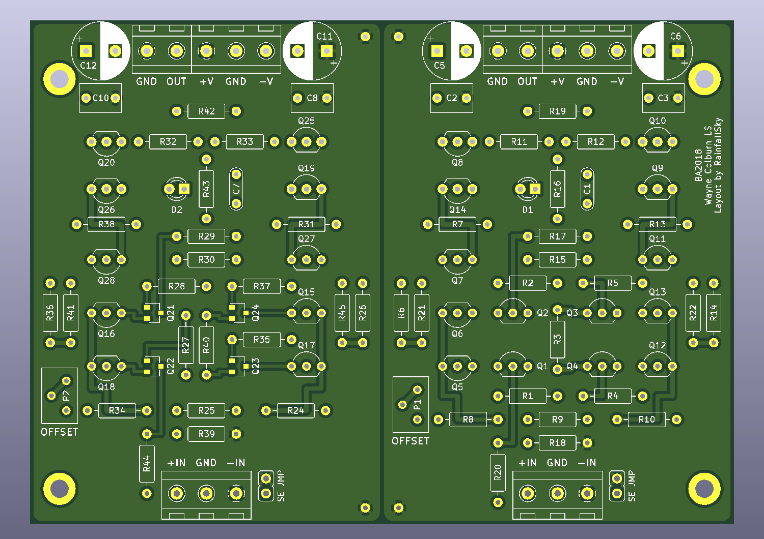

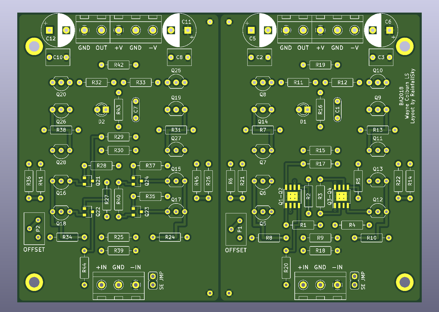

Experimental concept of Wayne linestage with 2SK209 and JFE2140 on one board.
That helped to adapt JFE2140 to ready layout with SK209 and borrow ideas from one part to other.
Too bad I have difficulties to find both locally but have 2SK170 that simualates the best of all.
So I guess I need to start making 2SK170 ver. with J111 on CCS.
So far the best simulation achieved with BD139/BD140 on Q9/Q14 and 2SC4793/2SA1837 on Q8/Q10.
Both is ECB or reversed BCE pinout (except BD139G/BD140G).
Aren't you supposed to connect the grounds at the bottom there, near P1?I've build this board today.

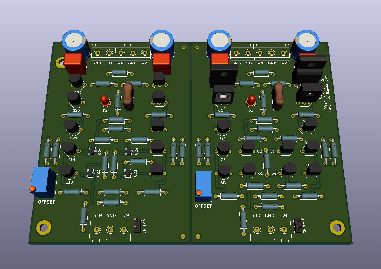

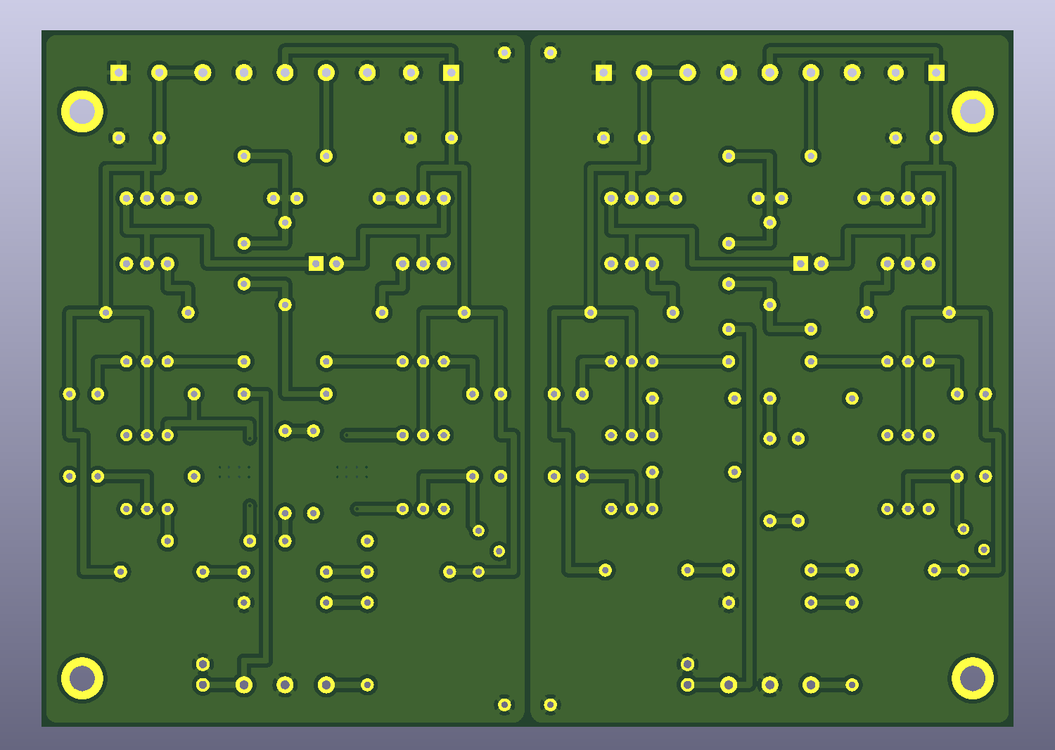

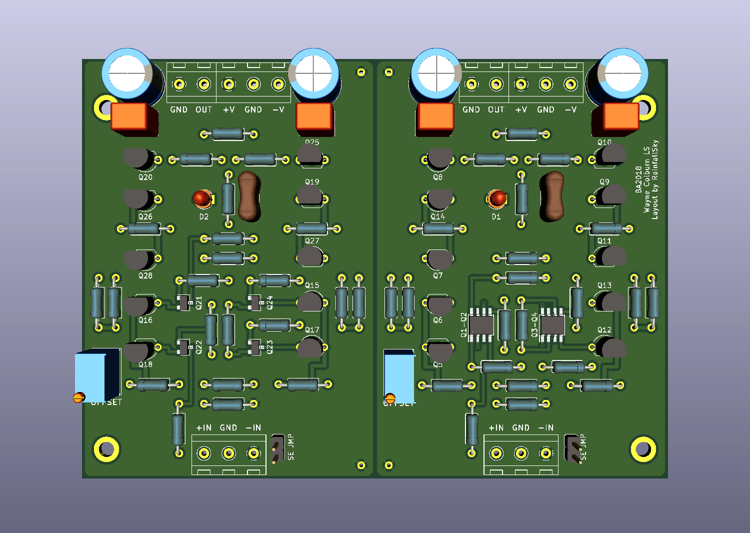

Next concept, now with 2SK170.
It looks kind of same but is fully through-hole now.
Q1,Q2 is 2SK170 (DGS pinout) and Q3,Q4 is J111 (DSG pinout).
Seems I can get all the parts needed for through-hole ver.
