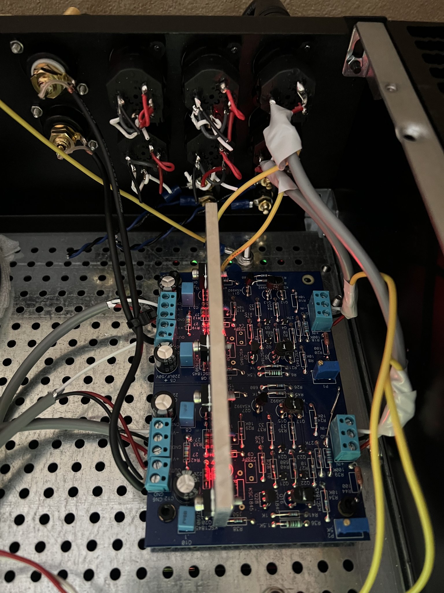

I just finished this preamp and there is too much gain (I get a hiss on the speakers - white noise).
I was reading that "gain set by ratio of R16/R17".
I'm using the preamp input as Balanced with R20 @ 10K and R18 @ 27K as per suggested in the thread earlier.
For a balanced input, is the gain still determined by R16/R17 in that scenario? Looking at the schematic, R17 ties to the negative phase of to the XLR terminal.
Thanks!!

The reason I was asking about gain, is that the preamp is super clear when playing on headphones (I did the "big" Toshiba outputs) and no hissing or anything there.
Problem happens when I plug it to the big amp, then I hear hissing about 4-5 feet away from speakers. It's annoying enough that I want to quiet it.
Bias-wise, the pre-amp biasses perfectly (can reach very close to 0V on each channel). So I don't think it's a build problem. But I'm happy to be proven wrong! 🙂

Can you please post a photo of how everything is connected?

I was trying to eliminate possible sources of noise so I cut the wires to the source selection (Will rewire later 😅).
The left channel goes to left (1-2-3 from xlr to IN+/-/Gnd of board) and right goes to the other channel of the board.
Shields of the cable goes to chassis.
I messed with Pin 1 to chassis and floating and it didn't make a difference.
Outputs are RCAs.
I tried headphones in tbe RCA jacks (with a shenaniganned adapter) and that sounds fantastic. It also sounds fantastic on the amp, just hissing.

if there is too much (sum) gain of preamp and amp, hiss is likely possible, and logical

The amplifier is the Wolverine amp from this forum (and they have absolutely no hiss at all when I connect other inputs. Only I can connect one input and SE only.
I was looking at a preamp as a way to have balanced input come in (which the BA18 allow) as well as many input sources with a nice knob.
I connected the headphones to the RCA connector (via an adapter) to make sure the test is fair.
When testing the components individually (preamp and amp) there is no hiss. Only when connecting both together, which is why I thought it was a gain issue.
Also the speakers are Klipsch Heresy IV, which are quite efficient.
Unless from the pic I shared you see a grounding problem, but I'd expect a hum in that case, the noise sounds like white noise only.
Thank you!!

so, simple calculus sez that hiss is what you can expect, with so excessive gain, feeding Klipsch speakers

Ya I wouldn't want any more gain in front of a Wolverine, myself. Bet that volume knob is hair trigger touchy..

as I remember , Wayne sez that thingie is stable with lesser gain, can't remember was it 1* or 2* mentioned specifically
however - if you decrease gain of preamp, it'll sound different ..... only you can tell how much of change you are going to hear and is it to your liking
besides preamp, you can change gain of amp; same applies regarding change in sound
probably best way is to use unity gain preamp, simpler topology than Wayne's (this one)
