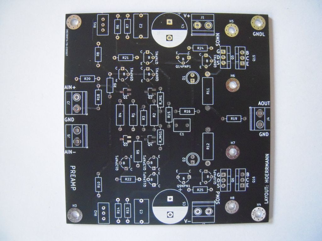

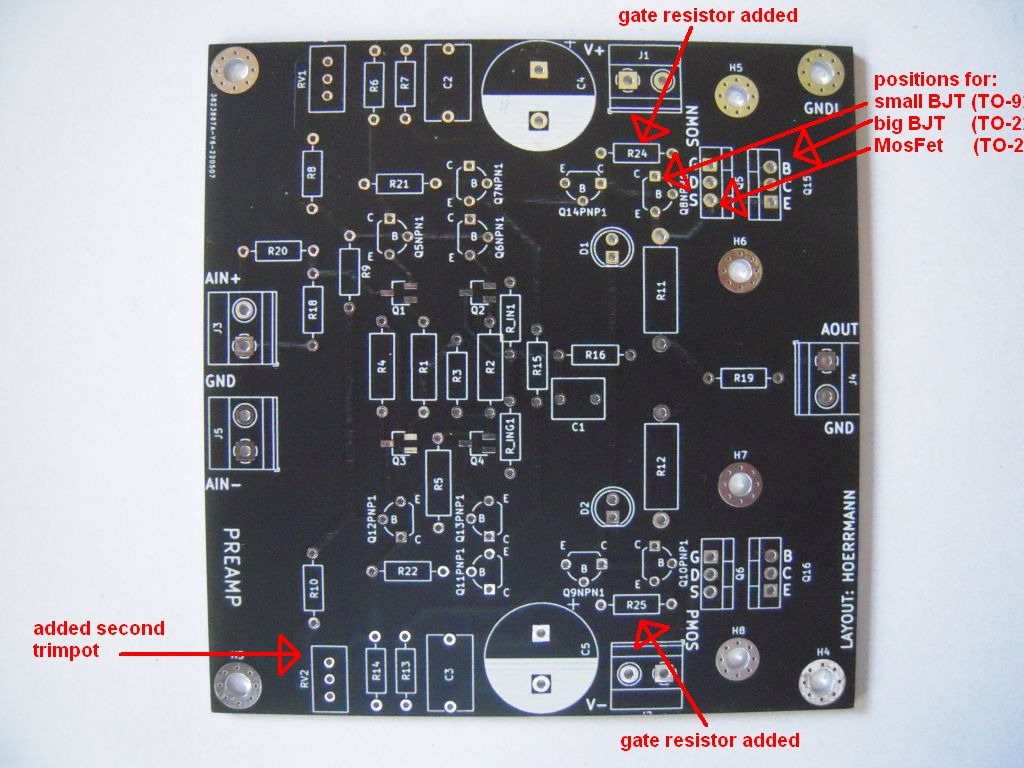

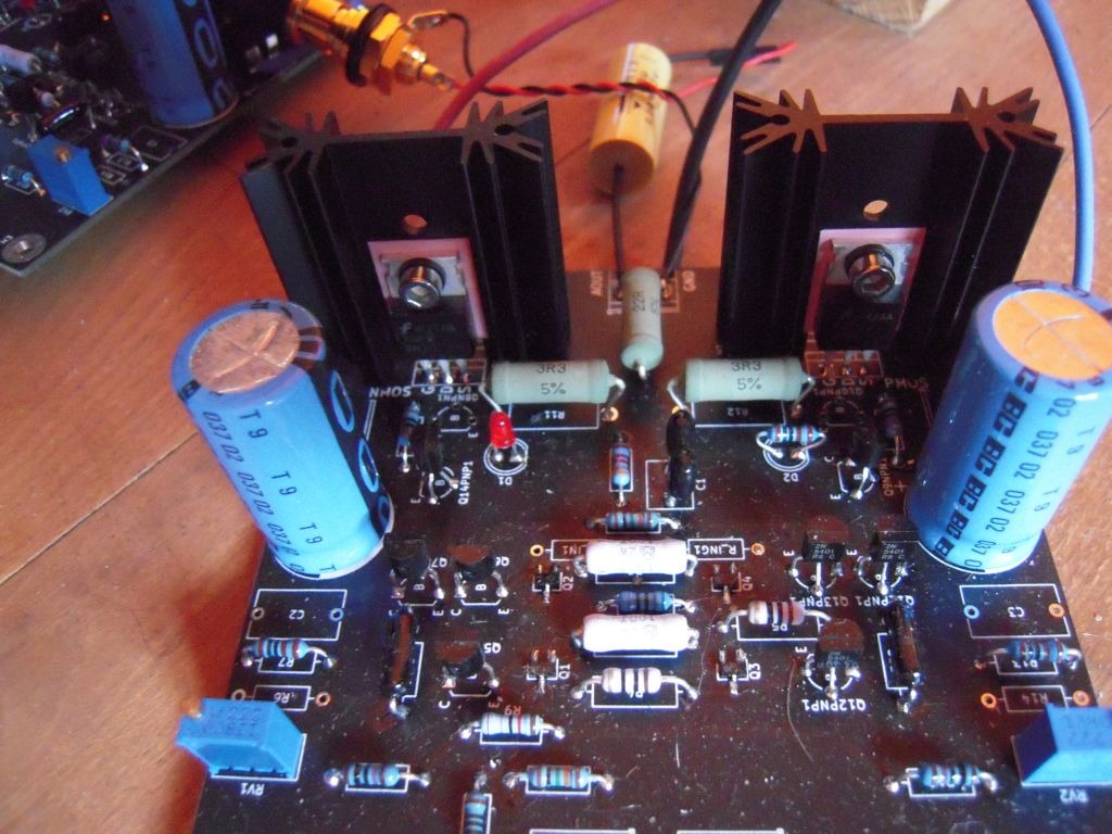

Hello RainfallSky,
hello all others, who want to experiment with Waynes Line Stage,
I made also my own pcbs of the WLS. Why? I wanted to be more flexible with some parts and
adjustments.
Don't misunderstand me - the original pcb from the store is pefectly fine! I have built 2 WLS
on the original boards.
Some pics and what I have changed.
I changed the pcb in the outputsection to be able to use
TO-92 BJTs, TO-220 BJTs and TO-220 MosFets (for the MosFet I added a position for a gate-resistor).
I added a second trimpot on the negative side of the rails
I added a second position for another LED or any other part (like a resistor) in the outputstage
Cheers
Dirk 😉

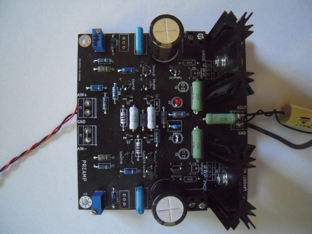

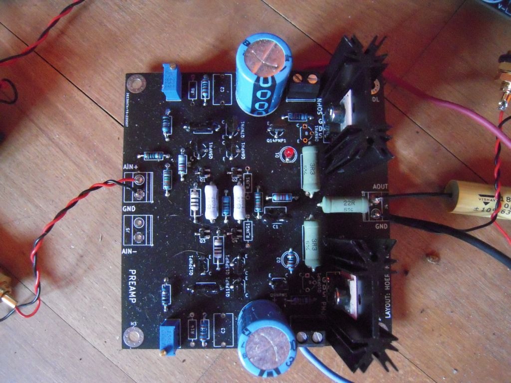

This is the first variant I have tried:
It needed some time to get it running. There had to be done changes to a lot of resistor values and to the trimpots. But it sounds very nice...
Cheers
Dirk 😉
- changed JFets to Onsemi 2SK3557
- changed all small BJTs to Zetex ZTX 851/951
- changed output BJTs to Toshiba TTA/TTC004B
Cheers
Dirk 😉

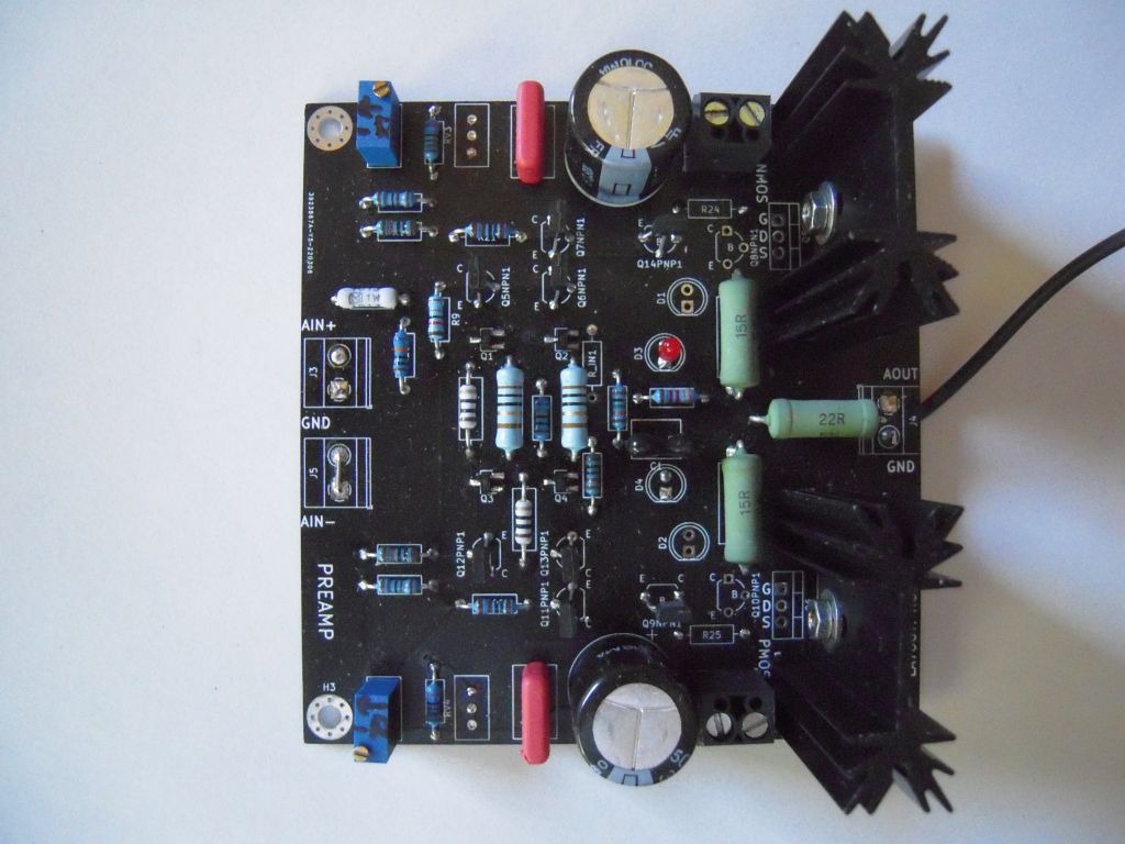

The third variant:
JFets: Onsemi 2SK2394
BJTs: Onsemi 2N5551/2N5401
MosFets (outputstage): Fairchild FQP3N30 / FQP3P20
The JFets have been chosen because of their very high yfs and they are super low noise.
The Mosfets in the outputstage are heavily biased - hot.
I am still testing, adjusting and listening to this version. I like it!

If you want to use 2SK2394, you should set the cascode voltages to say +/-9V or less.
Can go as low as 5V.
Patrick
Patrick

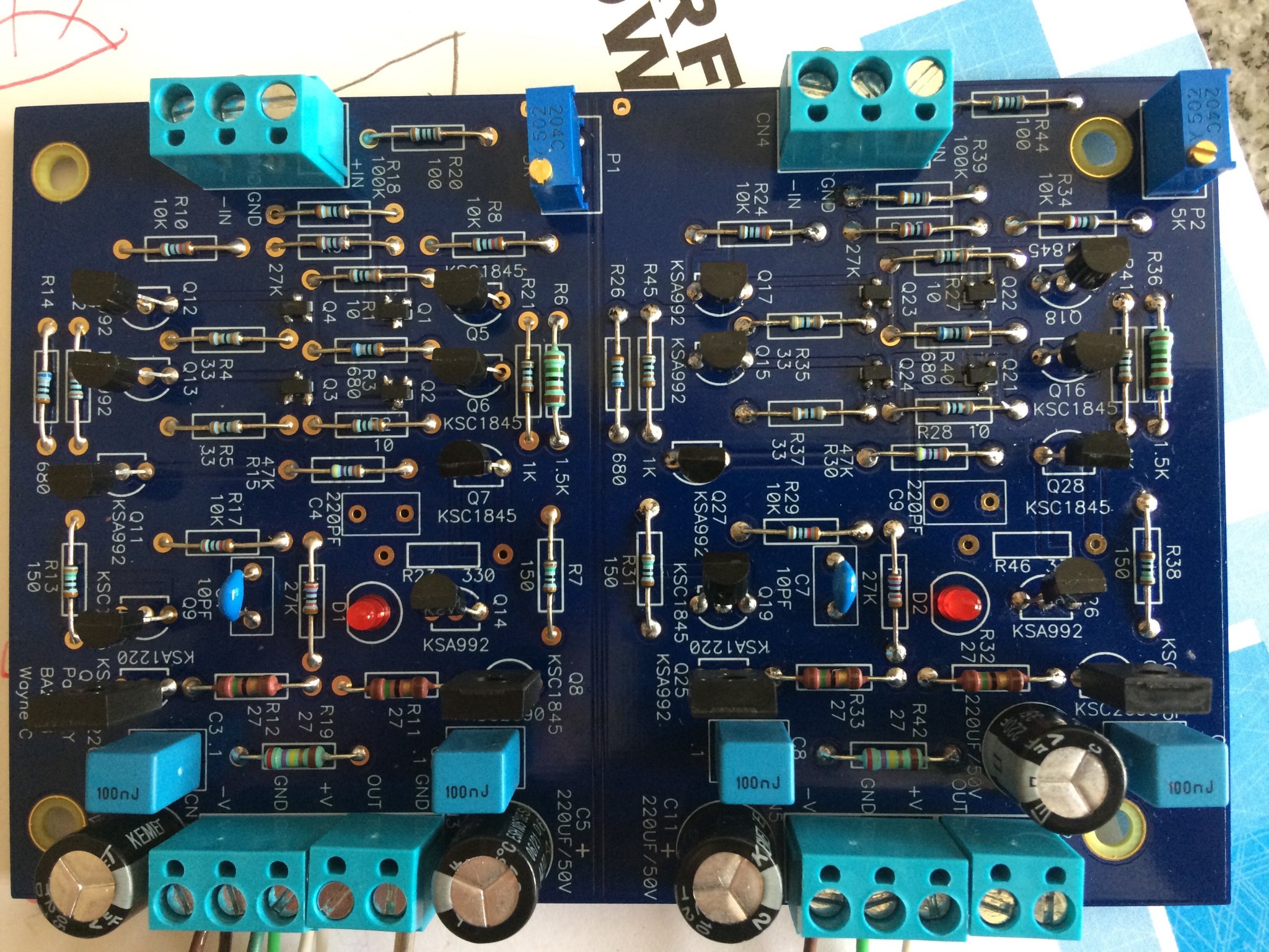

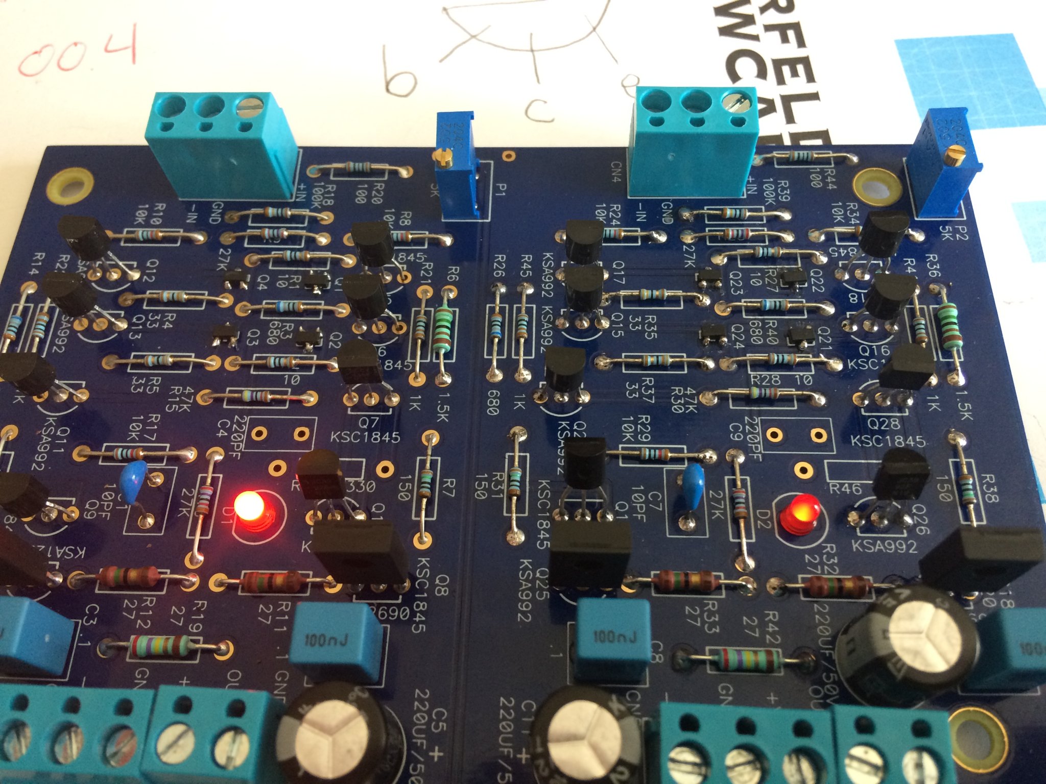

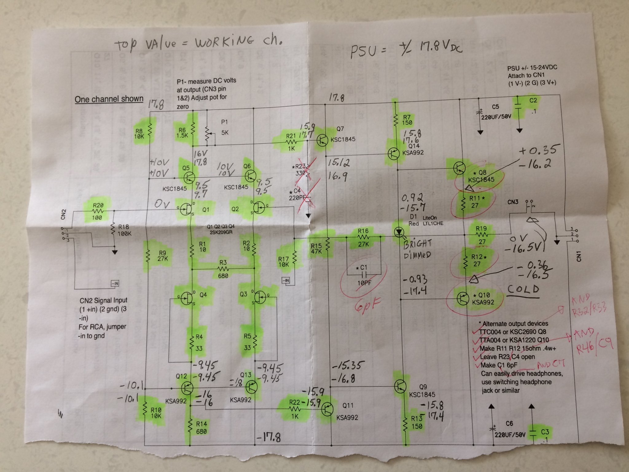

Hello
I have assembled the kit from the store but 1 channel isn’t working.(Left side of PCB is ok)
I have opted for the most powerful output devices.
The defective side has the led dimmed and the output is at nearly full negative rail. The trim pot P1 has no effect on the DC offset but without being powered P1 is working well and the overall resistance made from R6//P1 varies properly when turning P1.
I’m attaching the schematic with voltage reference to Gnd.
Top value is from the working channel and bottom ones from defective (right side of PCB)
Hope a good samaritain can help.
Thanks a lot.
Eric

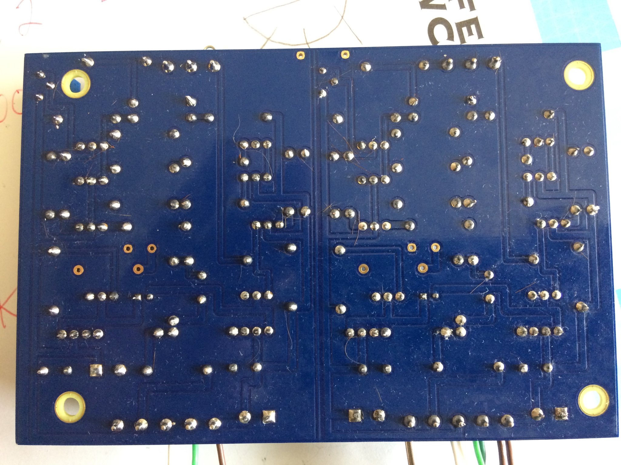

Try reflowing your solder joints on the 2sk209 fets. I had a similar issue and found it was a bad solder.
Maybe just a photo but it looks like Q16 at the bottom of the board have 2 pins connected by a solder drop.
