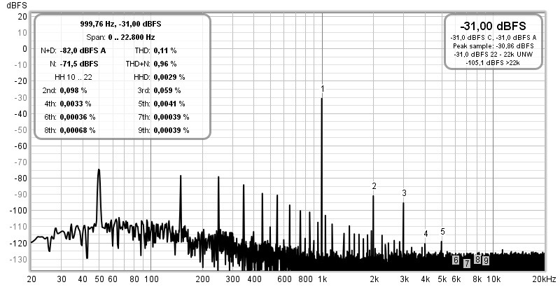

today I made my first measurements with my Focusrite Scarlett and REW on one of my
WLS-variants (variant3 = 2sk2394 ONSEMI JFets // 2N5551/2N5401 // output MosFets FQP3N30 /FQP3P20).
My signalgenerator from my Laptop puts out a sinus - signal (1 kHz) with a voltage swing of 0,068V (68mV).
Measured with my Fluke at the output (headphone out). Pretty low.
At the output of my WLS variant3 I have measured a voltage swing of 1,308 V AC at 1kHz (volume pot close to full volume). If I am hopefully right, this would equal a gainfactor of 19,23 or circa 25,6 dB.
Slightly higher 2nd harmonic distortion than 3rd.
Only some impressions. I hope I did not measure nonsense? 🤔
Cheers
Dirk 😉
There is something wrong with noise floor.
Do the loop first, no pre, just the output from scarlet to its input. Set the levels right, you should get -130 to -140 dB down.
Hello ZenMod,
the inputsignal is generated by a software/signalgenerator from my laptop (battery driven - to avoid more
noise from the laptop -smps).
That 1 kHz -sine-wave (0,068 V AC) is sent from laptop / headphone out into the input of the preamp.
At the output of the preamp the signal is sent to the Focusrite Scarlet (to the line input).
From the Focusrite Scarlet the signal goes into my PC (not my laptop) with REW.
So I didn't made a loop measurement = REW as signalgenerator and analyzer.
I hope this is understandable?

The noisefloor of the measurement setup got down to circa -130 dB (as Adason mentioned above).
Cheers
Dirk
Now the measurement of the WLS_variant3 looks a bit different...

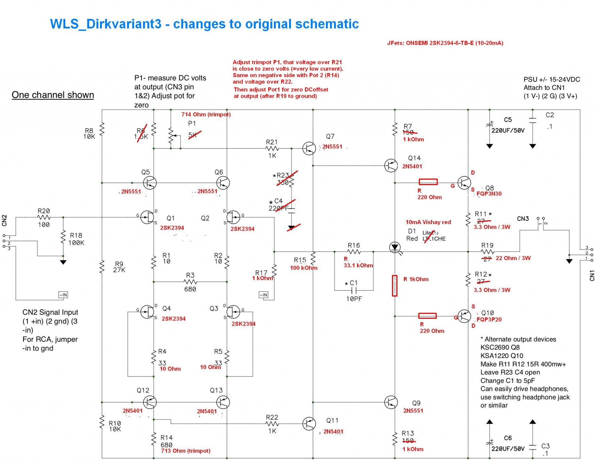

This is the schematic with parts-changes I have done.
If you want to try this: no guarantee or responsibilities from my side!
You do this on your own risk! I am still playing with this.
The JFets have been carefully matched (two quartets)
All BJTs have been carefully matched NPN-PNP (HFE at 180)
The MosFets in the outputstage have been matched N-Mos - P-Mos.
All actives have been matched from left channel to right channel.
Rails are on +-20 V DC.
0,162 V over 3.3 Ohm bias resistors in outputstage = 49 mA

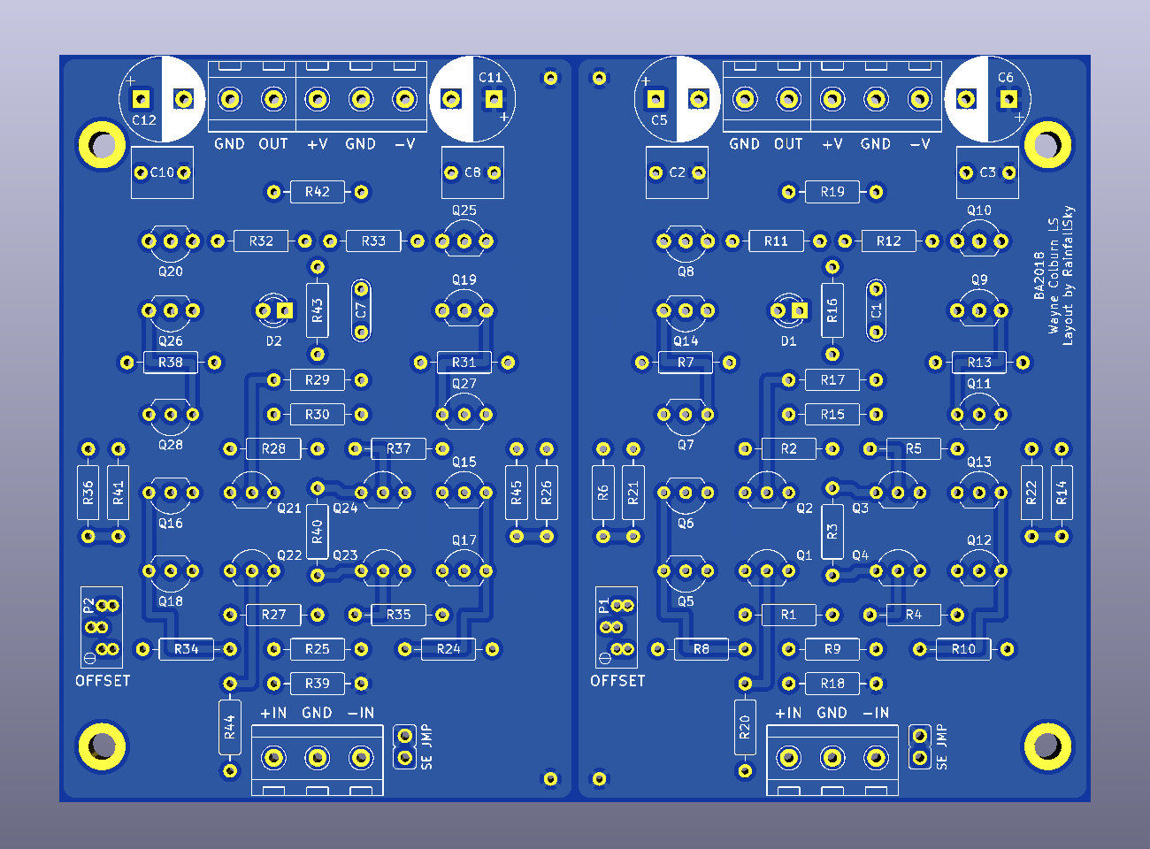

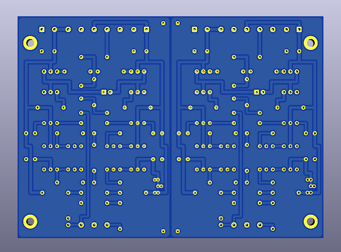

After a few cosmetic and not changes I sent my fully through hole version in production.
Those boards would be blue color, lead free HASL and 2mm thickness.
There was also an option to convert it free to ENIG for free if fab so decide but I think it will end up HASL.
Feel excited because it's the first time I sent something I made in KiCad to manufacture.

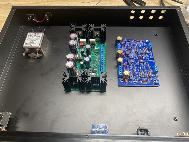

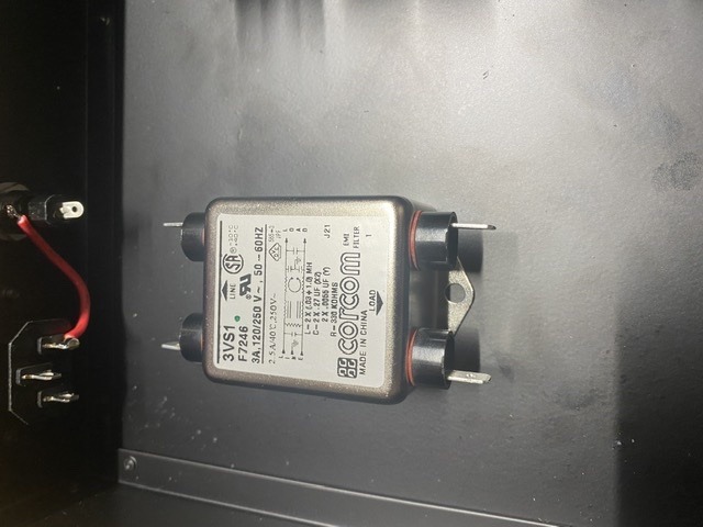

Does anyone use emi filters? I bought this one locally at an electronics store but wondering if it’s worth adding to my preamp build.
