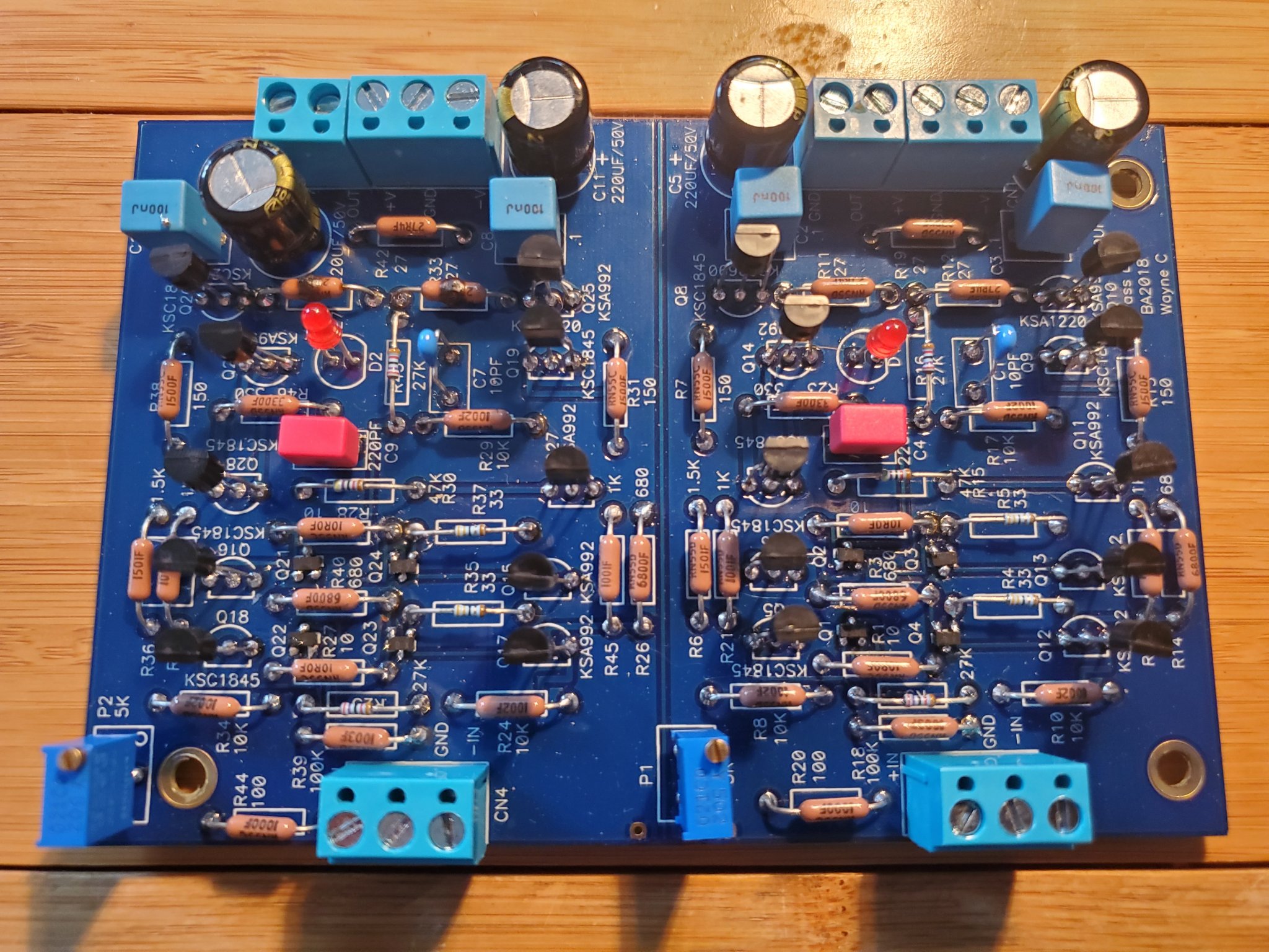

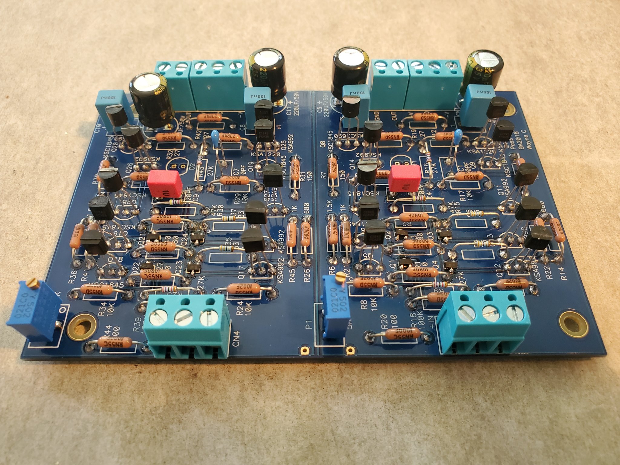

Here's what mine did when powered up:
Wayyyyyyyy too much smoke to want to continue, or try to unravel.
Going to do an iron pre instead next. Already have too much gain anyways. Perhaps I'll return to this one later.
Hope it turns out allright! Jfets are the main culprit in this circuit. Always start ANY troubleshooting there.ZM, can you give a link to the right kind of flux? I just built three of these boards without it. I looked closely at the results, and the SM parts seemed OK, but I guess we'll see. I'd hate to have to redo them.
MZM tought me, and I have passed this advice along many, many times: use flux on those legs, preferably liquid and not grease. Then carefully and thoroughly clean it all off. Take care around the JFET to rinse it all. I bathed it all in alcohol several times. Ps: don’t rush, let it all dry before applying power 🙂
Then, verify with beep test or ohmmeter solder joints by connecting one probe to jfet legs, and the other to next point on PCB, usually a resistor leg. If resistance is low/beep test checks out ok, you are probably OK. If not, resolder, those joints can look OK and not be.
Be very careful if you replace a JFET, so you don’t damage the pcb underneath. Also, make sure no flux is left under the jfet.
PS: unstable offset, in any degree, is giveaway number one. It should drop slowly slowly and then settle. Any jumping, you need to redo your work.

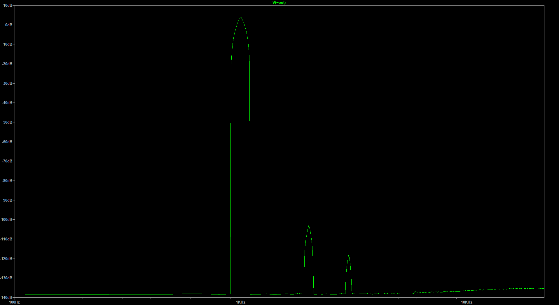

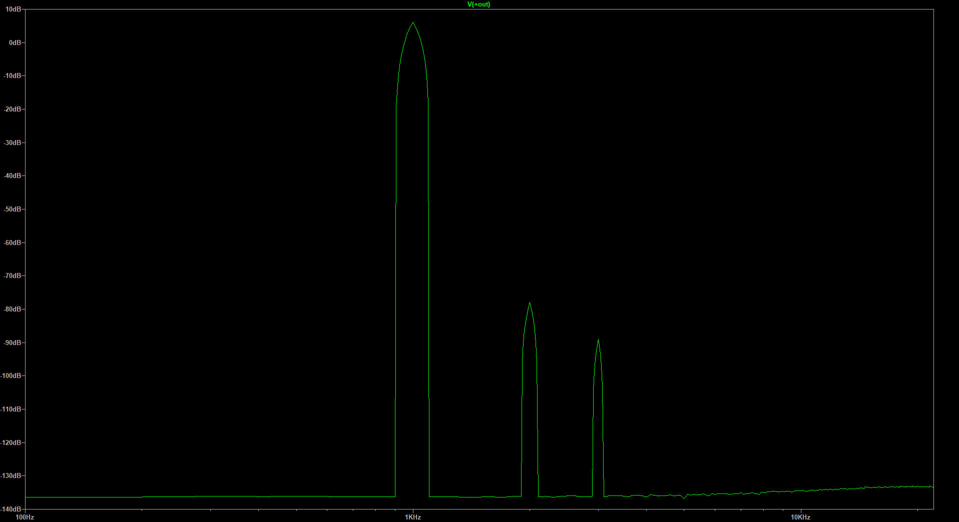

Here is the sim experiment with a gain of 3.
Sim is my version of parts but you can see the idea.
V1 is R16 20k, R17 10k.
V2 is R16 30k, R17 15k.
Same V out.

Btw: it might be interesting for the greedy boys to know whether the sims show increased tendencies of oscillation in changing these values
With my parts? Classic linestage looks like a THD H2 H3 generator machine in my sim..Very nice! Could you consider simming R17 @ 20 and 25k, leaving the feedback resistor at stock 27k?

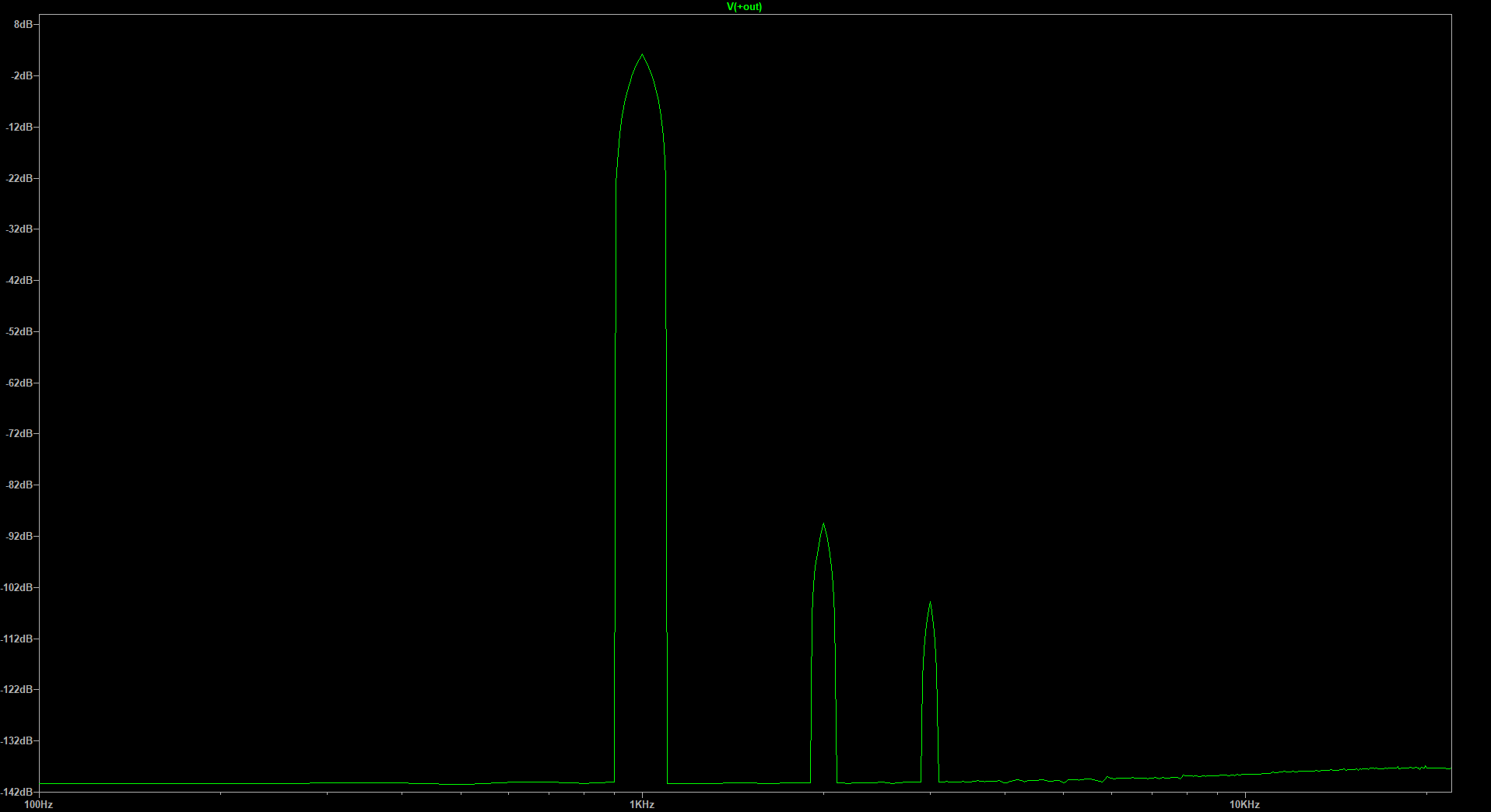

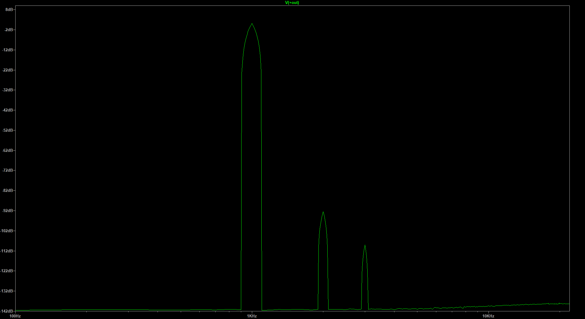

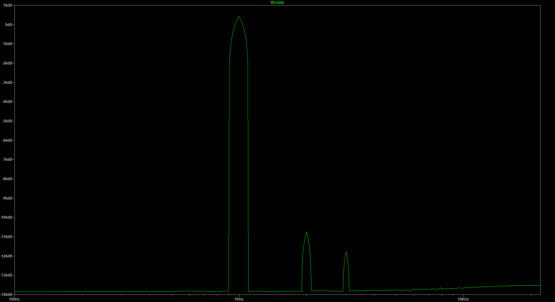

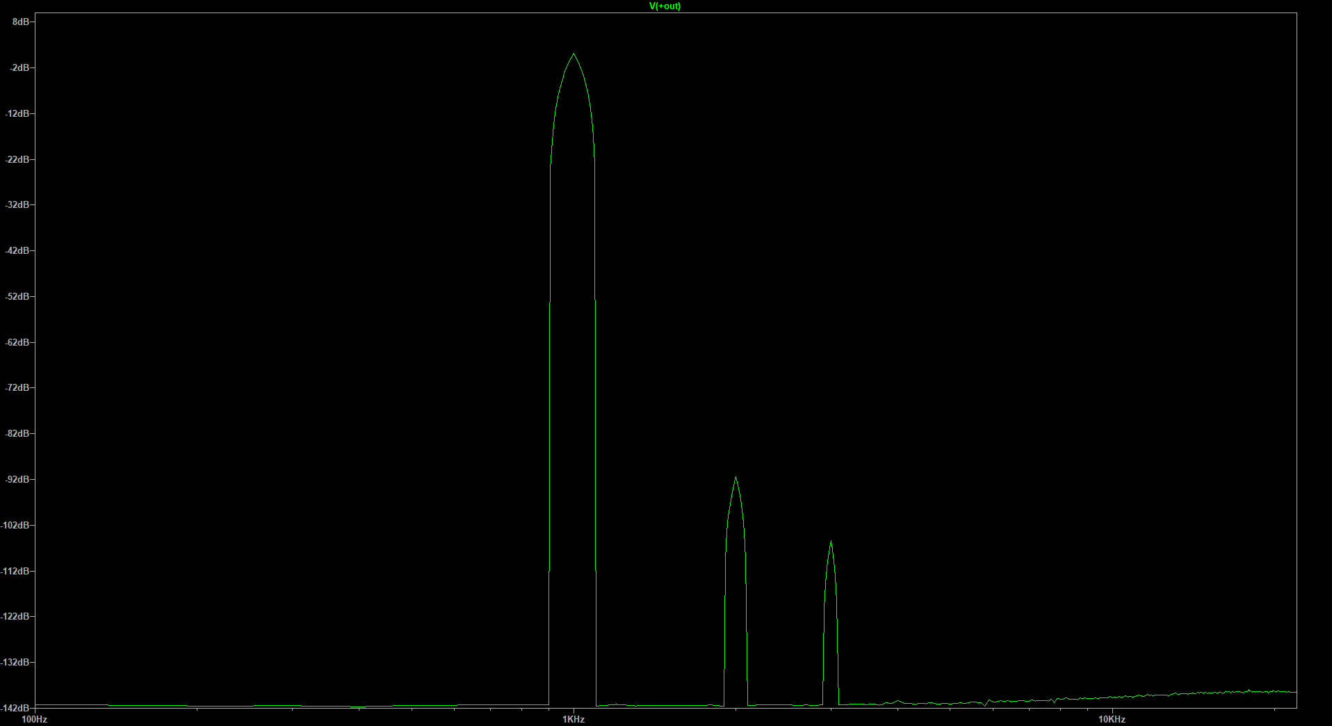

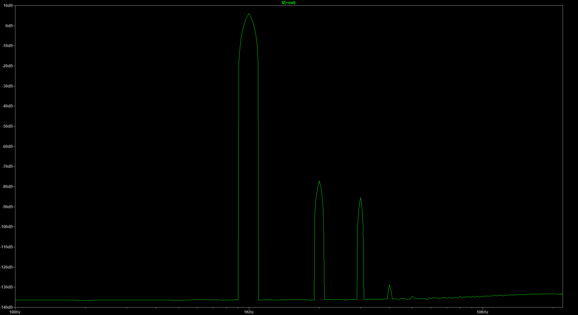

Okey here is more classic linestage with Toshiba TTC004B / TTA004B at the outputs.
V1: R16 27k, R17 20k
V2: R16 27k, R17 25k
Noise floor drops with lower gain.

This is the first time I’ve heard of one releasing the smoke… can you post a photo or two so we can try to autopsy?
Those was with 15V, now with 18V.Thank you!! 🙂
V0: R16 27k, R17 10k (3.7 gain) 15V
V1: R16 27k, R17 10k (3.7 gain) 18V
V2: R16 27k, R17 20k (2.35 gain) 18V
V3: R16 27k, R17 25k (2.08 gain) 18V
Certainly 😉
I know whatever transpired here was somehow my fault...
Pre-smoke:
Post-smoke:
I pitched the whole thing in the trash after it went up in flames, so theres a little gradu on there from that. Wanted to make sure I wasnt tempted to pilfer parts that could cause future problems.
I used the same regulated supply in a temp case I've used with my BA3-FE and NuTube preamp. I did relocate the PS boards in the case but a quick check with the meter had it putting out 24v unloaded, business as usual, before I connected this one.
