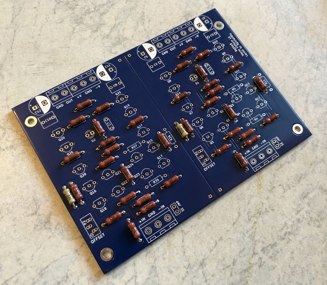

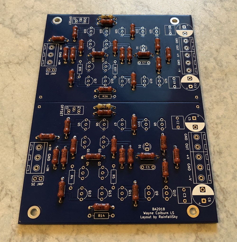

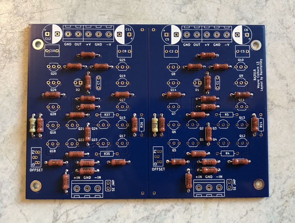

If D2 has a flat side I cant see it, was just the unequal length legs..
I'm 100% certain netiher LED made light before the poof.
Edit; also - C7 has obvious burn sign not visible in the picture.
That jumper shouldn’t matter.
-in should have a jumper to the input gnd, but that shouldn’t cause a fatal problem.

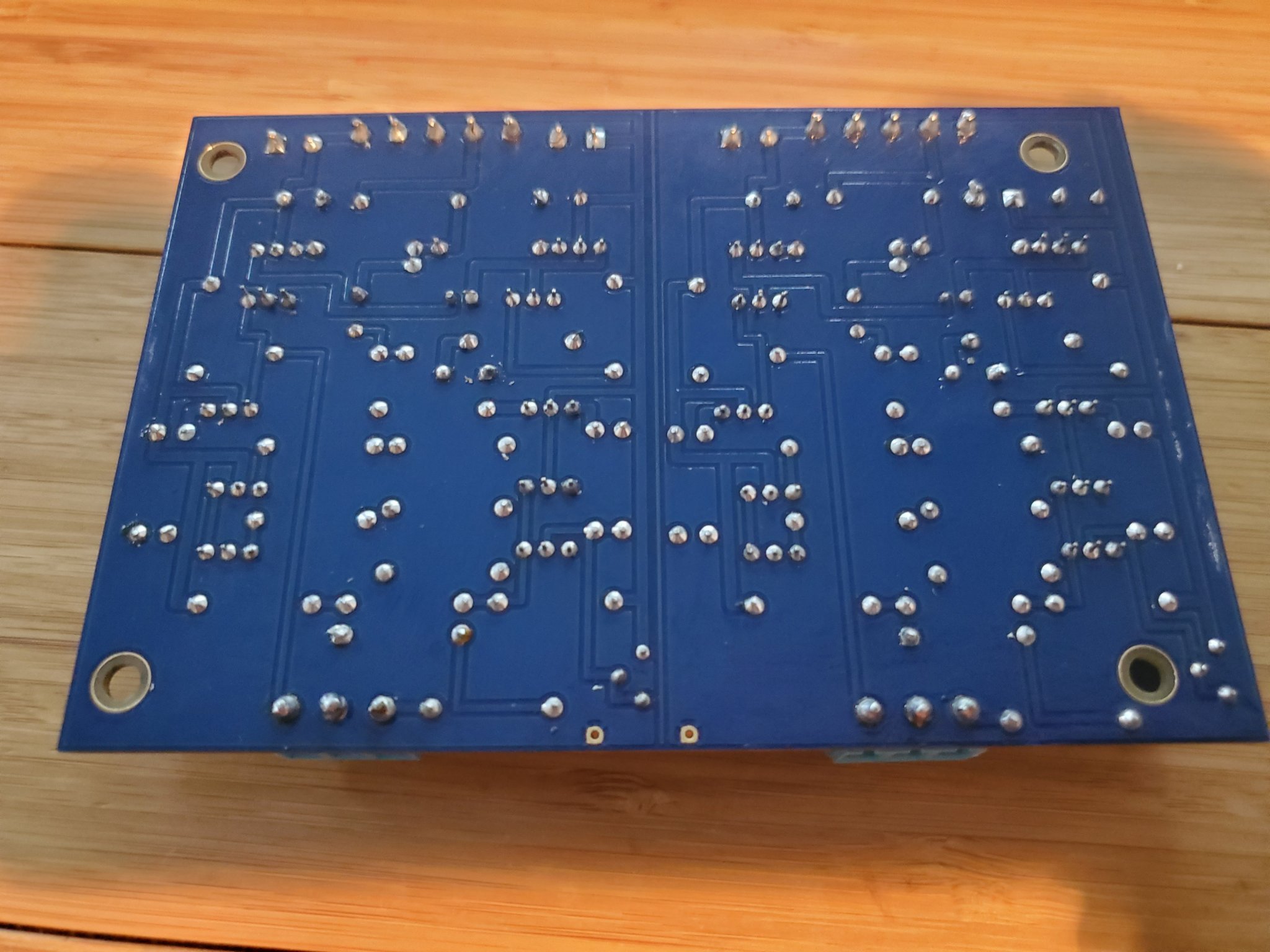

Can you post a photo of the bottom of the board?

I flow everything twice using a fine tip for the iron. Havent had a cold joint yet...but today is a day of firsts.
The rest of the parts for an M2 just arrived today...was building this to use with that.
One more edit: I also measure everything before it gets stuffed...often twice. Once when it arrives and again before it goes on the board.
Thanks for the pointers. I have to assemble my VRDN, then I'll be able to test it out.Hope it turns out allright! Jfets are the main culprit in this circuit. Always start ANY troubleshooting there.
MZM tought me, and I have passed this advice along many, many times: use flux on those legs, preferably liquid and not grease. Then carefully and thoroughly clean it all off. Take care around the JFET to rinse it all. I bathed it all in alcohol several times. Ps: don’t rush, let it all dry before applying power 🙂
Then, verify with beep test or ohmmeter solder joints by connecting one probe to jfet legs, and the other to next point on PCB, usually a resistor leg. If resistance is low/beep test checks out ok, you are probably OK. If not, resolder, those joints can look OK and not be.
Be very careful if you replace a JFET, so you don’t damage the pcb underneath. Also, make sure no flux is left under the jfet.
PS: unstable offset, in any degree, is giveaway number one. It should drop slowly slowly and then settle. Any jumping, you need to redo your work.

6L6 called it, my LEDs were backwards.

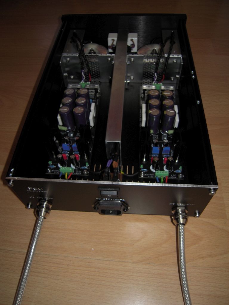

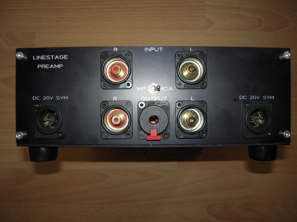

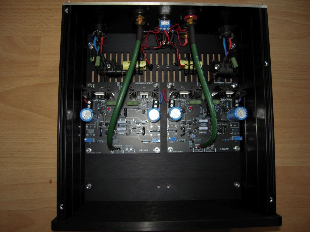

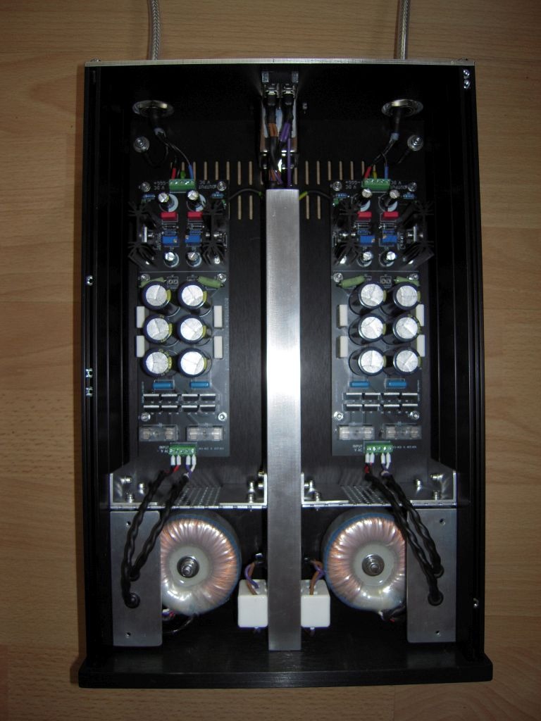

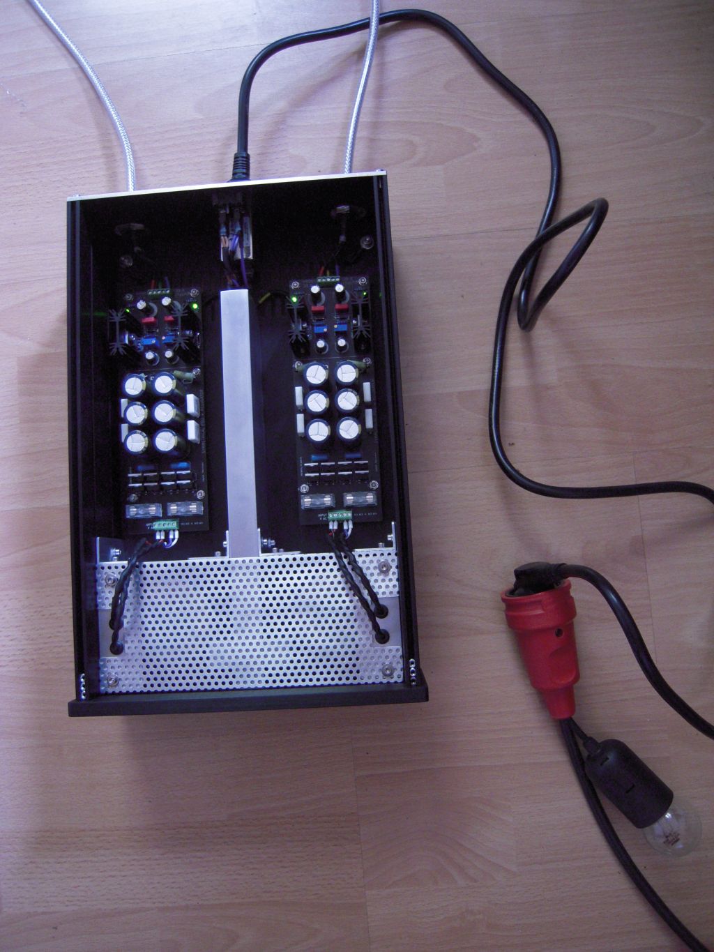

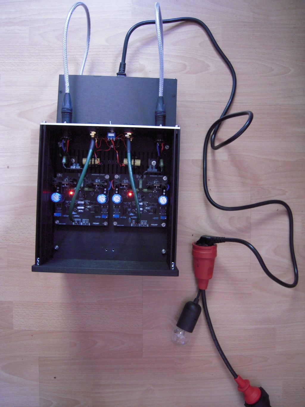

Hello Waynes linestage-builders,
I have put my WLS - variant3 and the PSU into some cases. Am I allowed to call it WLS? 🤔
It is a variant. Same circuit as Waynes linestage - different active devices.
JFets 2SK2394-6-TB-E Onsemi (very low noise), 2N5551/2N5401 and Fairchild Mosfets FQP3N30/FQP3P20.
It is a dual - mono - build.
It sounds very detailed and clear. I like it. But I am still testing. Not a lot of time for listening at the moment.
The PSU got a very long case (350mm) - thanks to Modushop / Gianluca. It`s also dual mono.

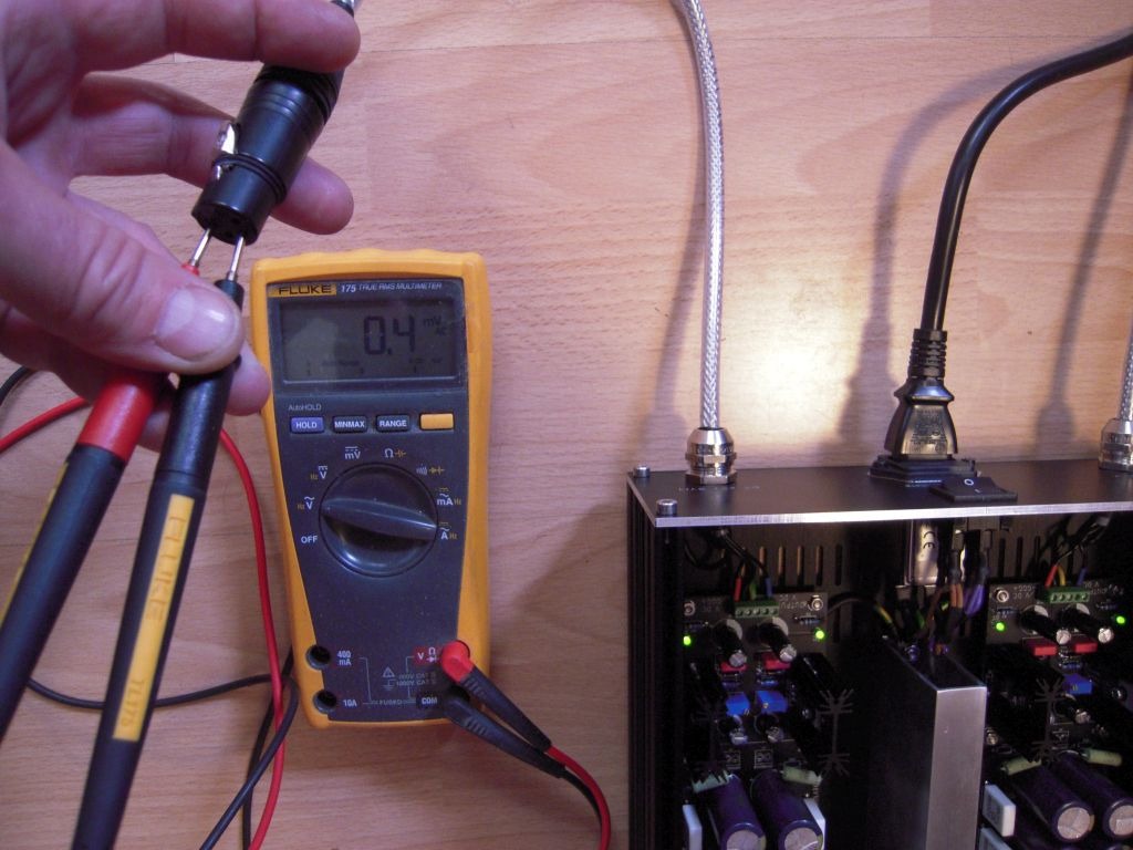

The outputvoltage is adjustable up to +-22V DC. Adjusted to +-20 V DC.
Measured ripple without load was around 0.4 mV.
Cheers
Dirk
