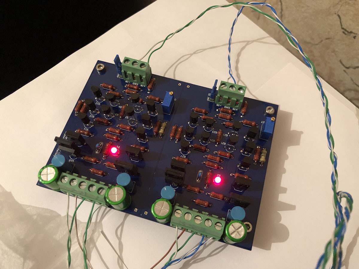

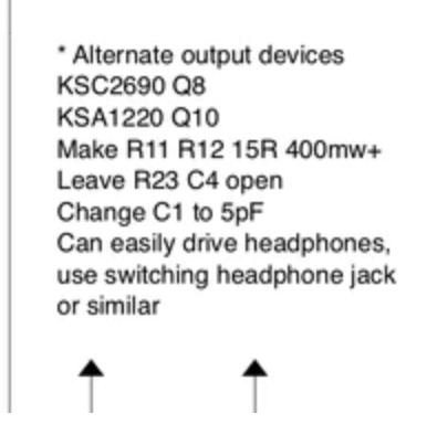

Just to check (and sorry for the blurry picture) but did you build the board using the components designed for headphone capability? If you just use it as a normal preamp to amp to speakers does all sound correct?I finished to solder my version of Wayne's LS this night.
Set DC out and tryed to listen with headphones.
There was a sound at the output but with distortion and also volume level was not even loud with LS connected directly to source.
Was dead tired to search what could go wrong and debug.
And I am still tired beacause I slept only a few hours.. 😴 So will only do simple measurements this evening.
A few suspicion things:
Both channels behave and sound the same.
LED's change brigtnes during music playback but not during playback of silence or tones.
My output transistors should dissipate 478 mW according to spice but they are barely warm.
I preset trimmers before solder from ltspice figures and DC out was only 0.01V and 0.04V and easily set to zero.
I did't have 0.1 mF film cap so I solder 0.01 mF. I hope this is not some kind of weird oscillation that goes berserk with music signal.
My headphone is low impedance, 40 Ohm.
Cheers

Yes, designed for headphone capability.Just to check (and sorry for the blurry picture) but did you build the board using the components designed for headphone capability? If you just use it as a normal preamp to amp to speakers does all sound correct?

Will start to search for errors this evening after work.
I hope it's just a simple part or wiring mistake.
As always, please post a series of well-lit, in focus photos and we can start the debugging process.
There was no voltage between R11 R12.
I use 2SC4793 2SA1837 at the outputs.
Rechecking pinout it seems I solder them backwards.
KSC1845 is ECB and 2SC4793 is BCE...
Those was saved in my text files as the same pinout.
doh! 😵
Thanks everyone!
doh! 😵
Thanks everyone!

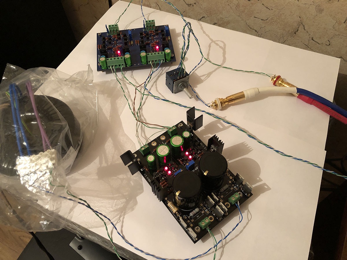

Folks:

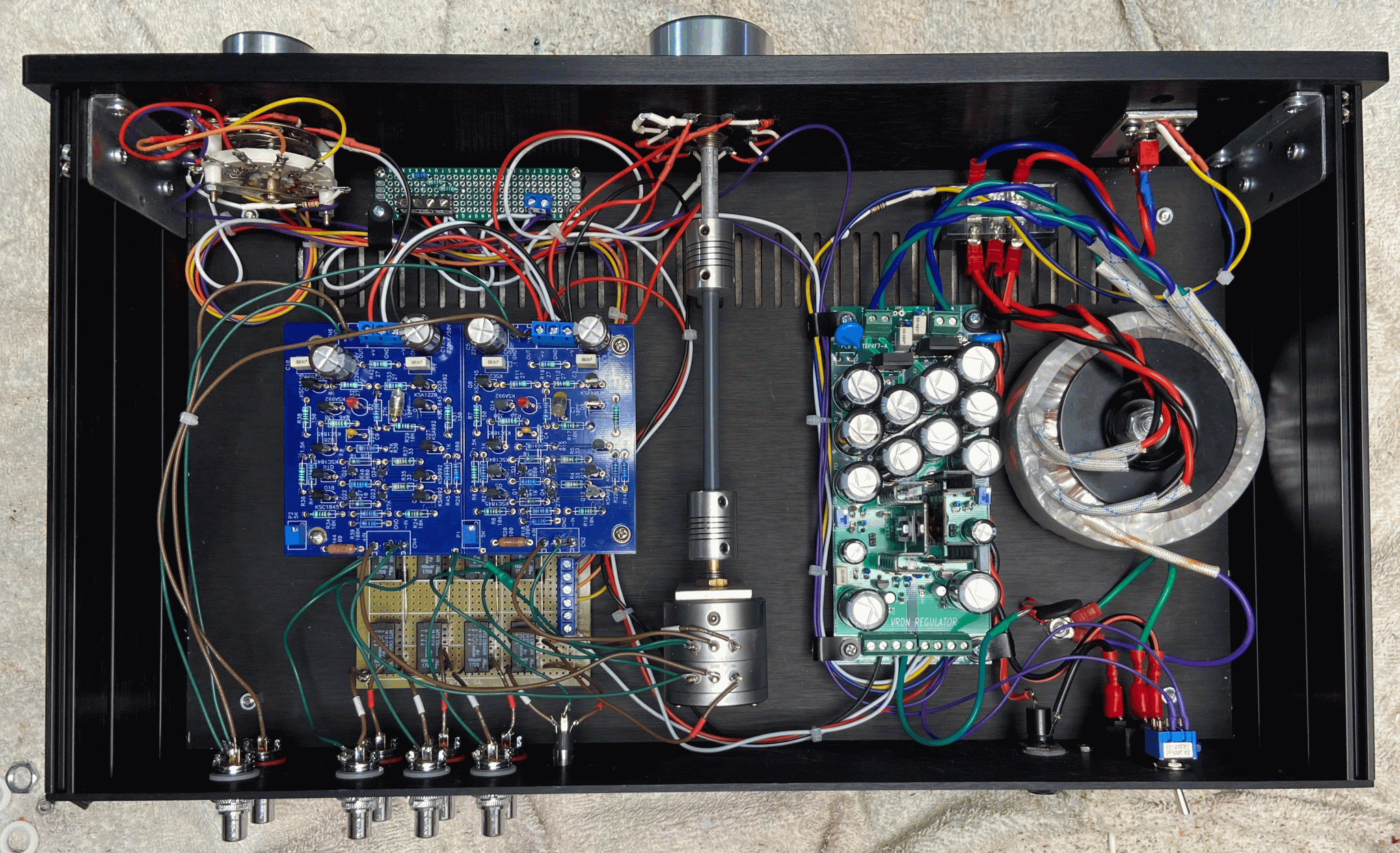

I spoke too soon. I recently finished a simple BA2018 preamp for a friend and have noticed a quiet 60 Hz buzz in the left channel. The hum is definitely coming from the preamp. The volume of the hum does not vary based on the selected input (the source selector relays also switch input grounds) or the position of the attenuator. All of the solder joints on the left channel have been reflowed, to no effect, and the wires seem properly dressed to me. I'm scratching my head here and would love some sage advice. But all suggestions and questions are appreciated!
Scott
Scott
MZM said recently, or long ago, "twist all wires that carry AC", which obviously includes signal leads. So, looks like both sets of the output wires are not twisted, nor are the wires to your volume control (which look a bit too long).
All good advice above. (Particularly twisting the in/out wiring)
A couple of easy-to-try things -
1) Loosen the bolt of the transformer and twist it left/right, see if there’s a quieter orientation.
2) Move the power feed wires out from under the corner if the amp pcb, I’d try moving the to the other side of the pot away from most everything, if you can.

Front LED near ON/OFF knob is too close to AC wires and trafo.
Backlite knob is also right near AC input.
I would start from there.

Thanks for the suggestions -- I'll be implementing many of them starting later on today. One small point: the hum can only be heard from the left channel and there is a shared power supply, so isn't it more likely that the problem exists somewhere within the portion of the preamp that is dedicated to just the left channel?

I may be wrong but it seems ground connection to your volume potentiometer wired strange.
Edit:
Sorry my mistake.
I thought it looked like input grouds route to potentiometer one channel ground but now I see they don't.
Edit:
Sorry my mistake.

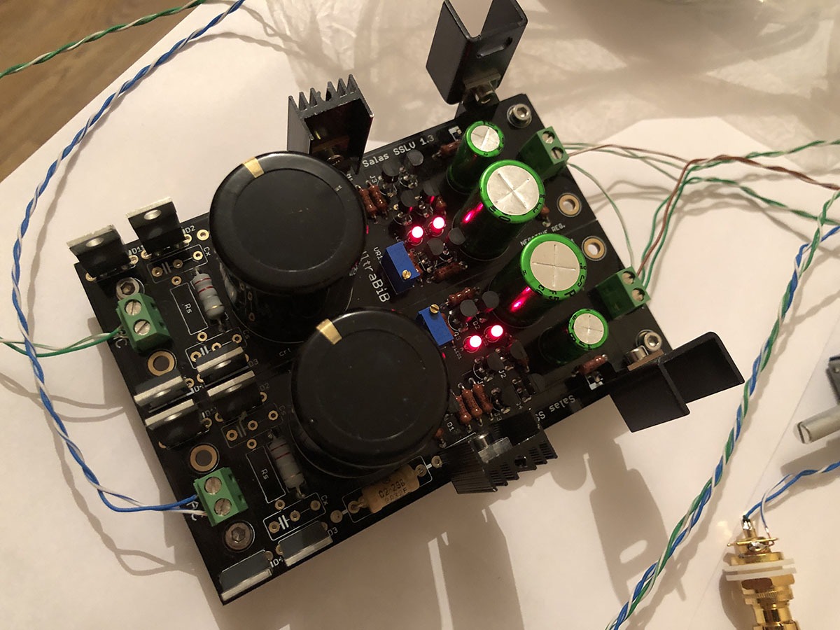

It turns out I am too have a very low sounding buzz that could be heard on silence or even when source is turned off.One small point: the hum can only be heard from the left channel and there is a shared power supply, so isn't it more likely that the problem exists somewhere within the portion of the preamp that is dedicated to just the left channel?
Buzz is not related to potentiometer volume level but on high volume levels with silence track I start to hear a hum.
I suspect buz is related to grounding and/or reference GND. Mine right now doesn't even have a casing.

All sorted! Thank you, very much, for the suggestions! For the record, I implemented and/or tested the following:
Unfortunately, after each change or test the hum persisted. All solder connections on the left channel were again reflowed. I could no longer clear the two output ground vias and was forced to connect the output grounds to the negative terminal on C5 and C12. Happily, that wasn't a problem.
It turns out the hum resulted from the way in which I connected the output grounds. The ground wires ran from the BA2018 to the outputs, where the two ground wires then connected to each other at the L and R outputs. The problem was that the preamp was connected to mono block amps. When I separated the ground wires (L channel ground solely to L output, R channel ground solely to R output) the hum vanished. I suppose the problem wouldn't have arisen with a regular stereo amp. Lucky me!
In any event, thank you, one and all, for the support!
Scott
- Rotated the toroid
- Moved the power feed wires further away from the BA2018 pcb
- Disconnected the power to the relay board (to assess whether the relay board was the problem)
- Swapped preamp outputs (to verify the problem did not lie in the amps, and yes the hum moved to the other channel)
- Twisted both the wires to the attenuator and the wires to the outputs
- Raised the BA2018 another 12mm away from the relay board
- Disconnected the wires between the attenuator and BA2018
