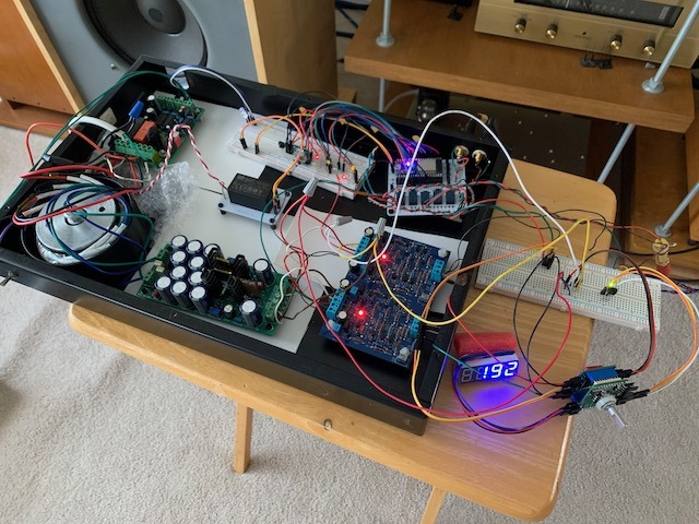

Looking for some advice on best implementation for a fully balanced preamp. Is Wayne linestage a good choice? the build looks straight forward. so far have done Aleph J, ACA mini, KGHV Carbon Stax headphone amp and crossover network,. Love the DIY audio so much that I am trying to getting rid of my commercial rigs over the years…
I would need a 4 pole attenuator and selector for fully balanced mode. Any recommendations where to find a good quality stepped volume control with reliable relays other than Ebay? not fond of old school mechanical attenuators
Thanks for your help!

I know you said you don't like the mechnical attenuators, but the Khozmo attenuators are fantastic, and simpler than the relay-based ones.
I've used a 4PDT switch in some such builds. Very simple, and relatively cheap. Goldpoint makes a nice rotary selector, but it's pricier.
BTW, if you don't need pre-amp gain, then you can build a balanced B1 quite cheaply. Pretty amazing sound.

For me, when source is a DAC or SS output device, the Muses sound better than any mechanical attenuator I tried. I think it all depends on the application. For example, my Goldpoint (100K) sound inferior to the Muses if the source is a DAC but sounds great when using a phono or tube output CD player as source. I have three Muses (20k per spec sheet) VC and really like them. I spent $60.00 per completed unit including remote control IR receiver assembled by me back in the day not including the Adafruit display. One example is below.
Yes, a 4 pole rotary would work. I've used a 4PDT toggle switch for this purpose, too, and you can get a decent one for $15 or so at Mouser. Of course that limits you to two inputs. I'm currently wiring up a balanced B1 with a Goldpoint 4P rotary switch. That was about $80 and gives three inputs. If you want more, you can do a two-deck switch, which raises the price to $120 or so.
For volume, there is a 4 gang Alps pot that you can find on EBay for $30 or so. I've seen it a few other places, but not reliably. You could also go with two stereo pots. I'm doing this in the B1, because I need balance (in the other sense) due to hearing deficits in my right ear. The Khozmo pots are great but very expensive.
One thing you might consider: a mute switch. (Very convenient.) For this, you can use a very basic 4P switch. Wire the outputs to it and connect everything so that, when you throw the switch, the signal routes through a 10 or 100 ohm resistor to ground. Wayne suggested this strategy somewhere. It's what Pass does in their own stuff.

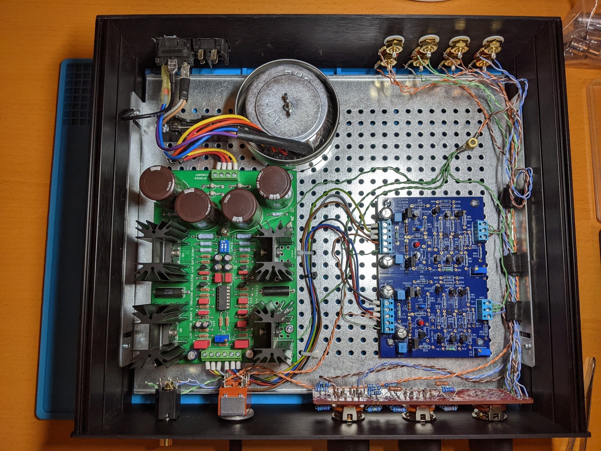

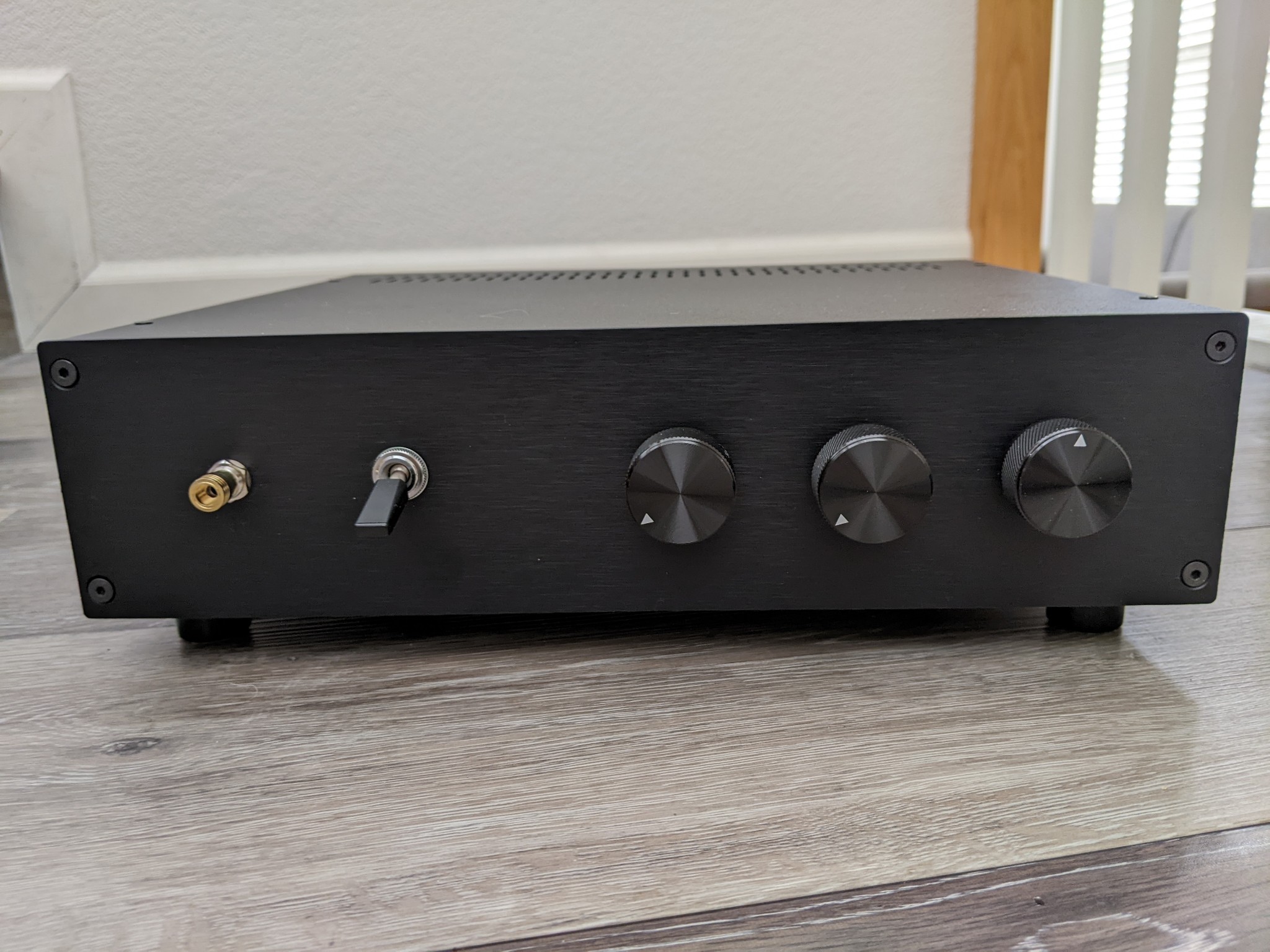

Big Thanks to many from this first-time builder! This forum has been an extremely helpful source of information as I completed the preamp. Thanks to all of you who contributed. And of course to Wayne for providing the design, having boards made, etc. Special thanks go to my local "go to" resource person here in Davis -- Bob Flocchini. Bob provided great advice every time I got stuck with this build. Here are the parts I used if interested.
Galaxy 2U w/Steel covers 330mm x 280mm/3mm black. plus chassis baseplate.
Mouser:
Neutrik RCA Phono Connectors - 568-NYS367-2, 568-NYS367-2
NKK Toggle Switch - 633-S333R
CUI Devices Phone Connector 6.35 mm Stereo ver - 490-SJ-63083A
Glassware:
FrontPanel PCB & Switches, Metal-film resistors (-2dB/-12dB)
Hookup wire, 2M-Teflon-FEP
Amazon:
Kaish 1-3/16" (30mm) Diameter aluminium potentiometer knobs
https://www.amazon.com/gp/product/B0B31GBTQB/ref=ppx_yo_dt_b_search_asin_title?ie=UTF8&psc=1
Power supply
Hotshot Model 73111
https://www.ebay.com/itm/Assembled-...Tracking-Regulator-w-Soft-Start-/322153708842
Oh, and some feet for the pre from an old Pioneer integrated I had around...
