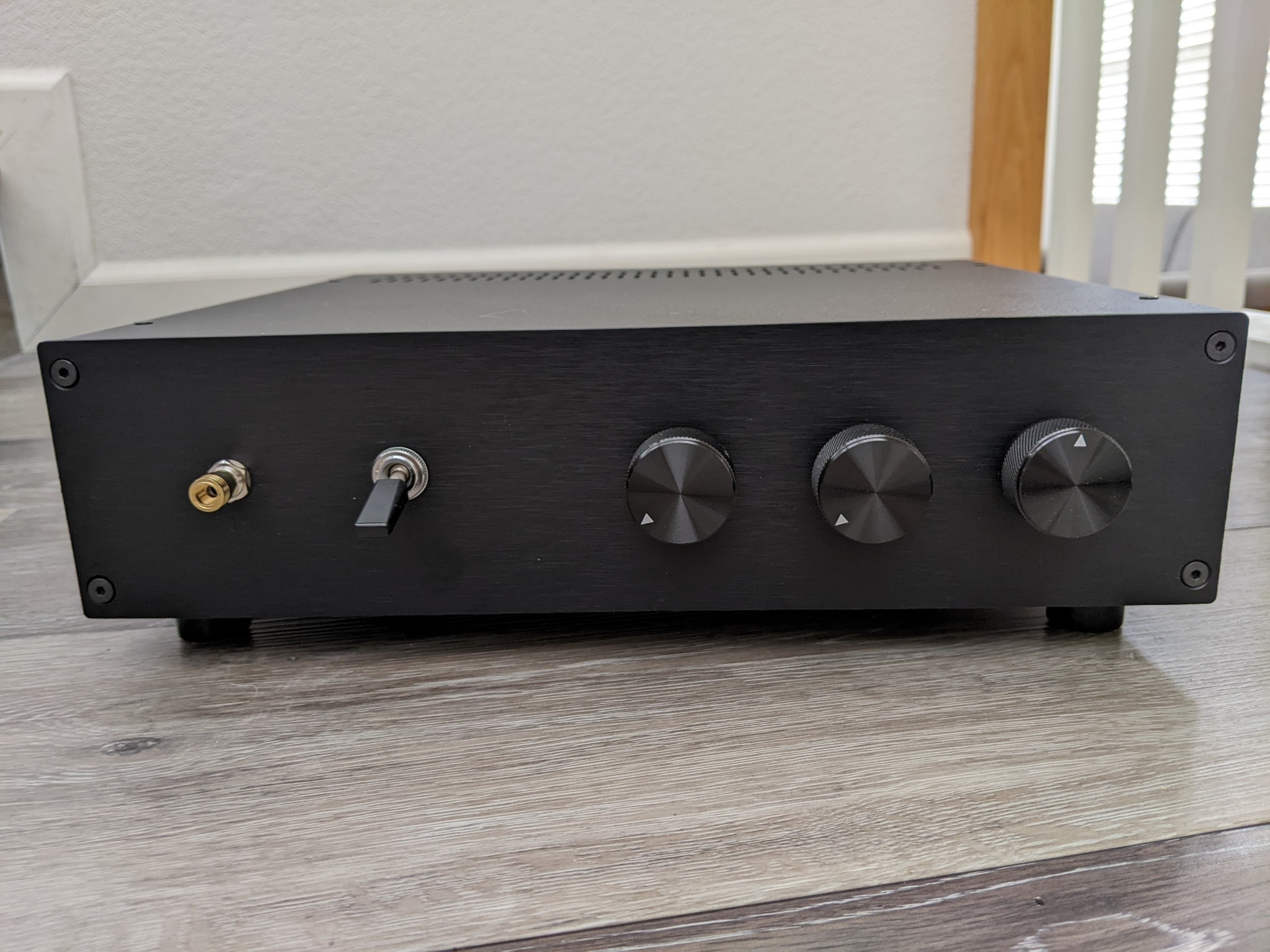

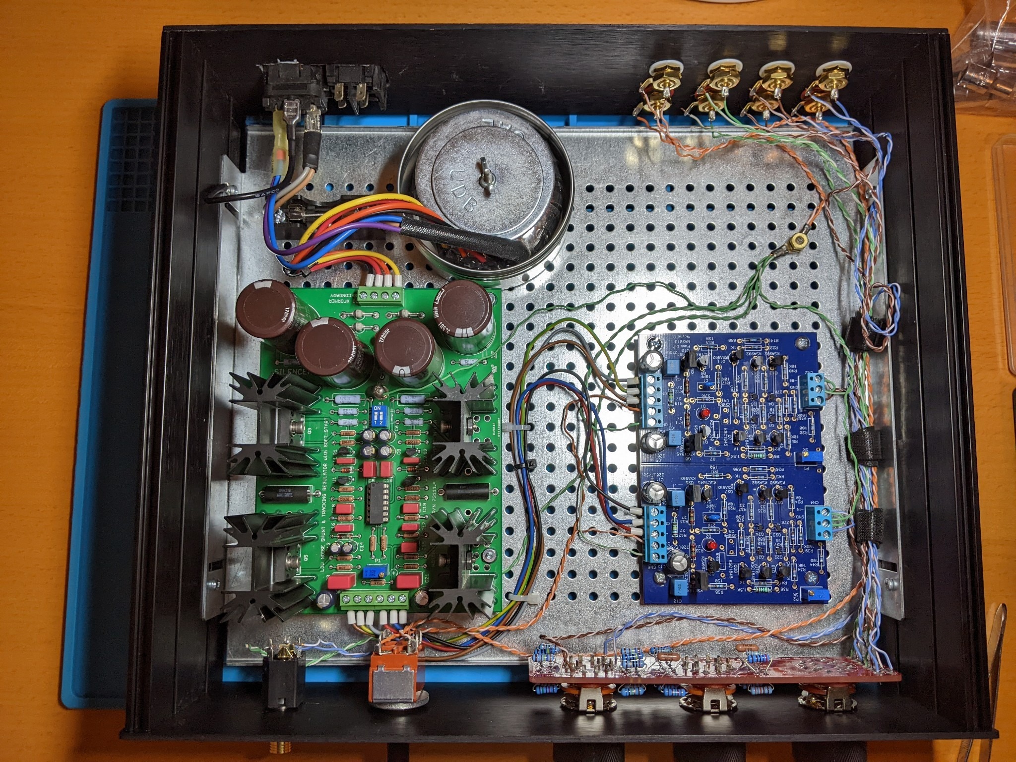

Very nice and stylish!Big Thanks to many from this first-time builder! This forum has been an extremely helpful source of information as I completed the preamp. Thanks to all of you who contributed. And of course to Wayne for providing the design, having boards made, etc. Special thanks go to my local "go to" resource person here in Davis -- Bob Flocchini. Bob provided great advice every time I got stuck with this build. Here are the parts I used if interested.
Galaxy 2U w/Steel covers 330mm x 280mm/3mm black. plus chassis baseplate.
Mouser:
Neutrik RCA Phono Connectors - 568-NYS367-2, 568-NYS367-2
NKK Toggle Switch - 633-S333R
CUI Devices Phone Connector 6.35 mm Stereo ver - 490-SJ-63083A
Glassware:
FrontPanel PCB & Switches, Metal-film resistors (-2dB/-12dB)
Hookup wire, 2M-Teflon-FEP
Amazon:
Kaish 1-3/16" (30mm) Diameter aluminium potentiometer knobs
https://www.amazon.com/gp/product/B0B31GBTQB/ref=ppx_yo_dt_b_search_asin_title?ie=UTF8&psc=1
Power supply
Hotshot Model 73111
https://www.ebay.com/itm/Assembled-...Tracking-Regulator-w-Soft-Start-/322153708842
Oh, and some feet for the pre from an old Pioneer integrated I had around...

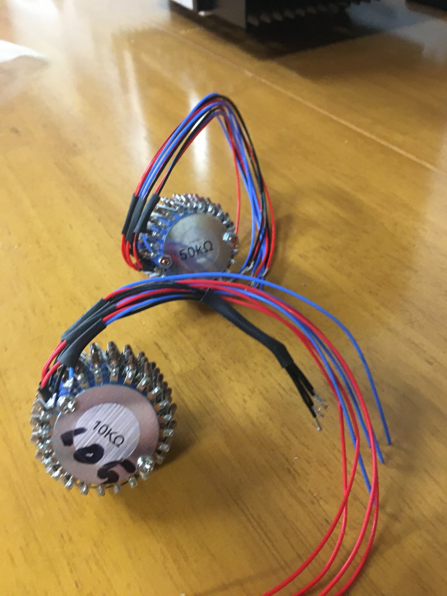

Ok. I can go the route of a SINGLE pot to accomplish this. Can I get an idea of which to buy for my purpose? and any wiring diagram?
Have you tried that one? I have a single-ended khozmo but getting a Khozmo in balanced is getting pretty rich.
Only once, I've used these on several projects and have these two left. 24 step four gang vishay dale resistors. I've found both types on ebay and ali, they are harder to find lately.
I've even found relay / resistor balanced controls along with selectors using relays and remote control, I used that on my Balanced BA2018 preamp.
TKD 4CP-2511
hificollective.com are listing it.
acoustic-dimension.com and partsconnection.com have the stereo version in the catalogue, how far away are 4 channels?
or some others here: http://www.tkd-corp.com/en/product.html#stepvr (gets my drooling)

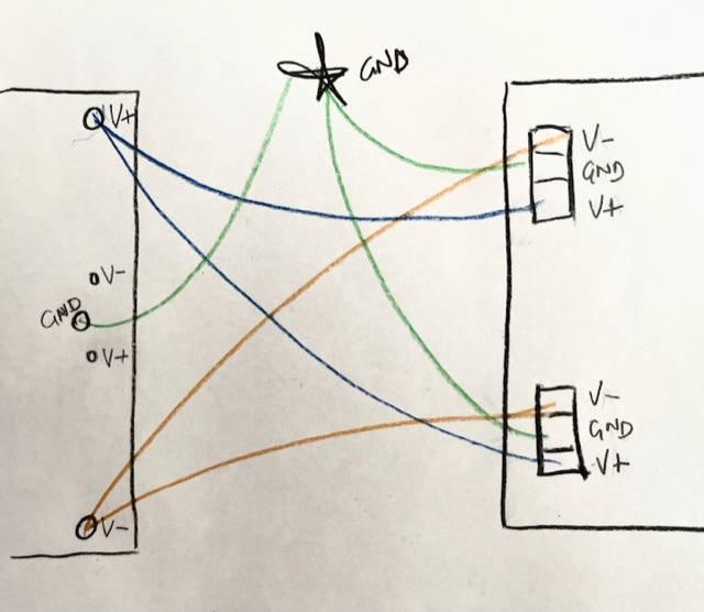

Hi all. I’m upgrading the power supply of my line stage to the glassware dual LV reg. I can’t find it written anywhere but based on some photos I’ve seen in the thread, it looks like this is how it’s wired to the LS. Can someone please confirm if I have the wiring right?
Also, I bought one of THESE in the 12V version for switching power on and off but I can’t get my head around how to connect it with the dual supply. Do I actually need the 240V version and put it between the IEC and the transformer? Or is there something else I’m not getting?
Could I connect it between the two primaries that are joined to make the transformer 240V? Sorry if these are dumb questions.
Thanks in advance 🙂
Thanks in advance 🙂
