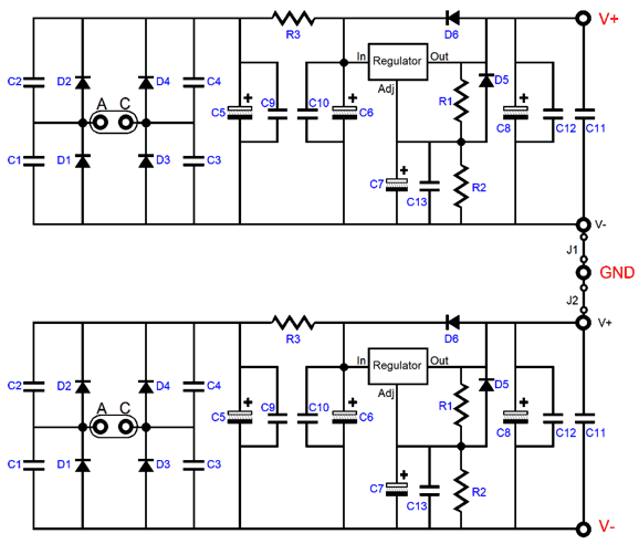

So long as there is not a ground lift on that power supply board, that would be the way to do it. If there is a ground lift, you would need to separate the power supply ground from the chassis. Remember to install the jumpers from the center v+ and v- to ground to take it from a dual power supply to a bipolar.

Thanks, @Mikerodrig27 Yes, the jumpers are in. Here is the circuit. How do I tell if there is a ground lift?

J1 and J2 have to be jumpered to get a symmetrical power supply with + xx V and - xx V.
GND (of the PSU / between J1 and J2) gets connected to earthground of your IEC-inlet.
From earthground / IEC-inlet also a connection to the case!
The Audio-GND of your amp-pcb (Waynes Line Stage) can be connected directly to GND of your PSU or
you use a ground-loop-breaker ( 10 Ohm - resistor or combined with diodes) to get a groundlift.
A groundloopbreaker is only necessary if you have groundloops / humproblems.

Thanks, @cubicincher and @sov yes, J1 and J2 are jumpered.
Can the PSU ground, the earth ground from the iec and the audio ground from the pcb all connect to the chassis at the same point? Is that what a star-ground is or have I misunderstood that?
