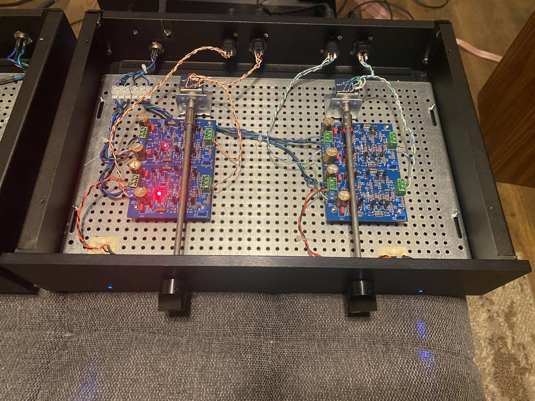

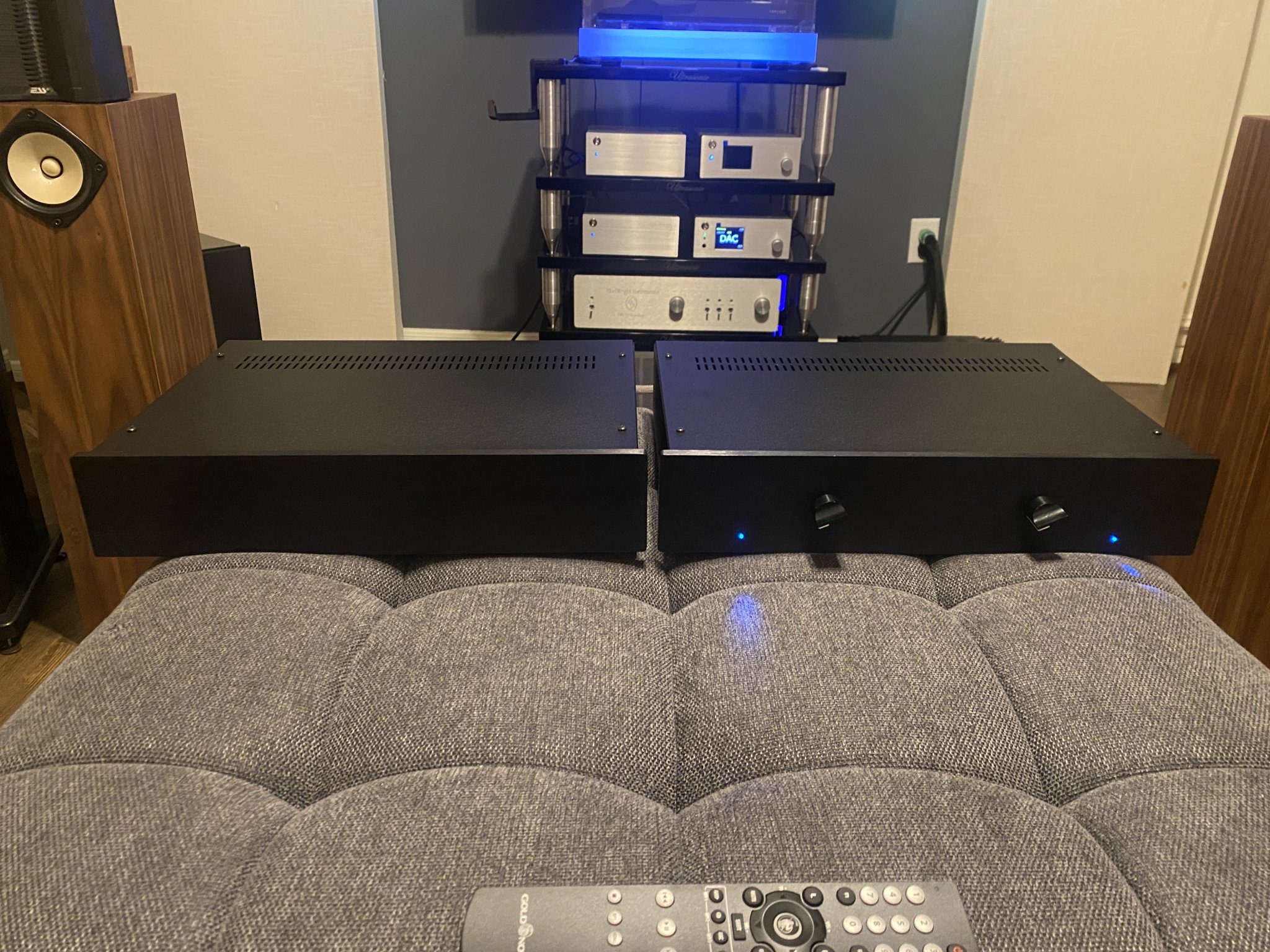

Thought I would share my build. I really over thought the whole balanced build and after getting feedback here from 6l6 and others I realized it was very simple.
I am using my dac that has coax, line input, optical, and usb as a volume control and adjusting the preamp to the desired level and leaving it.

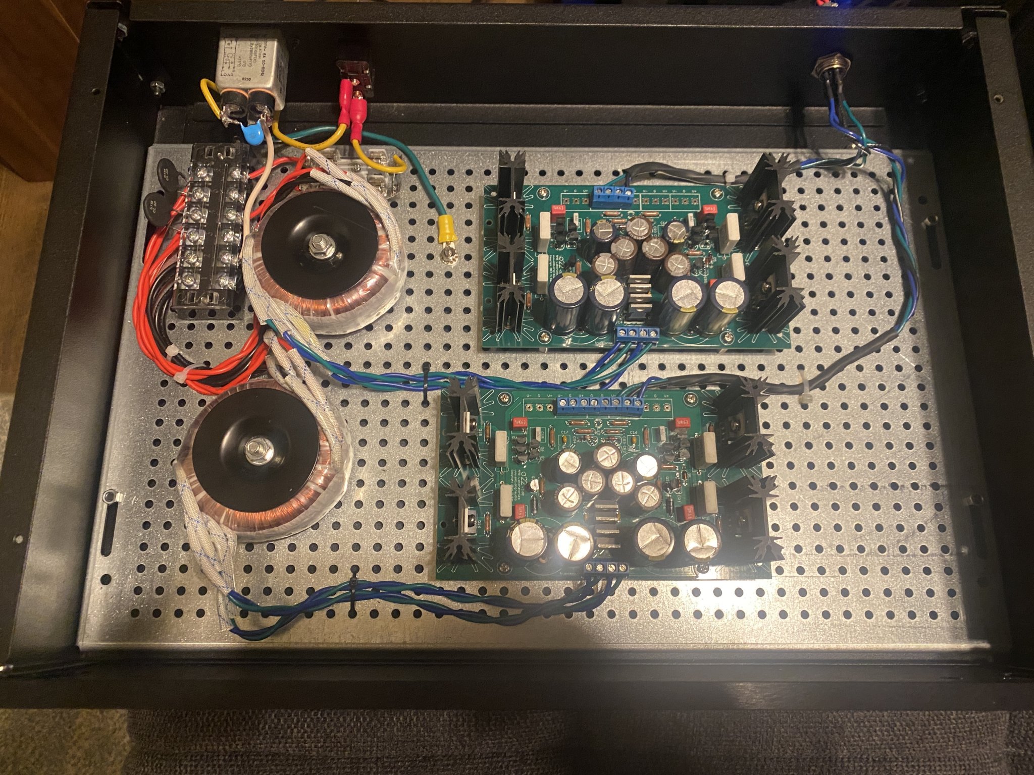

I built a separate PSU. Two amb o22 power supplies, Antek 20V 50VA transformers, and a 6 pin umbilical with 18V for each board.
The preamp chassis has 2 Alps Blue velvet pots (one for each channel).
Really runs my Aleph j nicely. This gave me the confidence to tackle a BBA3 balanced once the boards are back in stock for a pair of F4s to pull 100 watts. I had a pair of F4 before and loved them but had very efficient speakers and sold them before trying them at full capacity with the right preamp.

Hello Dneu2011,
a real nice dual-mono build of Waynes Line Stage!
Enjoy the sound!
Cheers
Dirk 🙂

- how did you tackle your 2nd box power supply (maybe used the AcademyAudio LPS/Reg + toroidal ,...) and would you be happy to also share a picture please?
Kind regards, JTJT:
My BA2018 was a two-chassis single-ended project. I did not ramp it up for headphone capability. The Academy Audio kit I purchased was their "Complete Audio Preamp Kit" (and not the "Complete Balanced Audio Preamp Kit"). I don't recall if Academy Audio offered their LPS9 power supply board when I built my BA2018; in any event, I used three of Pete Millett's power supply pcbs for his LR Phono Preamplifier (http://www.pmillett.com/LR_phono.html). Gross overkill, to be sure, but the BA2018 was a "no holds barred" project for me, so separate power supplies for each channel plus a third to drive the Academy Audio boards and front panel LEDs.
Notably, Mr. Millett now offers another power supply design that might work well: http://www.pmillett.com/audio_power_supply.html. And there is also Mark Johnson's wonderful VRDN power supply to consider. For me, a key determining factor was pcb size -- all of the power supply components had to fit into a HiFi2000 2U 230mm x 280mm "Galaxy" chassis (available from the diyAudio store but, for you, perhaps more conveniently purchased from Modushop / HiFi2000). Although not cheap, Mr. Millett's LR Phono power supply pcbs fit very nicely.

Finished my assembly today and got a few hours this evening to give it a listen. Very nice preamp!
I checked the DC offset at the speaker terminals a few times during the evening just to be cautious. The offset actually went down a bit after playing music, and seemed to stabilize around ~85mV. A bit more than ideal, perhaps, but certainly not going to start any fires.
To start with, it is dead silent. It even makes my phono-pre sound quieter, if that is possible.
This pre has very good headroom. Nothing seems to make it sweat, and it absolutely refuses to get harsh. Listening to records, surface noise is almost unnoticeable-- which is interesting. I would have thought that to be more a function of the phono preamp.
Everything sounds very clear, with good dynamics, too. Instruments sound very distinct.
I have read other builders post comments that they found the BA2018 a bit strident or bright at first. Mine was mellow from the first note. If I had to give it a single descriptor it might be "caramelly", in a good way, of course.
I wonder if this difference in opinion has anything to do with the choice of output transistors. I opted to use the big outputs Q8 and Q10. I used the Toshiba TTA/TTC004. I wonder if it would be worth it to pull the big transistors (and associated resistors) and swap for the KSC1845/KSA992 (and associated resistors/capacitors) to see how the sound changes. Someone must have tried it both ways. No?
