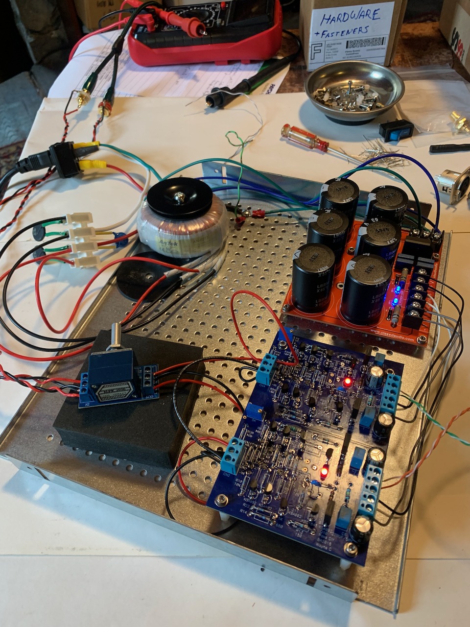

Yesterday I did the inital firing up of my Waynes 2018 and to my amazement it worked on the first go! (see photo). Now I have a question regarding the adequacy of the power supply. I used an Antek 0212 which is rated at 20VA and 12V dc. It is giving me 14.5V dc coming out of the power supply. Would I gain anything by going to a larger 50VA 15V Antek? More gain? Any other sonic advantage?
sndlvr:
I believe 6L6 reported that the ideal voltage for the BA2018 was in the +/- 18-19 VDC range. RickRay appears to be right -- your power supply looks unregulated. If you want to use that, a transformer with 14 VAC secondaries should net you just over +/- 18 VDC. A transformer with 15 VAC secondaries will net you roughly +/- 20 VDC, which would also be fine. Or switch to a regulated power supply like the VRDN, which would allow you to dial in the DC voltage with precision. Either approach works.
Regards.
Regards.
Thank you! Will get the bigger transformer and also read up on that VRDN power supply. Sounds like a great idea. Ideally set up as an external power supply to power various DIY builds, saving money on future power supplies and also allowing smaller casses. Kudos to Mark Johnson

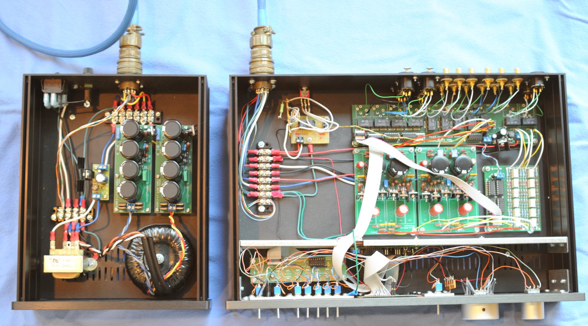

One more thought: if you're going to put a dedicated "universal" power supply in a separate chassis for various preamplifier and other low current-demanding projects, at very least consider making it dual mono. I built a two-chassis BA2018 for my main system a few years ago that includes three power supplies: dual mono for the BA2018 and a third supply for ancillary demands. Ridiculous but satisfying.

@SRMcGee i’d be interested in your thoughts about the trade-offs when going to external power supplies. We introduce connectors and cabling, which raise the potential of losing some of the benefits gained elsewhere in the system. What kind of connectors and cabling did you use? And do you feel there are any compromises to sound quality ultimately?
sndlvr:

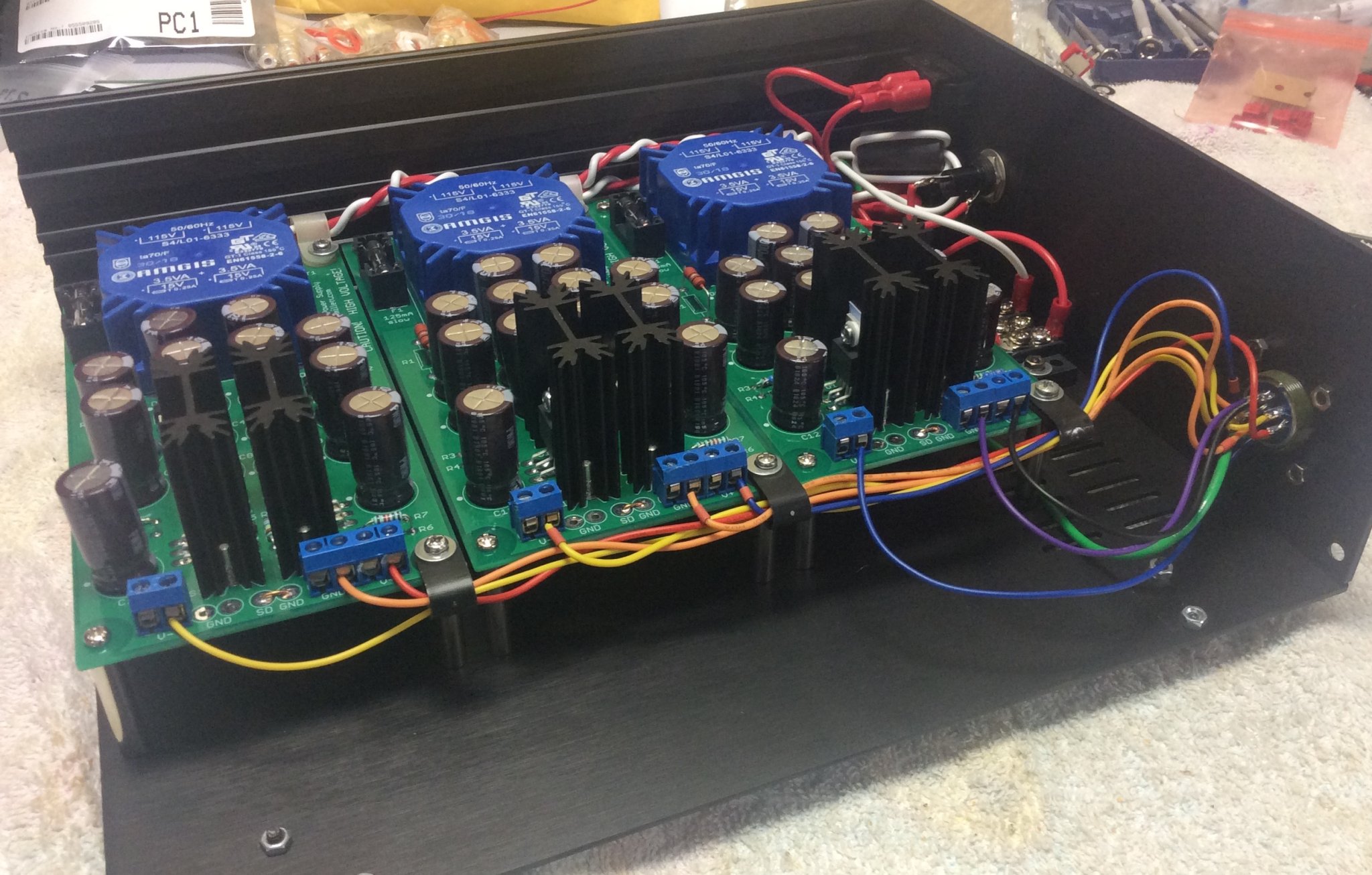

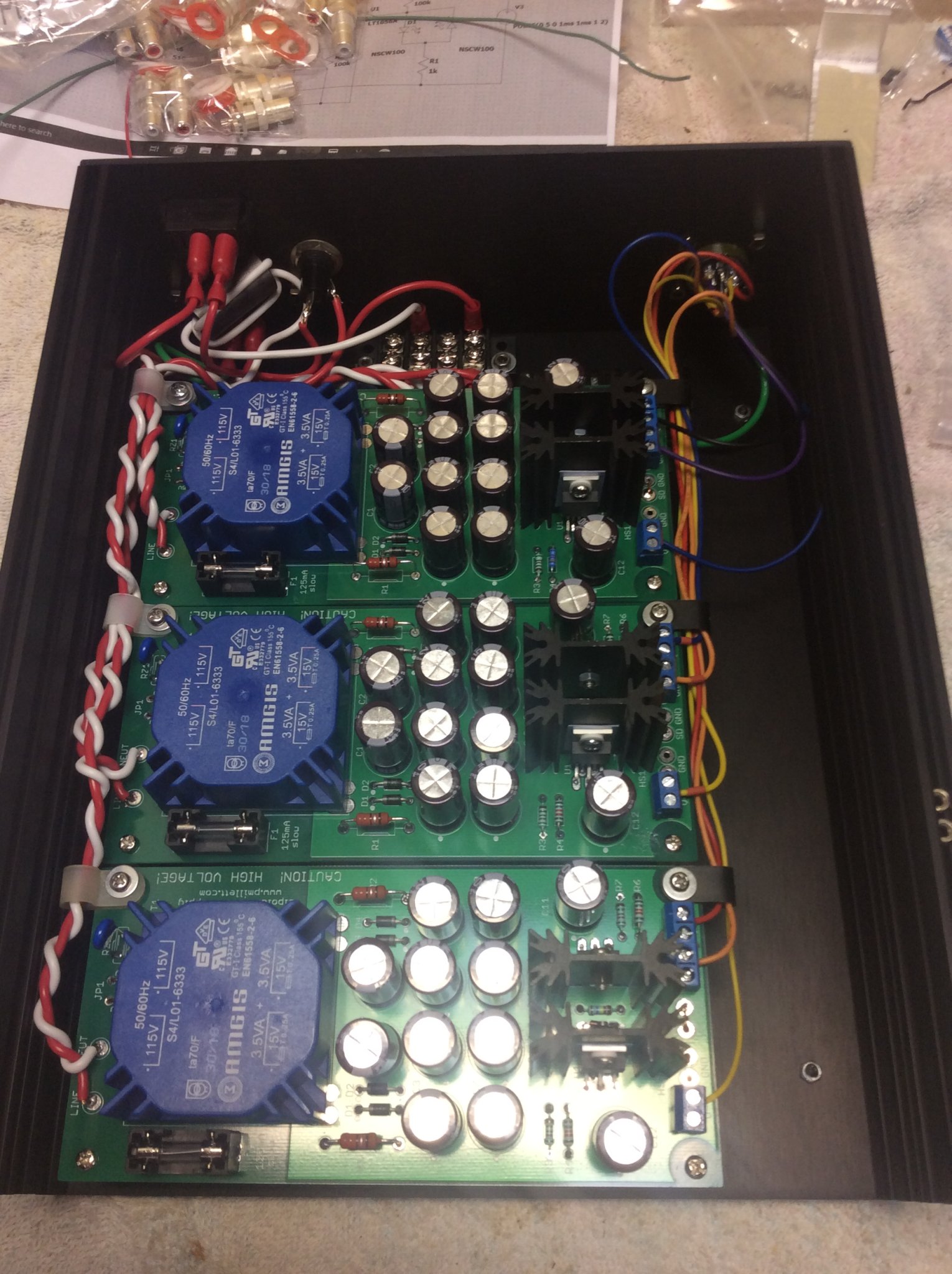

I think the benefits of external power supplies greatly outweigh the detriments. Understand that I'm no engineer -- take my perceptions with a huge grain of salt. Transformers and power supplies can make noise in the audible spectrum; distancing them from line level audio signals reduces the level of noise and audio degradation. It also looks cool. The only downsides I've found are cost (an extra chassis, fancy millwork and an umbilical comes at a price) and the extra shelf space needed. I make the umbilical cables to order (and enjoy doing it); you might find this thread interesting: https://www.diyaudio.com/community/threads/build-up-umbilical-cable.379909/. Also, I usually include 0.1 uF caps in the preamp to filter any noise picked up in the run from the power supply chassis.
As cliche-slingers will remind you, your mileage may vary.
Attached below are photos of three of my two-chassis preamplifier projects.
Scott
