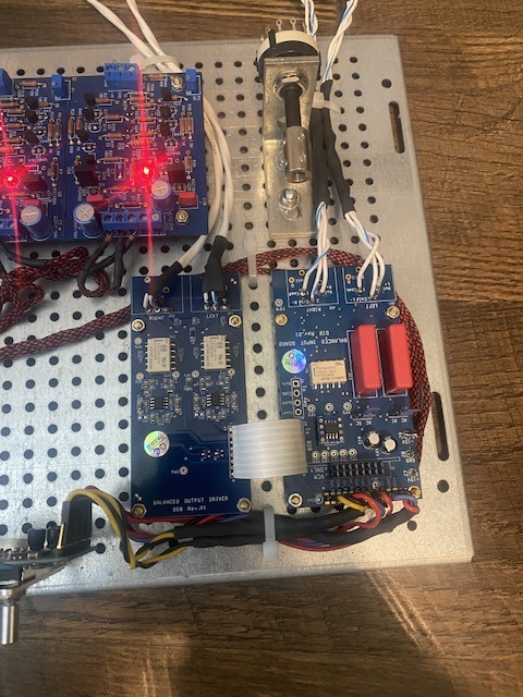

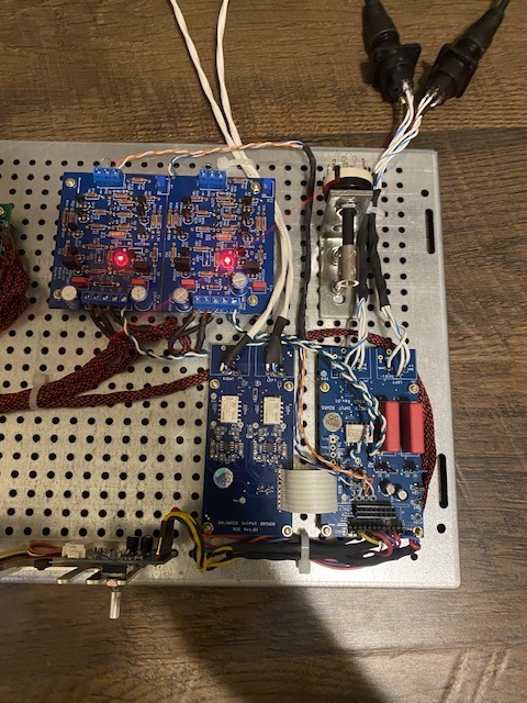

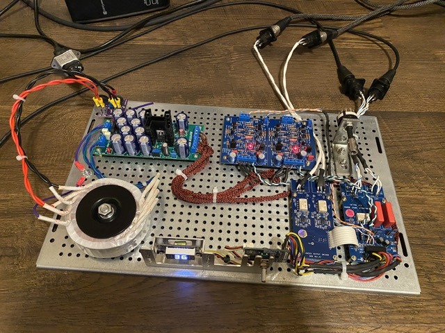

Thought I would share my partially finished Wayne’s build with Academy Audio’s new BIB kit.
Lenny has been VERY helpful explaining what I need and how to hook it up.
I got the optional BOB board so I have fully balanced input and output. He also included a nice mounting bracket to hold the MCU module and the screen.
It works and sounds really nice. I just need to put it in the chassis, add the other 2 xlr inputs, and figure out the best way to add my headphone jack plus a rca inputs/outputs for more versatility.
It sounds really good.
