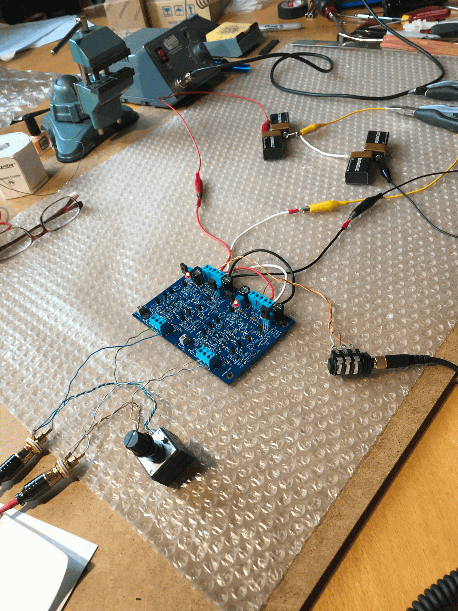

For those of you that have recently used an Academy Audio module in your Wayne’s Pre, are you having issues with the volume jumping to 100 while adjusting it with remote?
Lenny sent me a new one today and it’s doing the same thing… he’s been very responsive and VERY helpful but the volume jump is concerning.

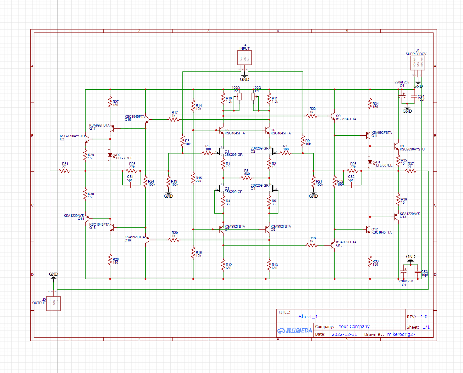

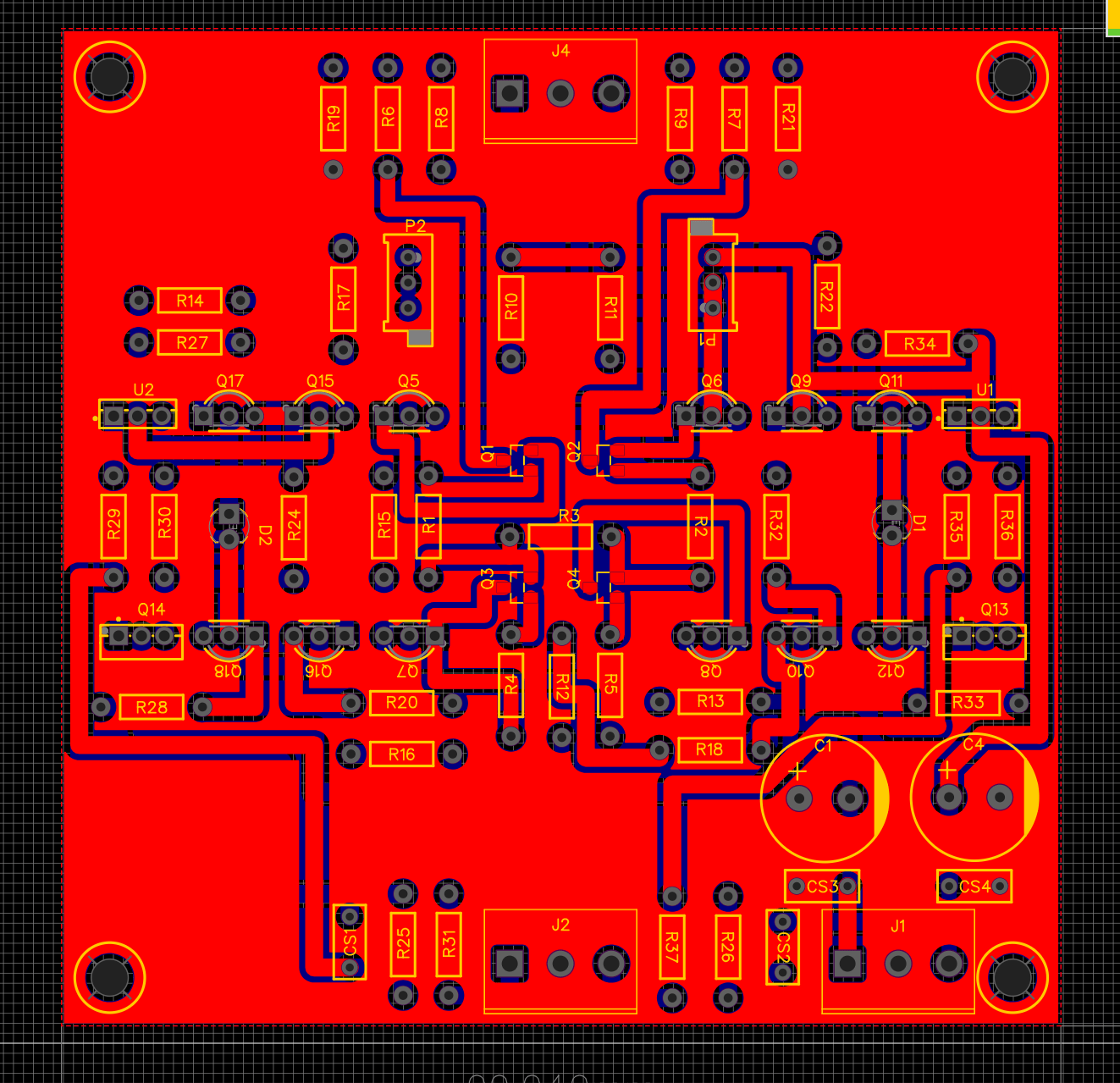

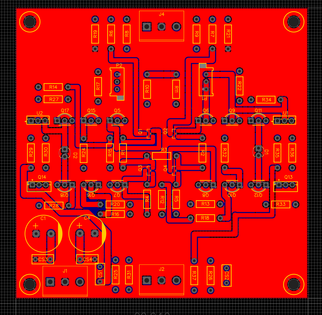

I started drawing this BA2018 SUSY a while back. It is a starting point as from what I understand, there could be a potential DC offset issue that would have to be worked out accordign to ZenMod. I don't plan to finish or build it. If someone wants it, feel free to message me. The program is EasyEDA. I was using as a platform to become more familiar with EasyEDA There are two boards. One for left channel and one for right. Just the placement of the connections:
Message me and I will see if I can figure out how to get the files to you. You will want to look for Zen Mod's starting schematic for the BA2018 and check it against that. It should match it. I belive I used the TO-220 drivers
