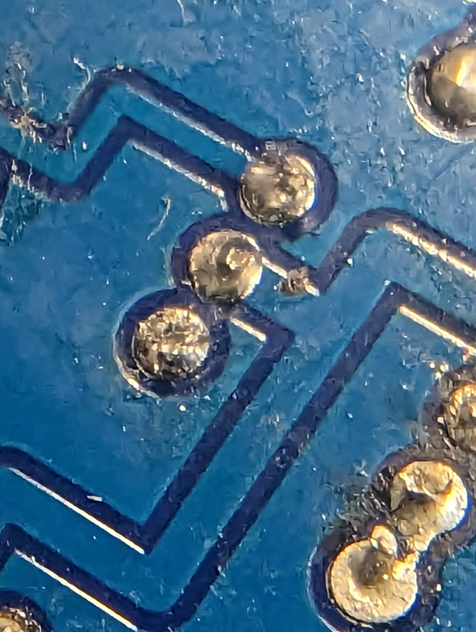

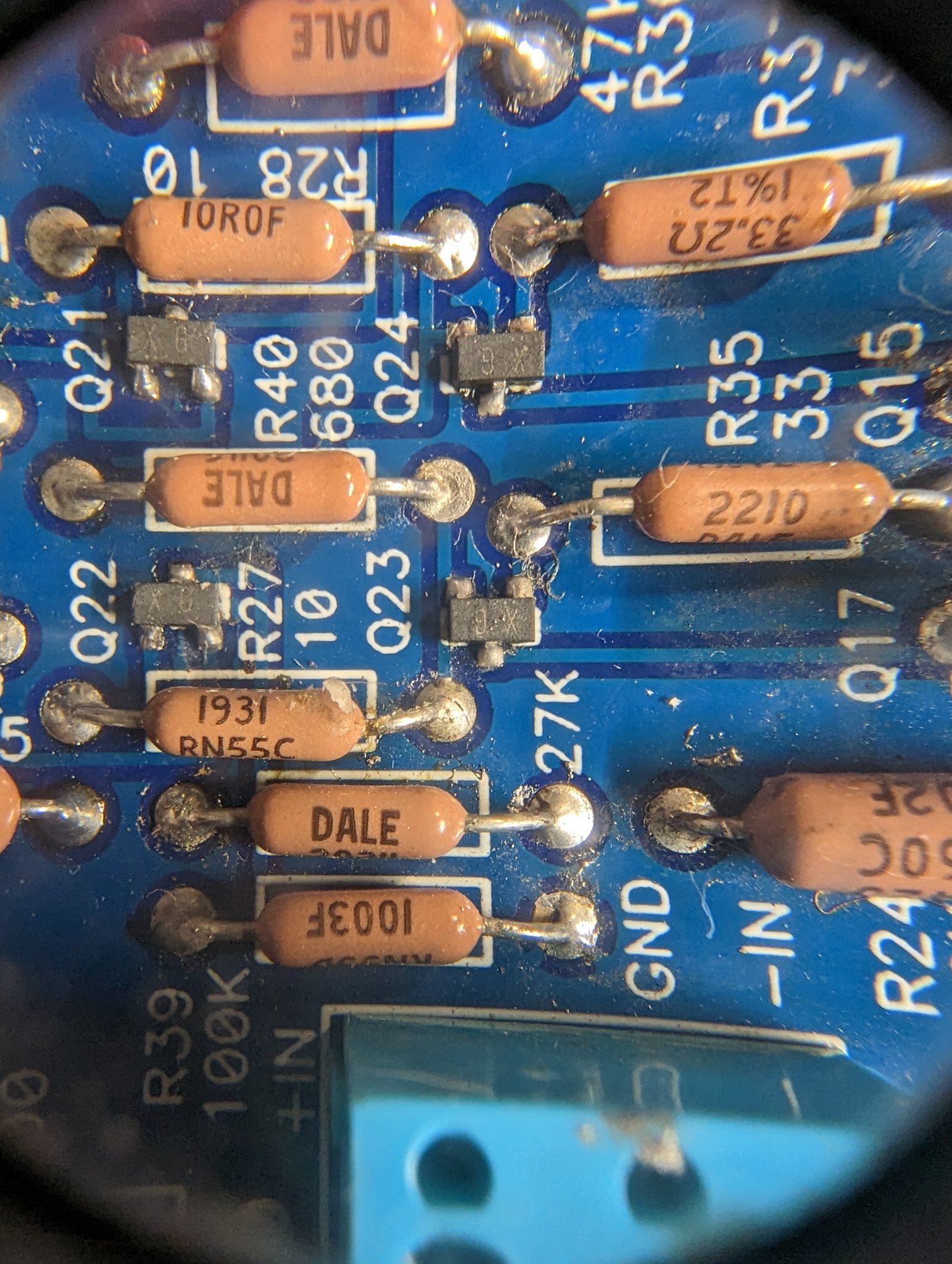

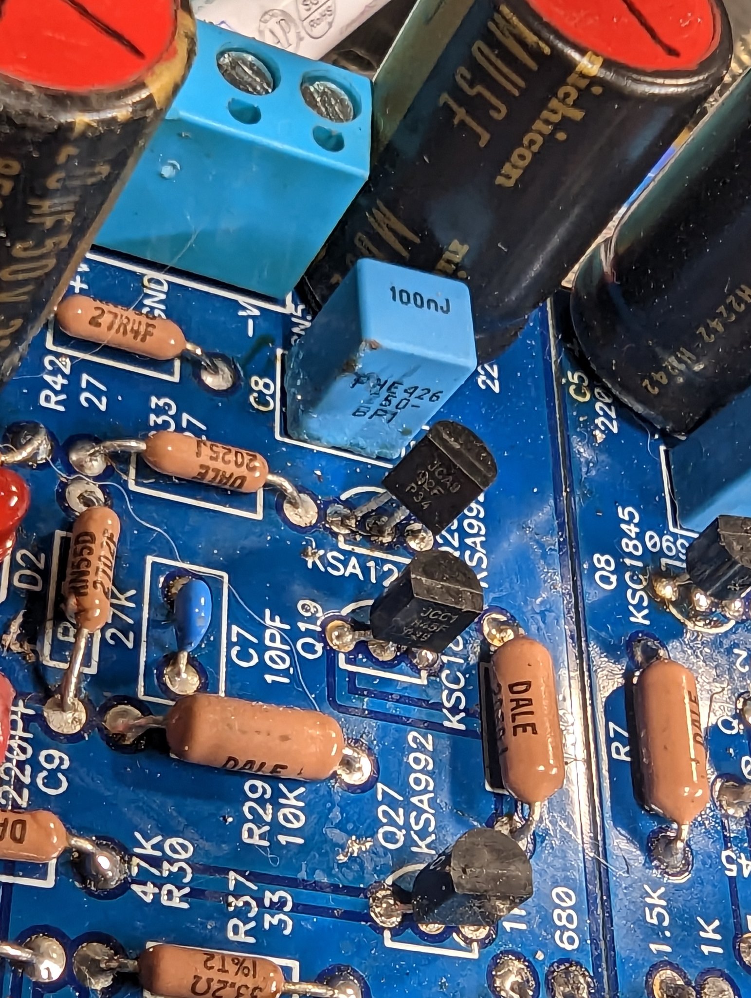

alright alright my boards were dirty i know i know. I marked one board blue(working) and the other red(not working) the led was installed reversed polarity (not the power). picture of q23(not melted) q25(not shorting) and the bottom of q19 but i did touch up the joint on top

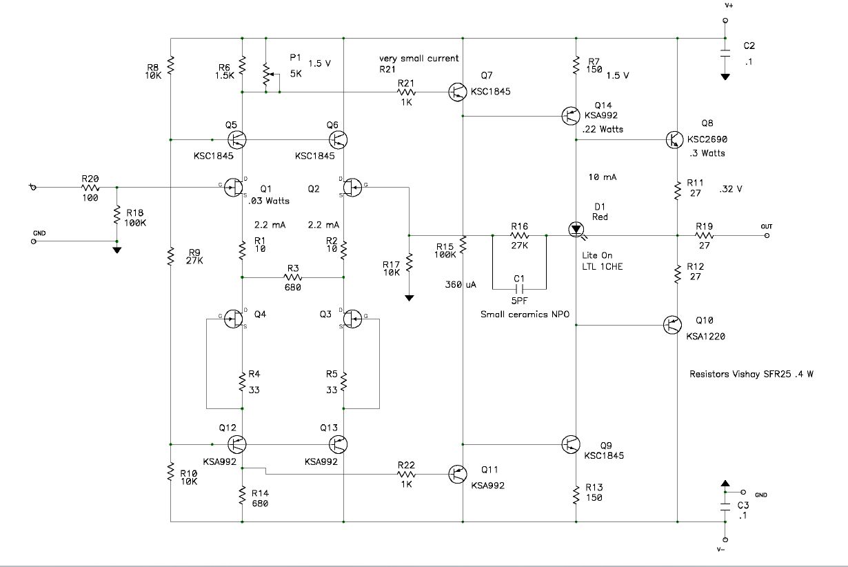

Looking at your measurements I assume the unit of measure is Volt. Always include the unit of measure. Are the second measurement at each location from the "red" channel?
Starting from the signal input side, R1= 0.05V indicates Q5 and Q1 are functioning, although the current through them are approximately double the design value. On the other channel R27=0 indicates either Q23 or Q22, or both, are not working (Q5 and Q1 as shown on schematic).
R2=0V and R28=0.05V seem to indicate the other channel not working, that is, either Q2 or Q6 or both are not working. Is this the case - both channels are not working?
These circuits affect the function of the later circuits so they need to be fixed before assessing the rest of the board.

so removed and cleaned q1 q4 q22 and Q23
r1 .025v
r27 .003v

R27 at 0.003V is still not good.
You needed to do more than clean Q22 and Q23. Did you test them while they were out?
I am puzzled. R27 is not good but R26 and R36 are good. Perhaps Q22 is bad? Or perhaps 0.003V at R27 was a mistake? Confirm R27 is 10R.
