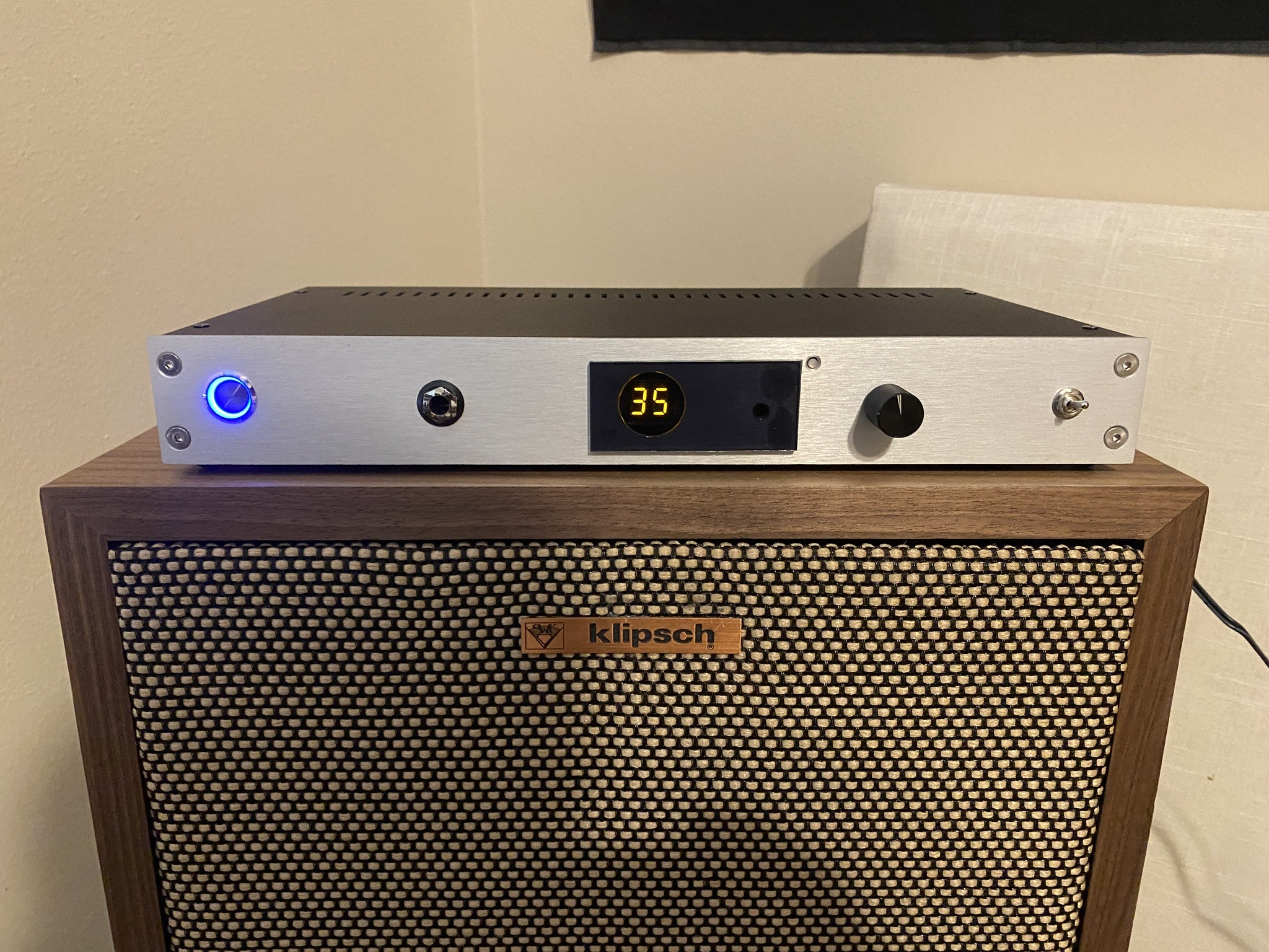

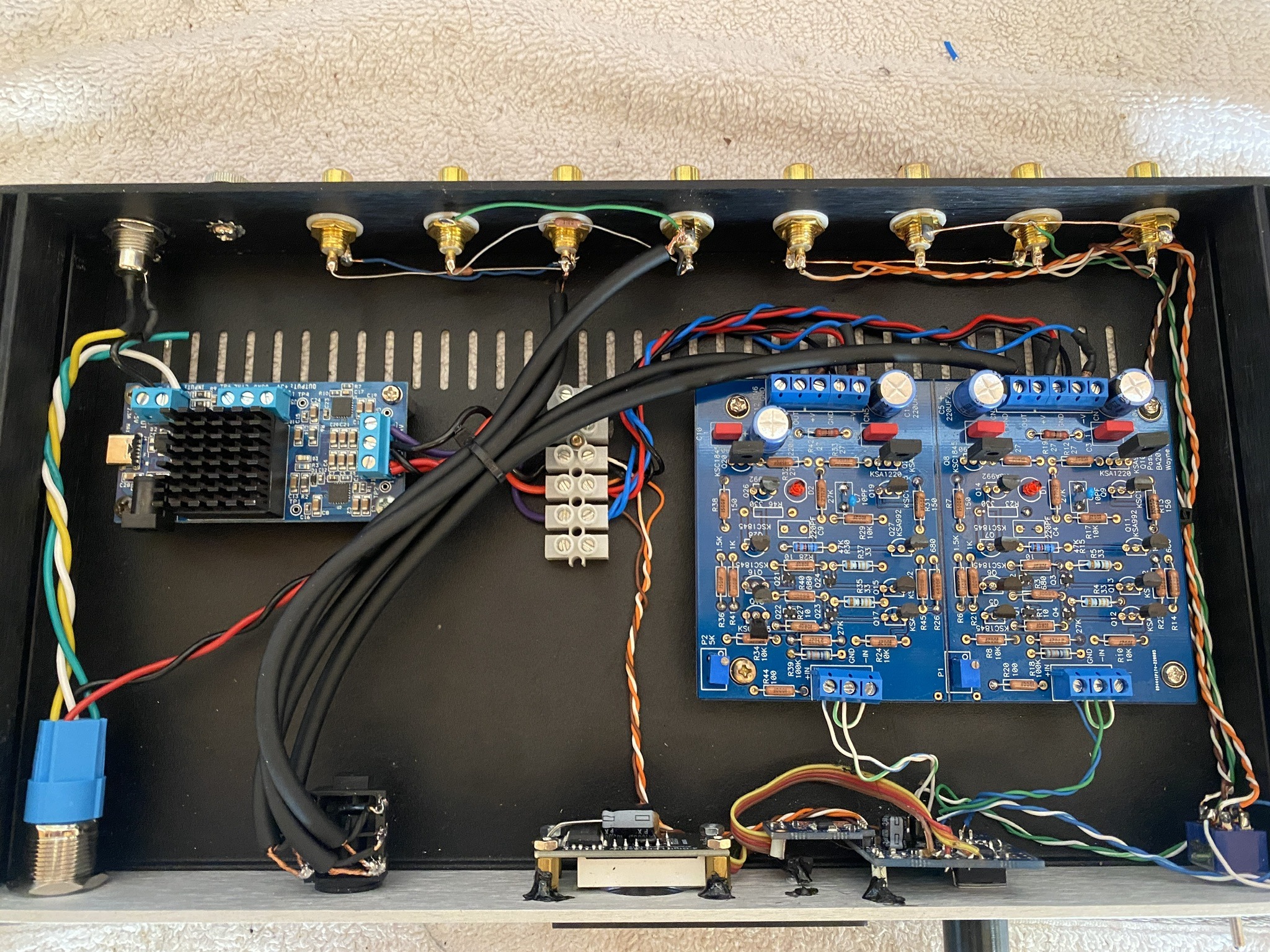

I built this one for my office with the Academy audio PSU and the VCX module with Lenny’s App Notes.
It takes a 5V wall wart so I was able to implement a nice little illuminated push button.

Did you get the issue with the volume jumping sorted?I built this one for my office with the Academy audio PSU and the VCX module with Lenny’s App Notes.
I actually built two different Waynes preamps using Lenny’s VCX.
The first one I had issues with and was a fully balanced unit with Lenny’s BIB, BOB, and the VCX with only one of Wayne’s boards. I tried two different VRDN boards and both caused the preamp to sporadically jump to full volume. I swapped in a new power supply and I haven’t had an issue since.
The second preamp I built as a basic single ended unit with Lenny’s LPS9 and no issues.
When I first built my VRDN boards I used the TI devices and realized there were oscillation issues and saw new modifications recommended by Mark. I thought maybe that was the issue so made the changes and the problems continued.
I just assumed the VRDN just didn’t play nice with the VCX. did anyone else have the same issue? Lenny mentioned a few others having the same volume jump problem.
Great question. I never did unhook the BIB and BOB to see if that changed anything.
I ordered another VCX and will hook it up on the VRDN single ended and see how it does.

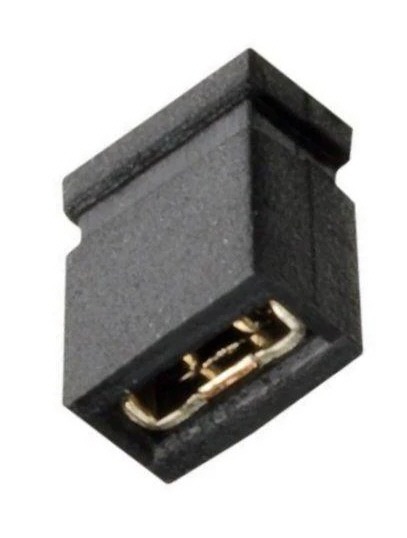

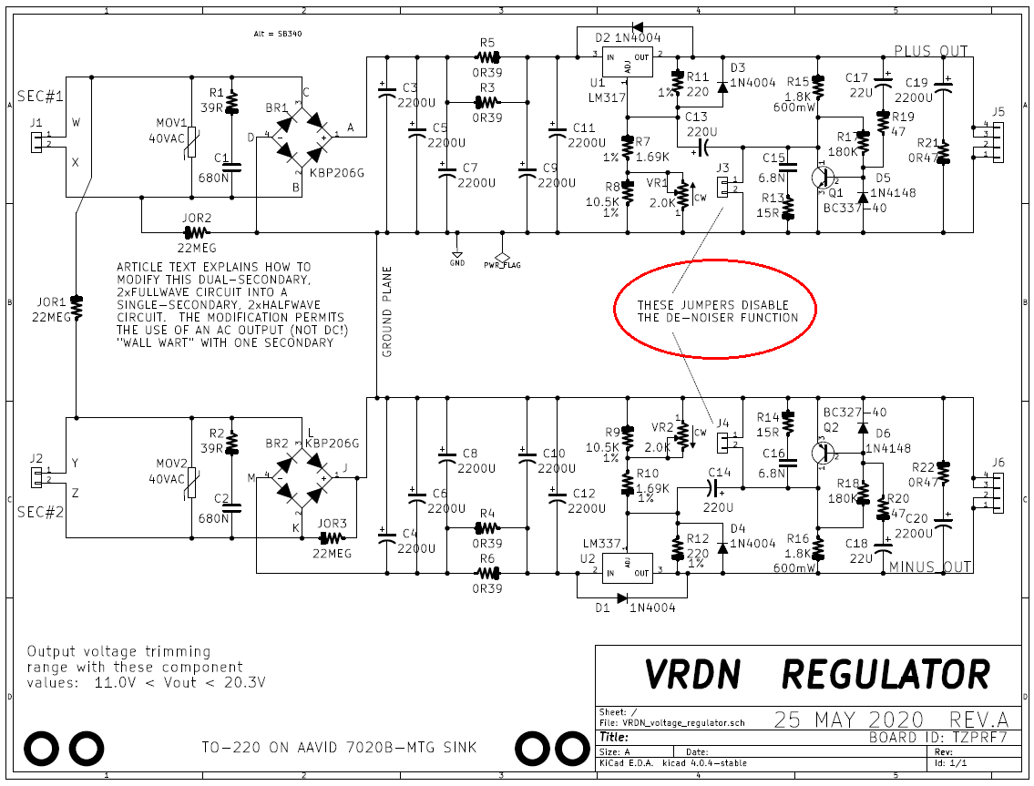

Remember that the VRDN board includes a pair of jumpers which allow you to disable the De-Noiser if you wish, and revert to a plain ordinary LM317 / LM337 voltage regulator. Install shorting blocks at positions J3 and J4 to disable.

Ok. I’ll experiment with this. It could very well have been the denoiser that caused the issues and I never thought to install the jumpers and see if that fixed it.
I will try again and see if I have better results.

I have the same issue with the VCX jumping to full volume. I emailed Lenny last week and he mentioned there is a firmware issue with one of the components, and I should email it back for it to get the new firmware flashed to solve the problem.
Then monkeying around with the VRDN power supply is extremely unlikely to make the issue disappear.
