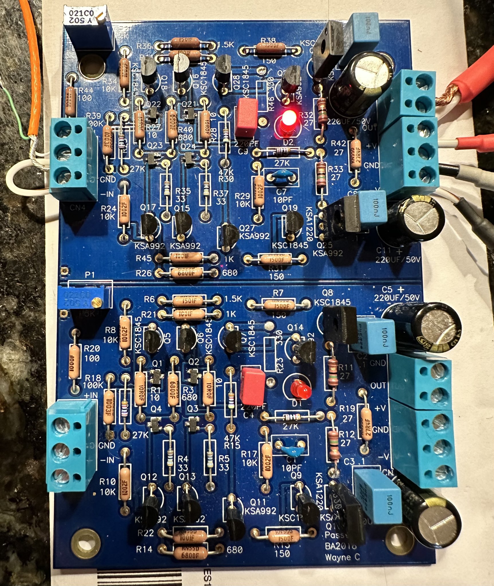

Hi All,
I got my power supply issues resolved with the help of some folks over at the power supplies section. I'm closing in on finishing the project. Case work is done. Power supply and signal wiring is done. I had a difficult time getting the offset to the correctly low voltage, especially on one channel. It felt like the pot was kind of twitchy and very sensitive. I did manage, though.
Today I hooked the board up to the unit's power, with input from a portable digital player and output going through a class D amp and a small test speaker. One half of the board seems fine: pretty good level of gain, no hiss, no hum. The other half (top in photo) has quite a bit of hiss and a lot less output. Wondering if this sounds like a familiar failure mode to anyone. The two halves of the board look identical to me, but maybe your eagle eyes will spot something. I will admit to installing one of the electrolytics (C5) on the good half backward, so that had to be replaced, which is why it looks different--same value though.
Lacking any other kind of plan, my inclination is to replace all the transistors on the bad half. I know this is not a proper test, but using a VOM, I checked resistance values between legs of the transistors in both polarities, and each measurement from the halves was in pretty good agreement, with no shorts or open circuits. Would it make sense to replace the early stage ones first and proceed to the next, or just do them all in one shot?
Any better thoughts on how to proceed? Always appreciate the wisdom and experience here.
Your bias diode (led) is not lit. Lot’s of advice on troubles with these boards. 90% are due to jfet issues. Mostly because of bad solder joints.
Then ensure all BJT’s are the correct ones in the correct locations. Orientation looks OK.
A quick measure across the 10R resistors on the bad chan will reveal if the JFET CCS provide the appropriate current. If it drifts, check JFET solder joints and function.
You can do a point to point beep test before and after the JFETs and to the next point on the board. If resistance appears, resolder. If JFETs are OK, report back. They should provide approx 3mA current, measured across the 10R resistors.
You should post measured voltage drop across all the 10R resistors after the JFETs here. Also describe possible drift in voltage drop across same resistors.
The same voltage drifts or shortages will appear amplified at R7 and R13, measure there too. Perhaps the route to a working chan is short.
The usual reflowing of all suspect joints apply.

6L6, do you mean the whole transistor is bottoms-up, or that it's just oriented incorrectly? Top markings on these little guys are extraordinarily faint. From a side view, it does appear that its legs are bent downwards to meet the pads like the others. Orientation is the same as on the (functioning) other half of the board as you can see.
Continuity check verifies that all transistors are soldered in a way that shows they're connected to adjacent components in the circuit.
With no signal connected, current measurement across the circled resistors all show 0.1 mA; when I changed to uA, value on at least one was 0.01 uA. Both a long way from 3 mA.
Next move?

Next step is to measure mV and not current, across the same resistors. Then use Ohms law to calculate the current. Read off the mV drop across the resistors, divide by resistor value (10), result is mA.
It is in this step it is important to note any drift. Readings should be very stable.
