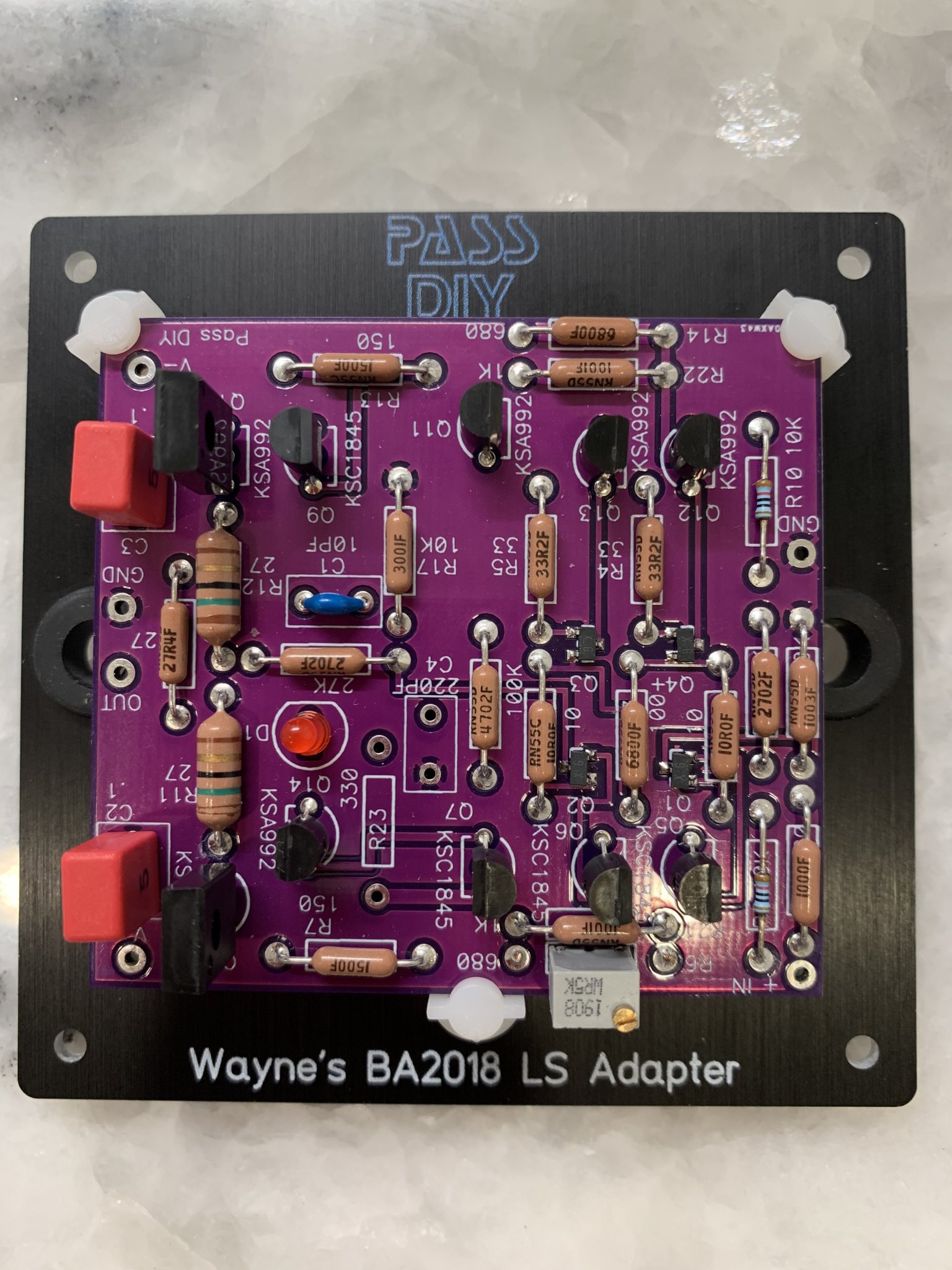

FWIW, if one wants to drive the F4 to its full rated power, the preamp will need to swing a bit over +/20V. So you likely will want to run it at a min +/-23V rails. For the gain, doubling from the current 3.7x to 7.4x should do it with a 2V RMS input. The distortion will increase with a 6dB decrease of feedback.
An interesting question to me is how high the distortion might be at +/-20V output. That probably calls for some measurements. 🙂
I've used a 2V RMS output DAC + the standard gain preamp into F4/Mofo. That's less than 7W RMS into 8 ohms max and I was pretty happy with the result.

Like many of you, I'm using a Glassware Dual Bipolar power supply for this preamp.
I built and tested the supply earlier, which worked just perfectly. After a lot of work on a complex case, I installed the power supply in the preamp. When I tested prior to powering up the pre board, now there's a problem. Output voltage from the PS.basically bounces around 100mv, like when you grab the probes in your hands--basically zero on both the + and – legs.
Both legs of the transformer secondary show 19.8vac. There are no toasted parts. No burst caps. No short on output. It's screwed to the chassis bottom with nylon screws, with a sheet of insulation underneath.
I'm stumped, and not sure what to look at next. Any thoughts on how this PS might fail like this, or what to test? Really don't want to tear this out and start over, but I really need to get it working so I can use the pre and show it off to you.
If this is not the right thread to discuss this, point me in the right direction. All the research results on this PS were here.
Hello Buckapound,
your Glassware - psu is screwed directly on the bottom of the case with a sheet of insulation (plastic? perhaps very thin insulator?) underneath.
Does that mean you have no standoffs under the pcb?
It is a symmetrical psu (V+ / ground / V-) - ground of the PSU connected to earthground at IEC-inlet?
Cheers
Dirk

Thanks, Dirk.
Yes, PS board sits on ~2mm thick sheet of polycarbonate, with no standoffs, w/ nylon screws. Very tough sheet and hard to imagine punching through it with the little solder/wire stubs on the board's underside. Last resort, I'll make room to lift up the board and verify, but everything is very tightly packed in this chassis so I'll have to unbolt the transformer, etc.
PS ground is not connected to the main ground, but it wasn't when I tested it either. As you know, grounding can be confusing, and with that unusual PS design I wasn't sure It should be connected. Easy enough to do. BTW, I have a robust star ground connected to the case just a few cm from the IEC inlet. Signal ground is connected through a diode bridge as NP and others suggested.
--Randy
--Randy

Hello Buckapound,
how you describe it - your groundig scheme with starground will be o.k.. Same with your 2mm thick polycarbonate insulation sheet.
I was afraid there could be a short...
If it is bouncing 0,1 V up and down (railvoltage of PSU) - perhaps it is your DMM or the PSU needs some load. I would test it.
I would hang the BA2018 board on the PSU and would test it. For the first run with a dimbulbtester - could be a 'life insurance'.
But I am pretty sure / hope, that all will be good...
Cheers
Dirk
