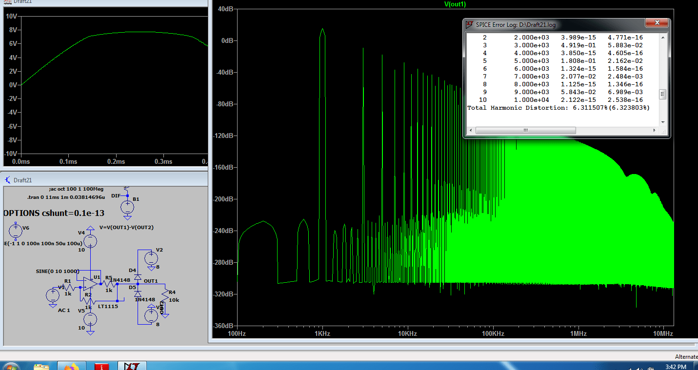

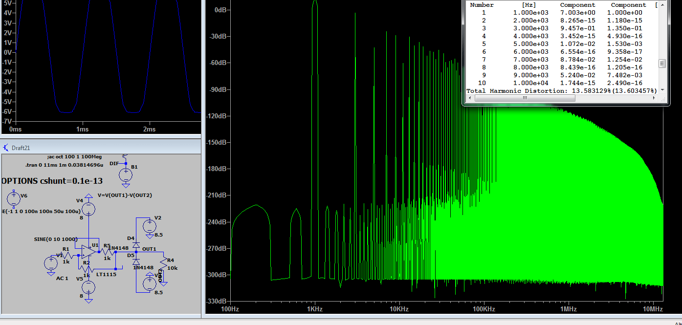

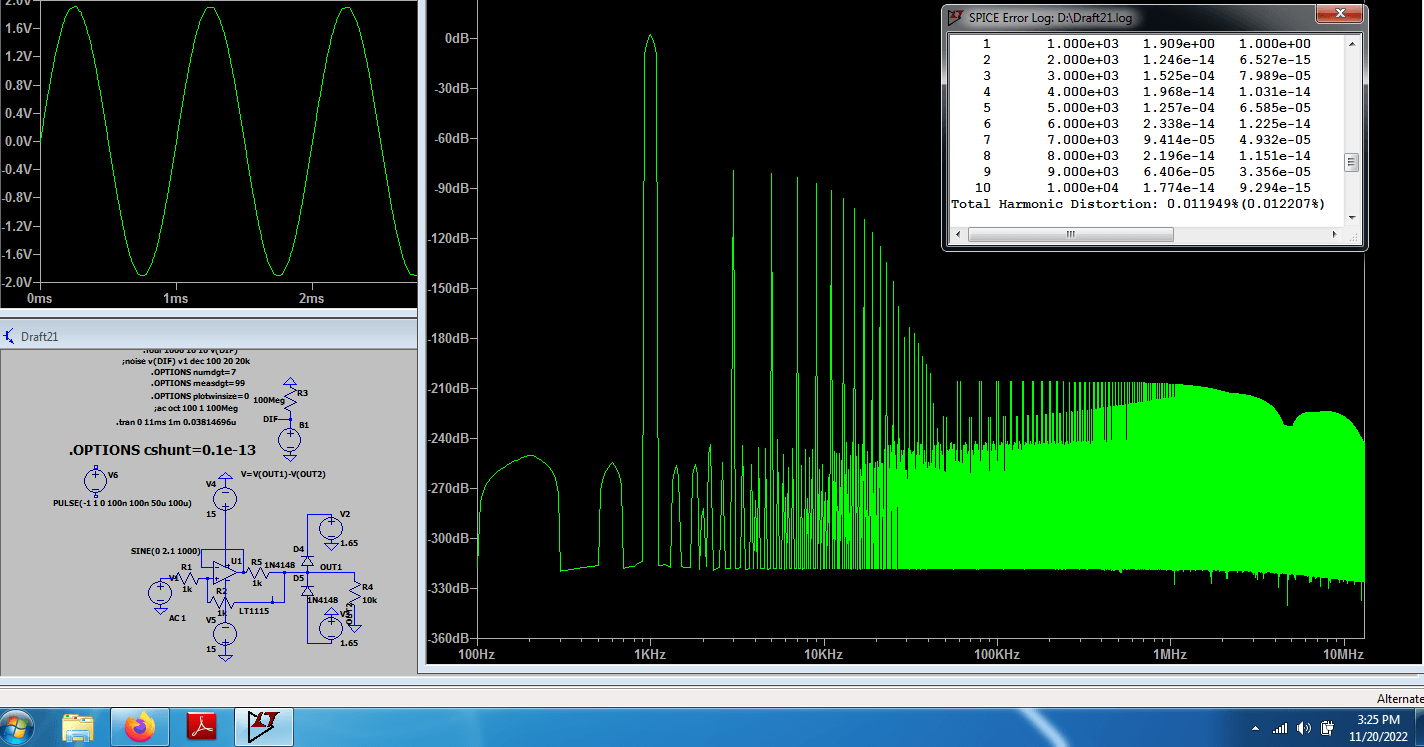

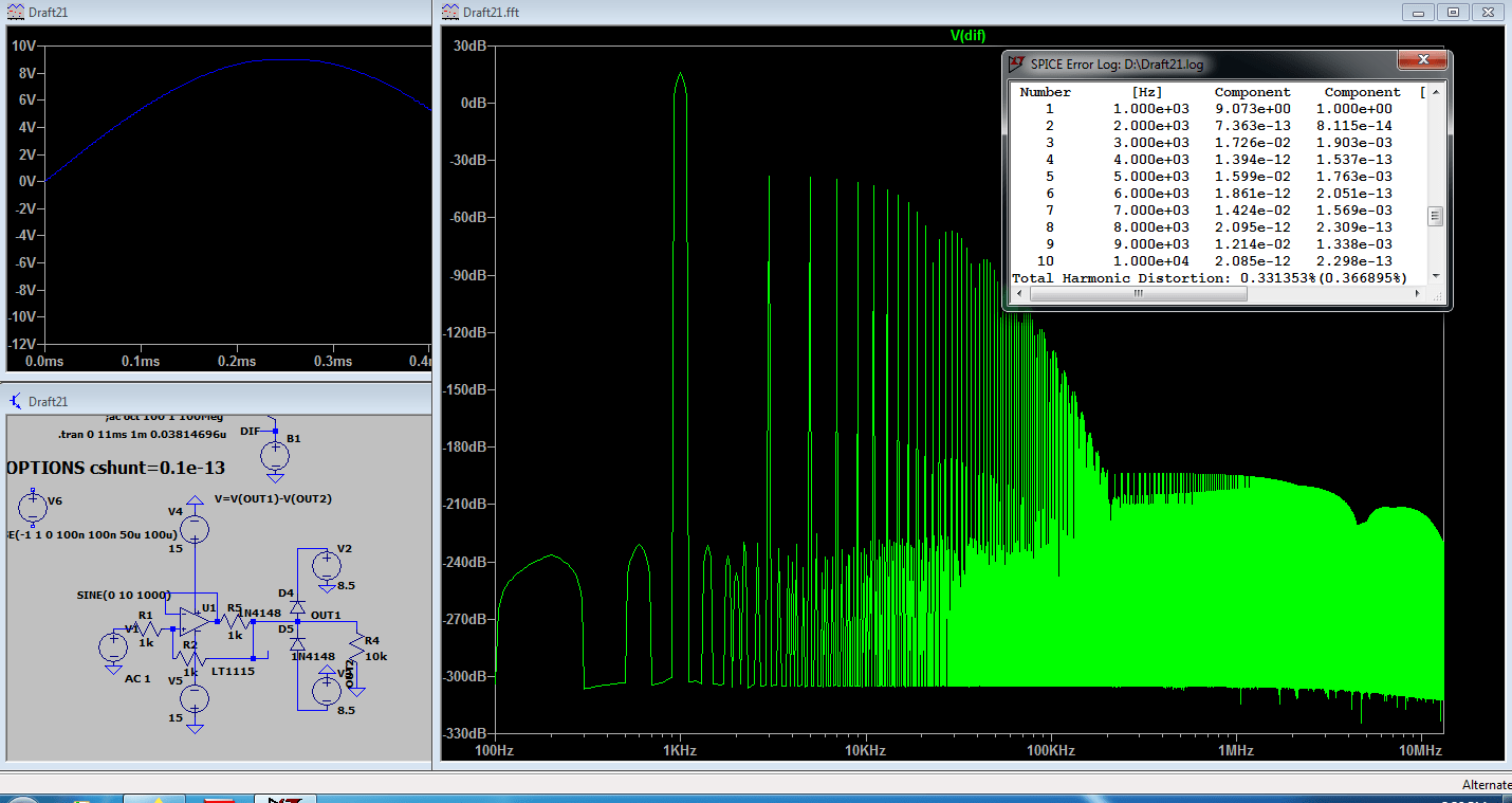

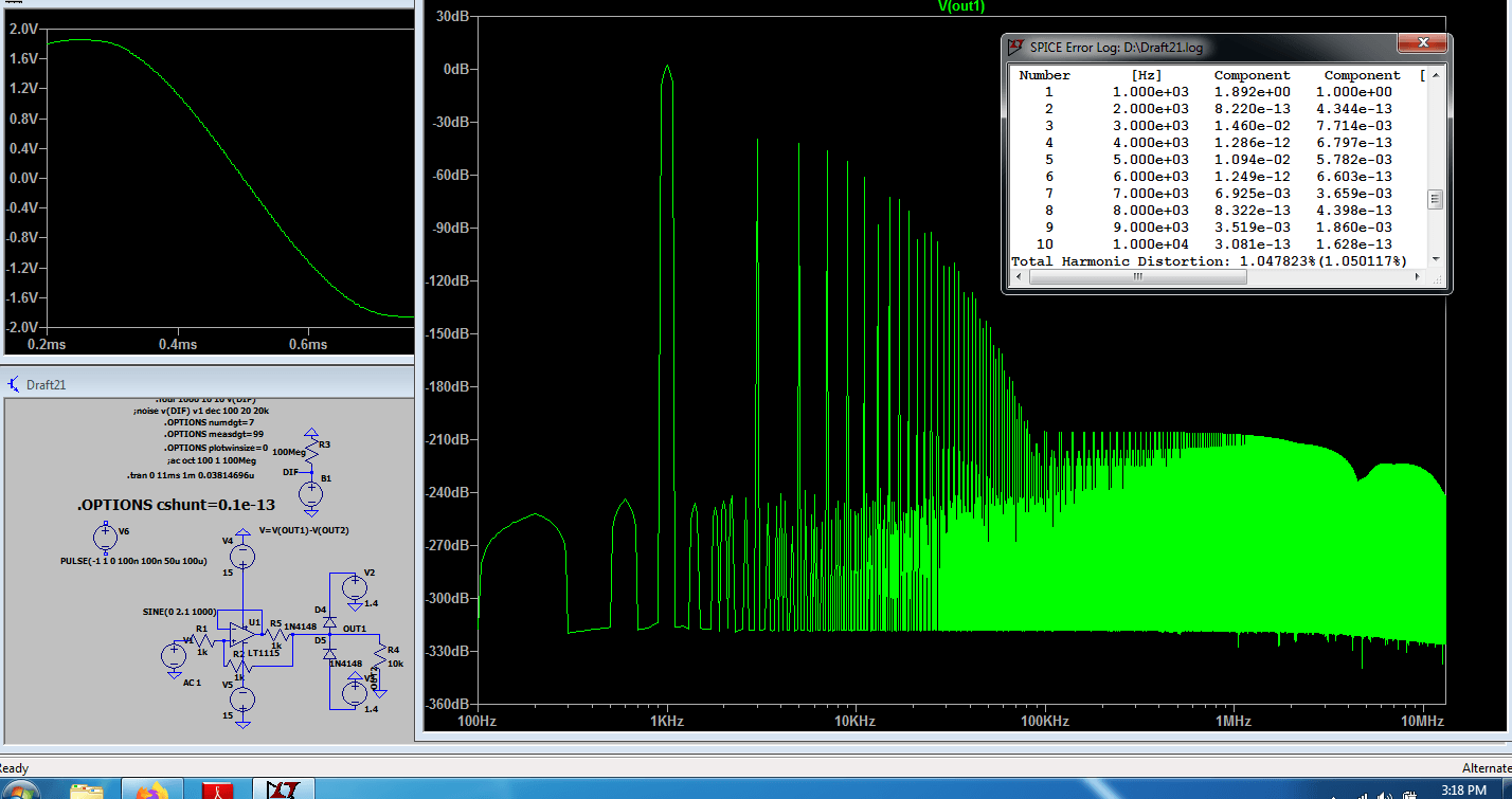

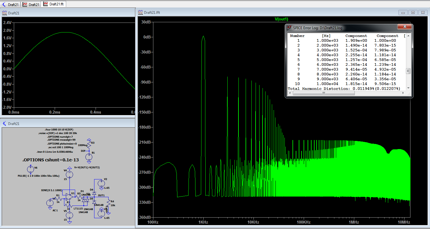

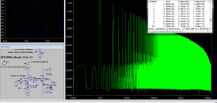

I've sketched a number of attempts, all involving bootstrapping the clipper diodes to reduce distortion by keeping voltage across them constant, which avoids nonlinear capacitance effects, leakage, etc. The bootstrap voltage is itself clipped by another pair of diodes, so when it reaches the limit, the other side of the diodes no longer follows the input signal and they begin doing their job.
The four ones on the left use diodes or transistors as diodes. They're strictly at the input of the amp, so they need an opamp buffer for the bootstrap voltage. The one on the right deletes the opamp by using the amp's output voltage (the power amp is VCVS E1) and using BJT emitter followers as diodes. Basically the two transistors' bases follow the input signal so they do nothing, until the diodes on the right conduct, at which point the transistors limit the input signal.

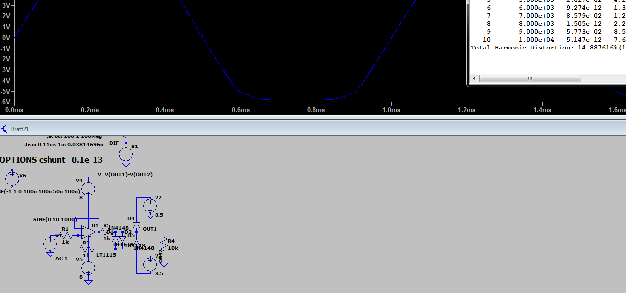

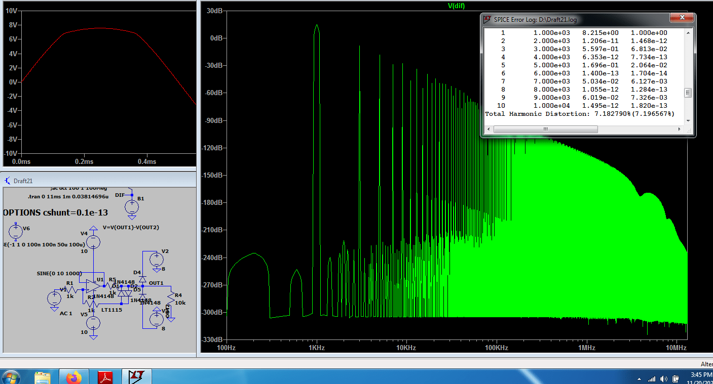

On the left is a sinewave with a smashed top.
And here is THD vs input level. Simulations are sometimes slightly optimistic, but it looks like "no distortion before it has to begin clipping" is achievable.
Thoughts?

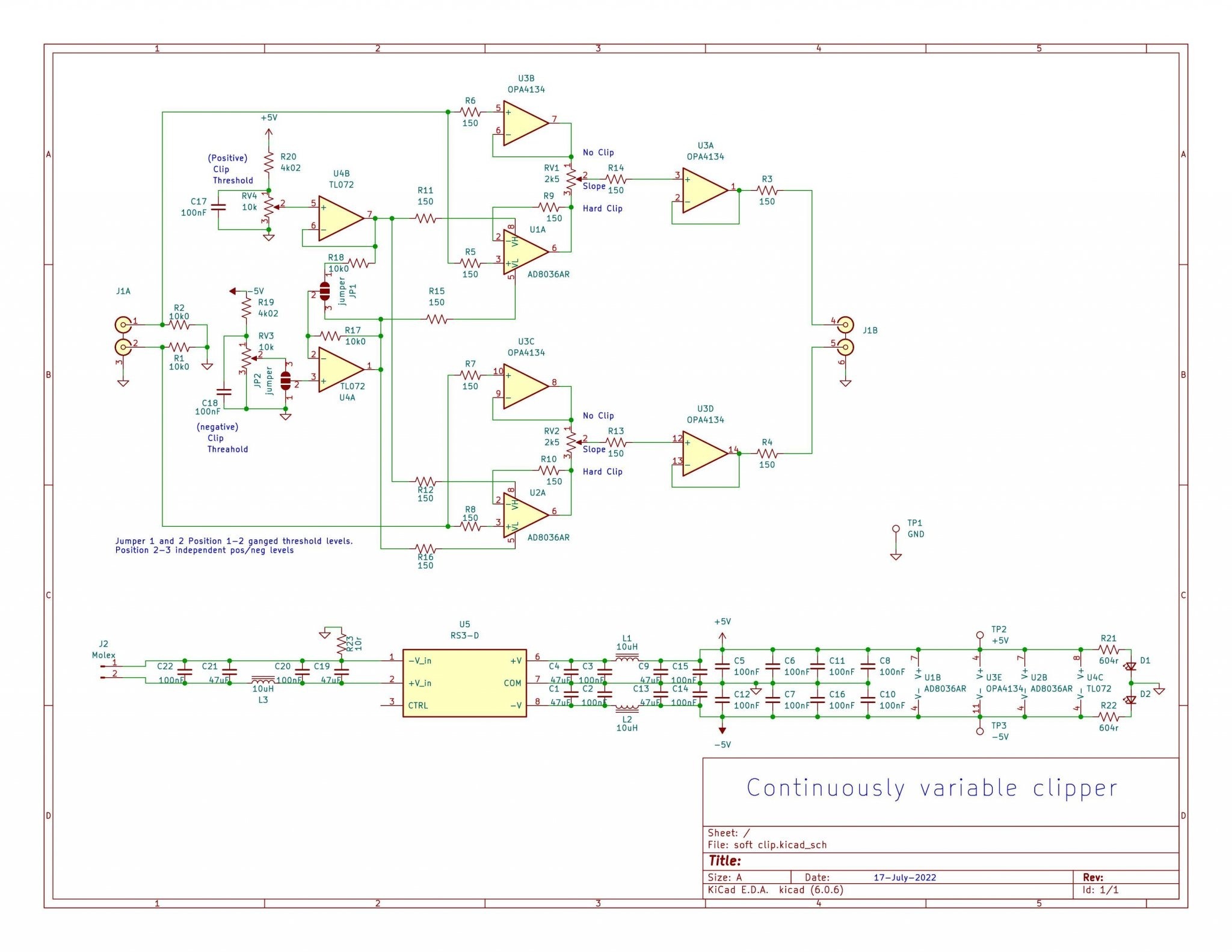

Looks very similar to this:20 years ago I did a soft clipper for a Hi Def telecine (film to video) It could
clip white vs black with independant black and white levels and a continuously
variable slope on each. This is a simplified version with continuous slope but
symmetrical pos/neg clipping. There are no discontinuities which would look
bad in video and sound like crossover distortion in audio.
The AD8036 is $12 at DigiKey. Check the data sheet as it's a very impressive chip.
https://www.analog.com/media/en/technical-documentation/data-sheets/AD8036_8037.pdf
Adding separate pos and neg clip levels with independant slope requires cascading
2 AD8036 stages but it works very well in video. Audio should be a snap.
If you attempt to build it I HIGHLY recommend using a 4 layer board with a
ground plane. The 8036 can hit 200 MHz and while stable, things get hinky on
breadboards. 5 boards would run $8 at JLCPCB.

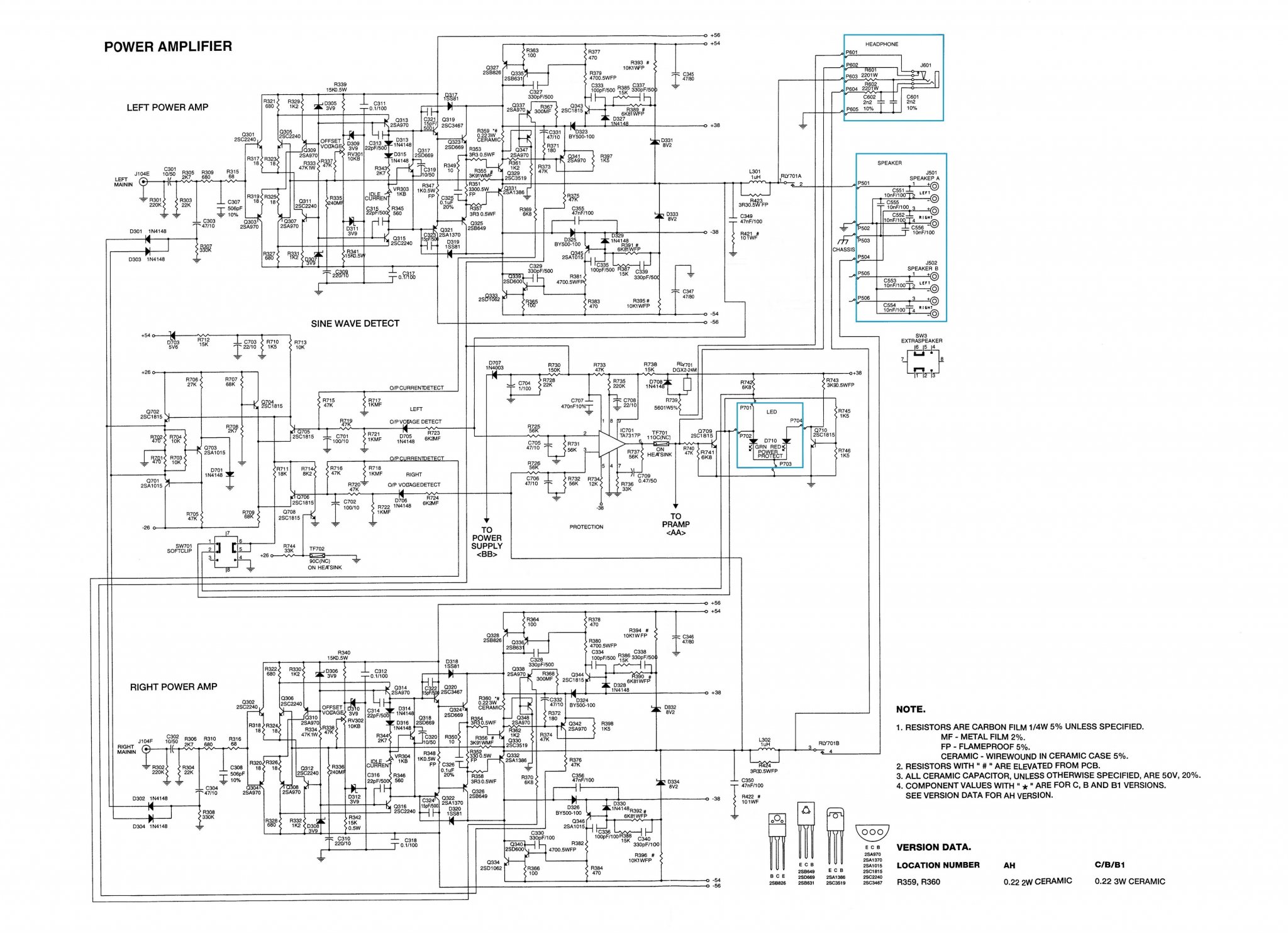

The NAD314 is a good amplifier. The only mod one would do would be to disable the class H power scheme and add an extra output device. Probably marketing and engineering were having a fun dayThere are ready, reliable.

@stratus46, I finally got the time to play with the board you sent me. It works fully as advertised of course, brilliant little circuit (attached).When this thread started, what was aked for was a soft clipper. I drew one up at the time
and posted the preliminary schematic. I now have a final version, the 4 layer with ground
plane PCB is laid out, files sent to JLCPCB, parts on the way from Digikey. That board will
be a very easy assembly. Should have test results in a couple of weeks.
There was one unexpected effect though. With the Slope pot set toward the U1A output, most of the final output signal comes from the AD8036 and is in fact the clipped signal. In such a situation, increasing the input signal hardly increases the output signal and the final output is properly limited.
Now, as you turn the Slope pot toward the output of U3B, most of the final output signal comes through the linear part of the circuit. In that situation, increasing the input signal does significantly increase the output signal too; the signal level isn't really limited.
In a situation where you want to use the soft clipper to avoid clipping a subsequent audio stage, the continued increase of the clipper output when set to soft clipping is an issue. I'm not sure at this point how to correct or circumvent it.
Jan

The circuit was originally done for soft clipping HD Video and may make more sense@stratus46, I finally got the time to play with the board you sent me. It works fully as advertised of course, brilliant little circuit (attached).
Jan
in that context. What you're describing is exactly what I had in mind when I did the
board and if you look closely at the pictures in post 84, that is what you see.
Adding dynamic control may work better for you.
G²
