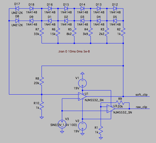

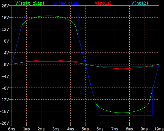

Here's an idea of mine, shown with opamp but applicable to any feedback amp I think:
Emulated:
The onset of soft clipping is set by the zener voltages of D8 ad D17 (here 12V), and more sets of anti-parallel diodes and resistors increase the headroom. I'm using 1N4148's which are limited to 75V, but their low capacitance should reduce the effect of the network on the feedback compensation behaviour. Halving the resistors at each stage seems to give a reasonable waveform, each stage contributes to the roundness of the waveform:
That's remarkable, I've been working on something similar, but for a different purpose. For what it's worth, the Diodes, Inc 1N4148 has reverse rating of 100V.
