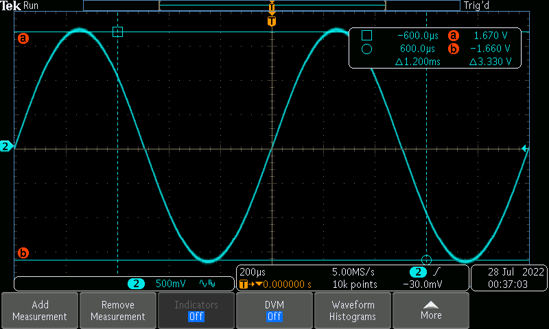

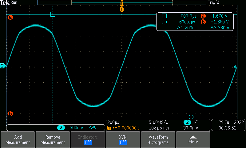

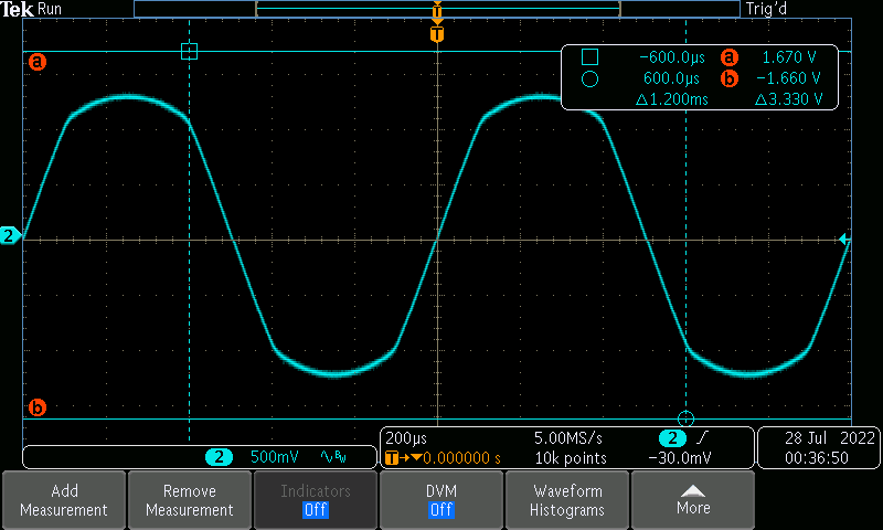

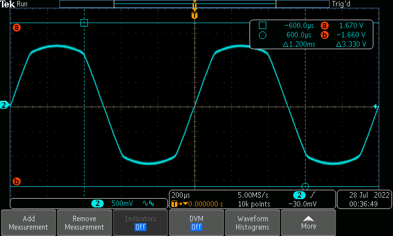

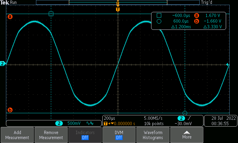

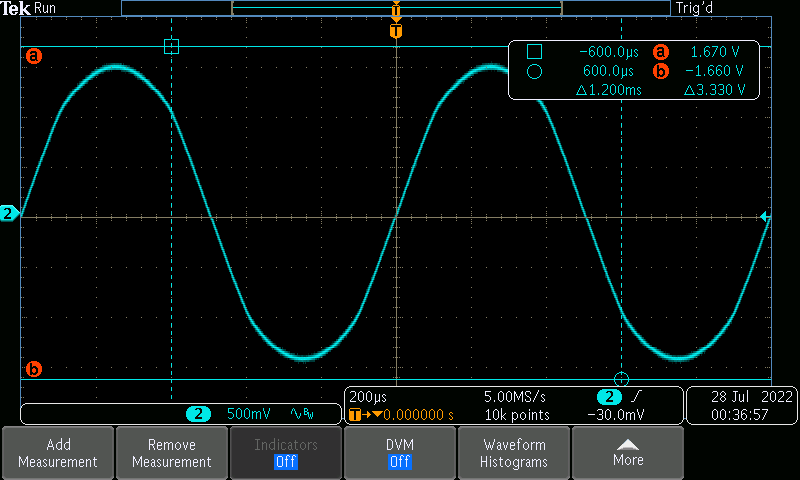

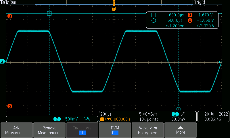

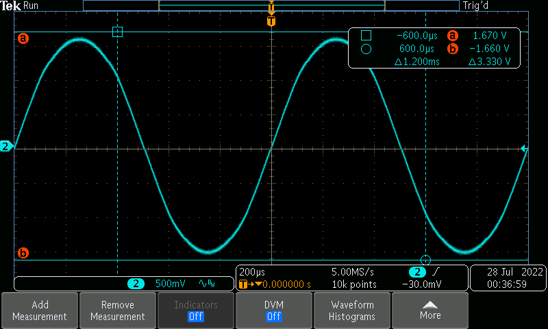

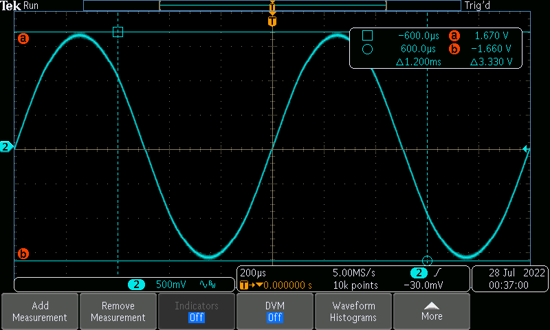

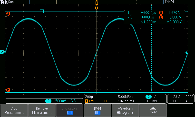

Boards arrived, parts arrived, assembled and first scope waveforms.Wow! Amazing productivity! 👍
1KHz sine no clip, hard clipped followed by changing softness pot with
no change on clip level. It's behaving just as predicted.
THD measurements to follow.
Signals from Adobe Audition 3 and yeah, I see the quirks near the
extremes. I'll check it with a Heathkit sine generator.

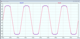

me, the 2nd pic is my soft clipper in "hard" clip. If you look at the datasheet for the AD8036
you'll find about 3mV of transition in and out of clip. This is very similar to the CD clipping.
Notice there is no 'hangover' which is common in solid state amps coming out of clipping.
I call those discontinuities. Crossover distortion, rubbing voice coils cause discontinuities
which we find very objectionable.

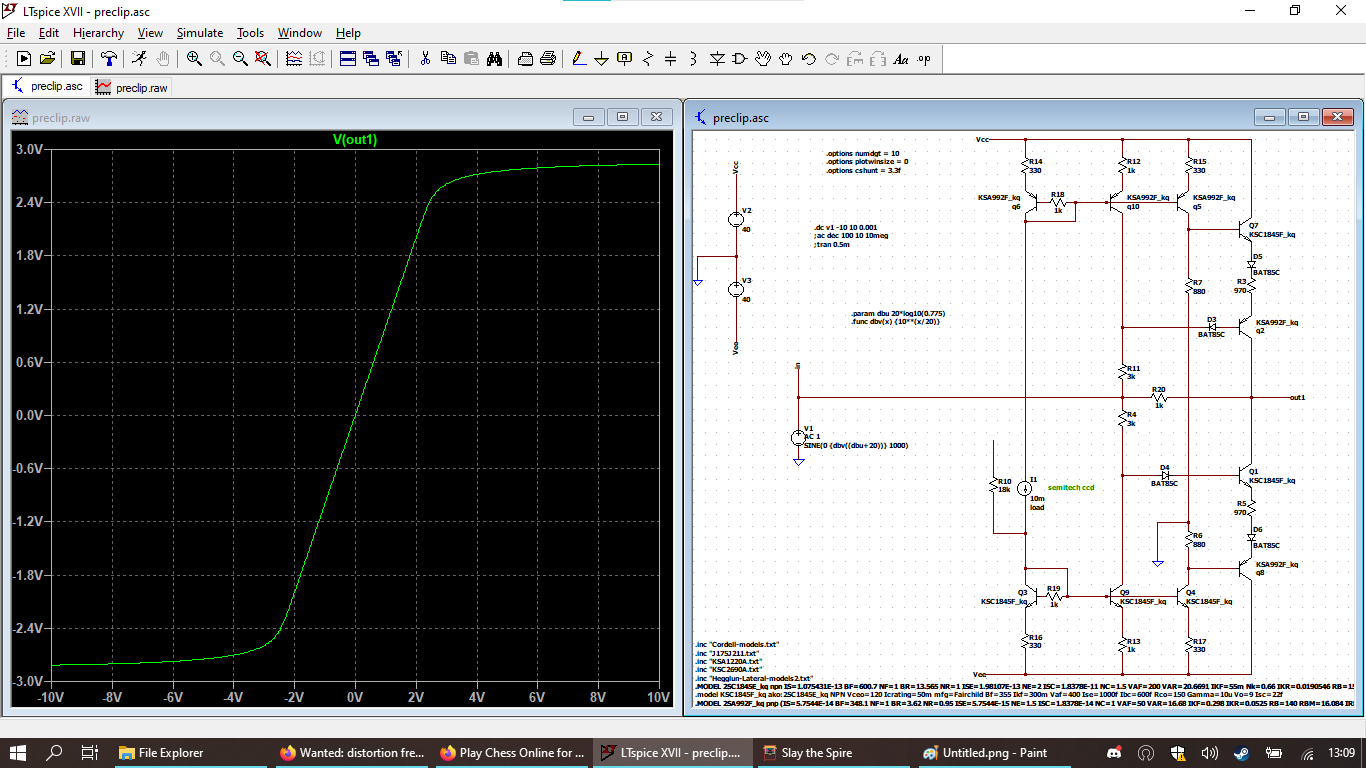

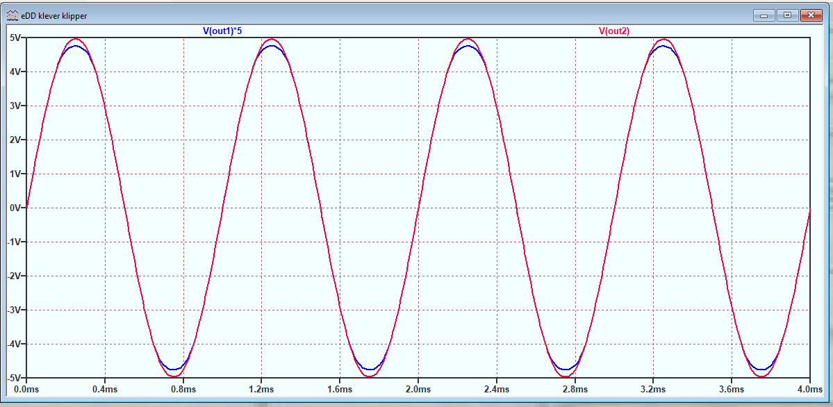

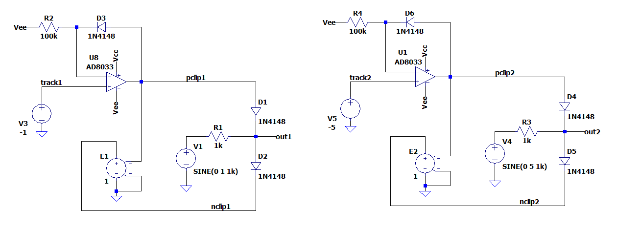

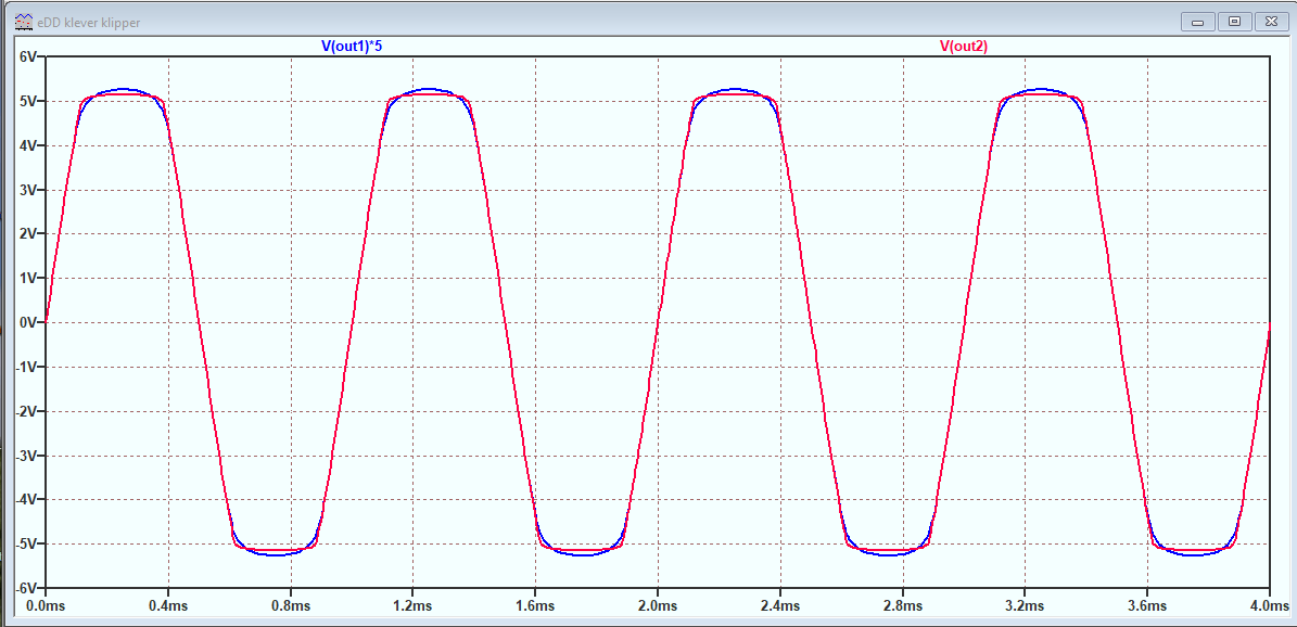

Going back to Bob's Klever Klipper. It's behaviour, how hard/fast it clips is a fuction of the signal levels it is designed for.
The reason is that the clipping behaiour depends on the ratio of the signal level to the diode threshold.
Setting it up for an onset of soft clipping with a 1V signal for instance makes it start to clip relatively early but softer.
Setting it up for say 5V signal makes the onset relatively late butclip harder.
So by selecting the signal level you can make the onset late, so there is less distortion before clipping, but then it will clip harder.
Pick your poison.
KK-1-5 is a klever klipper set up to clip at 1V with 1V signal and set up for 5V and with 5V signal. You see that the 5V signal shows no clipping.
KK-1.5-7.7 is the same setup but now with 1.5V and 7.5V signal (50% over). Both signals show clipping but now the 7.5V clips harder.
Jan
