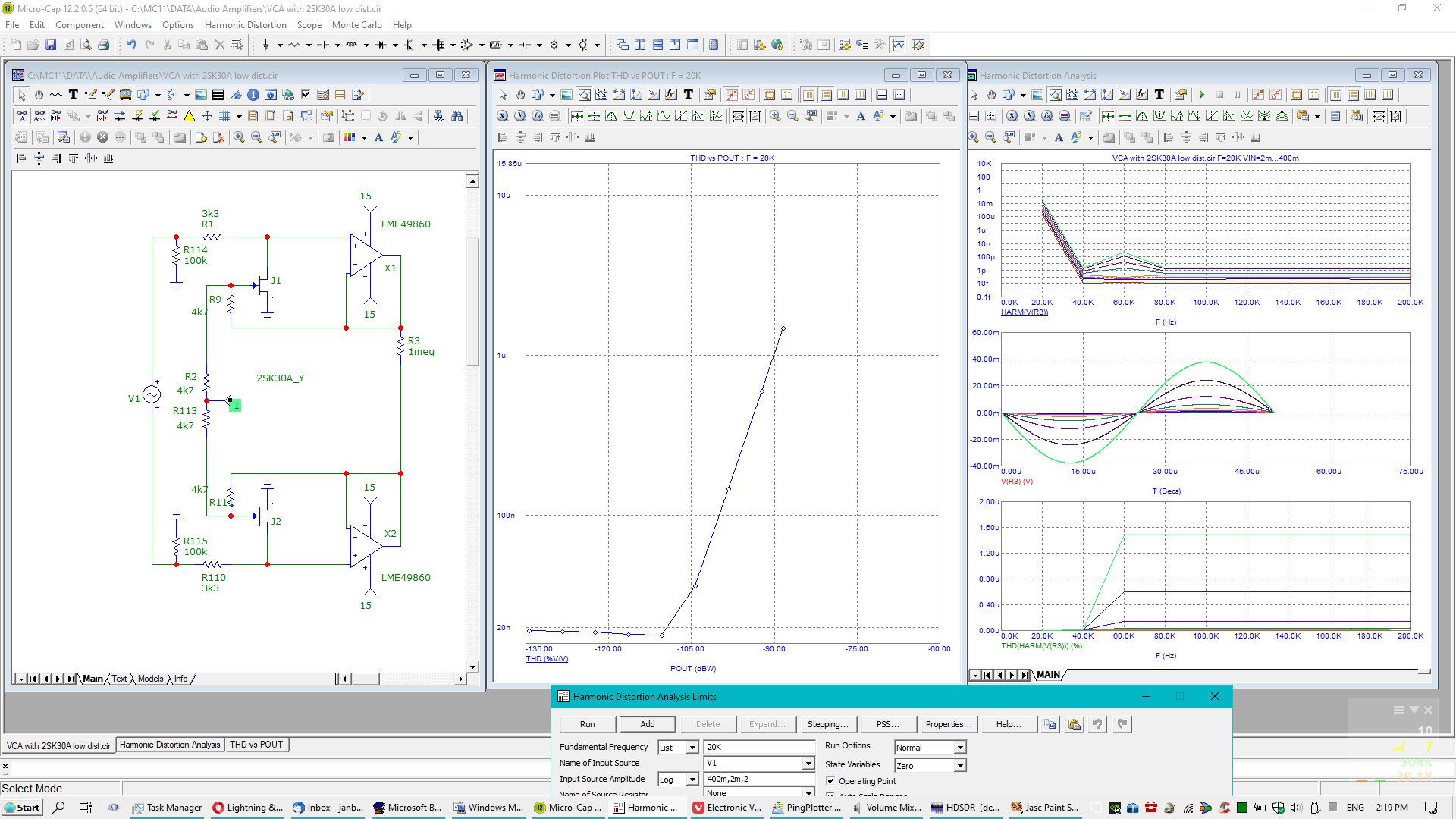

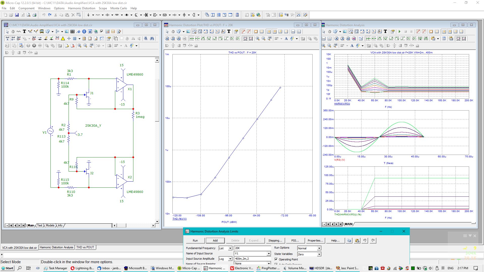

But they just said it doesnt cause any distortion artifact prior to engagement. Upon engagement, it's distorting the signal, kinda by definition. Would be interesting to do a harmonic spectra for the two cases; "prior to engagement" and "upon engagement" for just the pile of input stage op-amps used to implement, say, at the 0.775V level and 0.875V.It's difficult to make a low distortion VCA so I wasn't considering this solution...

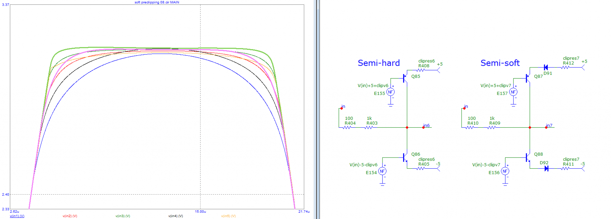

Another attempt. An opamp buffer would drive the transistor bases (expressions shown on schematic). When the signal is out of the allowed range, one of the two transistors turns on, becomes a current source, and returns the signal voltage to the clamping limit...
These require a known impedance source, but the amp should have a THAT12xx balanced receiver at the input, so it's okay.
The one on the left could exceed the transistor's Vbeo, so the one on the right adds diodes.

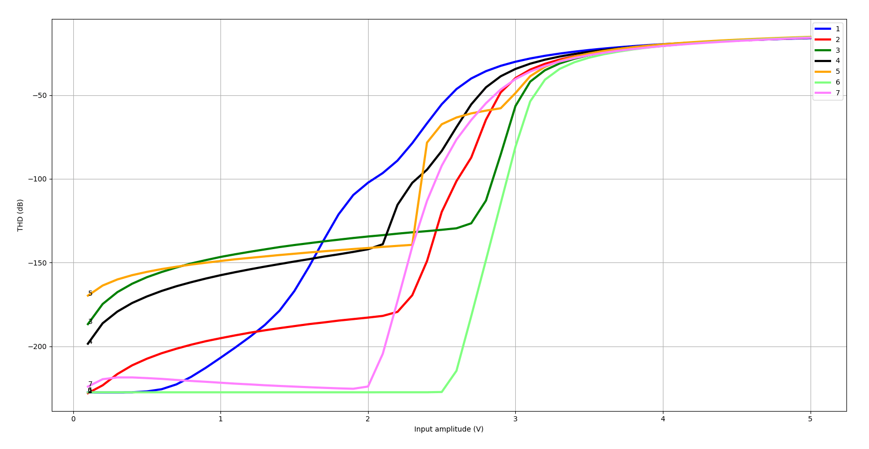

It turns out that the collector of a transistor that is turned off (and bootstrapped) doesn't add much distortion to the signal...
THD in the simulator's noise floor (-220dB) before it begins soft clipping. Ding! We have a winner

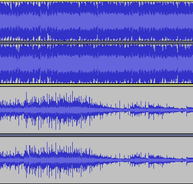

Good idea to switch off output. In the course of time I accumulated a variety of music with a "too wide for comfort" difference in output so either the peak level has to be equalized, or a limiter has to be used followed by lowering volume . With a DSP that would be fairly easy, reading a song in memory, setting the required peak level and playing it. No idea if such an application already exists.My amplifier automatically switches off its output relay when the clipping is really bad. The only time that happened (apart from testing it with a dummy load after building it) was when I was playing a DIY nature recording with a lot of wind blowing at the microphone, something like a group of oystercatches recorded from a 100 metre distance with an ordinary stage microphone. The recording still needed to be high-pass filtered to get rid of the wind sounds, I only heard a lot of loud rumble with very faint bird sounds.
There is a free program called MP3Gain that uses a rough psychoacoustic model to make the apparent loudness of MP3 files roughly equal. It does so by adjusting scaling factors without decoding and re-encoding the audio. Its disadvantage is obviously that it only works for MP3 files.
Apparently there is something called ReplayGain meant for other file types. I don't know anything about it, I only heard the rumour that it exists.
Thanks, if such an application exists there might be more so a search could be worthwhile. I've been using wma since it became available and also have much in wav format. The difference can be heard to the extent that I won't use conversion.There is a free program called MP3Gain that uses a rough psychoacoustic model to make the apparent loudness of MP3 files roughly equal. It does so by adjusting scaling factors without decoding and re-encoding the audio. Its disadvantage is obviously that it only works for MP3 files.

It's a tag that contains the gain setting the file should be played at, calculated from the average loudness. If you add the tags to your flac library (foobar can do this automatically) then enable ReplayGain in preferences, then it will set the volume accordingly on playback. It works very well. That way, you can make a playlist with well mastered music (high dynamic range) followed by modern compressed to death trash without having to rush to turn down the volume... Very convenient. You can set the gain for the whole album, or track by track.Apparently there is something called ReplayGain meant for other file types. I don't know anything about it, I only heard the rumour that it exists.
For example it will turn down LP "Lost on You" by -8dB relative to Dire Straits "Telegraph Road", doesn't make LP sound any better, it was destroyed in mastering which is a shame, but at least it doesn't make ears bleed...
