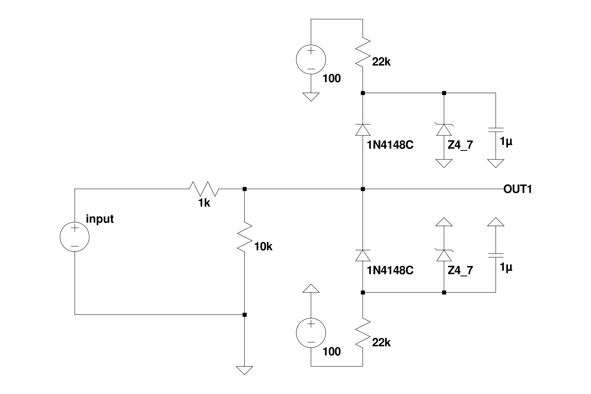

Here is how I implemented it:
The main idea behind this circuit is less soft clipping, but to protect the amplifier input from gross over-voltage events like ESD, mains or loudspeaker level.
The diodes in reverse bias add some distortion due to variable capacitance, but the distortion is not too terrible.

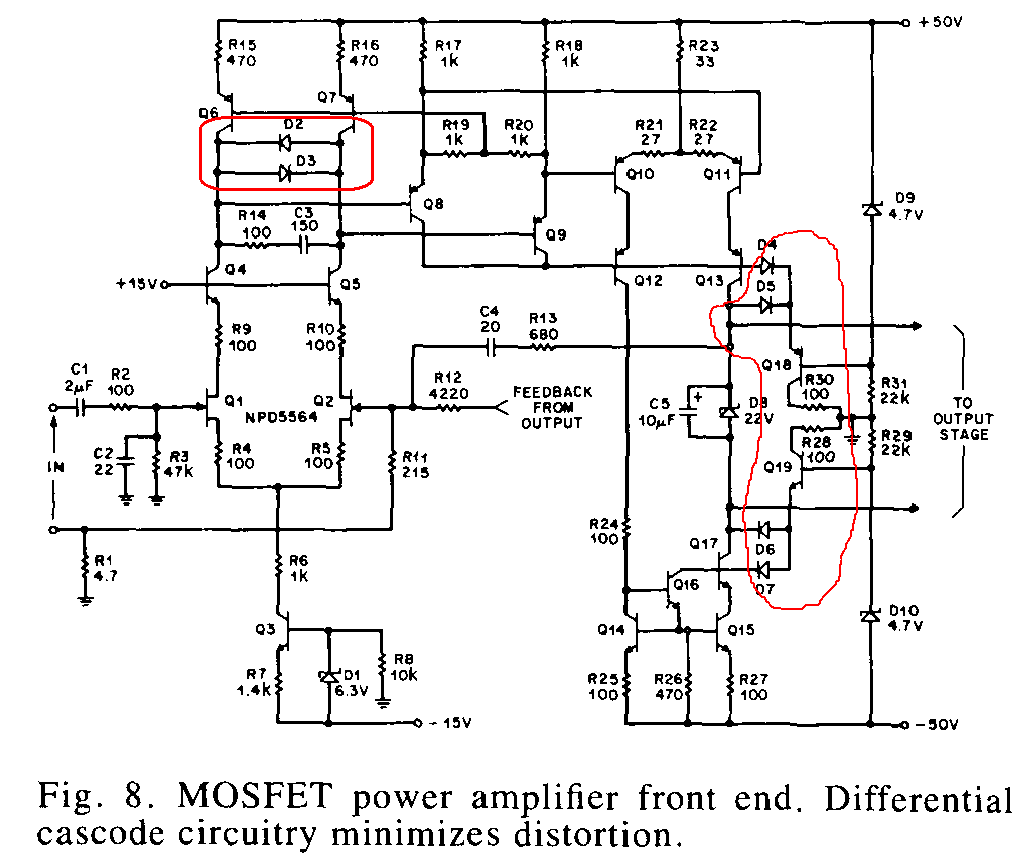

Peufeu, can you apply Bob Cordell's anti saturation clamp diode concept to the first two stages of the amp? {From his 50 watt MOSFET power amp with error correction AES paper} In effect, make the front end of the amp clip sooner than the output stage's clipping point?
Yes:
On your schematic, the diodes on the right cleanly clip the output of the VAS, probably to avoid squeezing and saturating the transistors in the error correction stage. When that happens, the input stage will still try to drive the VAS even more, that would probably saturate one of the VAS transistors or make it misbehave in other ways. So the diodes on the left prevent this by limiting the output current of the input stage. The input stage still clips, but that's not a problem because one of the transistors will just turns off. As long as no transistor is saturated, it won't stick to the rail after clipping.

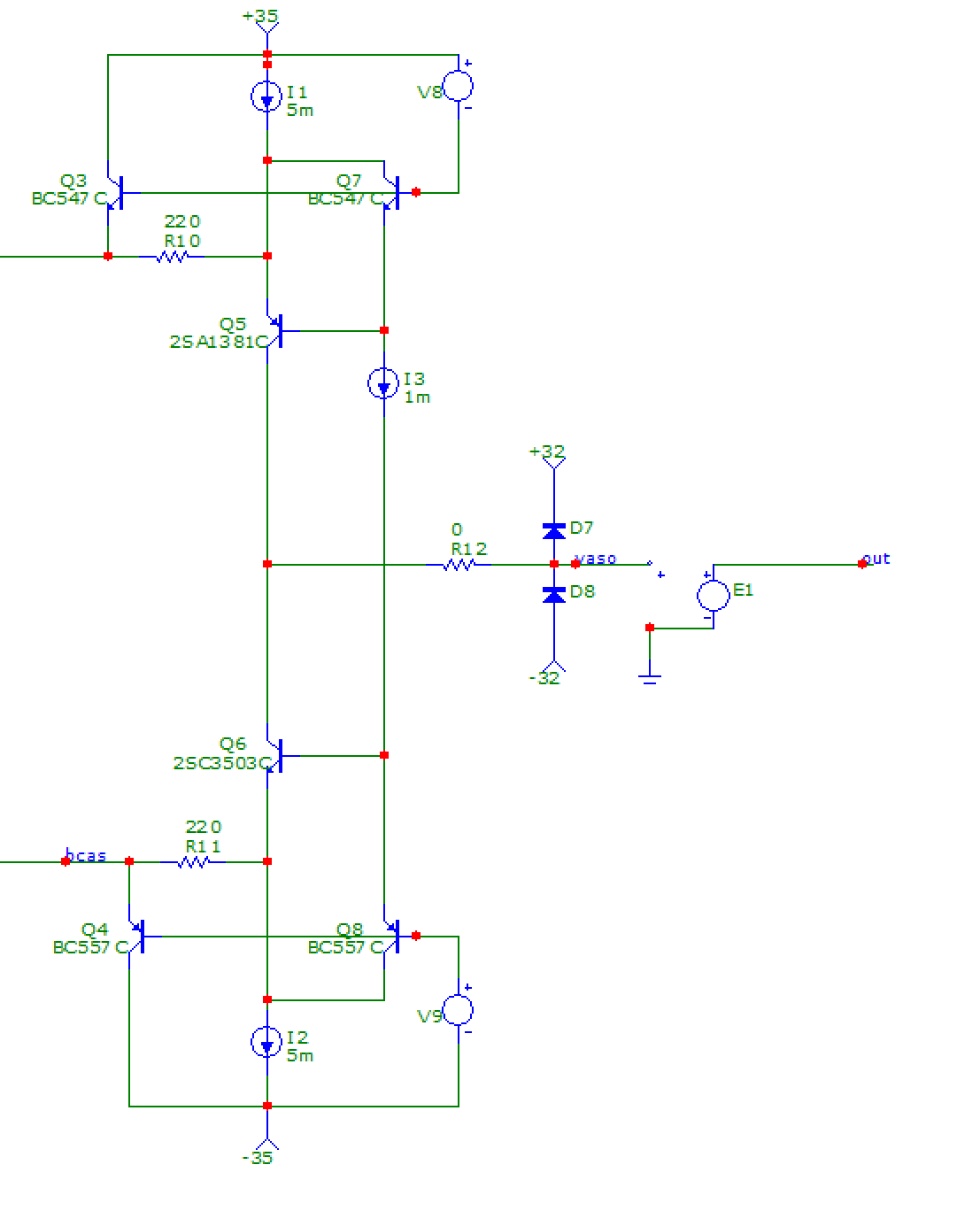

I'm working on a folded cascode:
The output from the input stage comes from the left. Q5/Q6 are folded cascodes, Q7/Q8 are superpairs to recycle base current. The diodes handle clipping before the output stage. When that happens, the input stage will pull more current. If it pulls more than I1/I2, that will reverse bias the folded cascodes Vbe and smoke them. So I can either increase the current sources (I1/I2) above the max current the input stage can provide (and waste power), or simply add Q3/Q4 which do the same thing as the diodes on the left of Cordell's schematic, and save the cascodes from reverse biasing.
However, my input stage is probably going to be an opamp, and I don't want this opamp to clip. I can't open it to put diodes inside 😉 that's why I'm considering pre-clipping the input signal.

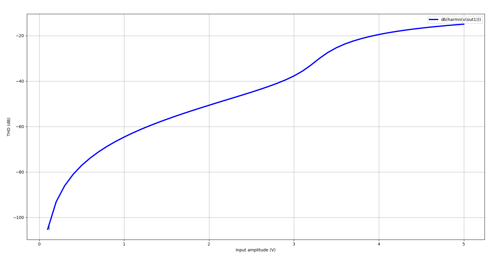

This is the Spice results from post #12. "Passive", open loop.
Of course it is simulation only.
But if you look at the datasheet graphs for residual currents, I have no reason to believe it will be much worse.
And I only really need 2Vrms.
The rest are for speaker protection only, just in case.

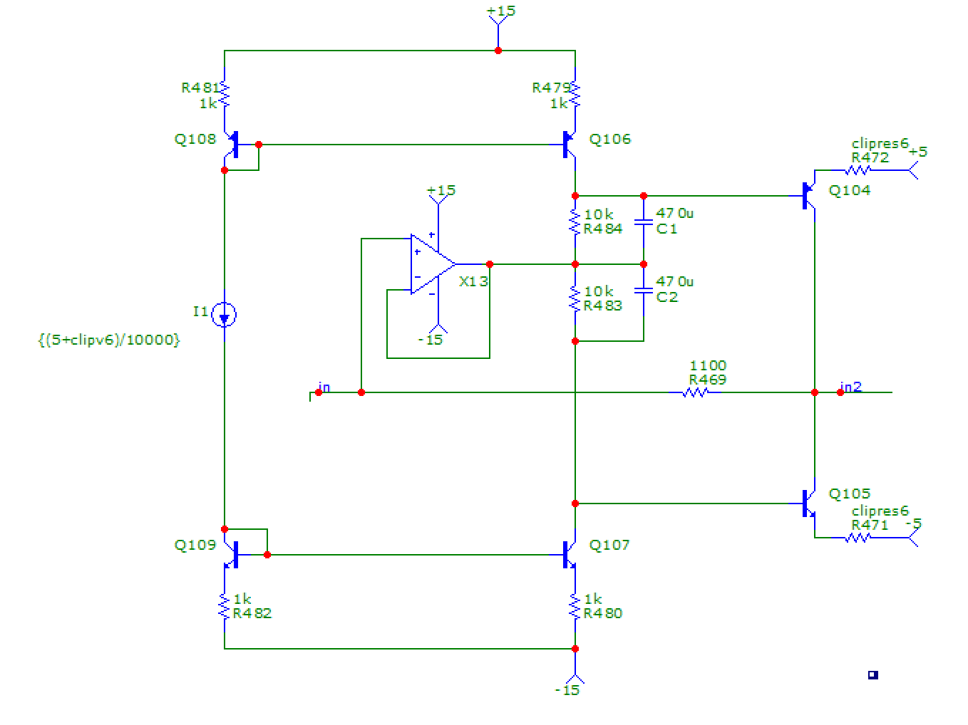

The one from post 25 gives excellent simulation results, because the clamp devices are bootstrapped to the input, so their nonlinear capacitances don't get to influence the signal. I think it's simple enough. I've added a current source on the left to set the clip voltage, the two current mirrors just replicate that voltage across the two bootstrap caps for convenience. I1 could be a pot, to set it by hand, or the positive and negative thresholds could be made proportional to the current voltage on the power amp's supplies for example.
Yes, well you could use any other value, the important thing is that it matches the other two resistors labeled "clipres" so when it goes out of the allowed range, the transistors pull current through these resistors that should cancel the signal across the 1100R resistor. The value of "clipres" is defined as a little bit lower than 1100 ohms because the transistors' internal Re are in series. If the value is too high, it won't substract all the signal above the clip threshold, so clipping is soft.
This needs to be fed from a low impedance source like a buffer opamp, or a balanced receiver in the case of a power amp, otherwise whatever is in series with the 1100R resistor upstream will also count.

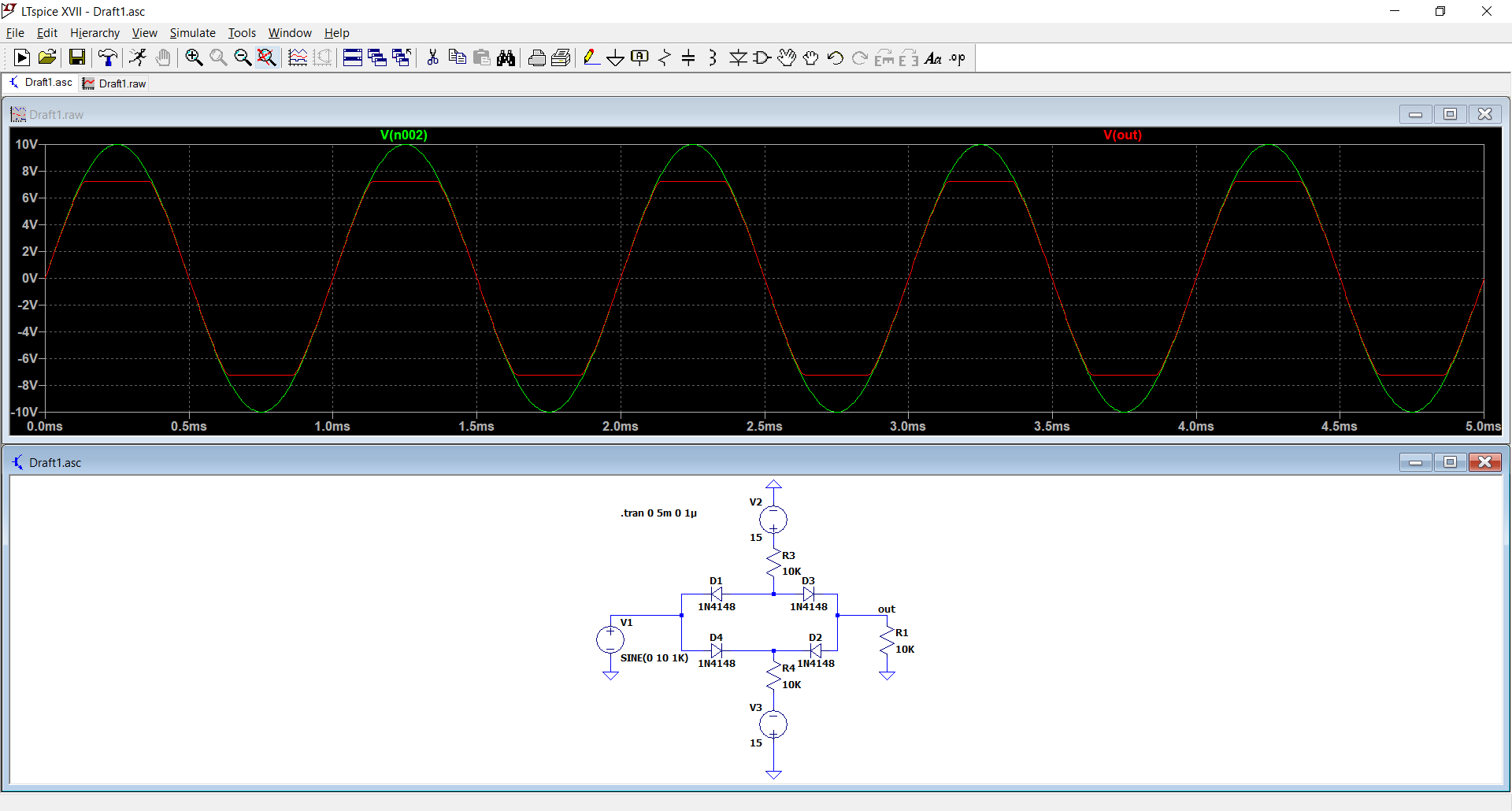

This is what I use for 2Vrms differential input, essentially distortion free.
And passive.
Patrick
This is mainly a result of the very low impedance level and symetrical configuration.
With low-capacitance schottky's (or diode-connected Fets) and low resistor values, any clipper will look better, including the series type
