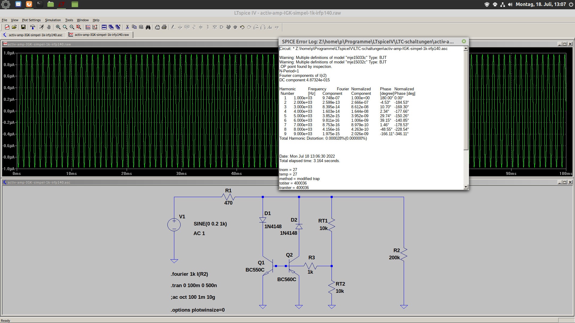

Wanted: distortion free soft clipping circuit

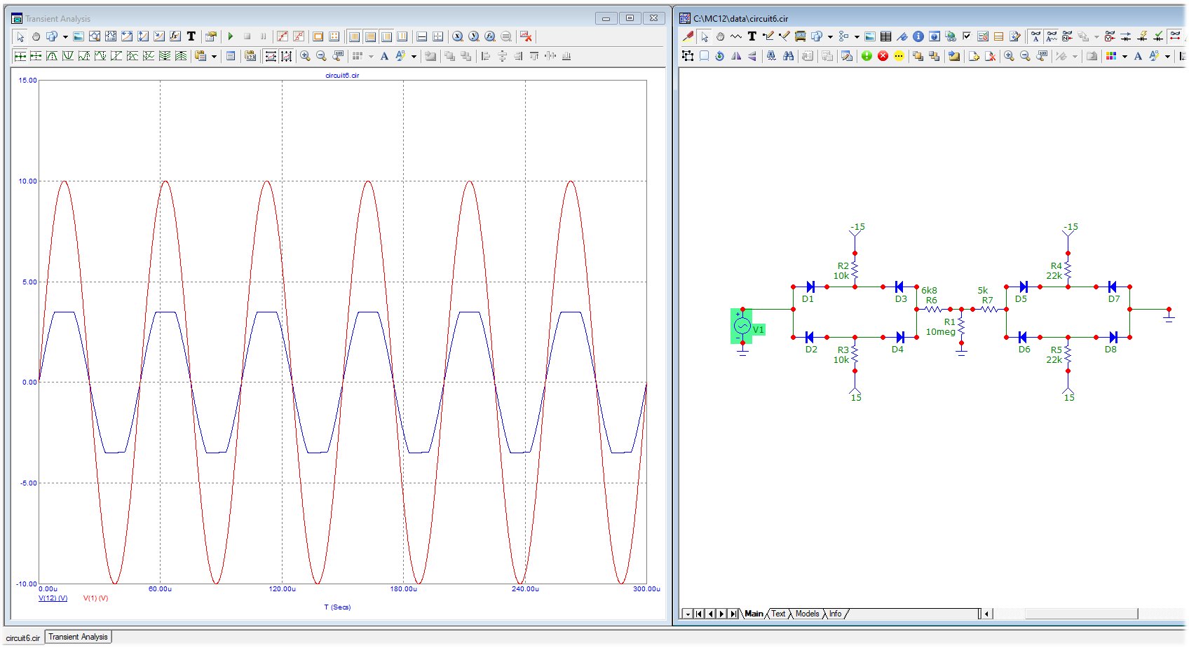

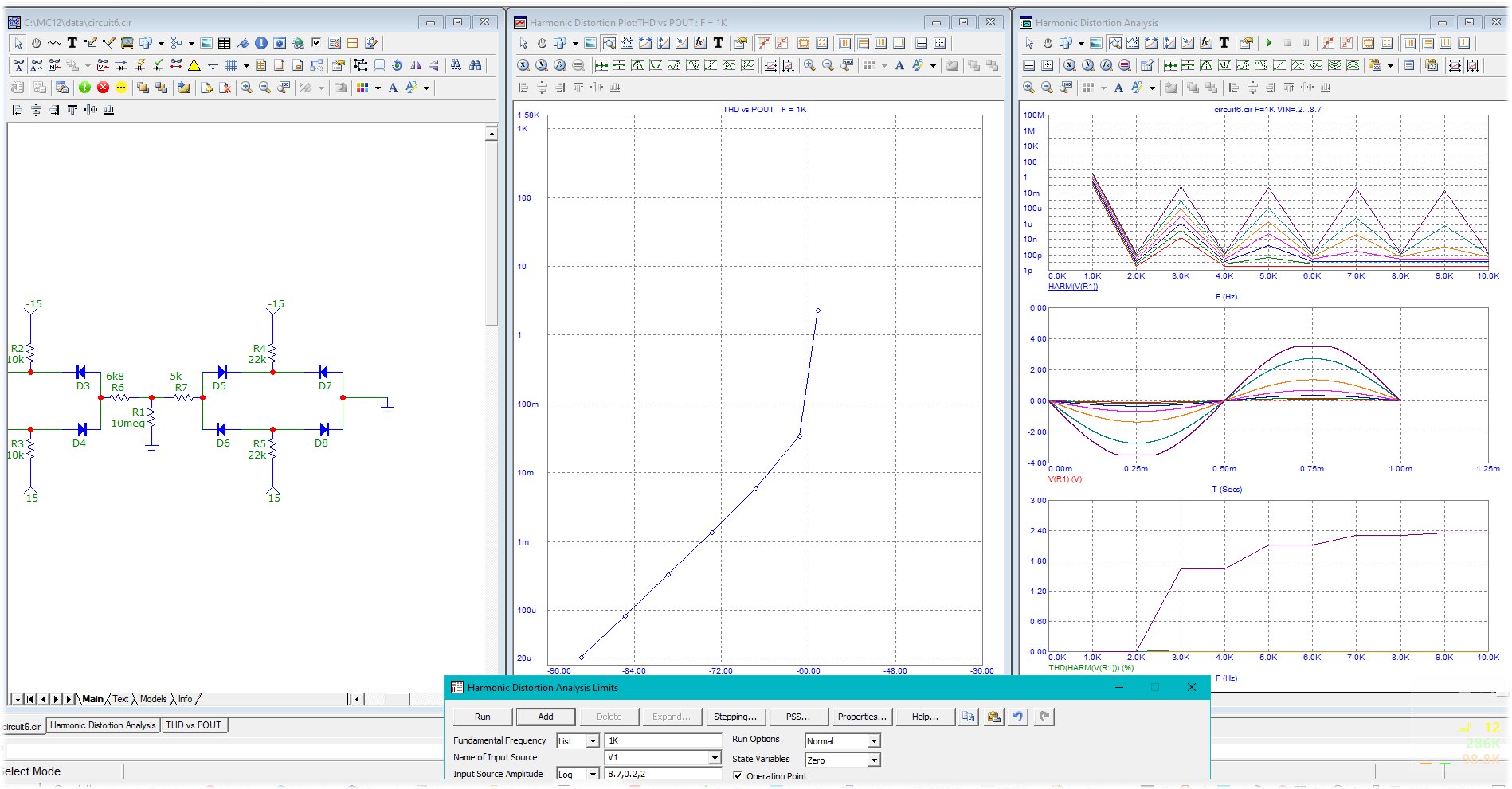

Using a compensating network, the linearity can be improved by ~40dB; with better diodes, more sensible resistors values and a bit more tweaking, further improvements would be achievable

And yes, matching is required if you want the best performance. Randomly picked diodes would probably improve the linearity by 20dB, not the 40dB afforded by the ideal spice matching.
Multiple diodes are available, in various configuration (in European and Japanese type numbers, at least, but JEDEC types are also probably available), even in packs of eight, but I am not sure about their configuration: probably common anode or cathode.
With 4, you have more flexibility: ring mixer or FW rectifier, or two uncommitted pairs.
You can run a Monte Carlo analysis to assess the effect of mismatch on the global performance

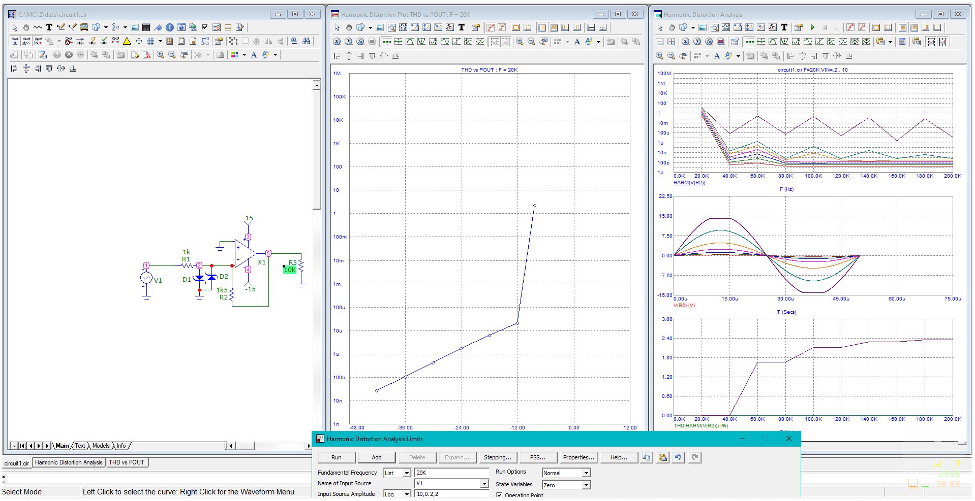

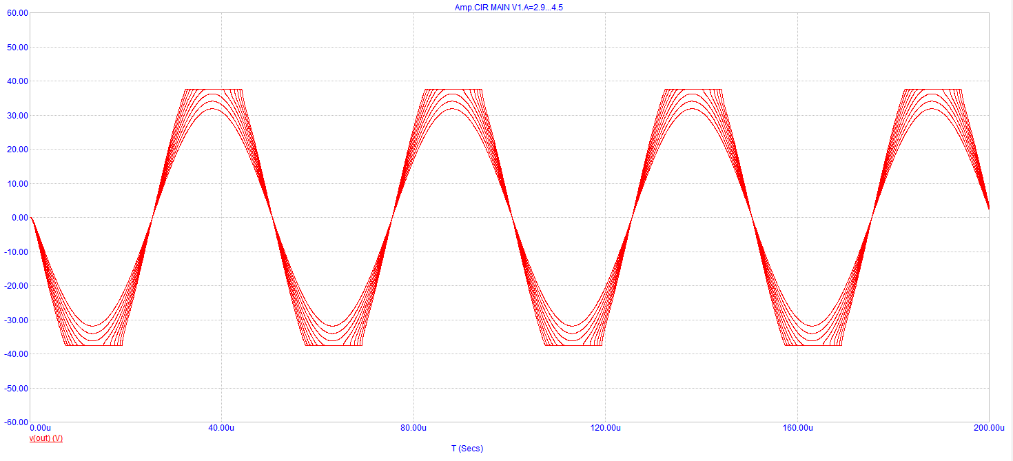

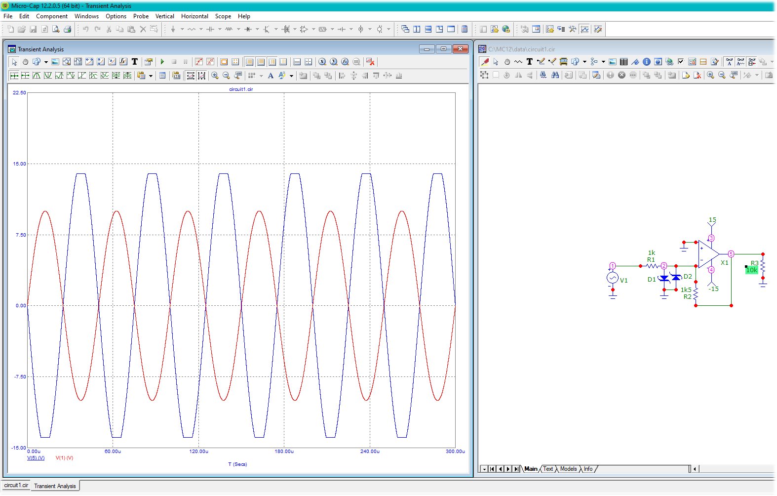

Series diode clippers have been used in AM receivers as noise limiter and as IF limiter in FM receivers. The advantage over parallel clippers is that the output doesn't exceed a set value - hard clipping.
The compensation network can decrease distortion (fiddle with the value of R6, 6k8 to see the effect) before hard clipping occurs and the better that's done, the more the result resembles that of a rail to rail opamp clipper. Example in the pics, diodes at inverting input speed up recovery (and also function as input protection for unexpected, potentially catastrophic events).
After all, mismatch doesn't have such a catastrophic effect: in this test, I sabotaged the compensating network by using different models for the diagonals, to maximize the THD:
It ended up with a 12dB penalty, not that catastrophic after all.

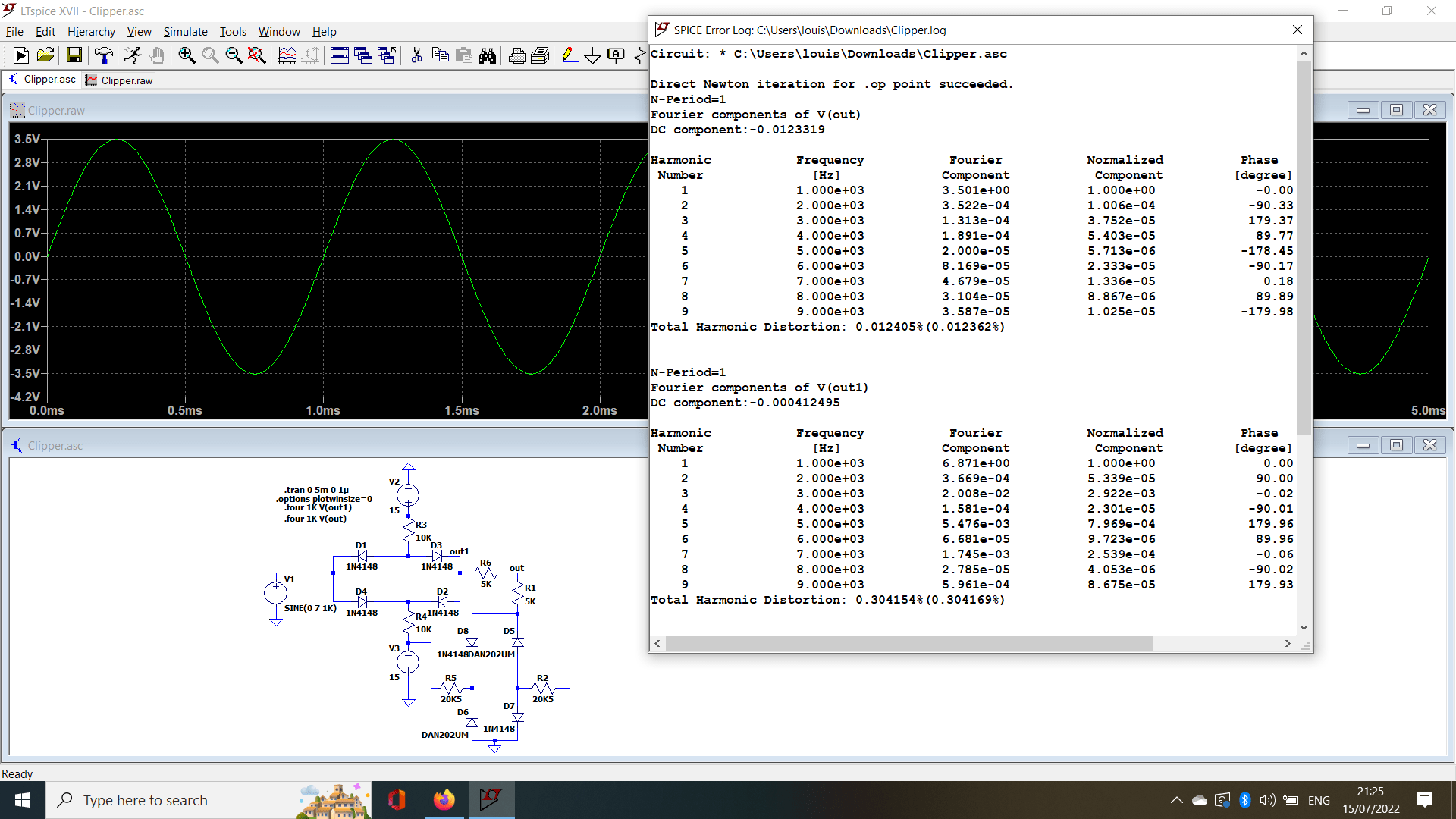

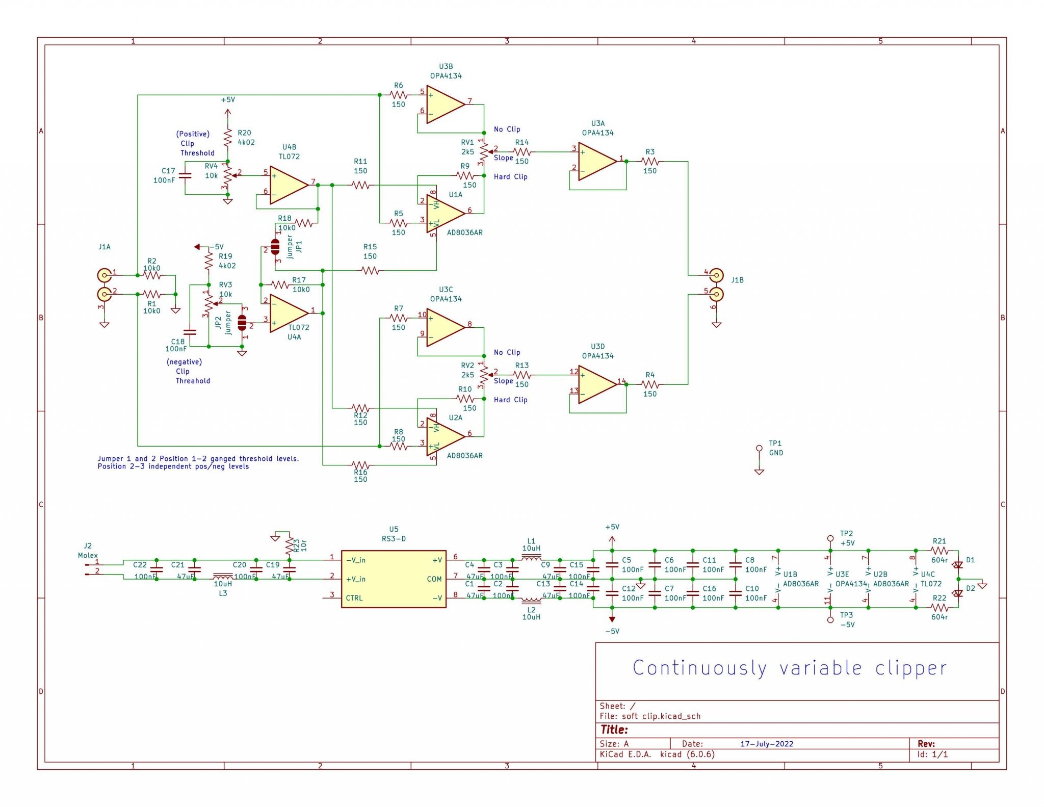

When this thread started, what was aked for was a soft clipper. I drew one up at the time
and posted the preliminary schematic. I now have a final version, the 4 layer with ground
plane PCB is laid out, files sent to JLCPCB, parts on the way from Digikey. That board will
be a very easy assembly. Should have test results in a couple of weeks.
BTW it appears the ACTUAL request was for an AGC with only gain reduction. Not quite
the same as a clipper.

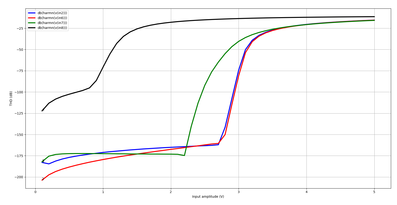

For me at least Reply #12 suits my purpose better.

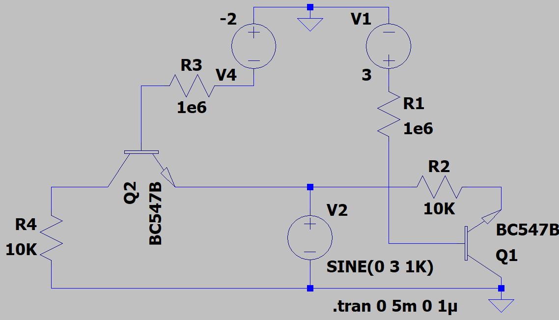

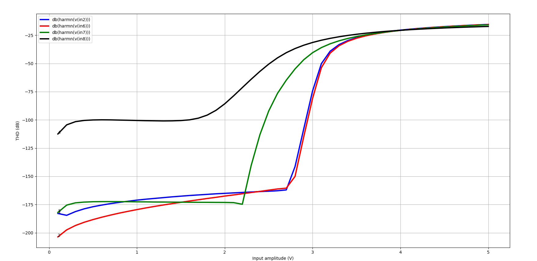

The voltage at which distortion is low (<-90dB), to the maximum clipped output voltage (max input current 20mA), is narrower.
So for a given maximum (clipped) amplitude, it gives a wider low-distortion range.
This is of course due to the sharp turn-on nature of the shunt references, compared to a diode or a BJT Vbe.
Patrick
0.2% at 1V input according tomy sim.
P.
OK
For the plot in the above post, I modified R3 (using part numbers for your schematic) to 33k to make it clip at a higher voltage, around 3V, instead of 1.2V. All the other circuits use 3.2V, as a target for maximum clipped output voltage. Some distort more at lower voltages than others.
That should explain the difference.

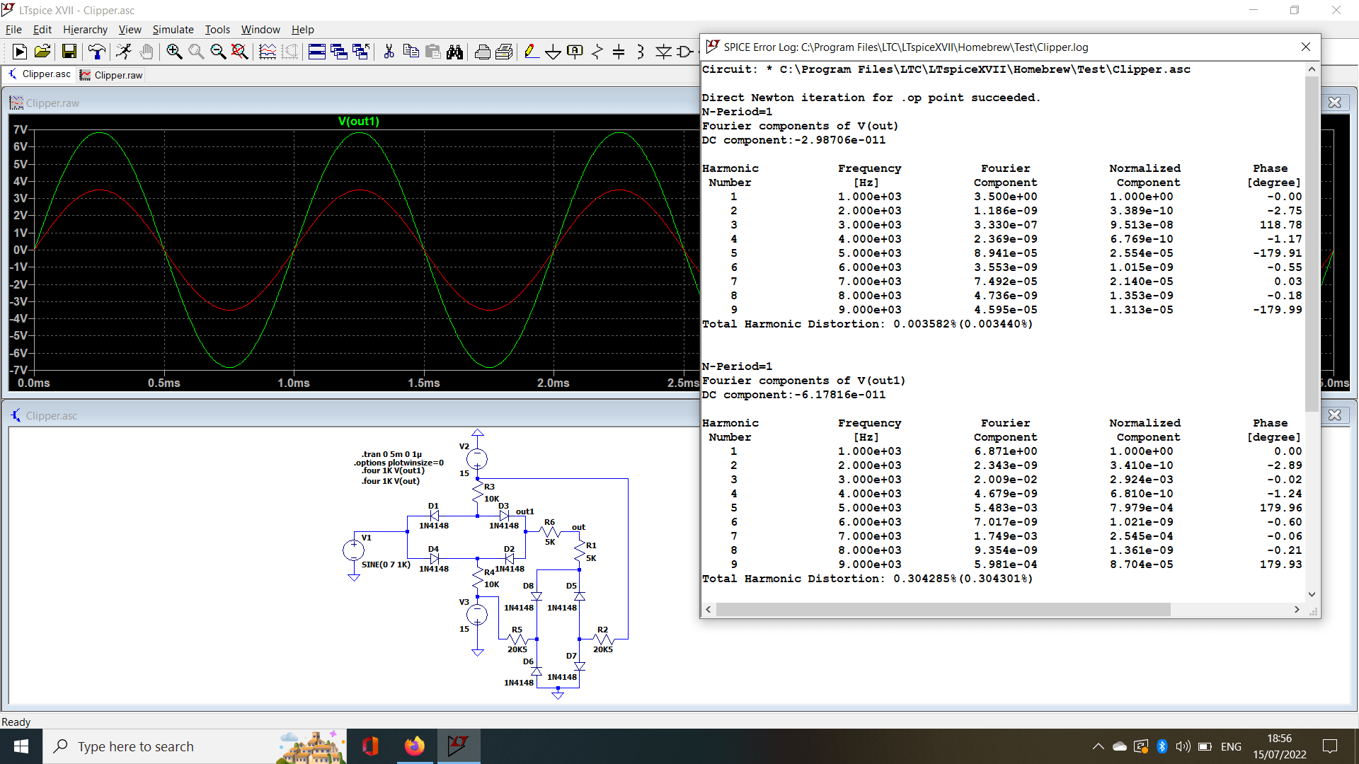

Here's a new THD plot with R2=R3=10k, same as your schematic, but using different sim (microcap). Diode is BAS516, BJTs are BC547/557C. At 1V it's close to what you found.
I left the other circuits at their 3.2V setting, so there's no change there.
