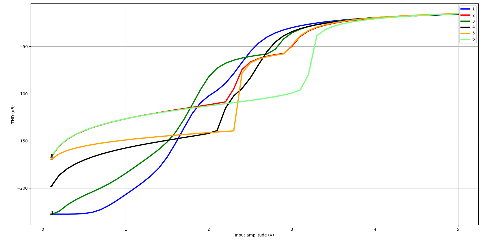

I've come up with an unusual amplifier topology involving boostrapped stuff, and that seems to have, shall we say... non-optimal clipping behavior. So it looks like I'm going to need a pre-clipping circuit.
Of course it should not distort at all until it does.

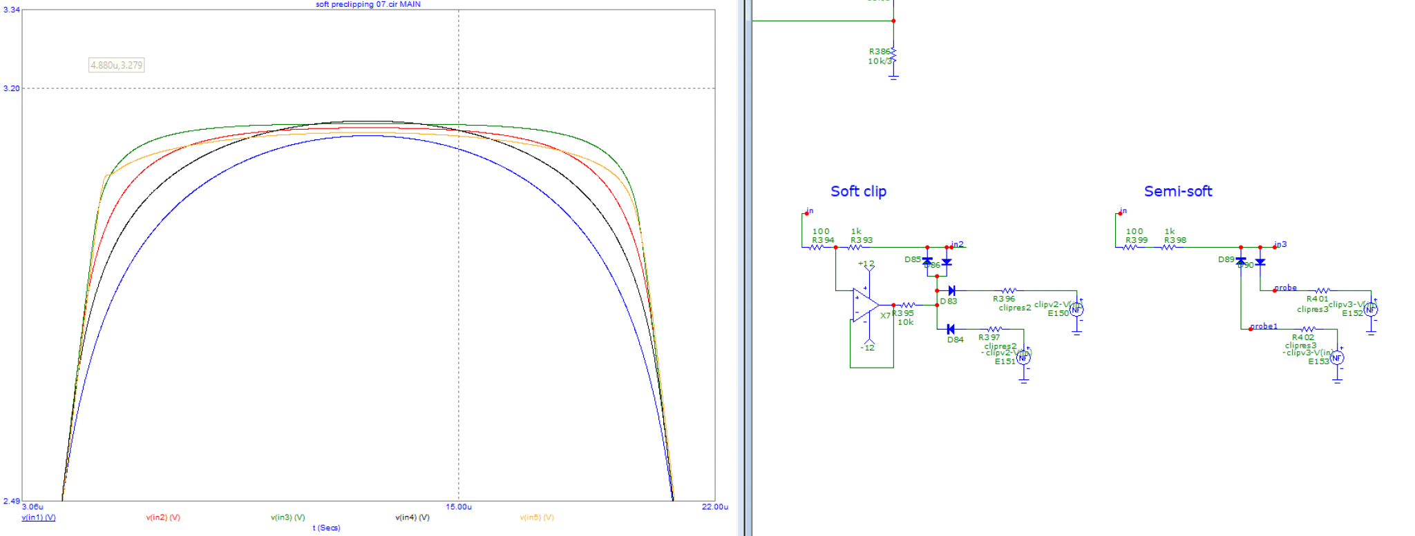

I've sketched a number of attempts, all involving bootstrapping the clipper diodes to reduce distortion by keeping voltage across them constant, which avoids nonlinear capacitance effects, leakage, etc. The bootstrap voltage is itself clipped by another pair of diodes, so when it reaches the limit, the other side of the diodes no longer follows the input signal and they begin doing their job.
The four ones on the left use diodes or transistors as diodes. They're strictly at the input of the amp, so they need an opamp buffer for the bootstrap voltage. The one on the right deletes the opamp by using the amp's output voltage (the power amp is VCVS E1) and using BJT emitter followers as diodes. Basically the two transistors' bases follow the input signal so they do nothing, until the diodes on the right conduct, at which point the transistors limit the input signal.

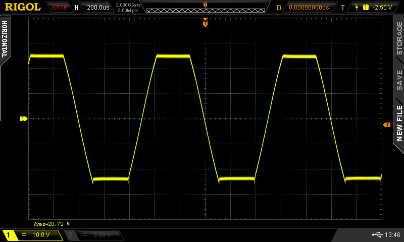

On the left is a sinewave with a smashed top.
And here is THD vs input level. Simulations are sometimes slightly optimistic, but it looks like "no distortion before it has to begin clipping" is achievable.
Thoughts?

Thanks for the info, but... this circuit was designed to clip hard by using feedback, which means the opamps must slew by two diode drops on each clip event, which makes a glitch. And the goal of the clipping circuit was to avoid precisely that glitch.
The tradeoff for soft clipping is increased distortion at high level, but that doesn't matter much because loudspeakers already make a ton of distortion at high level.
I don't like this circuit. I want the clipping to be a bit soft. When the signal isn't just one sine wave, but a bit more complex (example below) the softer clipping gives a much cleaner result.

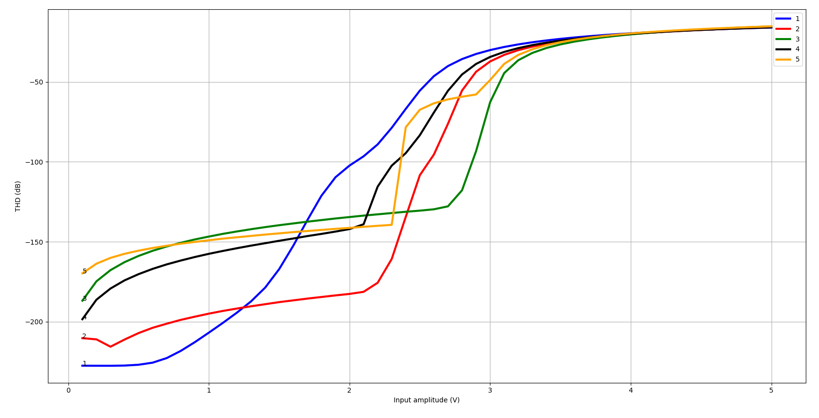

Stepping the amplitude shows why I didn't want to put the diodes in the feedback of an opamp and force it to slew...
Also all circuit in the first post except #2, have at least 30dB less distortion at low level because they bootstrap the clipping diodes... (Self's circuit is #6 in bright green)

Yes, that's a given with a soft clipping circuit.With soft clipping enabled, THD begins to rise when output power is ~ -3dB below the clipping point.
The title was a bit ironic. What matters is that distortion shouldn't increase below the level when it starts working.
But it looks like that's going to work with the 2 diode Cordell circuit also.

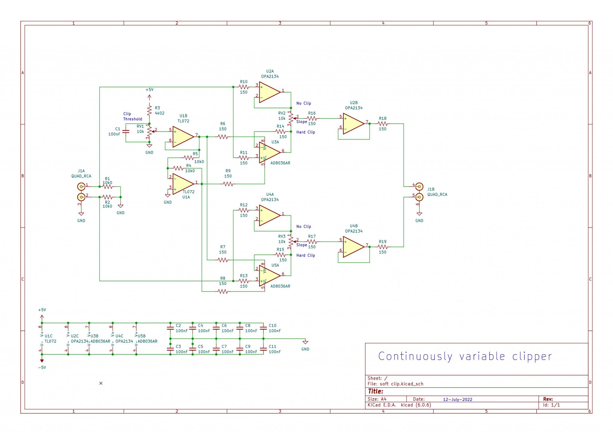

20 years ago I did a soft clipper for a Hi Def telecine (film to video) It could
clip white vs black with independant black and white levels and a continuously
variable slope on each. This is a simplified version with continuous slope but
symmetrical pos/neg clipping. There are no discontinuities which would look
bad in video and sound like crossover distortion in audio.
The AD8036 is $12 at DigiKey. Check the data sheet as it's a very impressive chip.
https://www.analog.com/media/en/technical-documentation/data-sheets/AD8036_8037.pdf
Adding separate pos and neg clip levels with independant slope requires cascading
2 AD8036 stages but it works very well in video. Audio should be a snap.
If you attempt to build it I HIGHLY recommend using a 4 layer board with a
ground plane. The 8036 can hit 200 MHz and while stable, things get hinky on
breadboards. 5 boards would run $8 at JLCPCB.

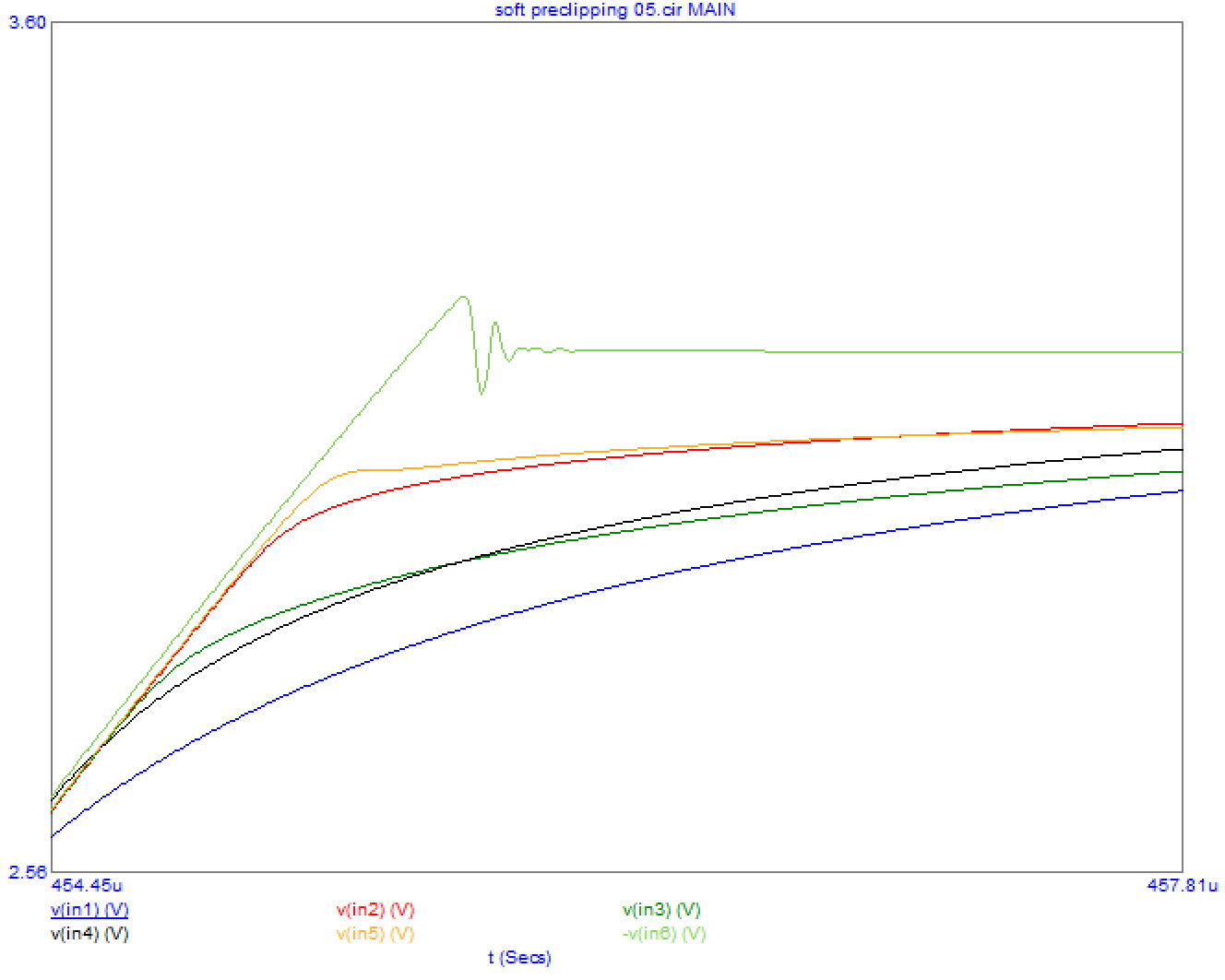

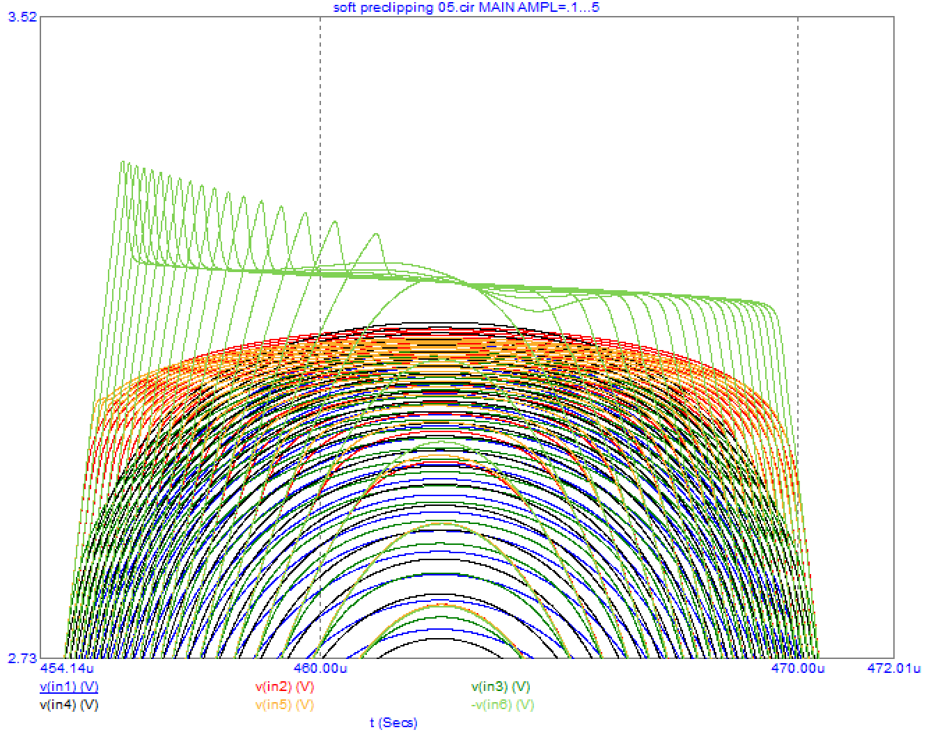

I did various sims and it looks like the choice of the diode is crucial... But is that because of model inaccuracies, I don't know. So far, BAS516 wins due to low capacitance, low leakage, and quick recovery.Using various basic circuits

I think I found a way to fix the clipping behavior of the amp, though. That would be a more "correct" way to do it lol.
PS: simulated BAS516 gives much better post-clipping recovery than BAS45 in your sim.

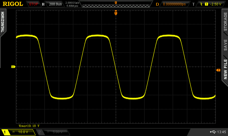

I've been chewing on getting a Rane MA-6. Supposedly, it's "the loudest 100W / ch amplifier" many have ever heard. Not that I'd need its capability for anything I'd do these days...
"USING THE BUILT-IN LIMITERS The built-in limiters in the MA 6 allow a significant increase in usable volume levels without clipping The limiters DO NOT effect dynamic response, distortion (italics mine...) or noise level of any material below about 90 watts output level. They simply “watch” the input level of each channel, and whenever the input tries to go beyond .775V, (which is the input level required for 100 watts output power), the limiter ‘jumps in’ (out of hiding as it were) and literally turns down the input level to prevent clipping. It does this very quickly (in about 1/100th of a second) so that only the peaks of the music are affected. What this means is that when ever a yellow LED flashes, a musical peak has been quickly turned down to avoid clipping. This allows you to run the amplifier at a higher continuous level, typically about 4dB SPL higher than without a limiter. And that 4dB of increased SPL is the equivalent of a 250 watt amplifier without a limiter."
The service manual is easy to find, via google "rane ma-6 service". In there you can see the active limiter component, with a box drawn around it that says "remove to defeat limiter".
I would wager the people at Rane know what they're doing. According to them, their circuit effect has some notoriety in the sound reinforcement world.
The only other bit of knowledge I can offer is that Zener diodes clip softer than regular diodes, when used in the Zener direction in an op-amp feedback.

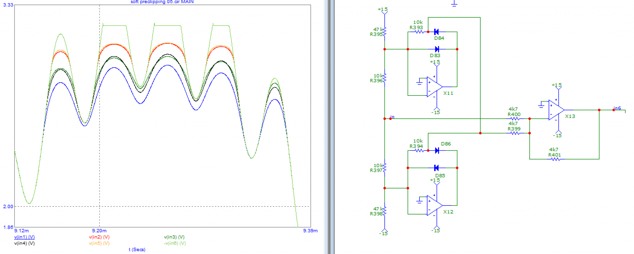

I've come up with another scheme, drawing inspiration from Self: substract an inverted copy of the signal, only if it is above the clipping value. I did not put the diodes in the feedback loops of the opamps, to avoid slewing effects. Two versions: one where the diodes are bootstrapped, for lowest THD before clipping (red), and one where they are not (green).
The latter (green) is quite simple, it needs a dual opamp to invert the signal and add offset. It is only in the signal path when clipping, so it can be very cheap. Estimated THD before clipping -128dB, which is fine.
I'm gonna try current sources now.
Yes, I have been hunting for a low leakage fast recovery diode. The lowest leakage ones have very long recovery times, there's probably a compromise between the two in the manufacturing process. I picked BAS516 as a compromise."simulated BAS516 gives much better post-clipping recovery than BAS45 in your sim."
BAS45 was chosen for lowest leakage current.

OK, it's a voltage controlled amplifier whose gain is lowered if the signal level exceeds the limit.The service manual is easy to find, via google "rane ma-6 service". In there you can see the active limiter component, with a box drawn around it that says "remove to defeat limiter".
It's difficult to make a low distortion VCA so I wasn't considering this solution...
