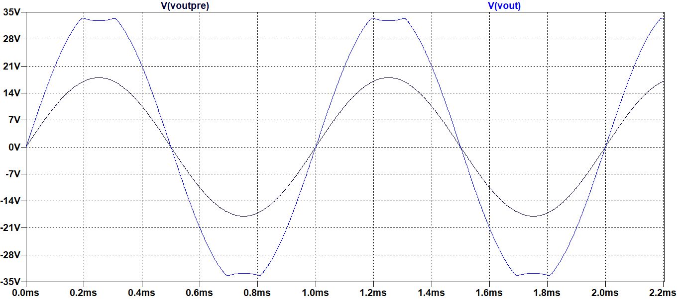

It has been a while since I've looked at an old-fashioned live scope feed of an audio signal. What many people don't seem to realise is that because the scale is linear, all you see are the peaks, and maybe the top 40dB of dynamic range. Unless it's a cheap gadget that skips frames and doesn't have any phosphor-like persistence built into the display, your eyes should not "miss" any mysterious peaks that go far above the obvious level that you can see.
For my needs, I suspect that ±2-3V should be plenty, and above that is all "overhead" and clipping. Probably more than anything, there's a kind-of internal battle, where part of me wants rolling bass, but even with something demanding like instrumental metal, most of the information is in the details between any percussive hits.

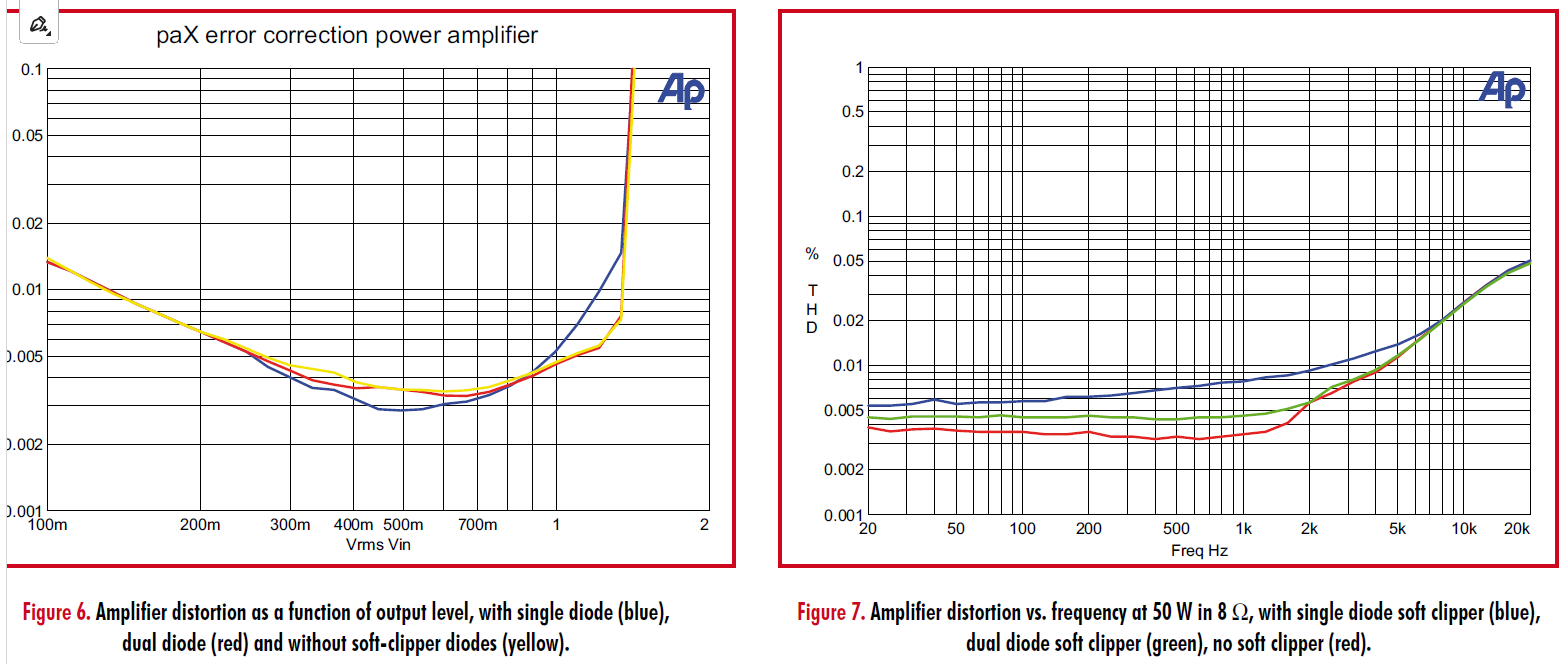

Zeners clip softer than diodes used the ordinary way. They can go under 2V, but I believe you need a regular diode in series to block any forward bias. The forward drop of that diode adds to the voltage the zener will clip at.Are there any characteristics in particular that make them more/less suitable?
Check out Bob Cordell's Klever Klipper, it may just be the ticket for you.
Scroll about halfway down here: https://neurochrome.com/pages/super-gainclone-with-klever-klipper , including before-and-after distortion graphs.
It is also fully described in Bob's book.

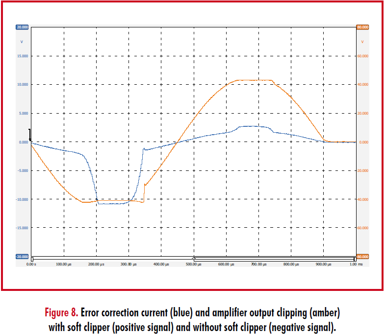

Check out Bob Cordell's Klever Klipper, it may just be the ticket for you . . . . It is also fully described in Bob's book.
Post #6 of this thread suggests Bob's Klever Klipper and shows scope photos of its operation

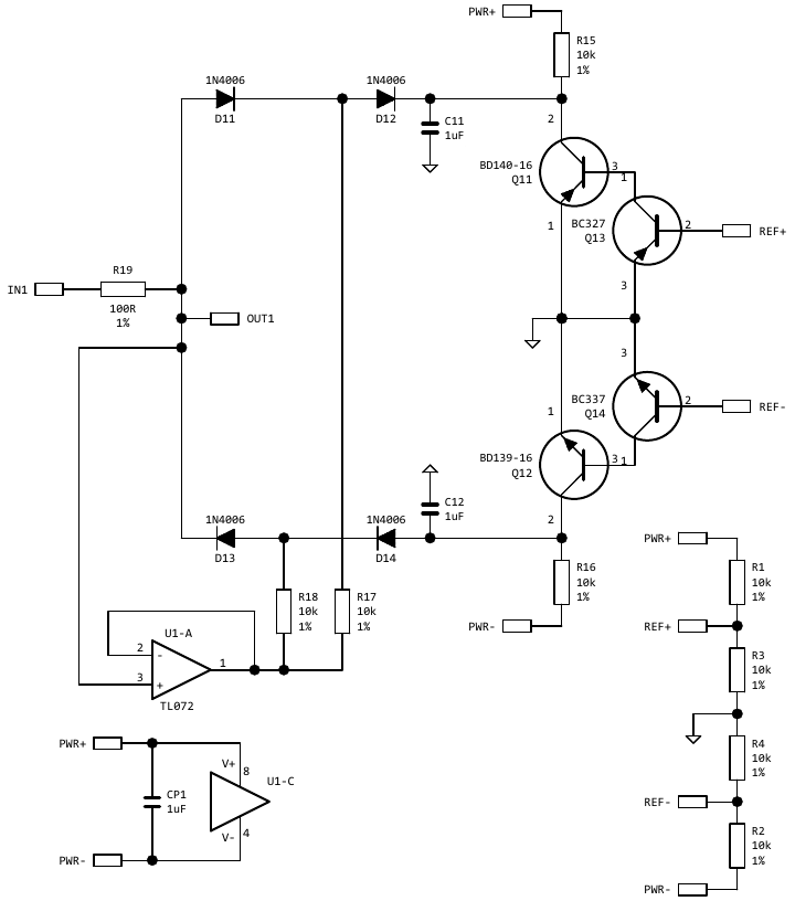

I developed a new over-voltage protection / clipper circuit that I find quite genius:
Distortion is very low because the diodes D11 and D13 have zero voltage across during normal operation because op-amp U1 mirrors the signal voltage and feeds the other side of the diodes with a copy of the signal.
This also means that the diode characteristic does not matter much (capacitance, leakage,...). High power diodes can be used without degrading the signal.
Only once the threshold is exceeded, there is voltage across the diodes.
U1 must not load the signal, else this would cause distortion. A cheap op-amp with (J)FEt input will do.
Once the threshold is exceeded, the clipping current goes through diodes D11 and D12 / D13 and D14.
Threshold is set by resistors R1 to R4.
During clipping, high frequency AC and spikes mainly go through C11 and C12 then, while low frequency / DC is handled by the transistors.
R19 may fuse during gross overload, or may be increased so that current is low enough that the resistor does not fuse.
A low value of R19 allows low noise though.
This circuit is well capable of sub-ppm distortion and can clamp currents up to 1A roughly (depends on threshold).
How do you like my circuit?

Yes, sup-PPM only below clipping.
It is not easy to design a circuit that is low distortion and clips well.

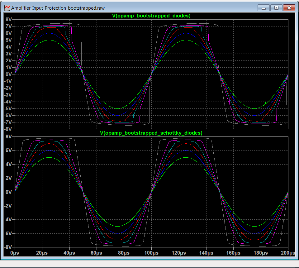

Here some simulations results:
Supply voltage = +/-10V
OP-amp: ADTL082 (LTSpice)
Diodes: 1N4007 (LTSpice) and the Schottky UPSC600 (LTSpice)
Else, as shown on schematic.

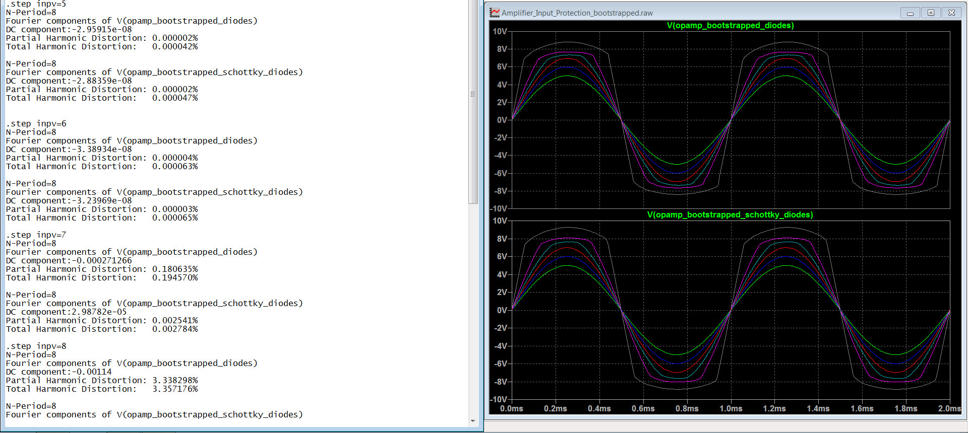

Voltage stepped 5, 6, 7, 8, 10 and 20Vp.

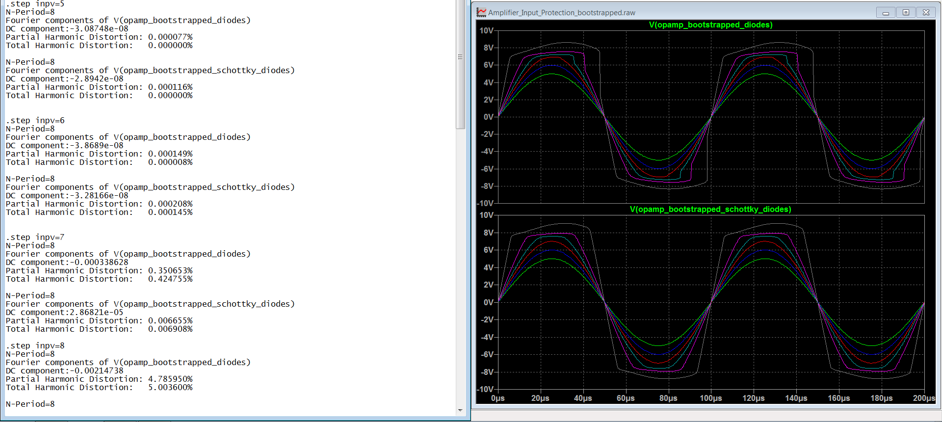

At 1kHz:
At 10kHz:
Conclusion:
At 1kHz everything is well under control with ridiculously low distortion and nice clipping.
At 10kHz, diode recovery makes a difference. Recovery can be quite ugly with the 1N4007 model, but looks nice with the fancy SiC Schottky model.
It appears as if the circuit does not behave well with voltages far beyond the power supply range (20V in this case).
With only 100R for R19, the resistor would be smoke within milli seconds though.
A higher resistance value for R19 (like 1k) would be advisable, is more common and yields better clipping, but not better recovery:

That's an understatement ;-)It is not easy to design a circuit that is low distortion and clips well.
The choice for diodes is indeed critical. You can minimize the recovery by minimizing the current through the diodes.
R19 can be higher for better results, 100R is quite low and as you mention, 1k should work better overall with no adverse effects on the signal before clipping.
Looking forward to your build.

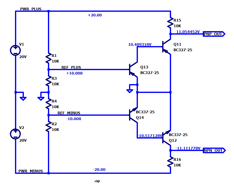

It appears to me that in the circuit of post #150, transistors Q13 and Q14 operate in the reverse active mode.
- NPN Q14 has (VBE = -10V) and (VCE = -10.5V)
- PNP Q13 has (VBE = +10V) and (VCE = +10.5V)
Like a "gain / offset" to land in the part of the curve you want. I recall reverse bias junctions ala Zener are sometimes used as noise sources. Is forward bias, as in normal diode function, inherently less noisy? Is the noise level of the Zener even something to worry about, relative to the clipping signal level?Any diode or zener can be made to show the clipping behaviour you want. It all depends on what part of their characteristic curve you put them on, by selecting the current you drive through them and the series impedance you use.

Don't some people label the anode side as positive, essentially making the schematic look upsidedown to Western eyes?It appears to me that in the circuit of post #150, transistors Q13 and Q14 operate in the reverse active mode.
This is a bit unusual for audio circuits, and I worry that transistor behavior in this mode is likely to have a much greater variance, both from unit to unit, and from low temperature to high temperature. Simulation DC bias result shown below.
The reverse BE bias avalanche voltage of silicon transistors is about 6V so that will be the clipping voltage. Note that LTC spice does not support the reverse BE junction behavior unless you add the parameter to the transistor model. I discovered this some time ago. It is not normally included in BJT models because using transistors this way is not common.

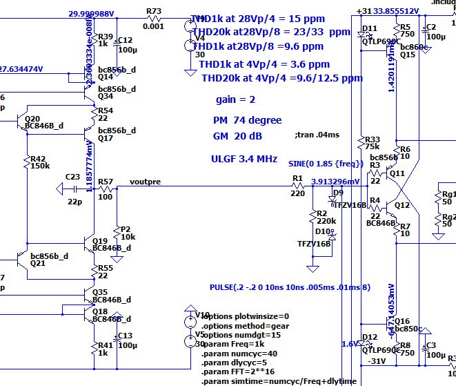

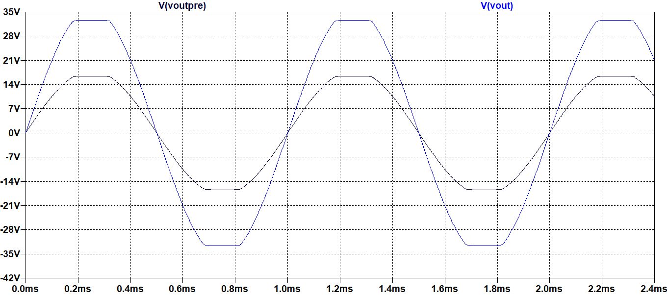

Simple soft clipping circuit. Preamp output should be high impedance.
D9 and D10 connected to bi activated.
OPS never go to clipping.
