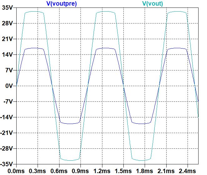

This amp has two parts (it is integrated type), preamp with no GNFB and OPS with GNFB and gain of two. The volume control is after preamp part.
This anti saturation circuit is to prevent OPS to saturate. The distortion is quite low and start to increase wen zeners start to conduct of course.
Why is important how distortion changes when anti saturation circuit (I would not call it compressor) become active?

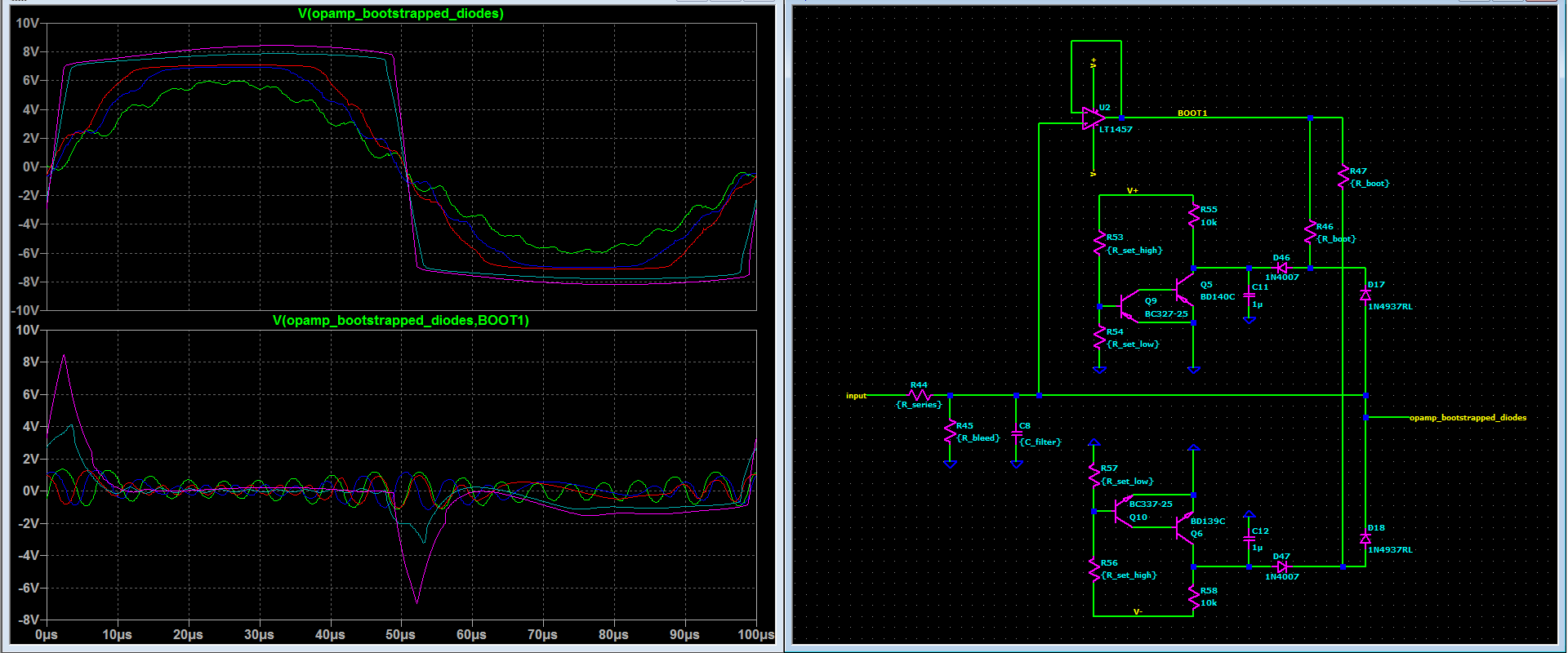

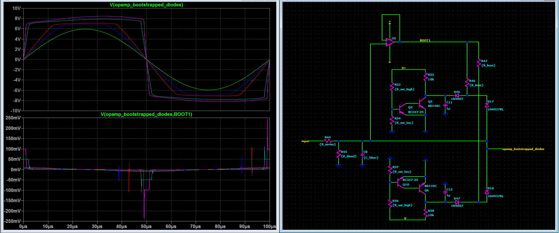

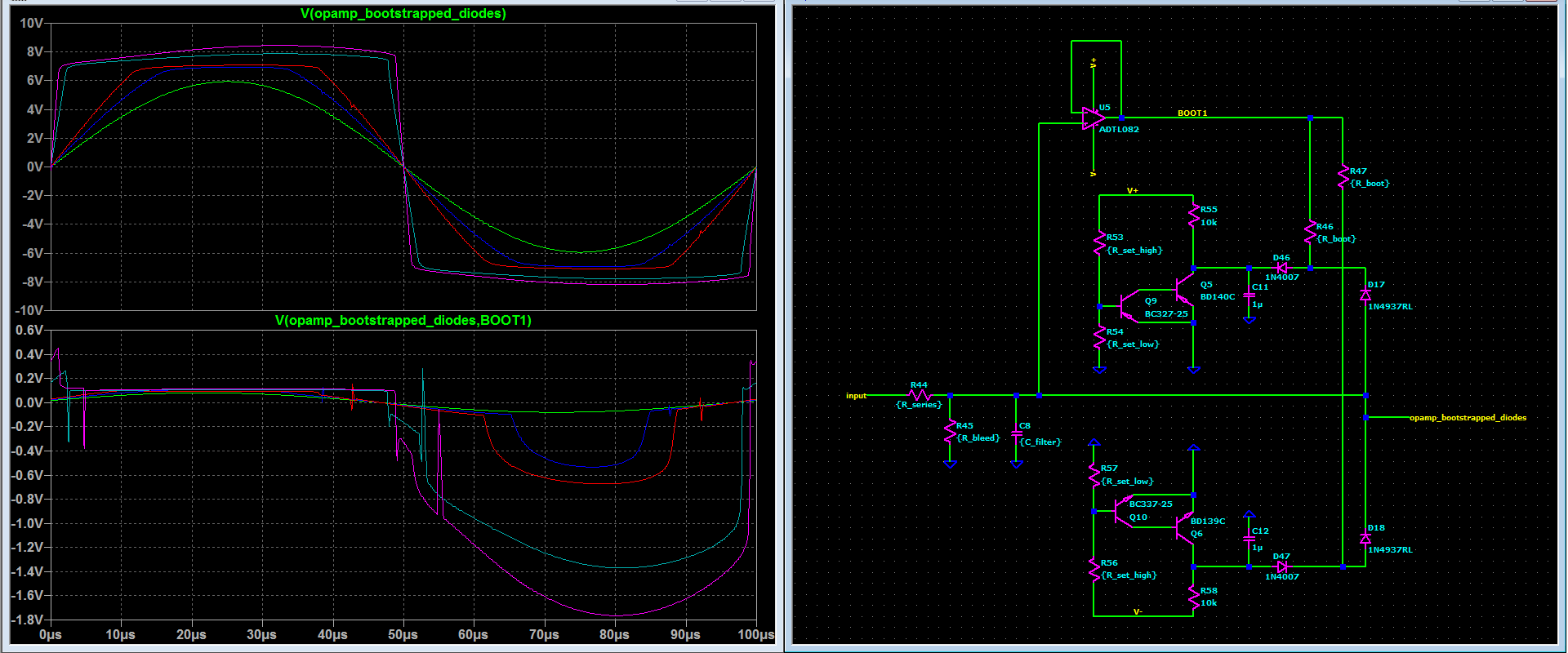

I've come up with an unusual amplifier topology involving boostrapped stuff, and that seems to have, shall we say... non-optimal clipping behavior. So it looks like I'm going to need a pre-clipping circuit.
Of course it should not distort at all until it does.

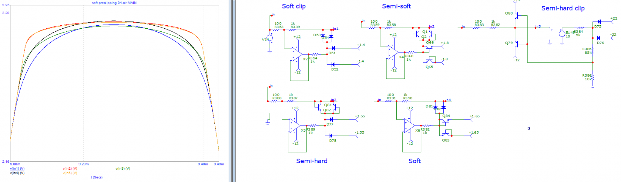

I've sketched a number of attempts, all involving bootstrapping the clipper diodes to reduce distortion by keeping voltage across them constant, which avoids nonlinear capacitance effects, leakage, etc. The bootstrap voltage is itself clipped by another pair of diodes, so when it reaches the limit, the other side of the diodes no longer follows the input signal and they begin doing their job.
The four ones on the left use diodes or transistors as diodes. They're strictly at the input of the amp, so they need an opamp buffer for the bootstrap voltage. The one on the right deletes the opamp by using the amp's output voltage (the power amp is VCVS E1) and using BJT emitter followers as diodes. Basically the two transistors' bases follow the input signal so they do nothing, until the diodes on the right conduct, at which point the transistors limit the input signal.

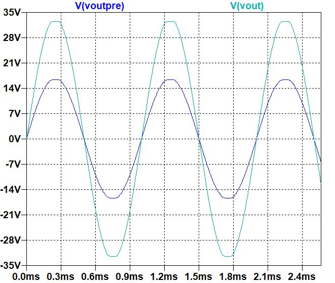

On the left is a sinewave with a smashed top.

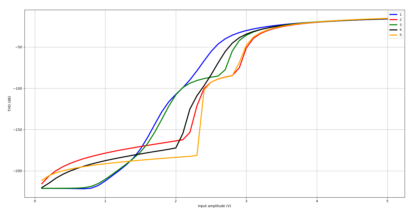

And here is THD vs input level. Simulations are sometimes slightly optimistic, but it looks like "no distortion before it has to begin clipping" is achievable.
Thoughts?

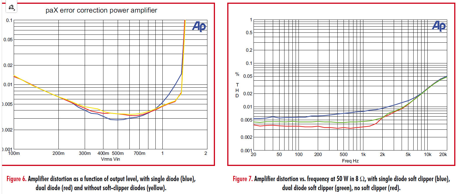

I made this softclipper with simple LED's:
https://www.diyaudio.com/community/...-8-ohm-how-to-limit-power.421941/post-7890159
https://www.diyaudio.com/community/...-8-ohm-how-to-limit-power.421941/post-7890258
Its TDH < 100dB upto -9dB with softly increasing distortion above that, very happy with the solution and you can see when it triggers 🙂
You would want to know how rapid the distortion rises at the onset of overload. How much better is it than just clipping?

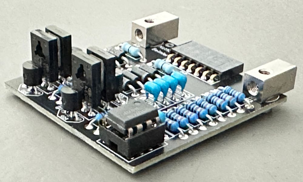

Hi Jan,
I built it and this is how it looks like:
The module has two channels.
I also measured it with the threshold set very low ahead of a balanced input, which has a connector mating with this module.
I swapped the module with jumpers back and forth.

Every chart tells a different story and it useful on its own.
The waveform is useful to see whether the clipping is clean, or shows some ugly overhang / sticking (see my contribution with diode recovery issues).
The FFT tells a bit about the harmonics - more even or more odd ones. Higher odd ones would mean that clipping is symmetric, preferable IMO.
The level vs. THD chart tells about how abrupt or gradual it goes into clipping with increasing signal level, i.e. how much clean headroom there is prior to gradual or sudden THD increase.
What does the topic "distortion free soft clipping circuit" mean at all?
Distortion free probably means that THD should be very low below the clipping threshold. Not so easy as you pointed out.
Soft could mean that transition into clipping should be gradual instead of abrupt? Or that clipping is not ugly (time domain)?
THD vs. level is easy to measure using REW for example - do a sweep or even better stepped level increments for more accuracy.
In simulation, at least in LT Spice, it is among the advanced simulations IMO. Level would need to be stepped and the results plotted somehow. Takes a long time and needs knowledge how to do it properly. I haven't done this yet because I don't know how to do it. I've seen it somewhere, but remember it is not trivial.

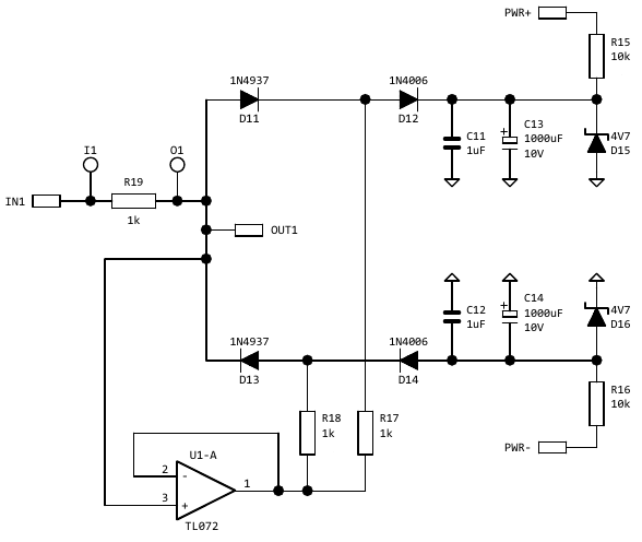

I like to present a slightly different variant of the circuit I recently posted:
The idea is to simplify the circuit by replacing the transistors with Zener diodes as mentioned previously.
The Zener diodes have massive capacitors in parallel and those capacitors allow to sink AC currents far in excess of what the 500mW Zeners could handle.
The 1uF capacitors share the footprint with the 1000uF capacitors, hence cannot be installed simultaneously.
Unlike the previous circuit, this does not work for DC obviously, hence this circuit would be best placed after the DC coupling capacitors.
In theory, this circuit also works very well.

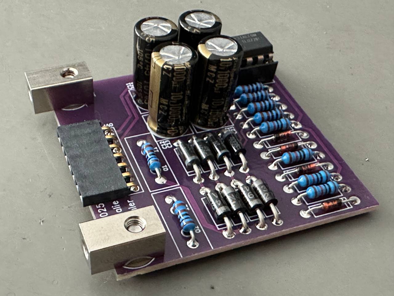

The PCB looks very similar:
@jan.didden, you are right that theory and practice deviate a lot.
In theory, the voltage across the op-amp inputs should be close to zero, in practice this is not the case at all.
Here is a simulation of the circuit using the near perfect LT Spice universal OP-amp type 1:
The amplifier is able to follow the signal well, except during transients.
Now with the ADTL082 model:
This amplifier architecture limits swing towards the negative power supply rail and while the clipping still looks right, the amplifier loses control entirely.
This limits the headroom of the circuit because there should be more margin towards the rails.
I simulated the circuit with many apparently suitable (J)FET amplifiers from the LT Spice library and the result was disastrous in most cases.
This is only one example:
The amplifier not only glitches during transients, there is also severe oscillation all the time.
If I hadn't started simulation with the ADTL082 model, I might have (wrongfully) dismissed the concept because it fails with 11 amplifiers I tried.
In my mind, the concept should work.
There is an inherent risk of a positive feedback loop and this is very obvious:
There is only a resistor and diode between the output and the non-inverting input of the amplifier.
Anything that may sneak through the diodes may turn this into an oscillator.
