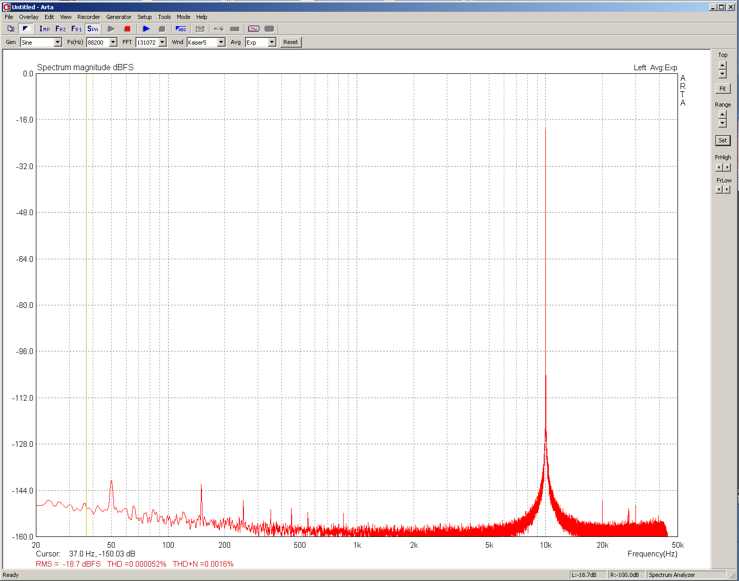

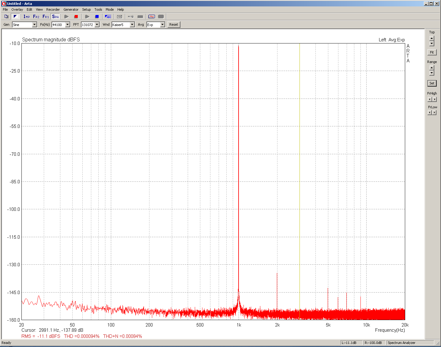

In the same time, I think STEPS is beautiful, but if someone wishes to squeeze the last bit out of the hardware/software, the arta spectra analysis is better..
The first shot is a spectra with the settings of 44k sampling, 997Hz, -11dB gen level, +4dB analog setting, with maxed out spectrum parameters
Then there is the fact that still the full system is limited by the Dac output.
The second shot is showing a 10kHz Victor's osc response.

The DAC limits the 1616M. The AK5394A is still the lowest distortion ADC made. The 1616M implementation is very good. Opamp upgrades will help a lot. The oscillators look like they can be swapped directly for the Crystek's.

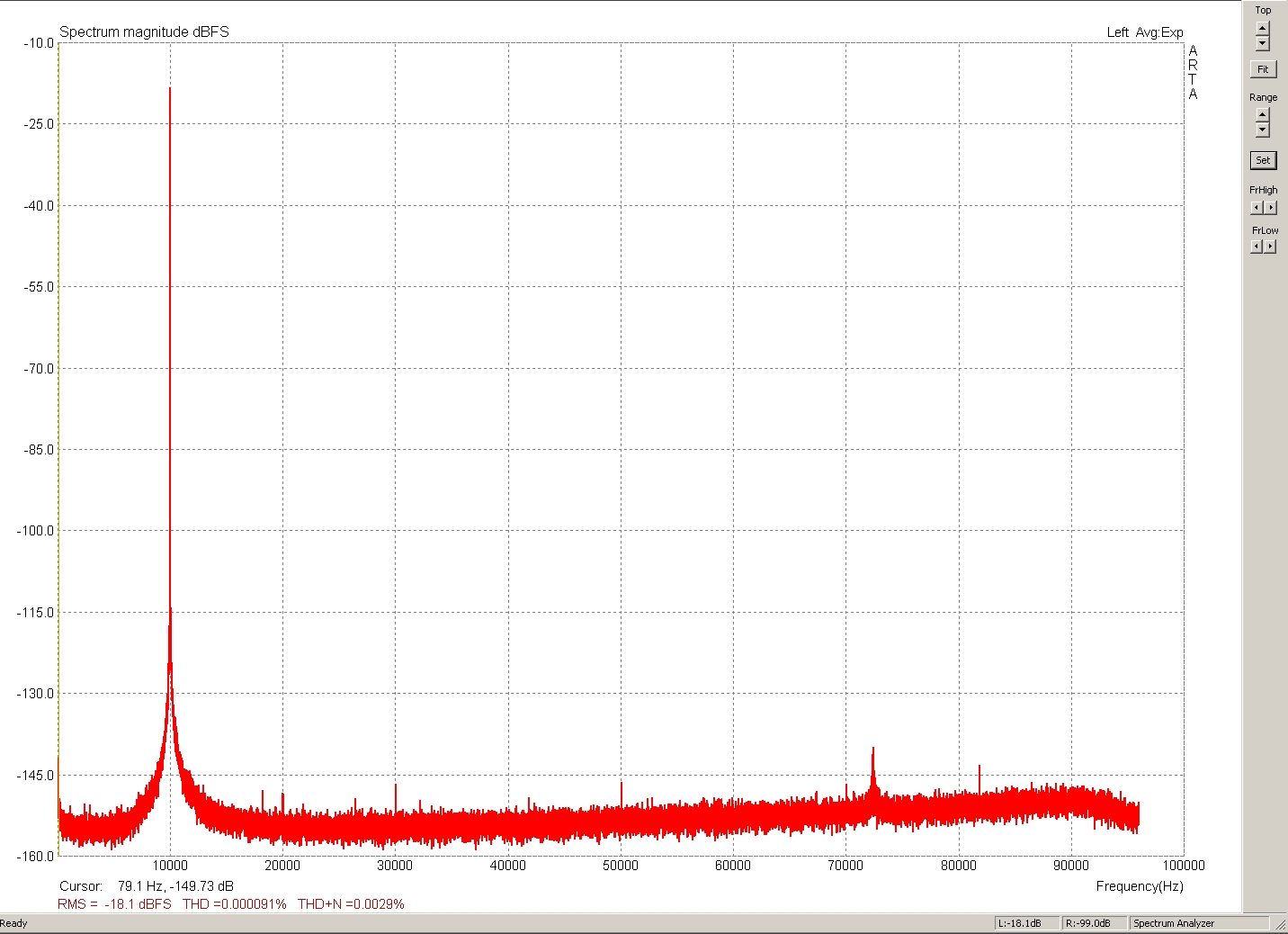

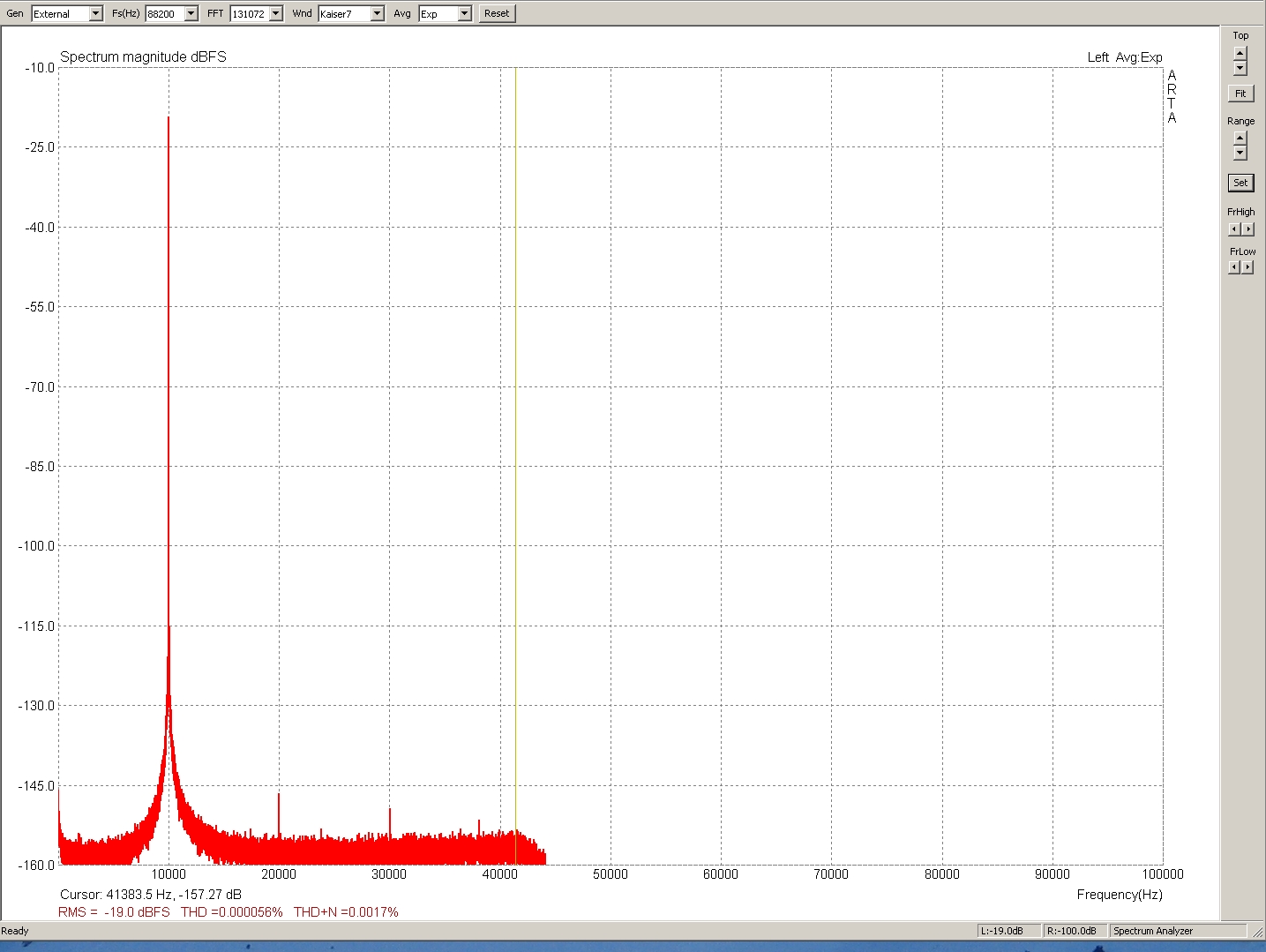

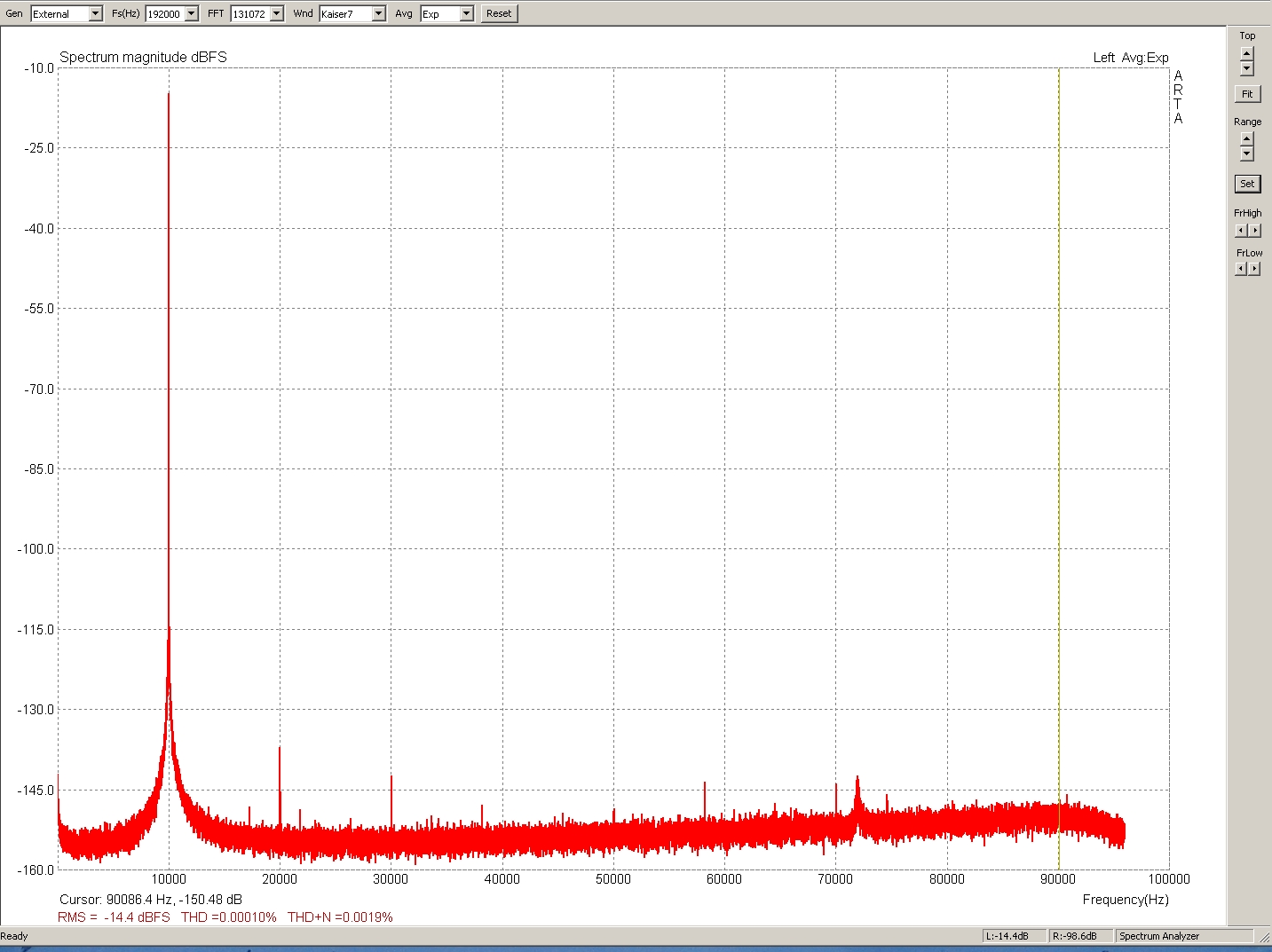

Here it is the 192k spectra. But first, for comparison and better view i had repeated the 88k shot, with linear scale. Then the 192k, with the same level setting. Lastly, 192k at a higher level, which shows better where the adc distortions are coming in.
It is not that clean any more! That ~75khz junk is the dxternal 48Vdc, switching power supply for the docking station. It is picked up externally, by just connecting the oscillator. The internal topology is full balanced, and do not see this common mode junk. But victors oscillator is single ended, and i had to upset the simmetry at the input connector..
one way to avoid it could be an external, screened single to balanced converter --or a linear power supply..
