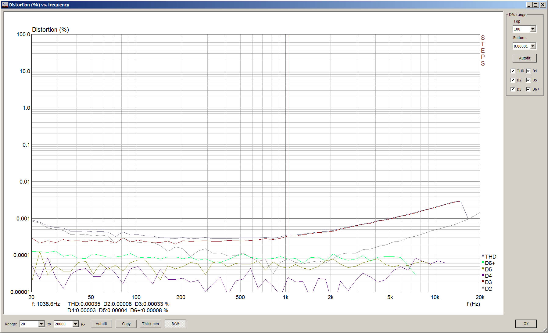

As far as I can tell, the EMU0404 remains king of the hill:
With a low distortion 1kHz sine generator, distortion gets down to .00014%.

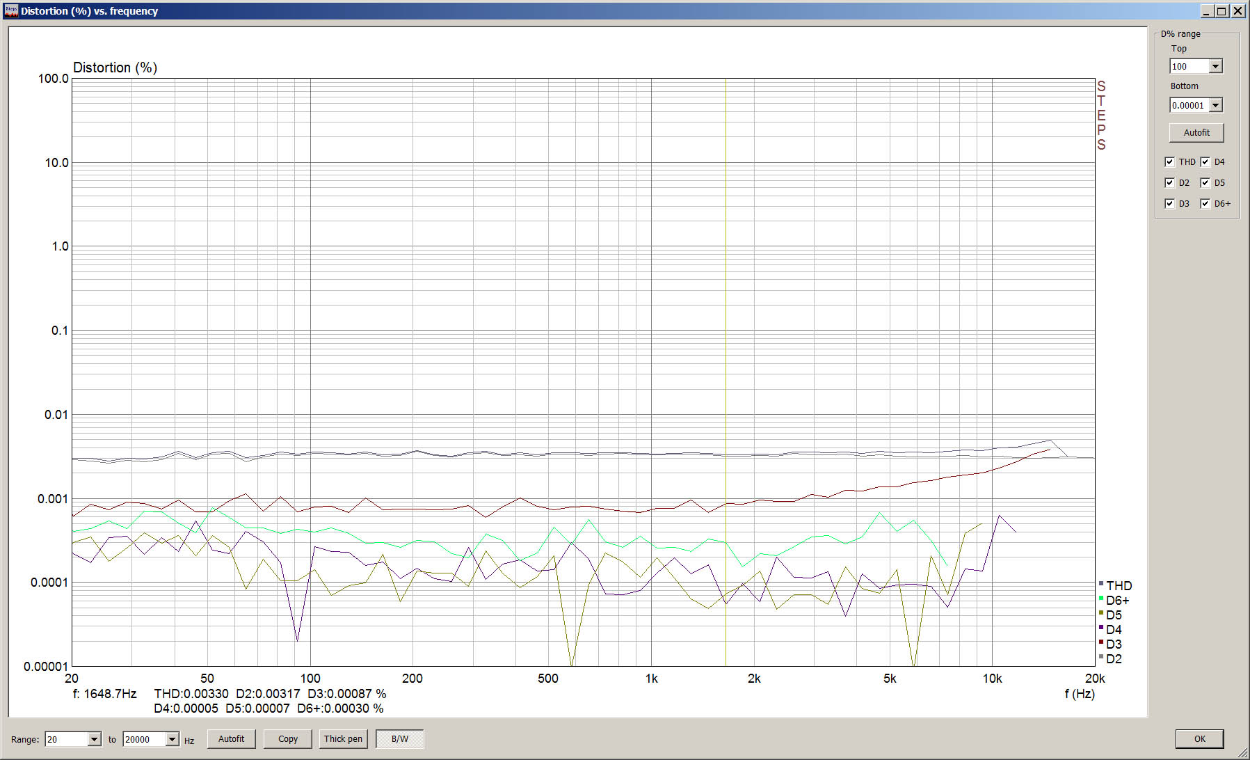

I also have a Fuckusrite 2i4, which does something like this:
Perhaps the 2i2 is better, but for me this was quite a disappointment, because it was produced after the EMU0404.
