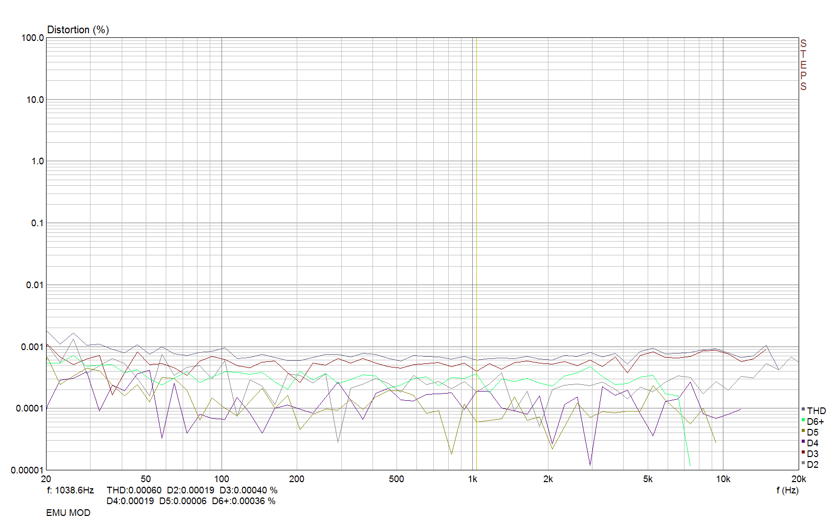

I read somewhere on this forum that the EMU 0404 can't be improved by putting in better opamps and that by trying to do so you would kill the machine. So I decided to look for an opamp that might be able to work. Most likely reason earlier attempts failed, I thought, was that better opamps usually take more quiescent current, and the EMU 0404 has more than a dozen of them.
So I started looking around for a SOIC chip that might work, and found one. TI introduced not too long ago an interesting opamp which comes close in performance to the LM4562 at less than half of its energy consumption, the OPA1652. It is a JFET input opamp with only 4.5 nV/sqrt(Hz) voltage noise. On top of everything else it is pretty cheap as well.
The end result did not disappoint:

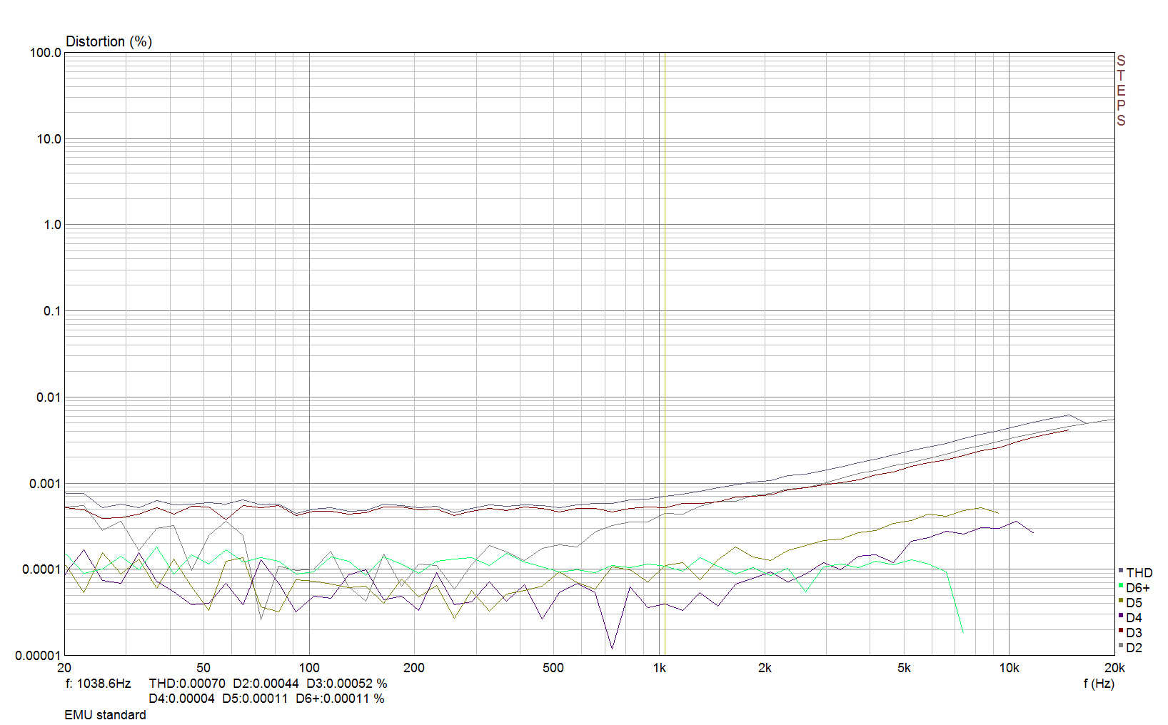

As compared to the unmodded version:
The distortion is still about double that of the Lynx, but the upward sloping distortion is completely gone.
Now, for its intended use, playing and recording music, this difference is most likely completely insignificant. Mooly started an interested thread recently http://www.diyaudio.com/forums/ever...-trying-understand-what-we-think-we-hear.html where you can find out for yourself.
But for measurements, and that is where I use it for, I am quite happy with the reduction.

There is a potential problem with the left channel because a trace runs close to a buck converter iirc, but I didn't change that. It may show op as a series of spuriae at higher frequencies.
I did change the opamps in the output, and the left input channel because that was easier to access, eight in all. I used the 1652, but in hindsight it might have been better to go for the BJT input 1662. The 1652 has pretty bad 1/f noise, with a corner @ 1kHz, and I think it shows up in the measurements. I might try the 1662 on another 0404 I have.
To get the old chips off (JRC 5532 and 2068), I found it necessary to first cut the legs off and then desolder the feet. I tried to lift off the first chip in one piece and this pulled a trace off, which I could fortunately repair.

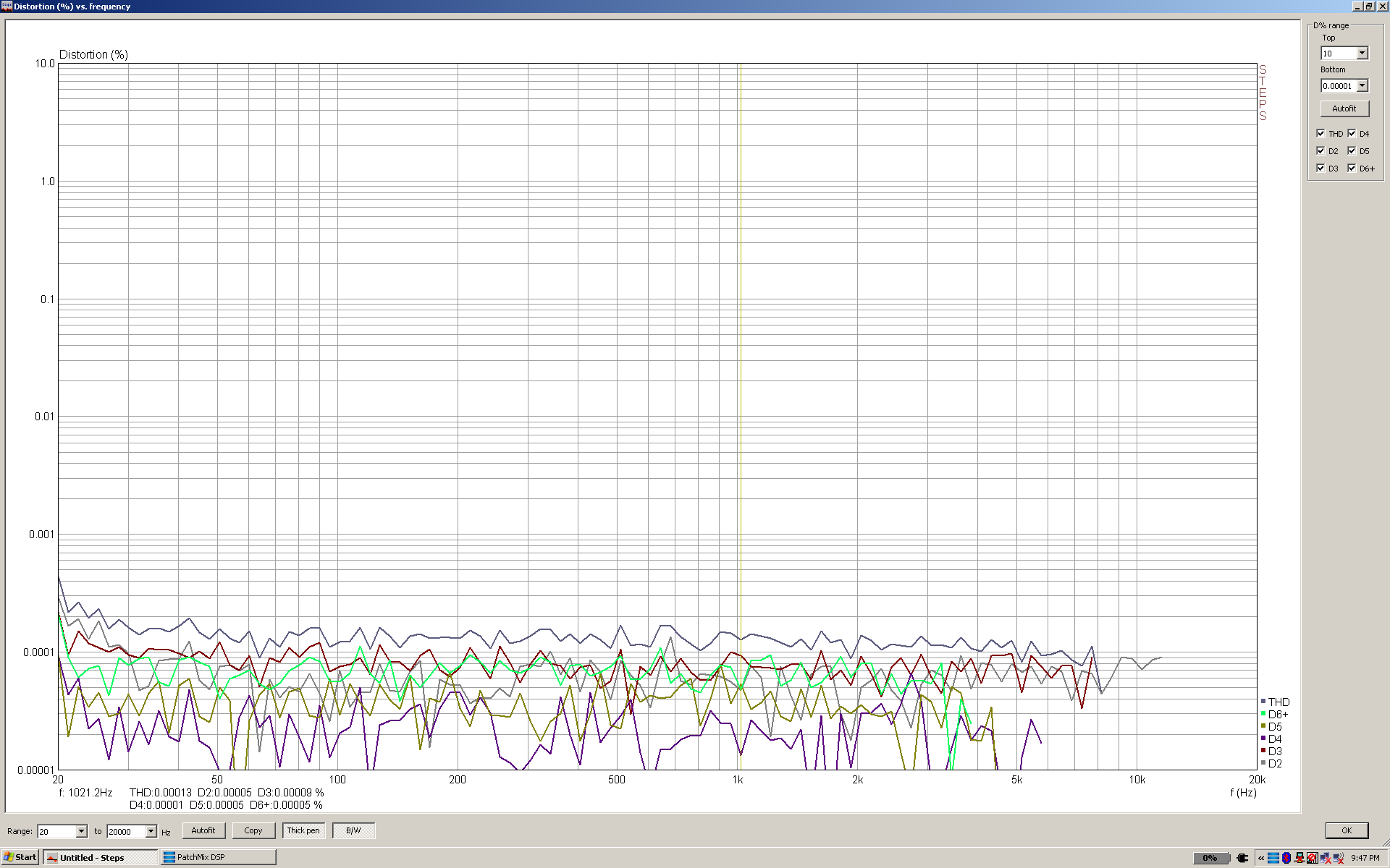

I would like to join the contest..
Mainly because I think the 1616m was a bit 'under-presented' in some of the posts here.

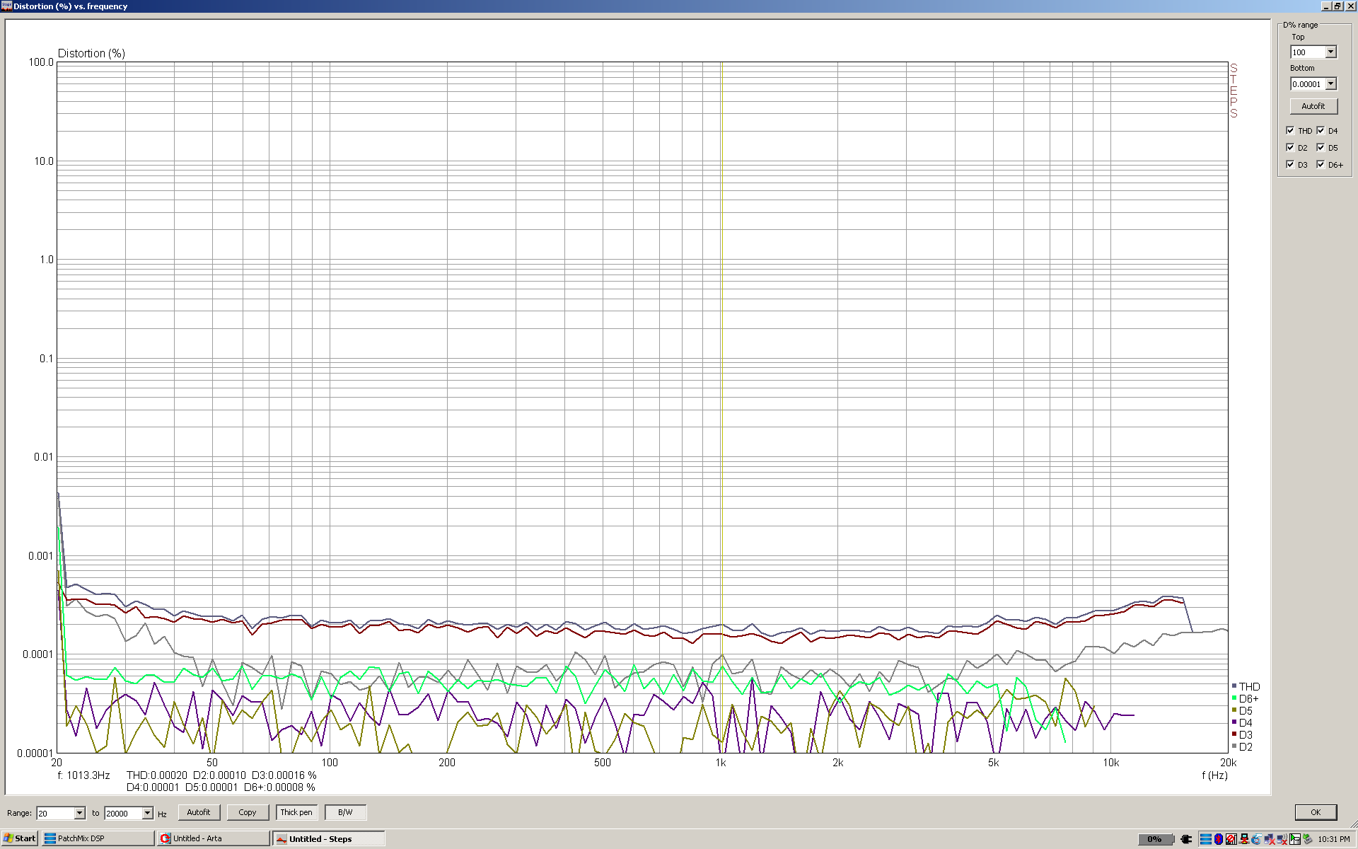

Here are some shots from my card: 96kHz, 24bit, +4dB analog setting, -6db Fs STEPS generator setting
The second shot is the same, except the card is used more close to it's sweet point, at -9db FS generator level setting.

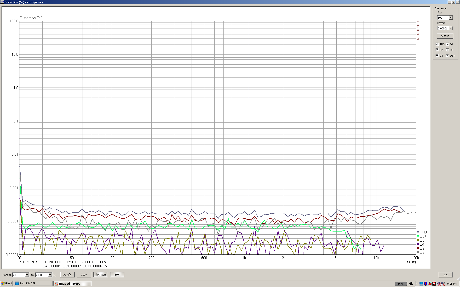

I have modded it, with a full set of OPA1612 (8 pieces!) for one dac/adc channel. Also some other mods, like the output muting transistors eliminated.
At lower sampling rates distortion gets even lower, as visible in the last shot, made at 48KHz.
