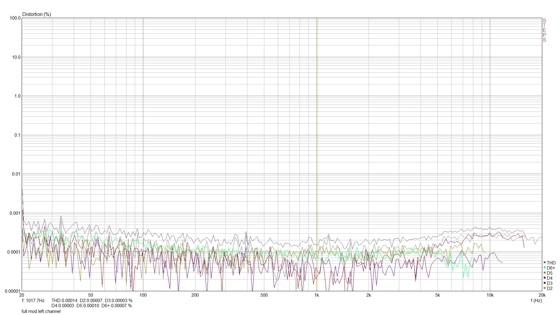

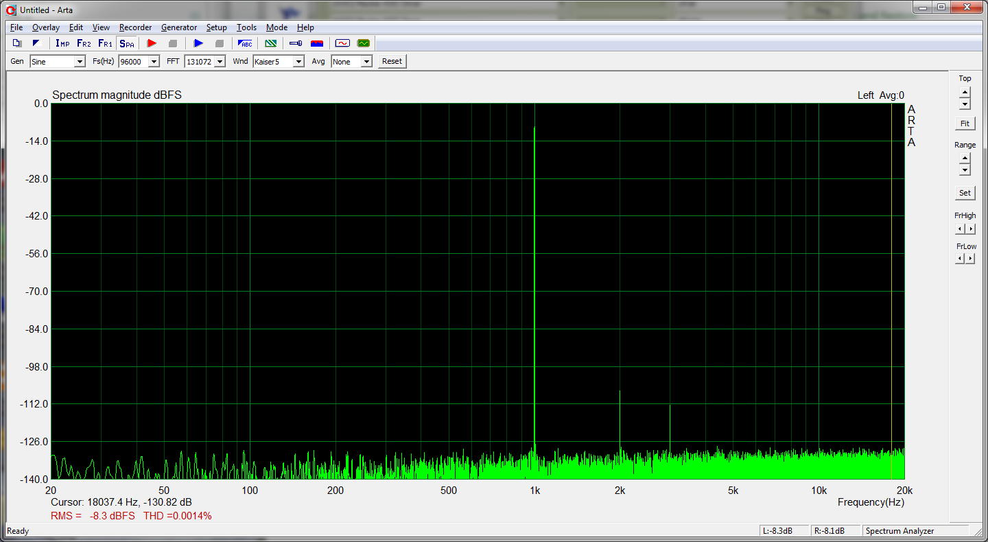

After a full mod this is my latest measurement:
It seems to beat the Lynx. That card has more consistent readings overall, albeit at a slightly higher level of distortion.

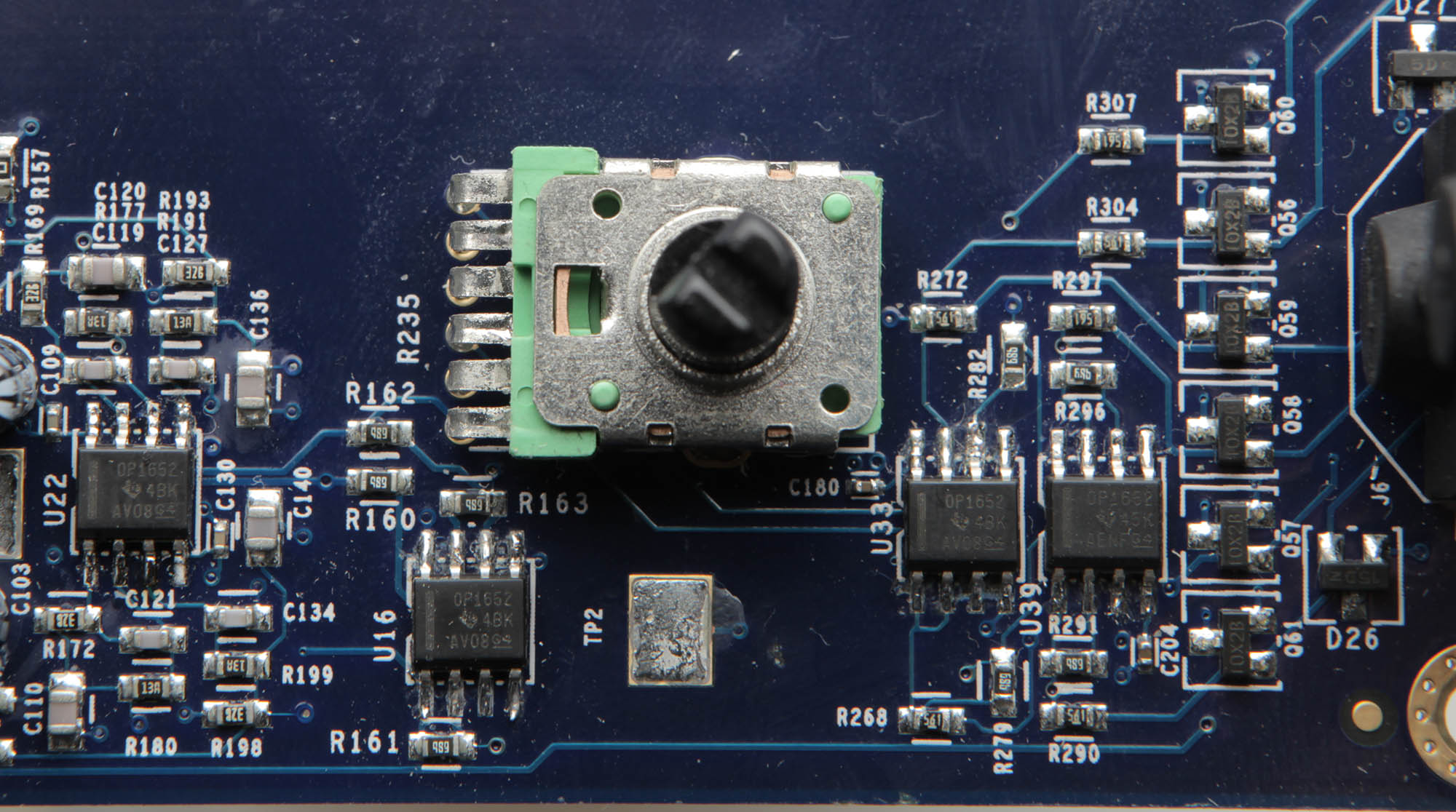

The modifications consist of:
- changing the input and output opamps to OPA1652
- disconnecting the soft limiting circuit
- removing R89 and R90, removing C40 so that this mystifying part of the circuit is out of the loop.
I also tried moving input caps c12 and c17, which did not make any difference at all, so I put them back in. This also goes to show that AC coupling through a large electrolytic isn't something to worry about.
Edit: one thing I found which may be usefull to other EMU owners is that at full scale output -0dB Fs- the generator produces much more distortion than at -6dB. All measurements are therefore made with the latter output setting.

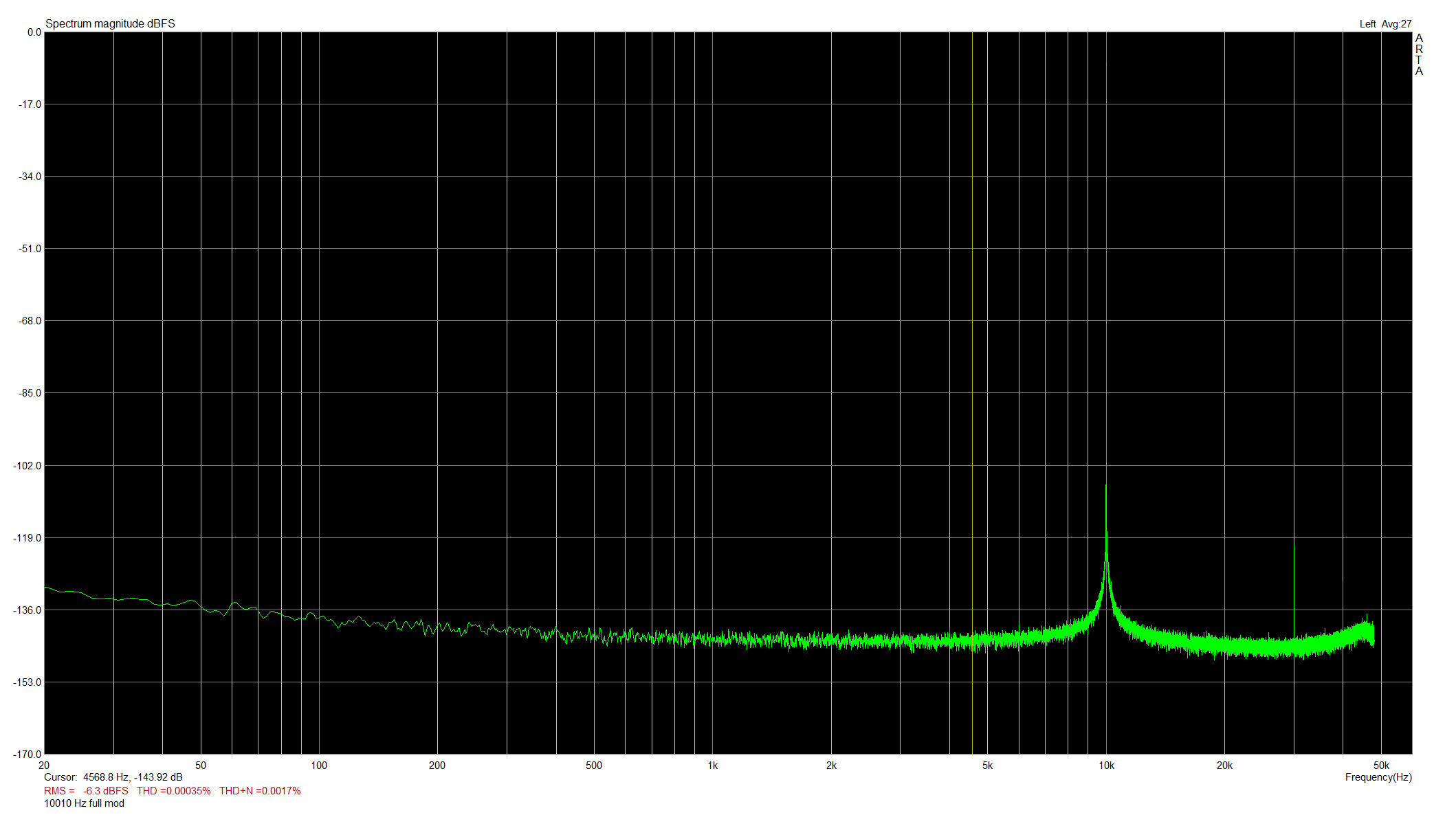

Hi Vacuphile,
Great performance! Can you also show 10kHz FFT?

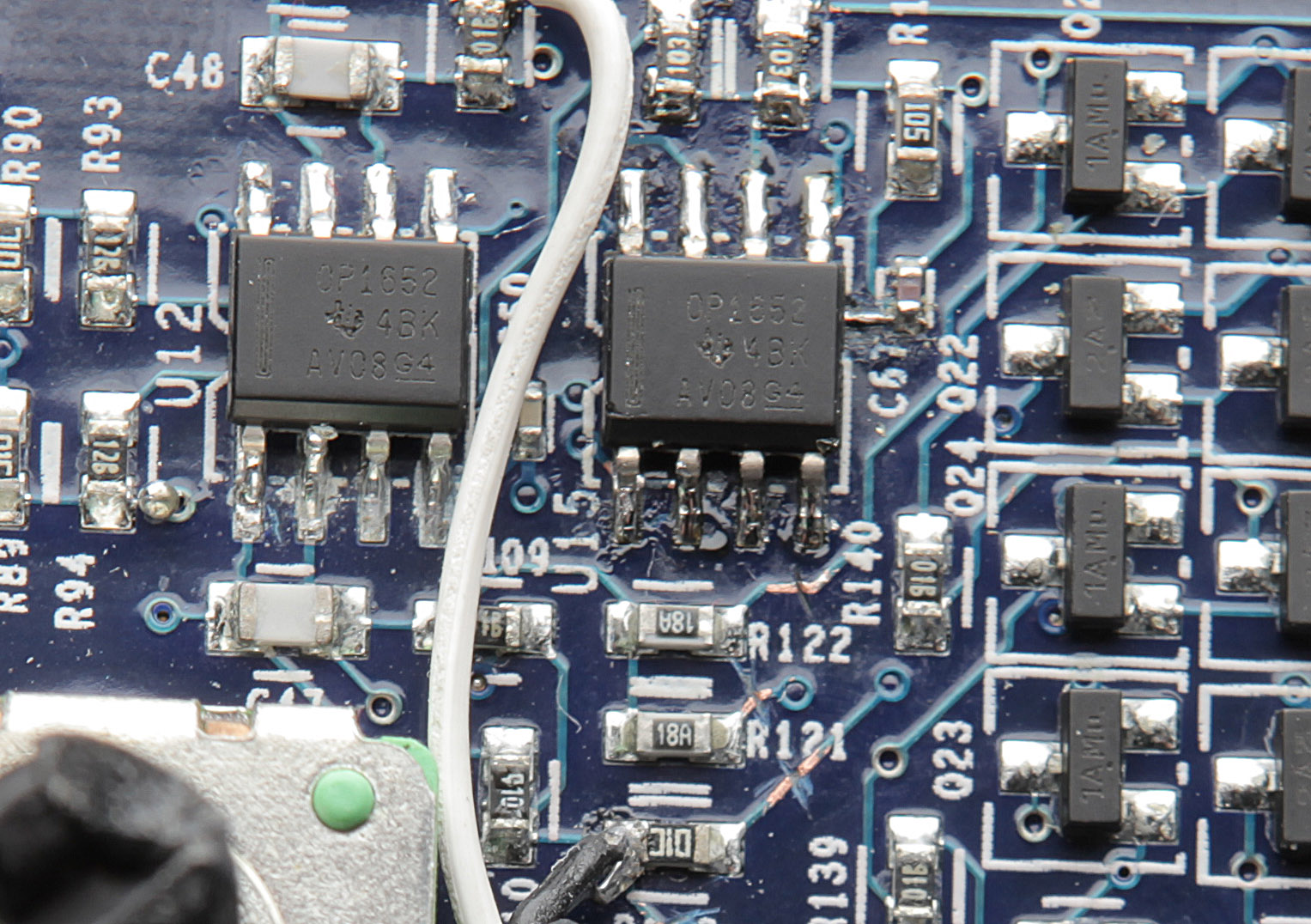

Ok, made some pics.
This one shows the output opamps replaced by OPA1652. Someone suggested OPA1612 might be better and I agree, but at 6 Euro's each they are about 3 times more expensive than the 1652.
What this does is reduce the upward sloping distortion somewhat, but the effect on total distortion is limited.

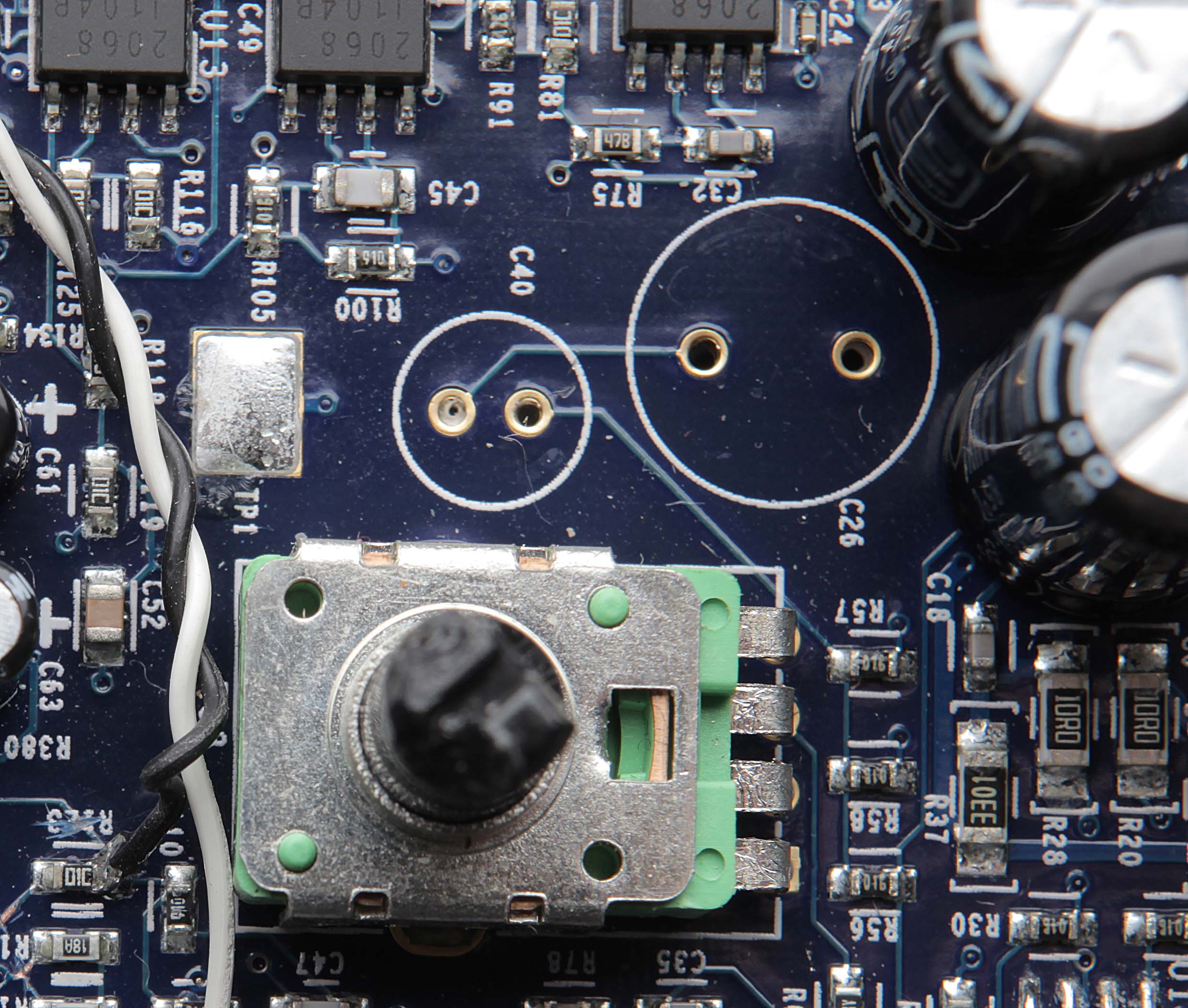

The next pic shows how the soft clipper is cut of from the circuit.
As this is basically a distortion engine for elevated input levels, as may be expected, taking it out of the circuit does lower distortion also at non-clipping levels. Also visible are the OPA1652's, replacing the JRC's. These have a form factor unique to JRC, but SOIC's align without problem.
Finally, capocide on numbers 26 and 40 eradicates the Whitlock style bootstrapping. For short measuring probes I see no advantage in this setup, but I can miss the positive feedback it gives for unbalances inputs like a sore tooth. It also eliminates the double bootstrapping to a node that is buffered from the input by U1 anyways.
Since the loop back distortion of this setup is almost an order of magnitude larger than that of the OPA1652 opamps I used, I don't think much can be gained by replacing them by 1612's or LM4562's, but than again, you just might push distortion even lower by a teeny-weeny bit. The ADC is specced as THD+N=-103dB, but S/N is -114dB. The DAC is -100dB and -120 dB respectively. So, in all likelihood, -114 dB is the absolute minimum distortion that can be achieved. With all these mods, the EMU almost reaches that level at some points.
