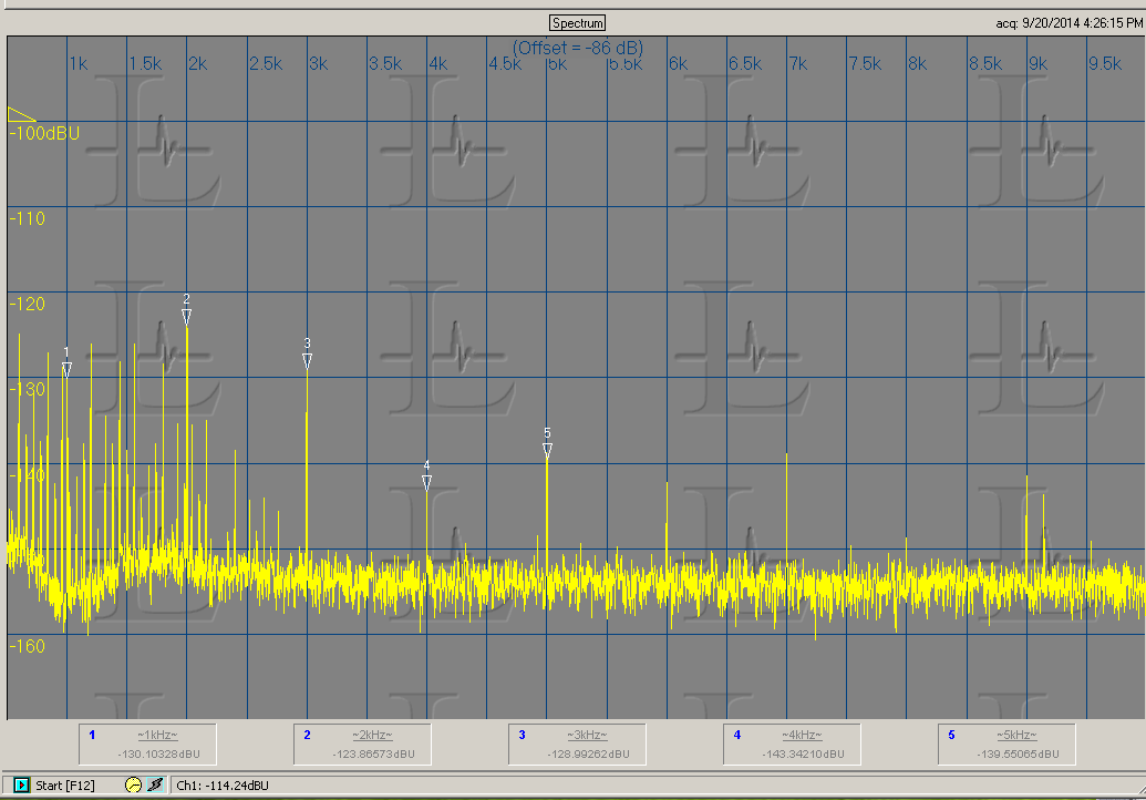

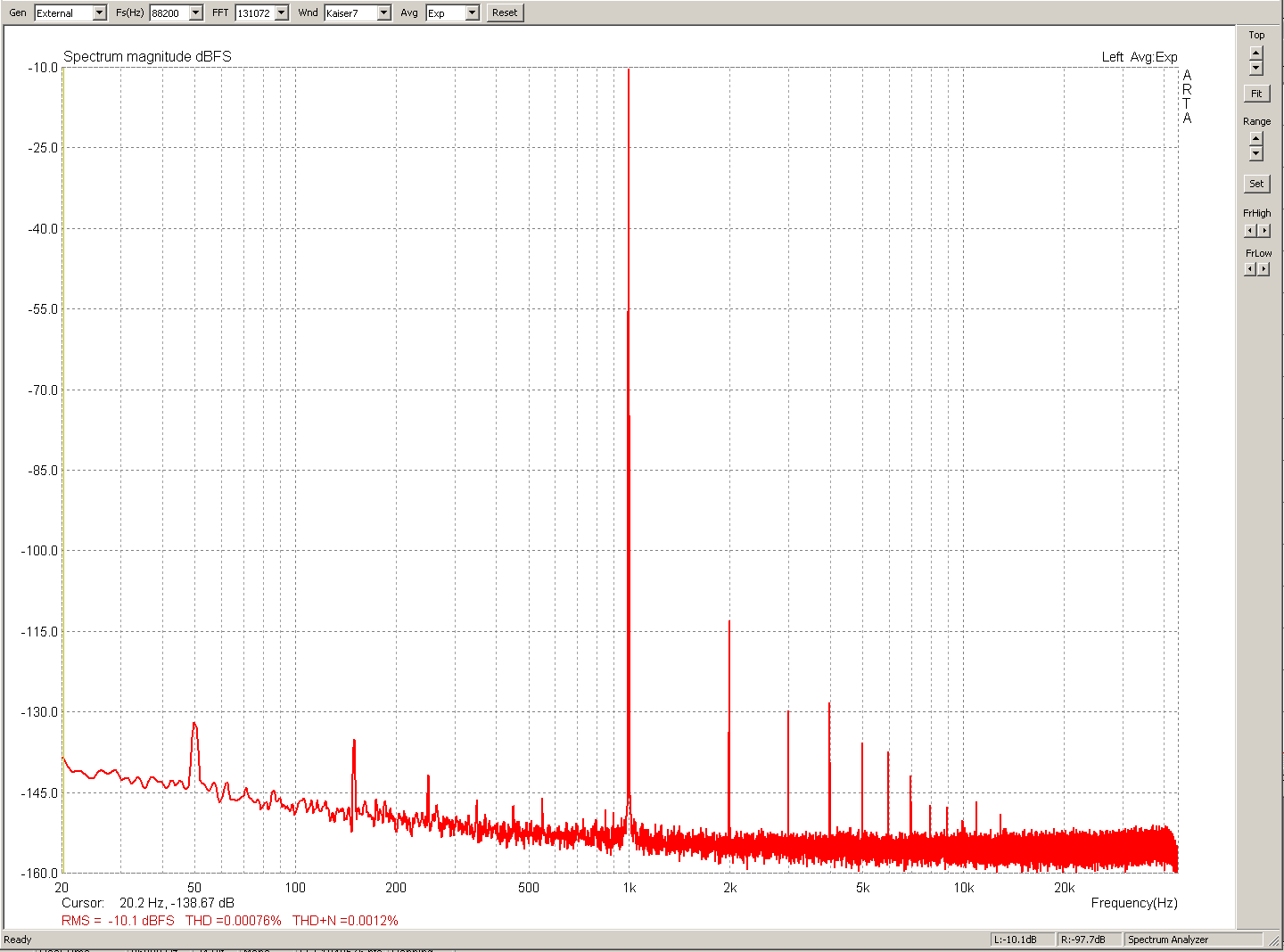

I am also playing with possible use of an external build of the AKM4490.
So far I got this spectra (below).
I would confirm the concern of Arnyk what regards Arta and more independent soundcards. Also I had to use an external driver for the Xmos based Dac.
Which is a pity for Steps, especially.
I noted that for close to max output levels (up to ~-2dB) this AKM dac still measures at around 0.0002 % THD, which is way better than the EMU's own 4398. But at 'sweet spot' both dacs perform almost the same --- uhm, with the 'slight' drawback that the AKM dac applies a balanced-SE conversion (OPA1612) and this SE output is tested here, entering the soundcard unbalanced.
So with proper full balanced signal path... I don't dare to immagine what would happen..
A note about jitter: this dac shows the smallest side skirts that I have seen up to now. It's considerably better than the EMU cards internal dac jitter. Still including the same jittery clock for the ADC.
A note to Arnyk: a very nice result with the chinese dac. Maybe the only visible drawback is the jitter, in your spectra.

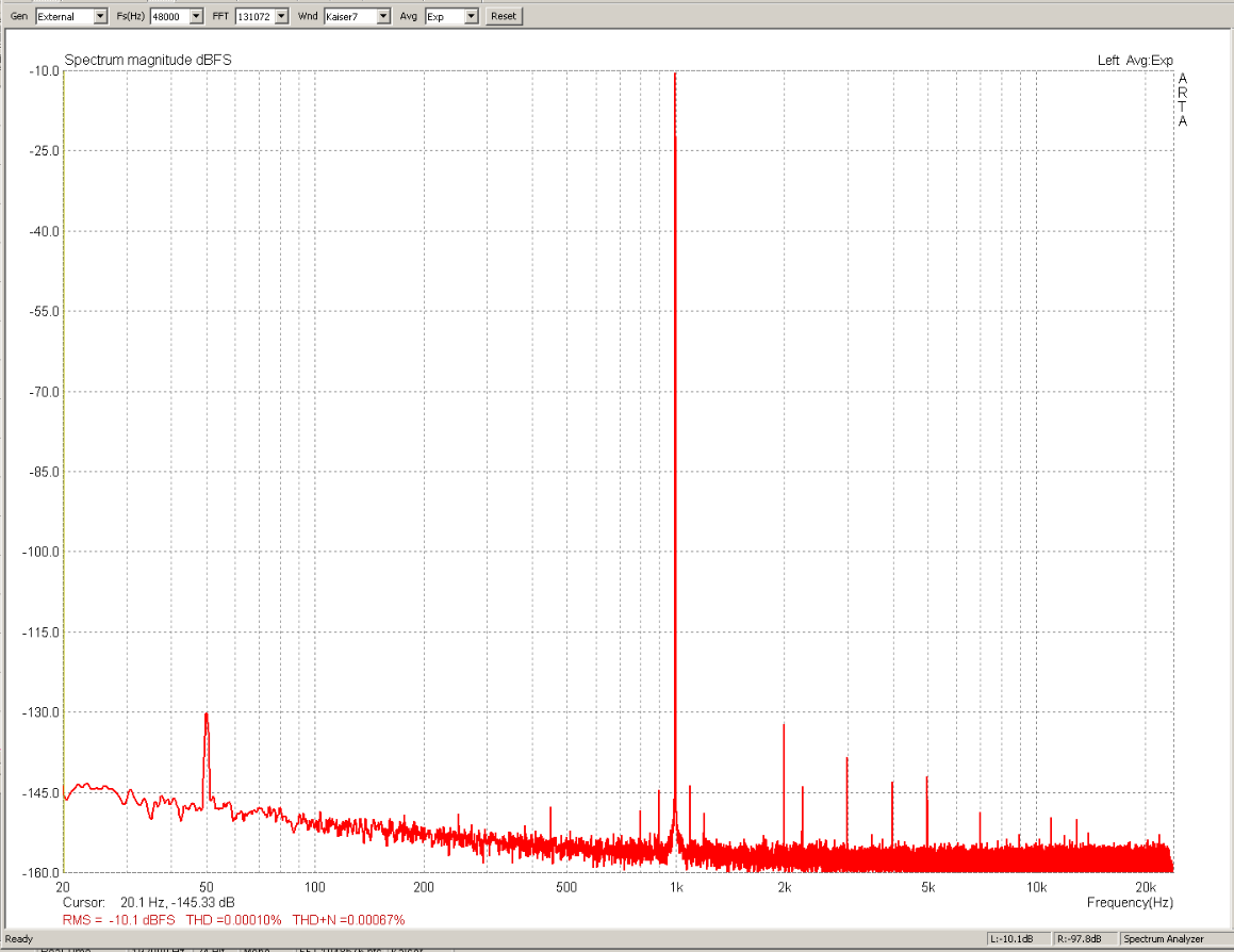

AKM4490 at higher sample rates?
Thanks to Demian, this had to be cleared up. I have done some more test what regards asio or wdm drivers, Arta, loopback and distortion levels.
First of all, I have seen a distortion level rise with sampling rate when testing the XMOS jlsounds+AKM4490 combo into the AK5394A adc of the EMU1616 card. In general it's to be expected, but I feel it's a bit too high, more than what I used to observe with the 4398 in the EMU.
I was wrong ascribing that to the system drivers, it's the hardware itself.
The used drivers do not change that. Arta do not enter here, in fact it works wonderfully as always. When Asio is used, Arta does not permit to use different in/out units but using windows drivers it's possible. Using wdm drivers it's better to be aware of the system internal conversions, in fact 48K multiples work best. But that's enough, the results will not be strongly distorted.
Using Asio drivers the spectrum cleans up a tiny bit better, so I prepared a series of tests using ARTA reading the EMU ADC with ASIO drivers, and the 4490 Dac was driven externally at different sampling rates but always the same generator level, -10dBFs, (~600mV RMS out). The results are in the file

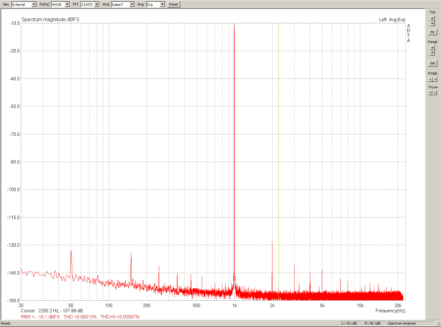

For comparison, I used ARTA in the conventional way, wdm drivers, AKM4490 looped back to ADC input at always the same level -10dbFs at different sample rates. Also this file is attached, AKM4490+EMU1616_wdm.pdf
Also have tried driving the 4490 with an Amanero, same results but worse noise floor. Seems to be inherent the dac board. or the dac itself? Definitely not the analog output drivers, they always see 1kHz carrier.
tried to look up other people's result, but also JensH was showing up to now only the 48K sampling rate.
ArnyK, may I ask you how did you obtain your nice spectra? 96KHz ADC sampling, but the dac was driven at..?
A bit puzzled.. George Edit: flipping thorugh the PDF gives nice prompt comparison

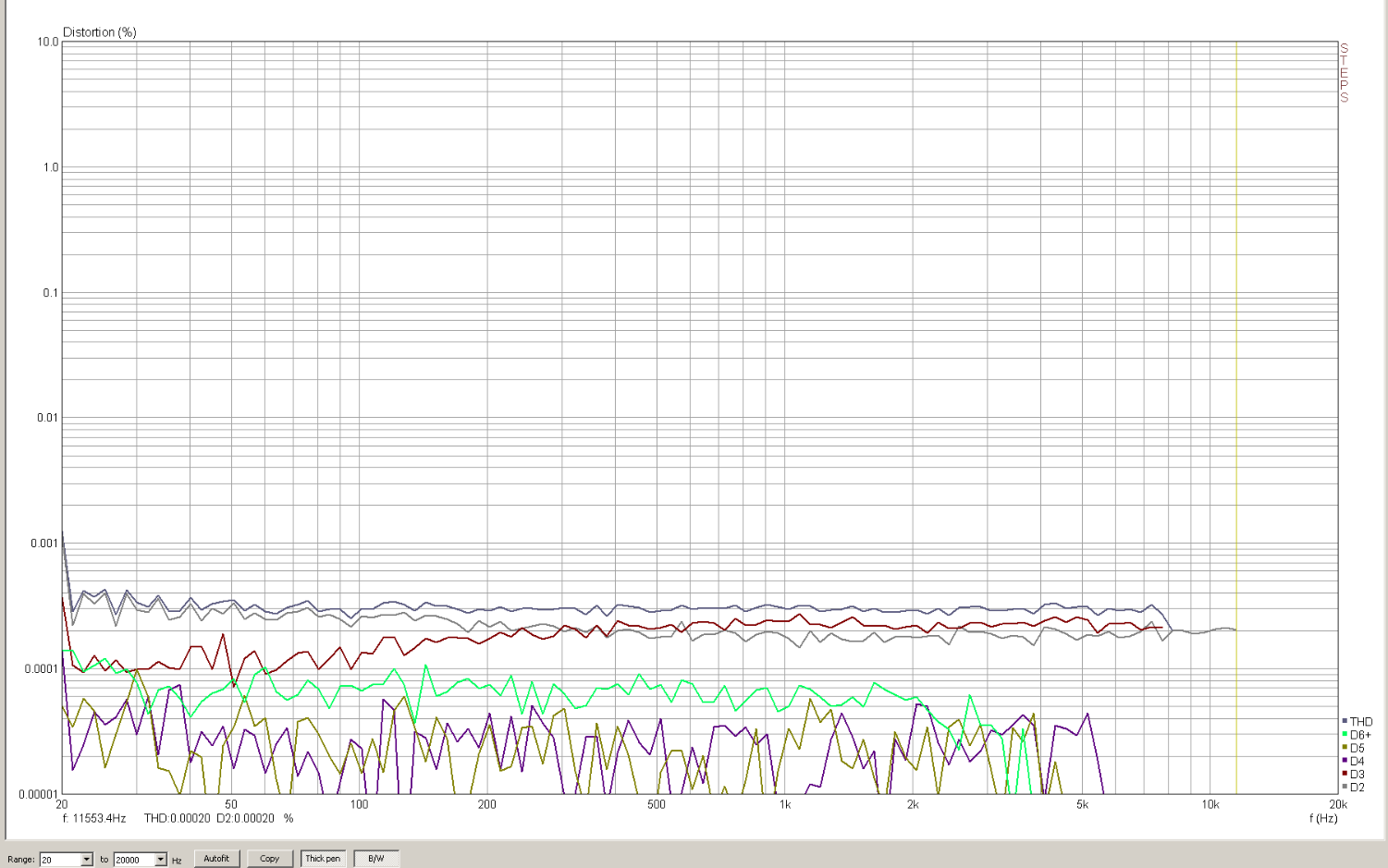

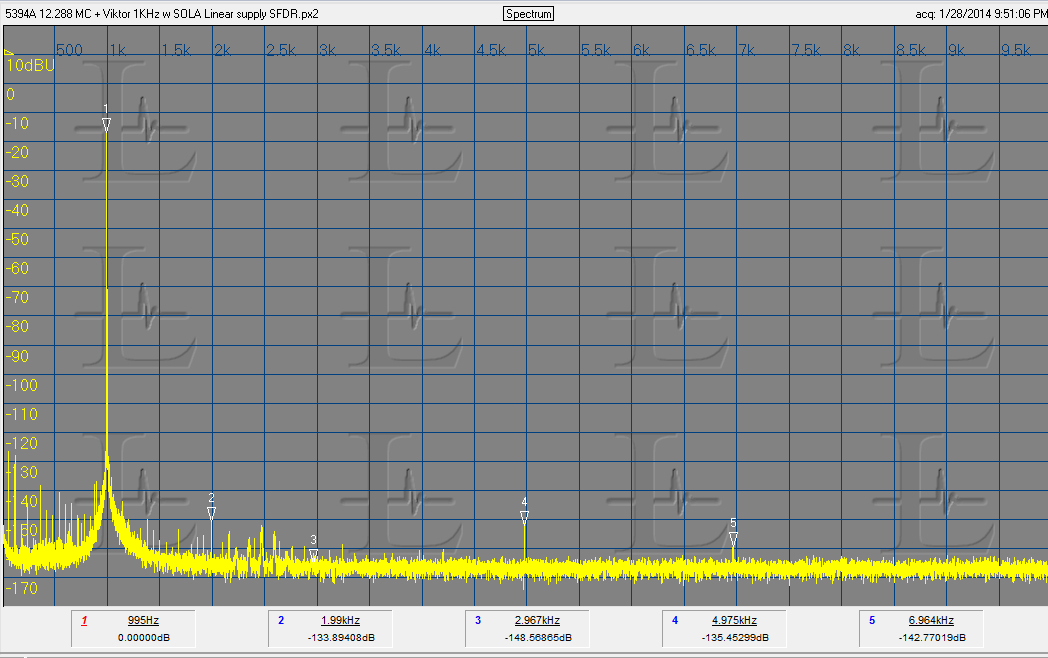

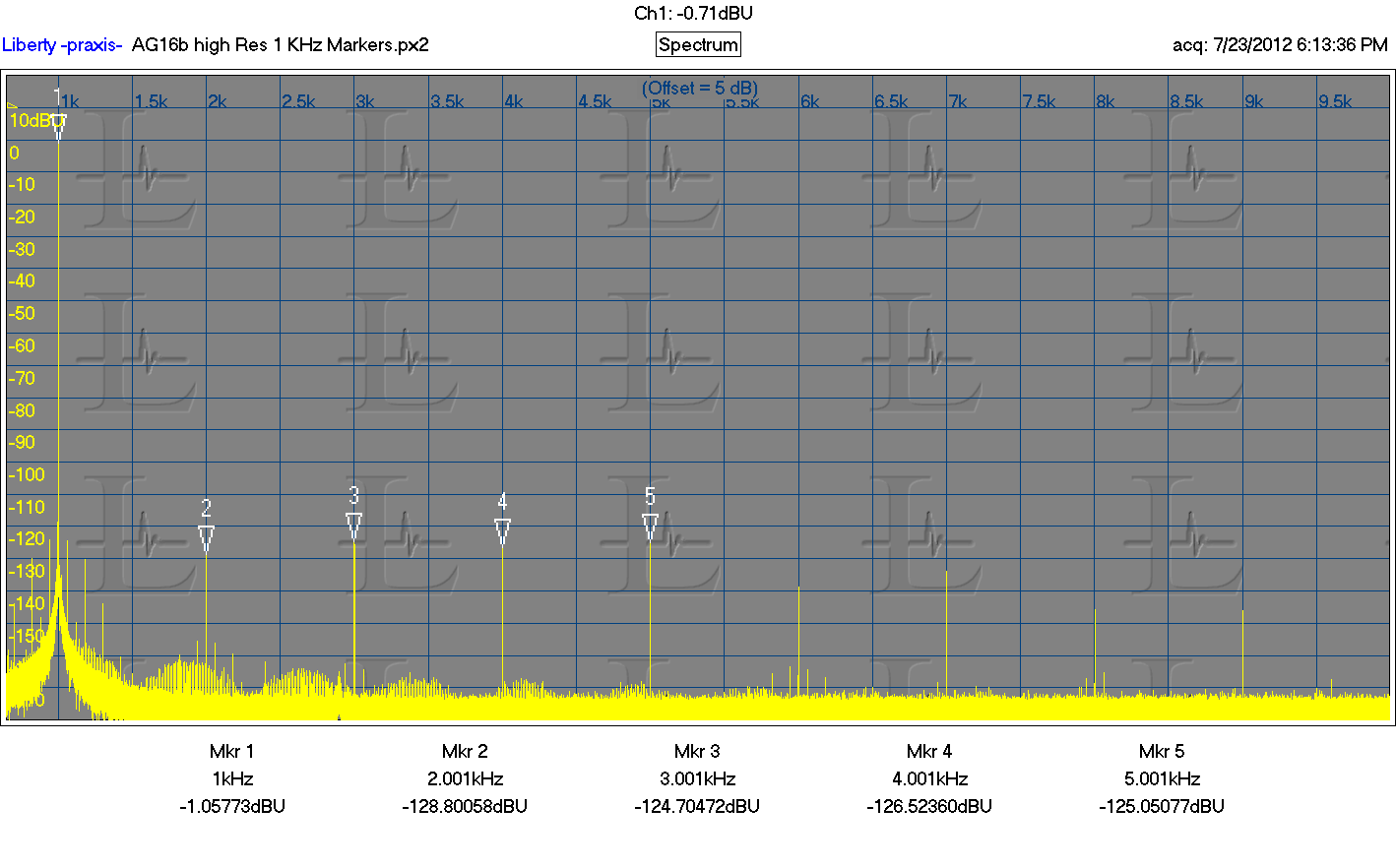

Attached is a measurement of an AK4490 made using the JK generator (a fantastic tool) and measured through a Shibasoku 725 distortion analyzer to lower the reference floor a lot. This is the residual of the chip in the demo board fed via I2S at 352.8 KHz. In my testing I have not seen a substantial difference at lower sample rates.

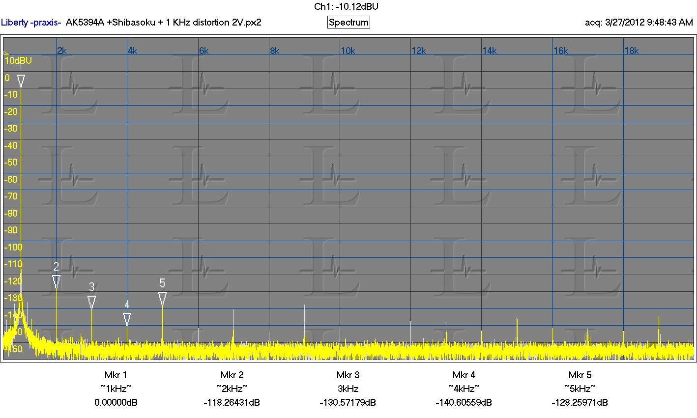

These are some measurements I made some time ago of the AKD5394A demo board with a few tweaks. 4V is essentially 0 dB and 2V is -6 dB. The AK5394A distortion drops a lot below 0 dB as well.
The third plot is the fully tweaked demo board (improved clock + opamps + power supply tweakes + best clock chain settings + random luck.
I don't seem to have a composite of the two (5394A + 4490) at this point.
its clear that much better performance can be had from a stock 1616m or 1212m if you can figure out how to get it. The ADC is the lowest distortion available still.

Dear Demian,
The last plot.. cruel numbers 😎
Also the noise floor is ~8-10dB less than what best I have seen from the 1616m card.
Sigh.. will have to open it again -- always that lurking feeling of last operation.. (with the patient dead)
Only point: I think my 1616m card do work in full strength, without problem. The above observed distortions all come from the external dac. Notwithstanding, your numbers are a strong invitation for further fiddling..
And clearly I have a problem with my 4490 install.

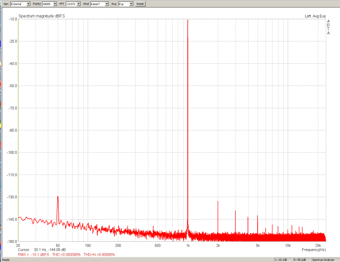

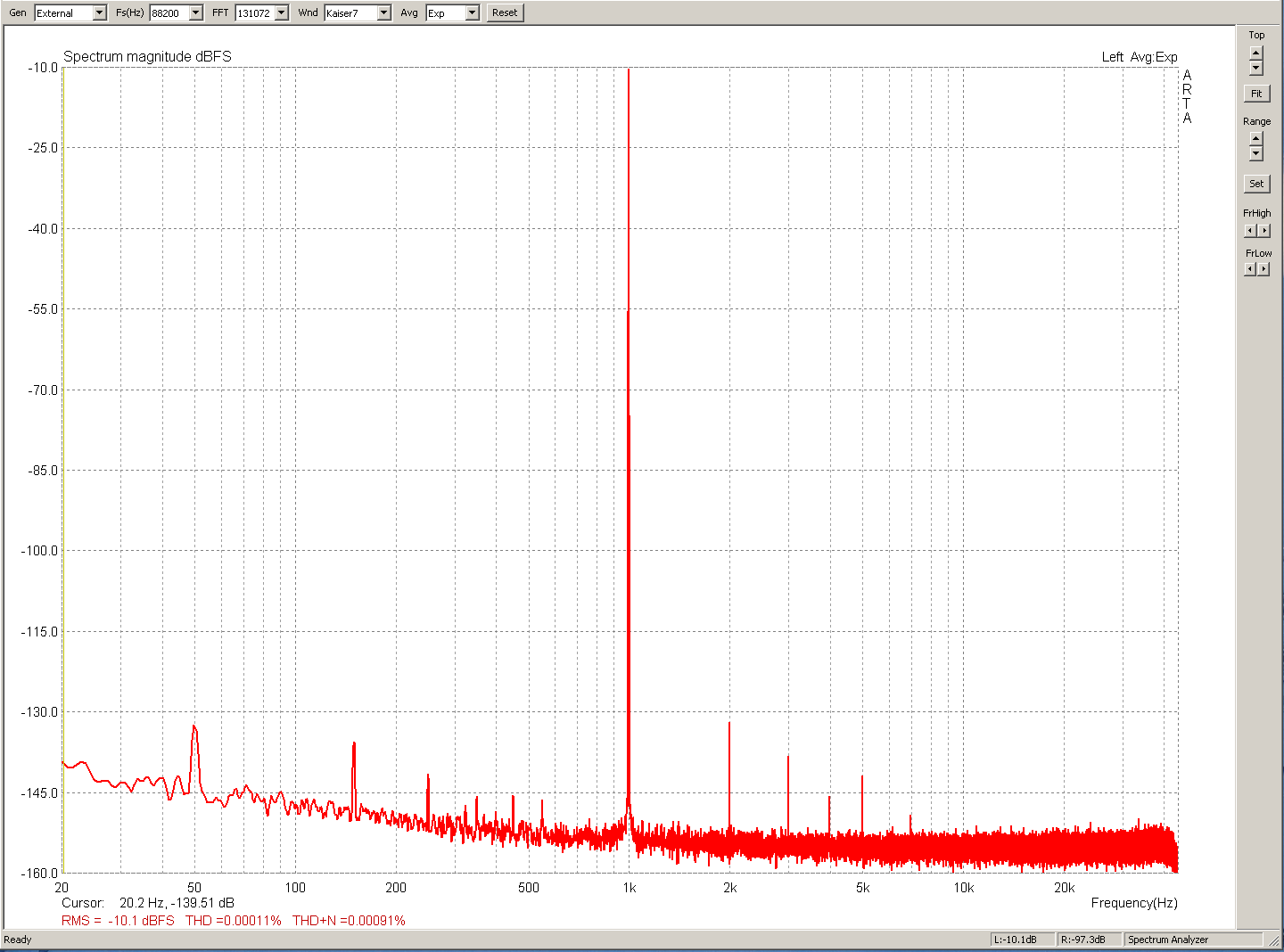

Ok, i have found the bug in my diyinhk AK4490 board configuration. It is coming with manual sampling rate configurafion, this should set to auto, or taking care externally, while changing sample rates.
Now it does the right thing: the first shot is the usual configuraton, AK4490 board at 44,1kHz sample rate, EMU1616m input at 48kHZ sample rate, asio drivers.
The second shot is the same setup except the AK4490 board driven at 192kHz. The only change I see is in the jitter. (Sensitivity to jitter)
